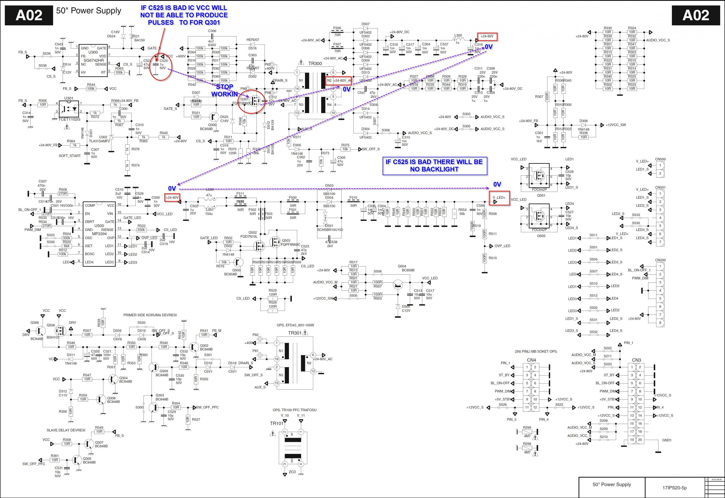

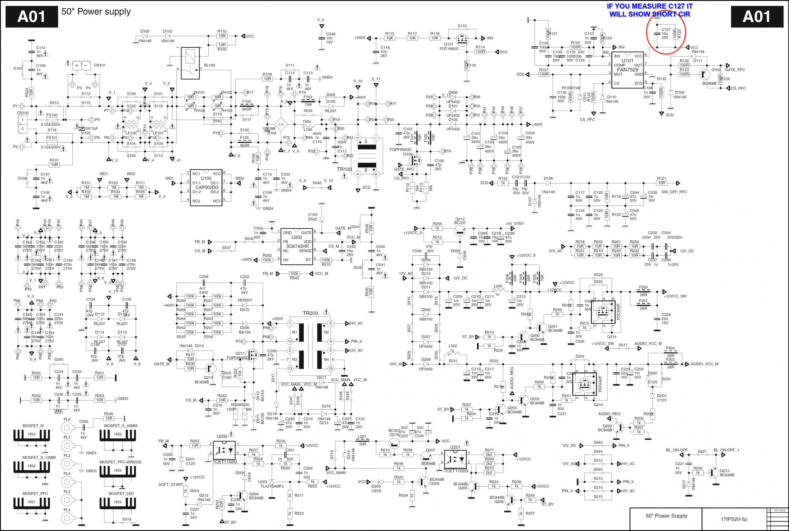

    HI ReeceyBurger123
    very good work very good video thank you .
    this power supply seemed to complicated ..but not it is not wil arranged diagram .
    I have two comments :
    first when you measure c127 it has 100 ohm parallel to it ...it shows false short cir
    second if c525 (1uf/50v) is bad it wil stop backlight I send pic elastrate the reason for this .
    I think all vestel ps are the same but this one is the worst .
    again thank you for good work and video .

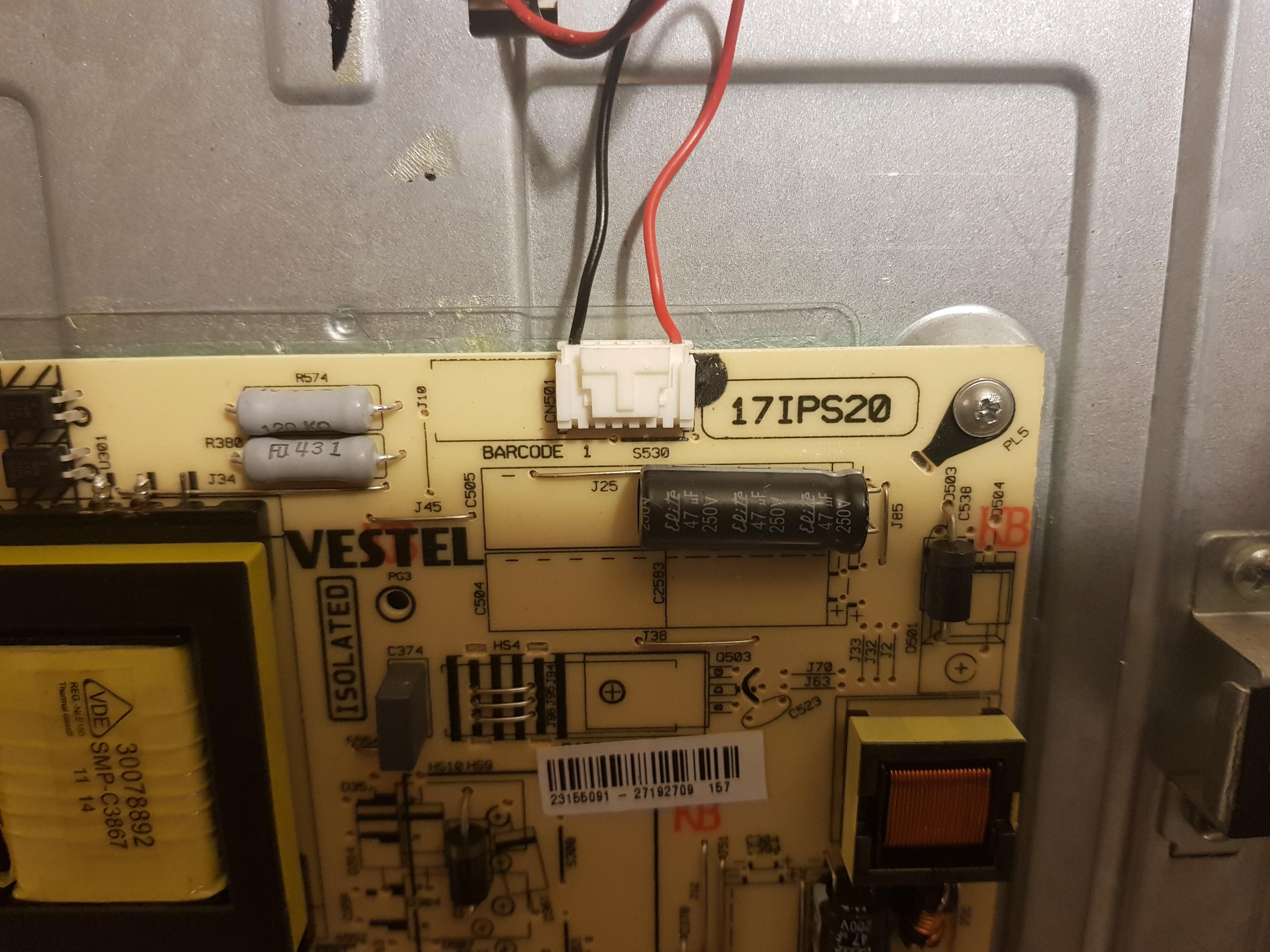

                                        #39
                                        Re: 17IPS20 No Led Voltage Solved With Video
                                        Originally posted by johnboy183
                                        Hi Sorry to jump on to this thread but my issues are the same as above largely. I am trying to sort no backlights ona JVC LT50 TW60J with the dreaded 17IPS20 board. Have followed closely the many threads on this especially the excellent youtube video by ReecyBurger123 which was very helpful but seem to now have reached a dead end. The set has a working screen with an occasional flash of backlight at startup but most of the time backlight's remain stubbornly dead. I was convinced it was a LED problem so checked to find odd faulty LEDs but once all were fixed and and each strip tested and working I get no backlight on connecting up the whole series and firing the set up. The LED out from the board goes straight to 156v and remains there constantly. But no 180-190v startup voltage. With the LEDs in place I get 156v at the beginning of the LED circuit and 95v at the end of the LED circuit on the return to the board. Reading all the threads I am left with suspecting the startup boost. Any help if pointing me to the likely board culprits would be very appreciated as nearing wits end on this issue!
                                        1) Can I see good clear straight shots of the whole top and bottom side of YOUR board?
                                        2) "With the LEDs in place I get 156v at the beginning of the LED circuit and 95v at the end of the LED circuit on the return to the board." What do you mean 'at the end of the LED cicuit? Do you mean the Cathode return of the LED string? Your TV has only two wires to the LED string, correct? So if you have 156V feeding the Anode of the LED string and 95V on the Cathode return, that means the Vdrops of the LED string is only 61V! which is not normal.BTW, the measurement is done using chassis as the GND ref. for the meter, correct?
                                        3) The schematic we have shows 24 ~ 80V (depends on PCBA) is for feeding the LED boost converter, you indicate that you have 156V so the boost converter is working but not high enough.
                                        4) No LED connector in place, keep black probe of the meter on chassis, Red probe on the V+LED of the LED connector, what Voltage does it show when TV is off, then hit the power button and see what Voltage it goes up to.

                                          Thanks for the reply and thoughts. I will try and take some good photos of board and post later today. Things have moved on slightly in that I have managed to get a good clean set of fully working LED strips from a reputable source but the fault remains - ie no backlights on at all and not even a brief flash of them.
                                          I have set up now the complete array and boards on the bench and checked every connection point along the LED path from the board back to the board and to ensure no shorts to chassis etc.
                                          With the array plugged in, black lead from Meter to earth ( Both boards earthed to each other) and red lead used to probe voltages along the LED circuit I get when power switched on:
                                          166v instant blip (blink and you miss it)
                                          156v at LED + connector on board
                                          156v at + connector on 1st strip
                                          138v at + connector on 2nd strip
                                          121v at + connector on 3rd strip
                                          102v at + connector on 4th strip
                                          87v at + connector on 5th strip
                                          71v at + connector on 6th strip
                                          58v at + connector on 7th strip
                                          48v at neg side of LED connector on power board.
                                          When tv turned off using remote ( so no front blue light) LED + connector shows 3.7-4.2v (why?).
                                          Led connector disconnected with no front blue light (as above) the 3.7-4.2v slowly disapates down to 0V
                                          Then turn on TV with remote with LED cables disconnected I get very brief 166v followed by static 156v at LED+ connector on board.
                                          I hope this helps you make some sense of the problem as I am running out of ideas. thanks for your help. Will send board photos soon
