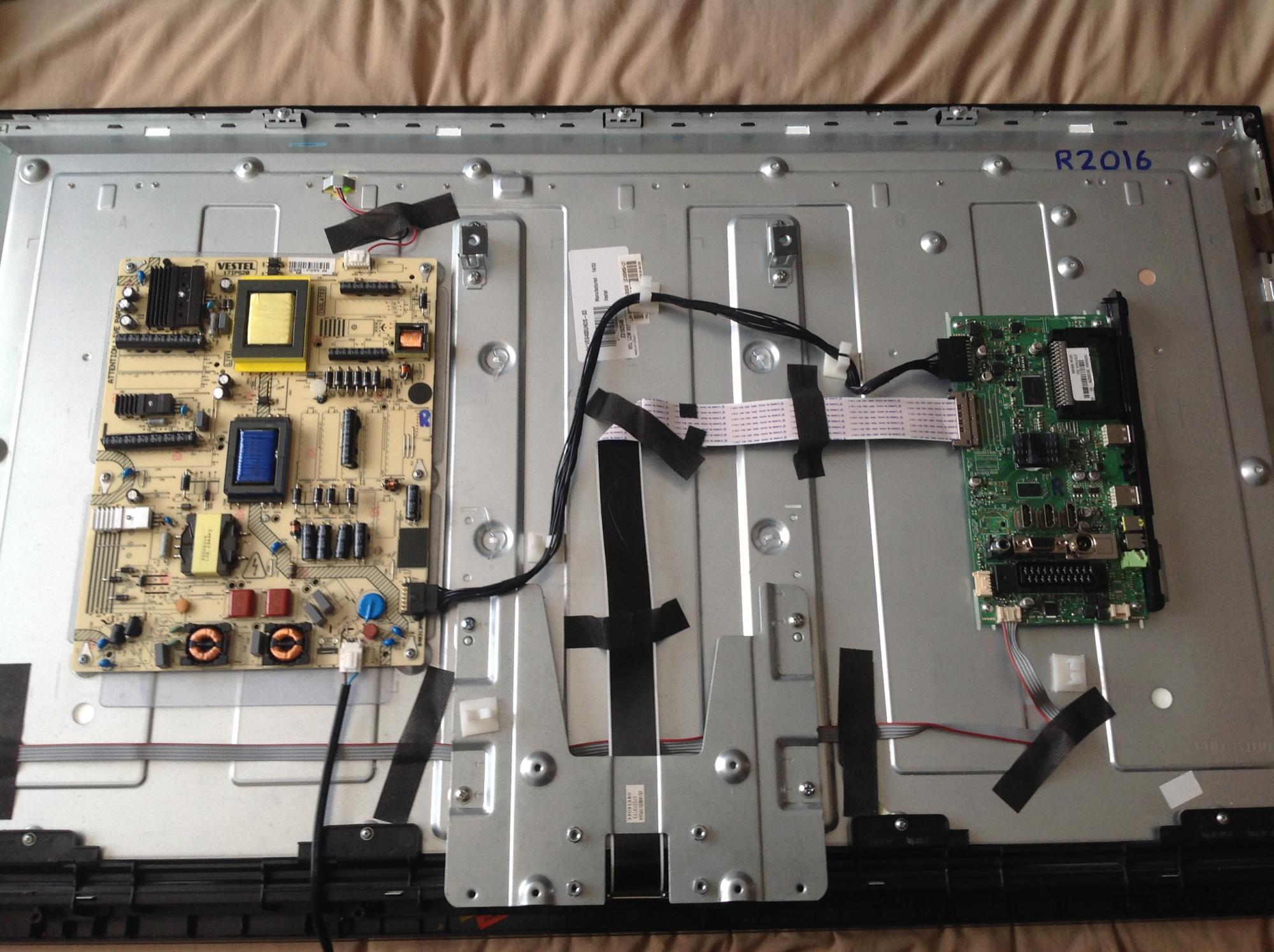

    Hi all I know theres alot of issues with these supplies and no backlight, today the symptoms of the issue with this one were the following:
    No backlight
    0v on Led output
    Q502 and D504-Led output boost devices not shorted
    0v on D303-D314 which are 6 diodes in parallel for Led output meaning Q301 transistor for Led output is not turning on enough or at all
    Found only 330v across main caps meaning Pfc mosfet Q100 not turning on
    Pfc controller U101 starts then shuts down Vcc drive voltage meaning issue is in the primary side
    Things to check:
    Q301 for S/C
    Q101 for S/C note both these can blow and if their resistors fail open quick enough the mains fuse will not blow and Psu likely will start with no backlight
    D506 for leakage current, this diode does not normally fail S/C but leaky acorss the cathode to anode so check that
    What I found:
    U300 check if its sending Vcc now I found it did but then shut down too meaning issue with either U101 or U300 or related parts
    Checked U101 found low resistance across pins 1 and 3
    Checked C127 (near U101) 50 ohms across it meaning theres a short acorss that cap, removed and checked however cap is fine out of circuit
    Then checked C525 (under Q301) which is in parallel with C127 and both U101 and U300
    C525 had lower resistance across it
    Removed C525 and its shorted
    Checked controllers again and low resistance gone
    Replaced C525 which I believe is a 1uf 50v multilayer ceramic cap-MLCC stole one off a scrap IPS20 which is not worth fixing and replaced resistance still good

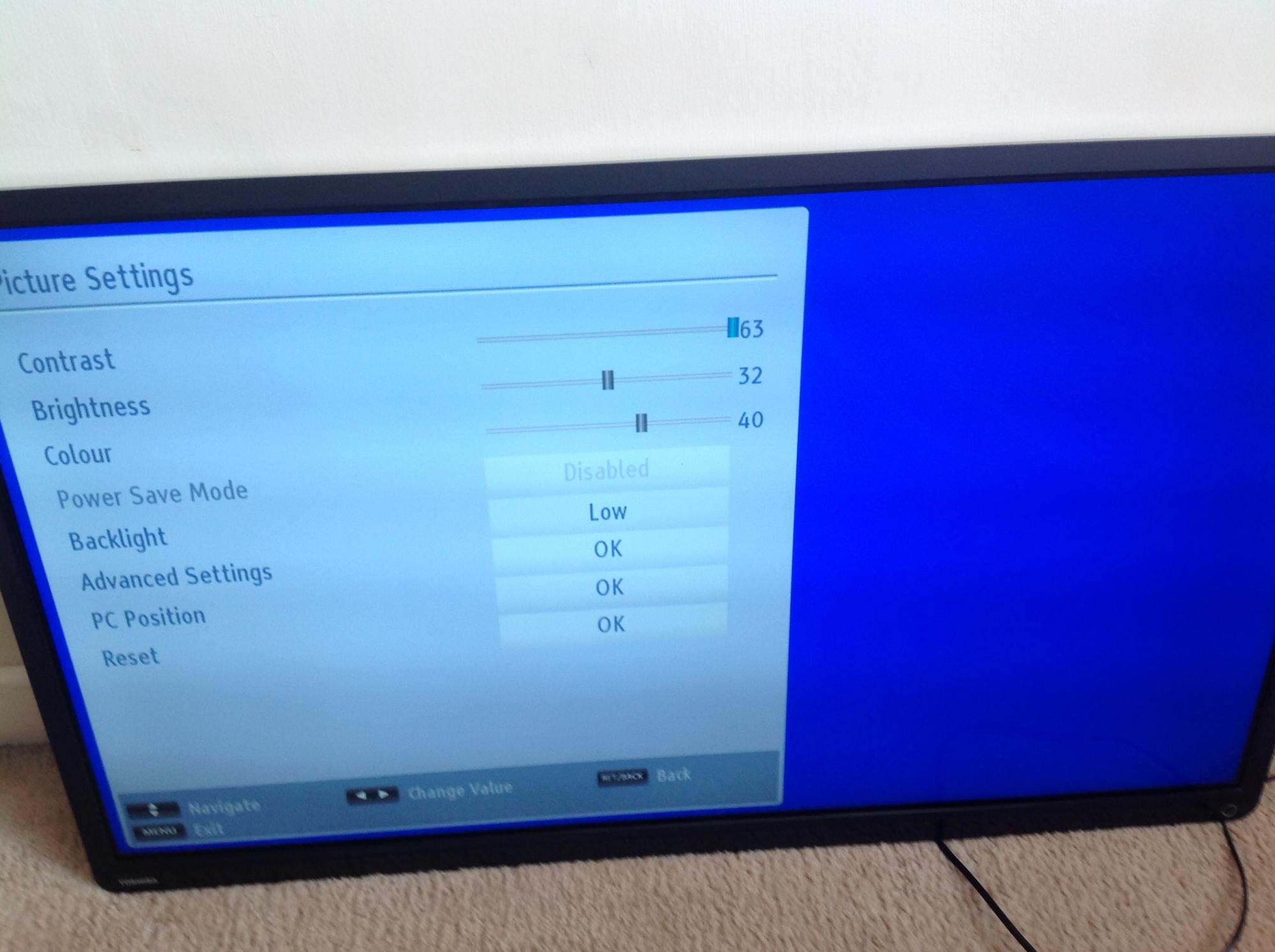

    Put the Psu back into the Tv and the set now works. Hopefully help someone out, remember to check that cap if your Led section is totally dead with no output
    Video coming tomorrow or Tuesday.

    I also forgot too add, the motherboard (17MB95) was also totally dead the standby Led would flash then die flash then die, swapping the Mb for a similar one sorted the issue. So I wonder if the Psu cap shorted killed the Mb at the same time ? Or the set got hit by a surge ?

                    TV powers on for a second giving the blue screen before going back to standby.
                    I disconnect the inverter and the TV stays on. No shorts on the inverter or the spare I have, the two poly caps have been changed and other electrolytics checked.

                      Hmm seems like the Pfc is low to me, this can cause 24v shut down which crashes the set. Whats the pfc running at ?
