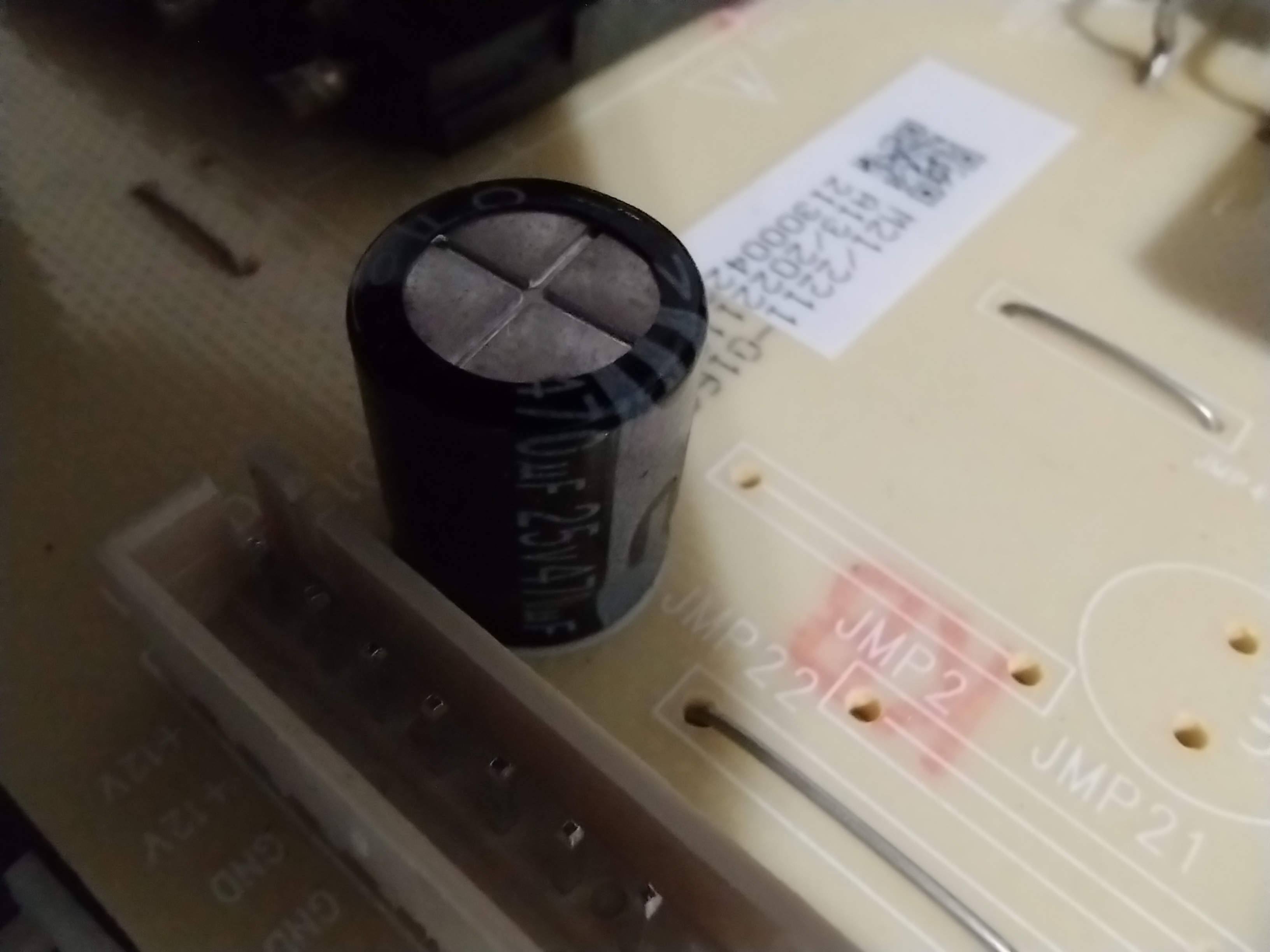

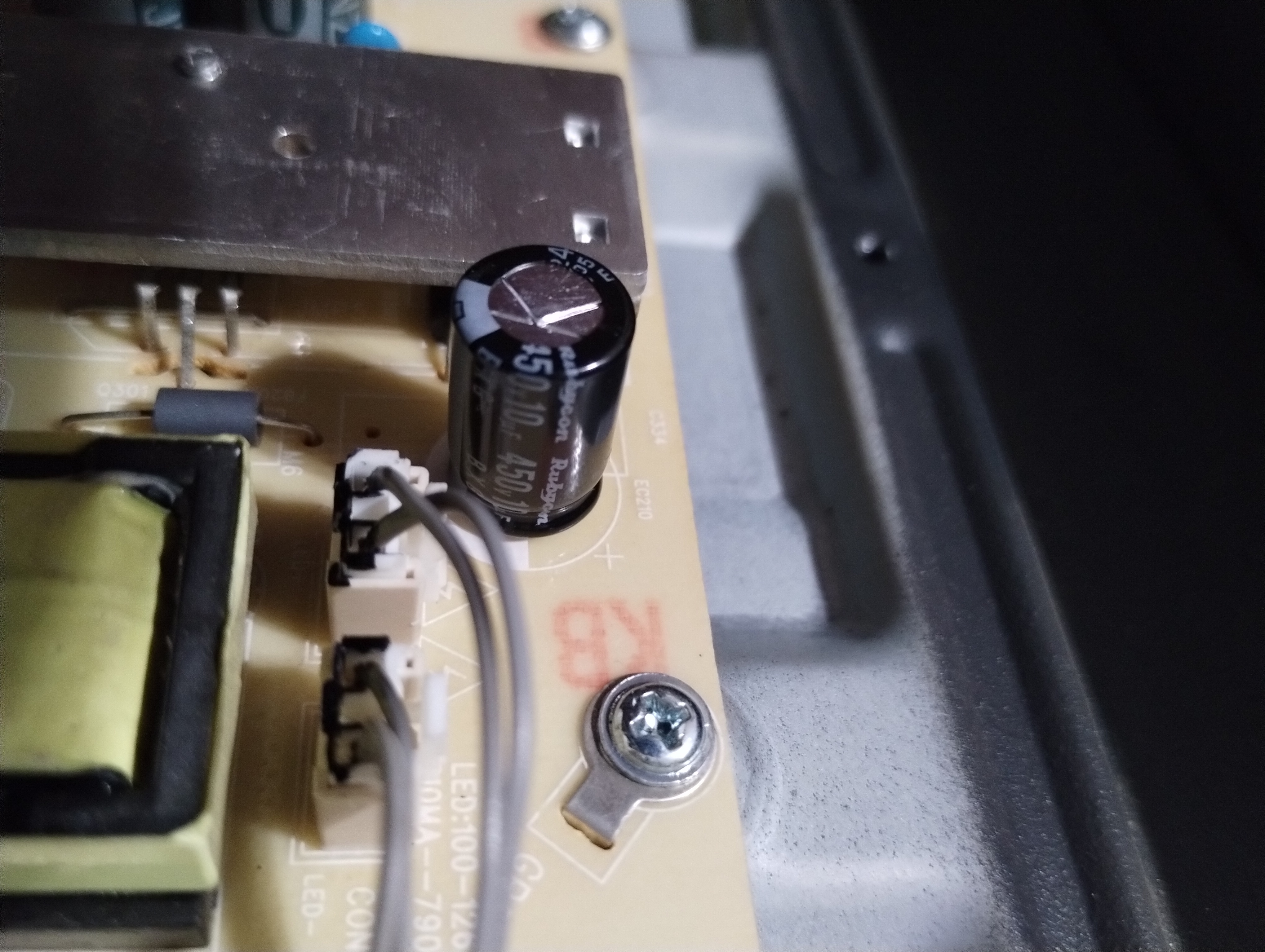

    Had another one of these 70 inchers from onn and was same problem as others. The picture shows but no backlight. The backlights test fine. The issue is the 450v 10uf capacitor by the backlight connector. Usually the cap bulges, the cap I replaced today for fix was NOT bulging. Replaced anyway and fixed.
    Hope this helps someone.

      If not able to test caps, just switch those 2 out, be sure the polarity is correct, that's one pretty simple way to either fix it or eliminate them from being the issue.

        To me it's common. Ive had 6 of these and it was always that capacitor in the picture. There's only 1 capacitor also.
        The cap should be slightly bulged, but I have also seen flat ones, and replaced it anyways and that's what worked
        2023 version of this TV, which is same model number, has a cord that is not removable, I've had an issue with main board, but the TV appeared to be dead, so different problem.
        I would be safe to say that yes this is your problem.

          Right only one on this tv, some tvs have 2, one for each side.

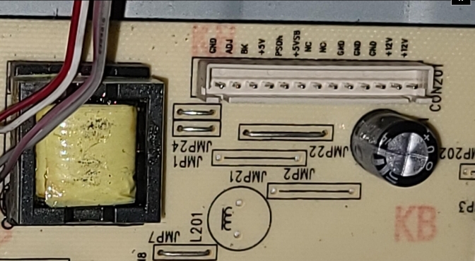

              I recently came across this post and the description of the problem was identical to my TV's problem. The backlight will flicker for a quick moment when powering up the TV then stay off. After reading this post, I purchased a new cap and replaced the 450V 10uF capacitor. This didn't solve my issue and the backlight doesn't even flicker when starting up now. I can do several things to light up the LEDs, so I don't believe those to be the issue. What I'm curious about now is that your image shows the capacitor near the cable going from the power board to the main board. That capacitor is 470uF 25V.
              Which one was actually replaced? Any other advice by chance?

                It's the 10uf one. I think I've had 15 of them where it was that capacitor. On one of them it wasn't the capacitor but it was the capacitor AND the backlights.
                What do you mean you can do several things to get the lights to light up? You have an led tester?

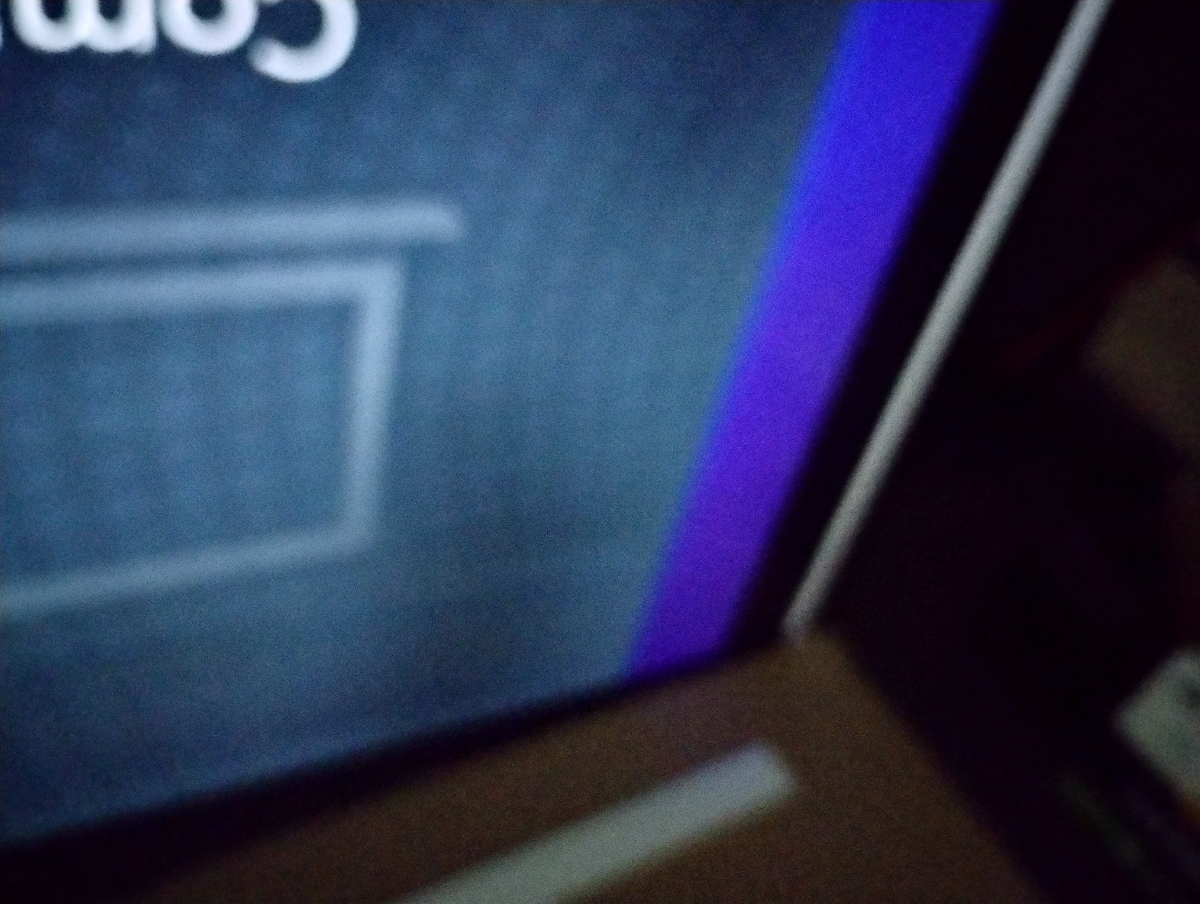

                    • DR12
                      • Nov 2024
                      • 3
                      I was able to look at the screen and use the remote while it was lit up (although it is dim, suggesting LED brightness issues) and I noticed I have a purple bar along the left side of the screen. I'm attaching a picture. It looks like I have more than potentially just power board/LED issues. I'm currently debating my path forward as this potentially just got more complicated and expensive.
                      If I do get the LED tester, I see one of the voltages going to the LEDs is around 340V. The testers I'm looking at for 15-20 dollars only show up to 300V. Will that be an issue?
                      Thanks for all the help and patience.

                      • EazyBone
                        • Jun 2023
                        • 1361
                        • United states
                        The voltage from the tester will show only Around 96volts for thie tv. If the tester shows 300v then there's a short. It'll show a different voltage then if you tried to test it with multimeter. That bar won't be fixed by led replacement and if I personally saw that I would stop there. Looks like a cof like on the screen is damaged. Take a look at the ribbon on the bottom over there for damage.
