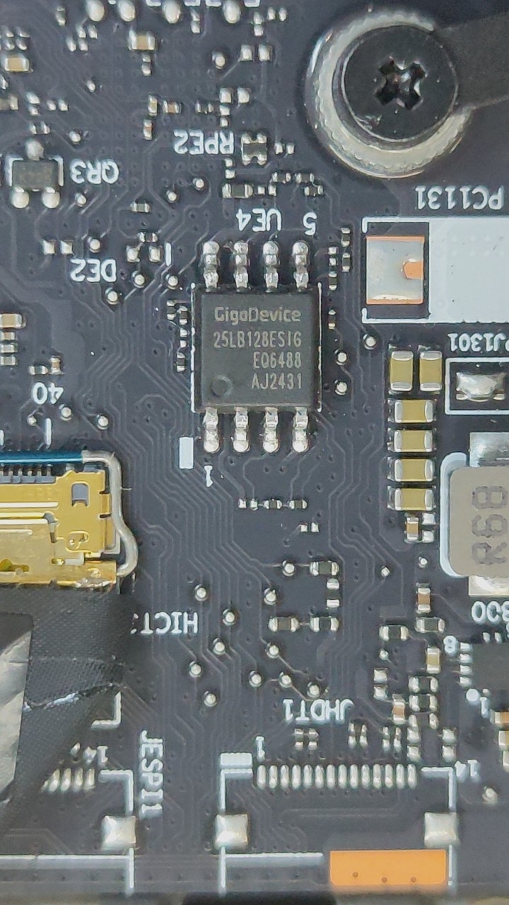

    The device is based on NM-F871 motherboard with Nuvoton NPCK397 series controller. The motherboard also contains three BIOS chips: two different Winbond chips for main BIOS and external EC flash, and also a Gigadevice chip which purpose I do not know. The password information is contained directly in controller and thus can be manipulated by reprogramming it, so reprogramming BIOS chips is technically not required, however you may wish to make backups thereof to use them in case of unforeseen emergencies.
