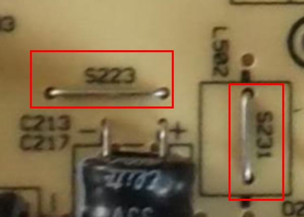

              1) Q511 is used as a switch it is part of the LED current path,if it is bad you will not have backlights when all other circuits are working, it is not doing anything right now because U500 is not running.
              2) Part designator with Sxxx and Jxxx should be just jumper wire, as I indicated before, the schematic is the master schematic for making PCB so all the parts are shown in the schematic. In this case if R513 is not installed the jumper S505 will have to be installed for the IC to get Vin, if R513 is installed then S505 will not be installed. If we have the BOM of the this board assembly that you have then it will be so much less confusion as to what parts are being used and not used. Since S505 is just jumper wire connected between +12VCC_SW and Vin pin 15 OF U500 so I cannot see how it can have 11.9V on one end and 7.6V on the other end, it has to be real bad connections to have that much Voltage drops on a piece of jumper wire.
              May be show me the pictures of this S505.
              See picture of Sxxx jumper attached.
              3) Q214 pinout, as shown in the schematic, pin 1,2,3 are Drain, pin 4 is Gate, pin 5, 6, 7, 8 are Source. You do know where pin 1 is on the Q214, right?
              4) Q214 and jumper S505 are present on you board, correct?

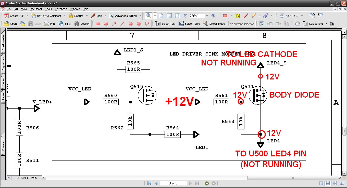

                1) Well aware Q511 as a mosfet is a switch - why does it have have 11.9v on all three pins?
                  2) As I indicated above that I measured both sides of S505 (it is a resistor marked 101) I'm not sure why you are asking if its present? If its simply a jumper why can it have 11.9 volts on one pole and 7.67v on the other? I need to understand its function.
                  3) Yes i know which would be pin 1
                  4) As said above S505 is on board. Have just been out to the workshop to look at board and cant find any 8 pin IC marked on board as Q214. I cant even find the board marking for Q214 but it is 1 am here so will look in daylight but even if I find the pads for it there does not appear to be such a chip mounted.
                  1) The Drain is connected to the Cathode of the LED string which is fed by Voltage source and you also have body diode of the MOSFET that is back fed through resistor between Gate and Source through body diode, the Gate is fed by the 12VCC_SW, Gate and Source pin has resistor connected and since the IC U500 is not running then the Voltage at the Source pin will be same at the GATE due to R563.

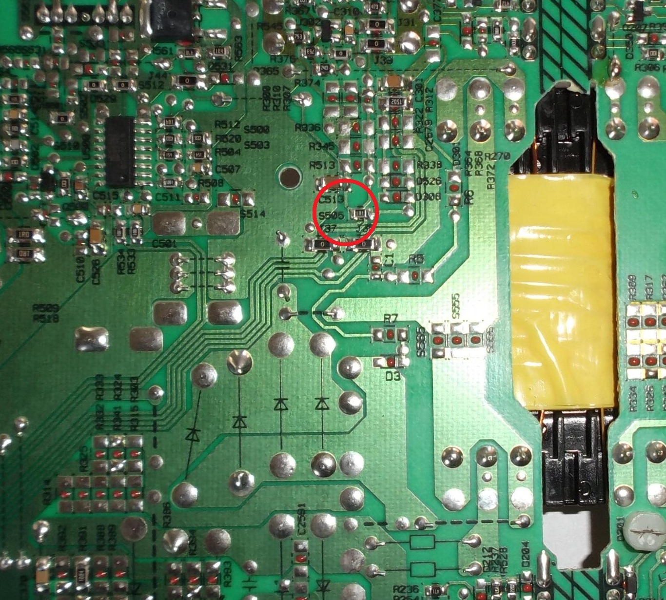

                    Here is a photo of S505 on the board unless I am misreading the board marking

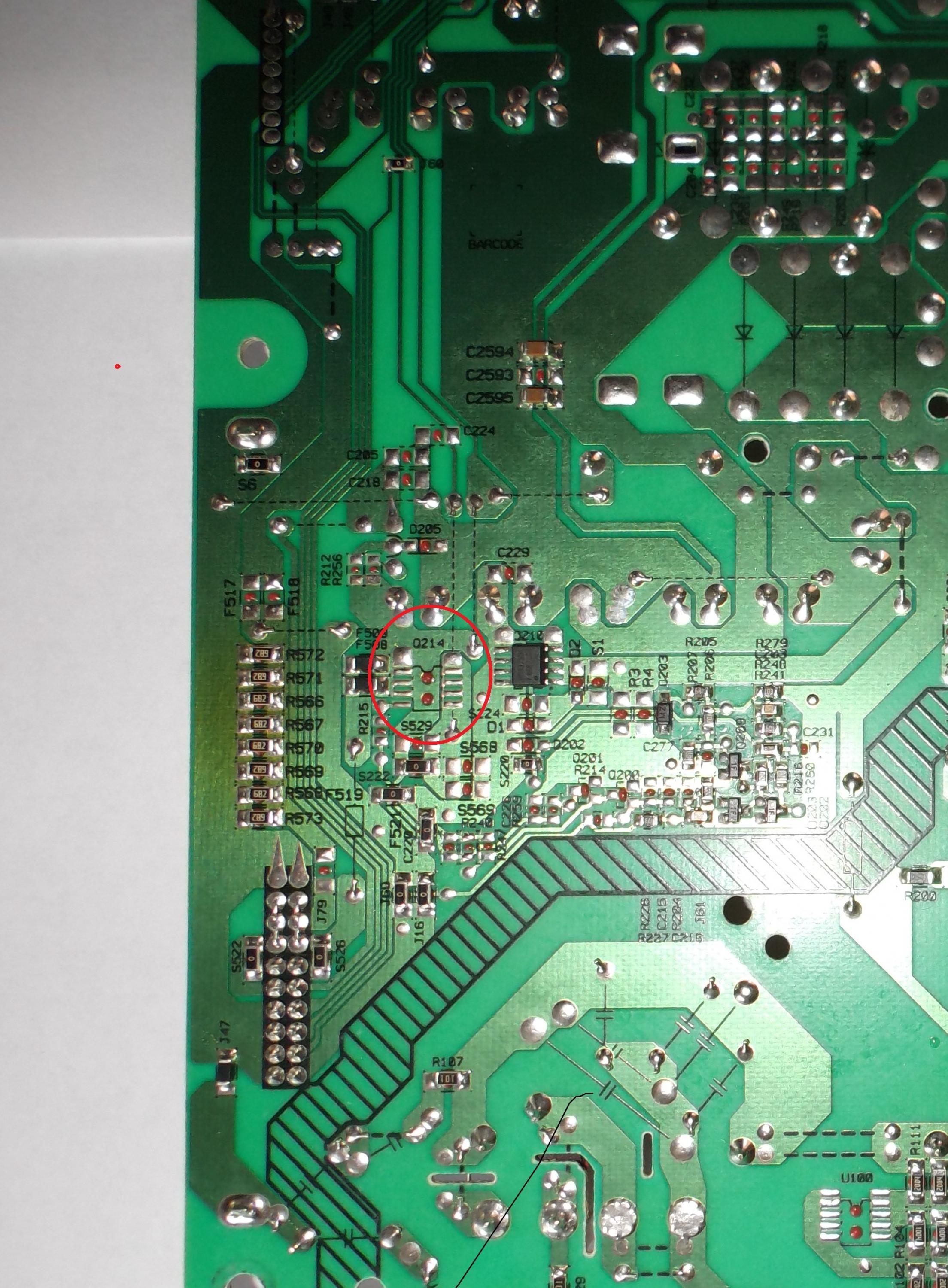

                      Finally found location of Q214 position and as you can see it is absent

                        You say above "the problem is around that IC and associated parts around that IC." Which "IC" do you mean in this comment so I can concentrate on that?
                          #92
                          Re: 17IPS20 No Led Voltage Solved With Video
                          1) IC U500, the LED driver IC.
                          2) So Q214 is not installed, that means S522/S529 are installed to bypass Source and Drain pins of Q214, please check to see if that is true or not.
                          3) Is one end of S505 connected directly to pin 15 Vin of U500? And another end of S505 is connected to S522/S529/Q214 Soucre solder pad? Please check.
                          VESTEL board is one of the worst board to work with due to so many variation and also due to not having the schematic that exactly matched the PCB assembly. This is very frustrating to troubleshoot.

                              • johnboy183
                                • May 2008
                                • 119
                                #95
                                I need to fully understand what you are saying here, and I don't unfortunately.
                                1)Are you agreeing that Q502 is dead and requires replacement?
                                2) Are you saying that the second fitted new U500 is now damaged and that is because up to 12 volts has been coming through it via the mosfet drain? (since the new U500 was fitted there has been no voltage larger than 11.8 volts recorded on the mosfet GD or S or any other component in this part of the board)
                                3) Or are you meaning that U500 is damaged as a result of the 42.3mA coming via S505 due to the difference between the 11.9v and 7.67v at S505 junction?
                                4) or both 2 and 3?
                                5) The trace from S505 also interacts with Q511 via R561 so will that have any bearing on the situation?
                                6) I still have no understanding of how at U500 Pin 2 Vin is 11.9v at standby, and at the commencement of power up, only for some 20 secs later it to drop to 7.67v! what could cause that to happen?
                                Unfortunately I cant just keep refitting new U500s every time the set is switched on as the pads at that point are now almost non existent so what would you advise my next actions to be?
                                ( I have ordered a new FQD7N30 but would have to re-order a new MP3394S if needed and hope I can successfully fit it)

                                  An update on earlier:
                                  In 6) I incorrectly typed Pin 2 instead of Pin 15 so ignore that typo.
                                  Have powered up the board with FQD7N30 left out of circuit and now its Drain and the LED connector + pin again read 156v
                                  Have disconnected the trace from S505 along its path to Pin 15 at various points ( via jumper pins and joints) testing up to each disconnection and right up to Pin 15 ( if Pin 15 is disconnected from its pad) it retains 11.9 volts at every point along the way until Pin 15 and its pad are reconnected when it immediately drops to 7.6 volts. So it would appear as you feared than U500 or one of its other pins is the source of the voltage drop. Any thoughts on this later news?

                                      #98
                                      1) Q502 is bad.
                                      2) Q502 Drain is fed by 24 -80V power source as shown in the schematic, but it is actually 150V which is then boosted up to 190V or so if U500 and Q502 are working so when you have short between Drain and Gate, the Voltage is dumped into the Gate drive output of U500.
                                      3) "Have powered up the board with FQD7N30 left out of circuit and now its Drain and the LED connector + pin again read 156V" Which Q is that FQD7N30? Q502?
