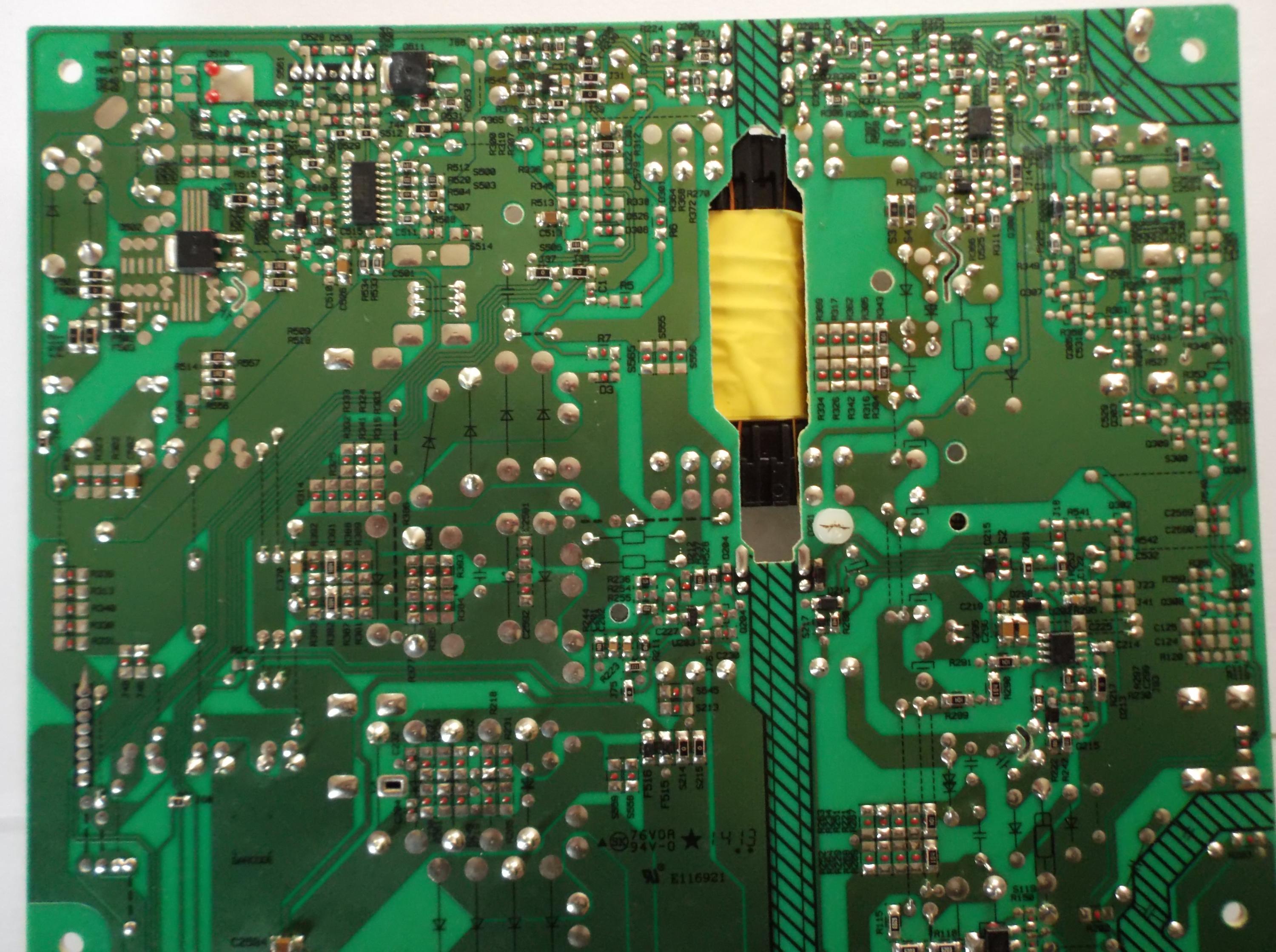

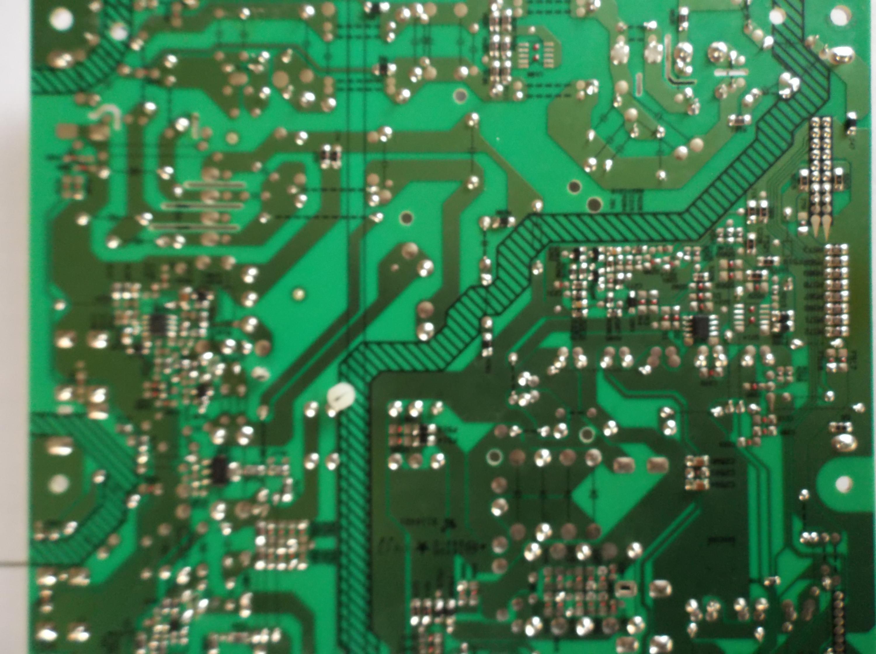

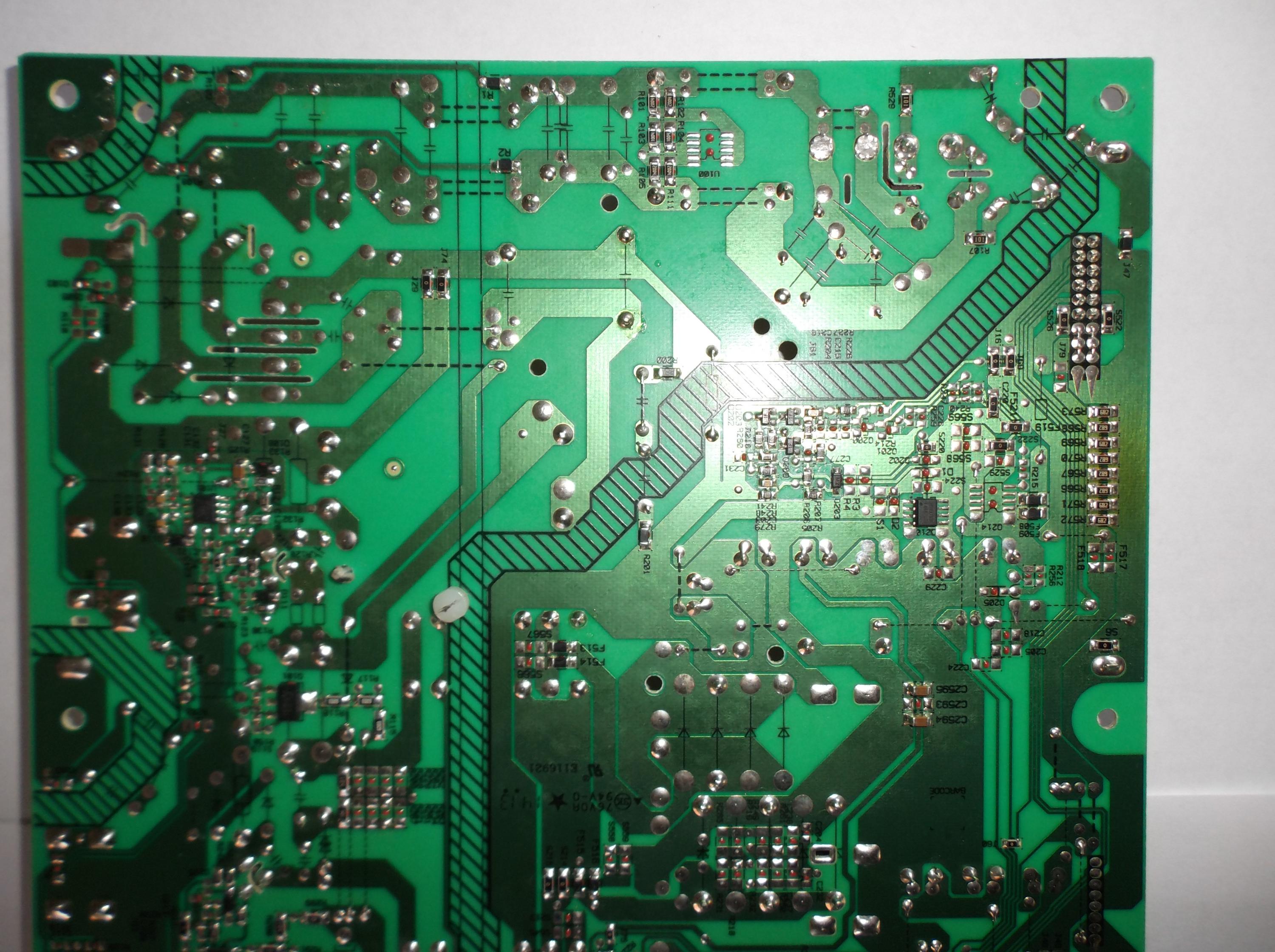

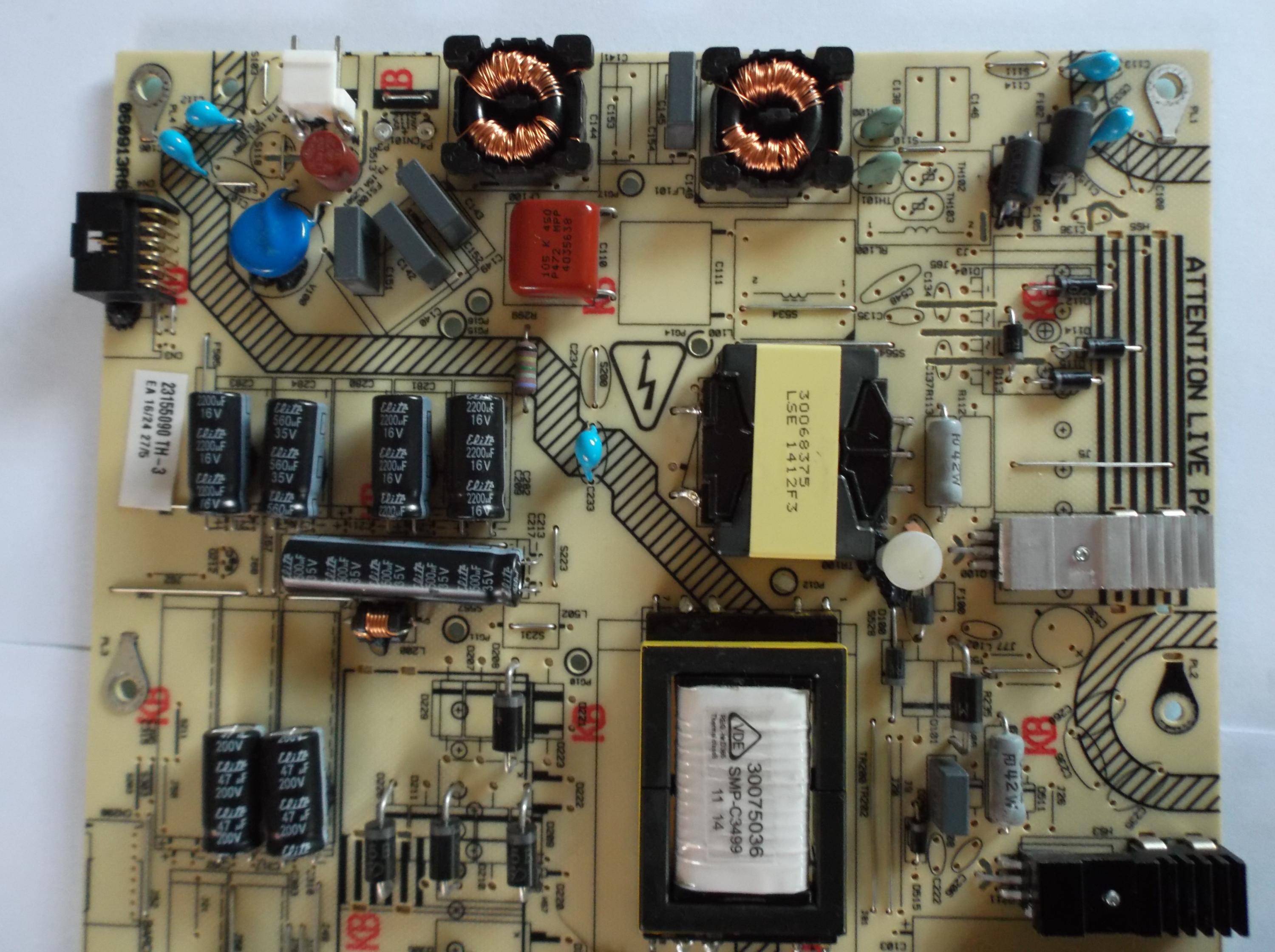

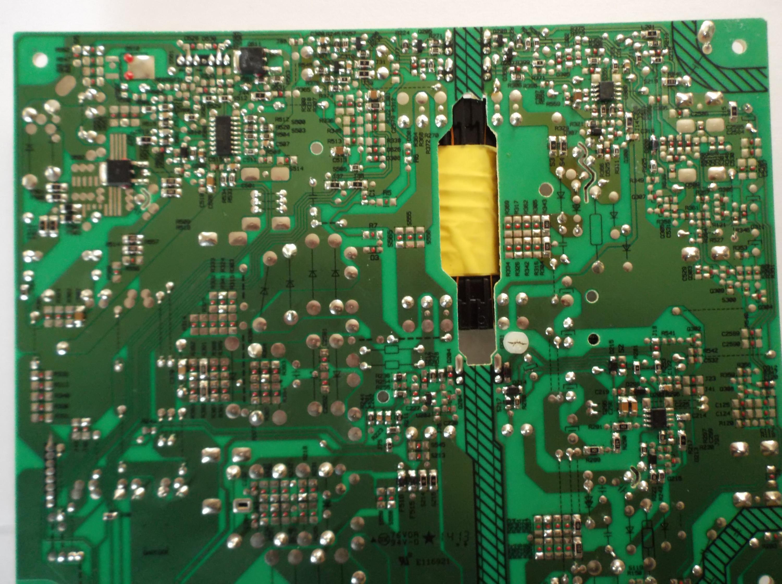

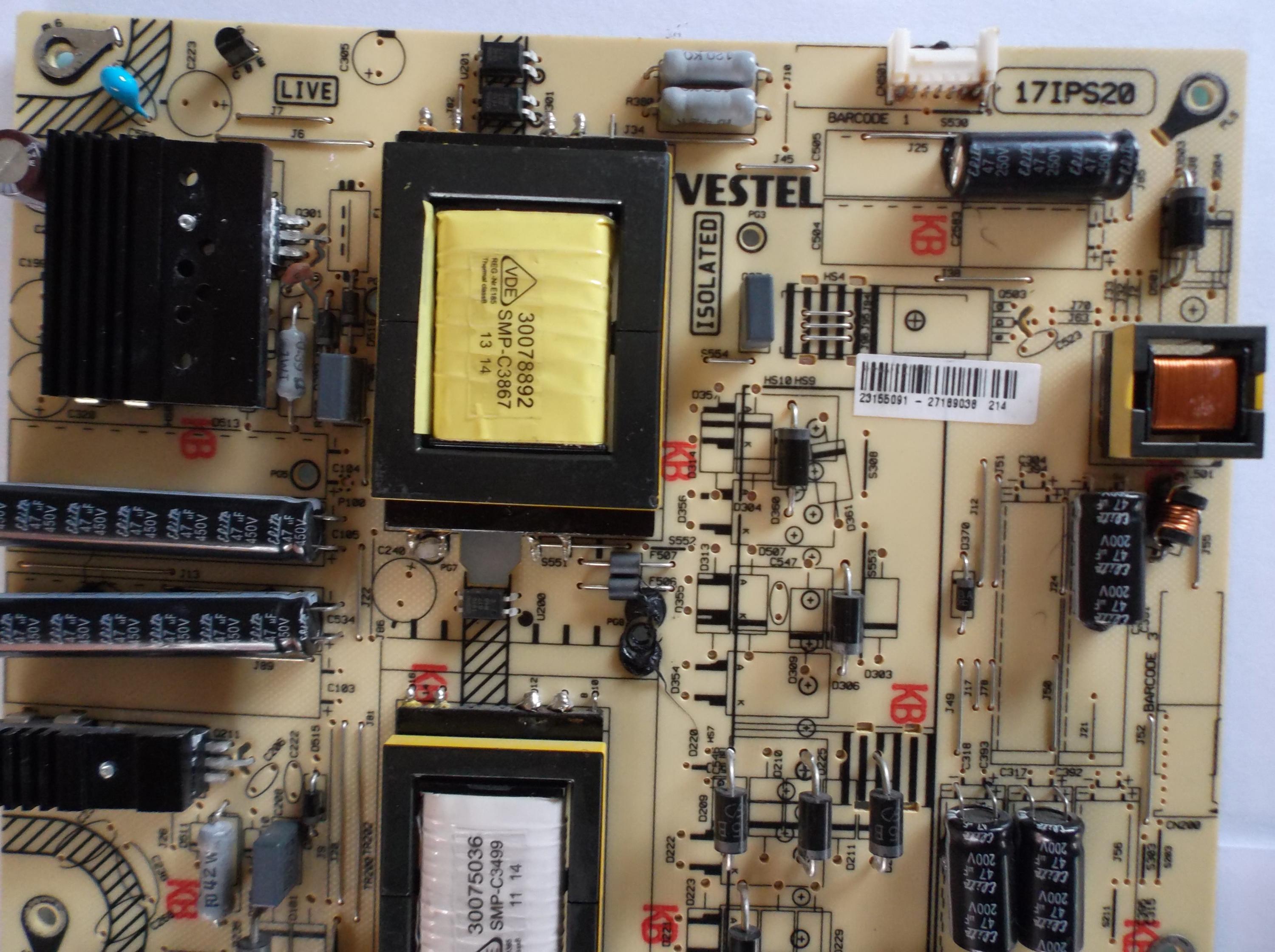

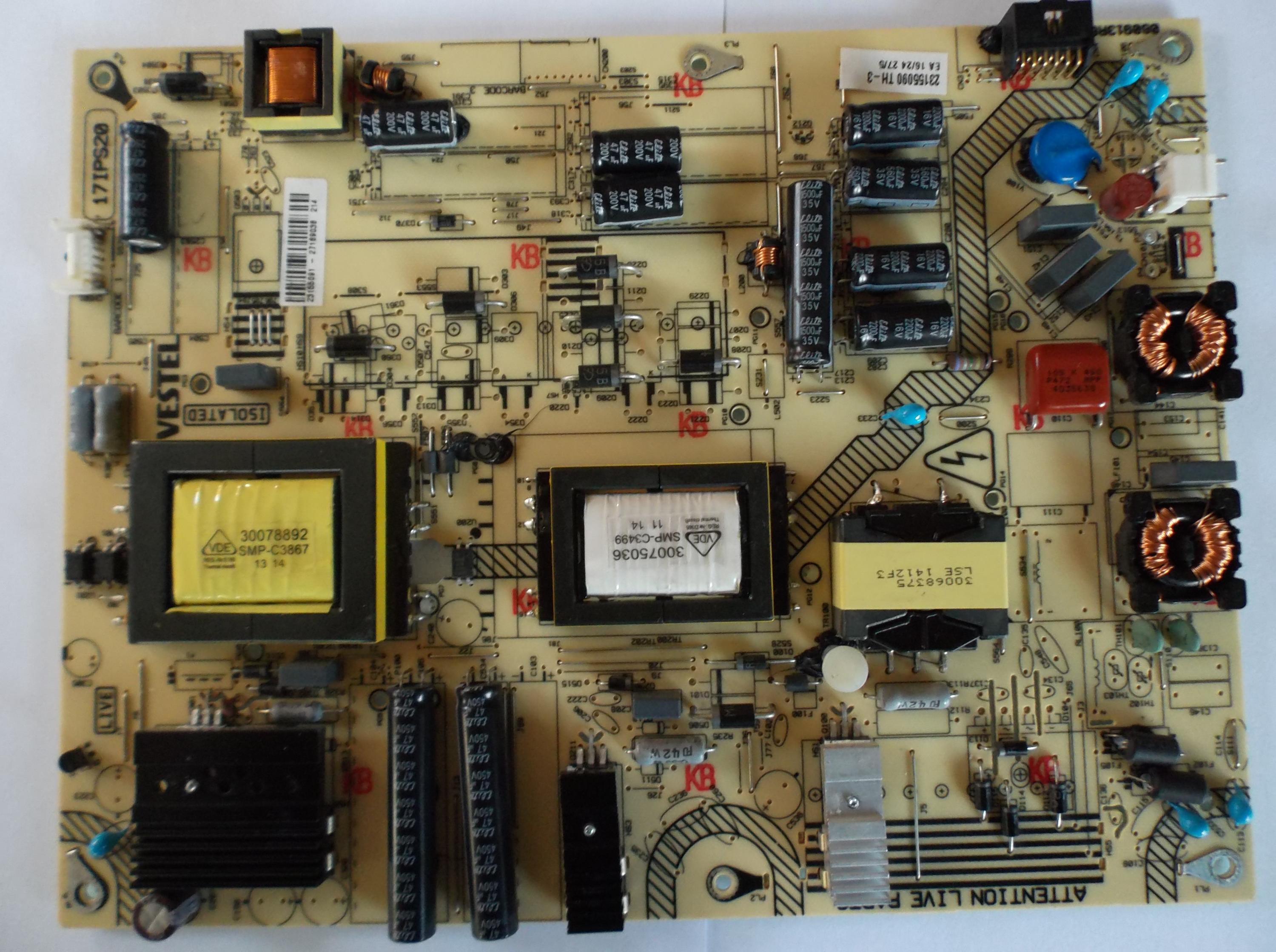

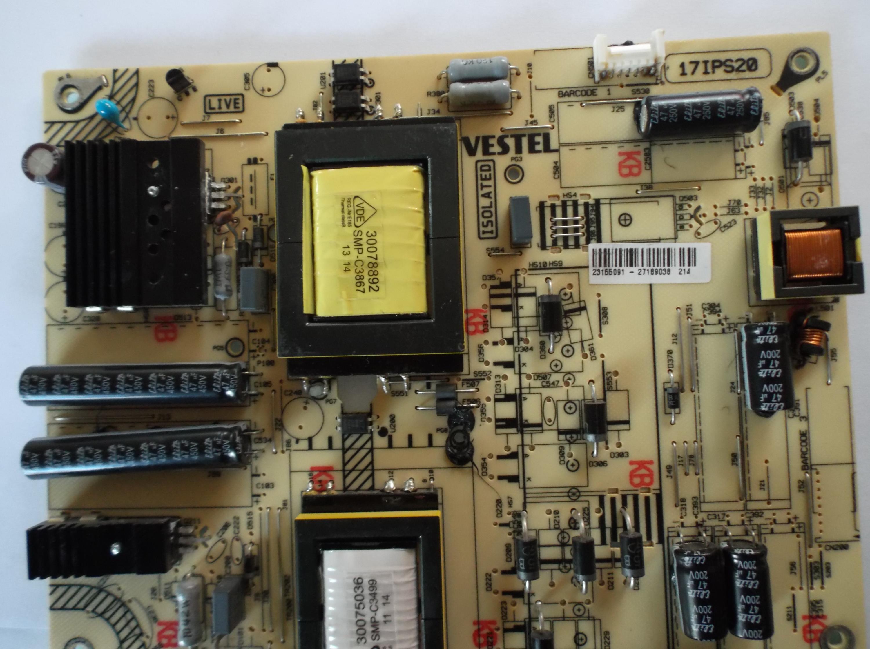

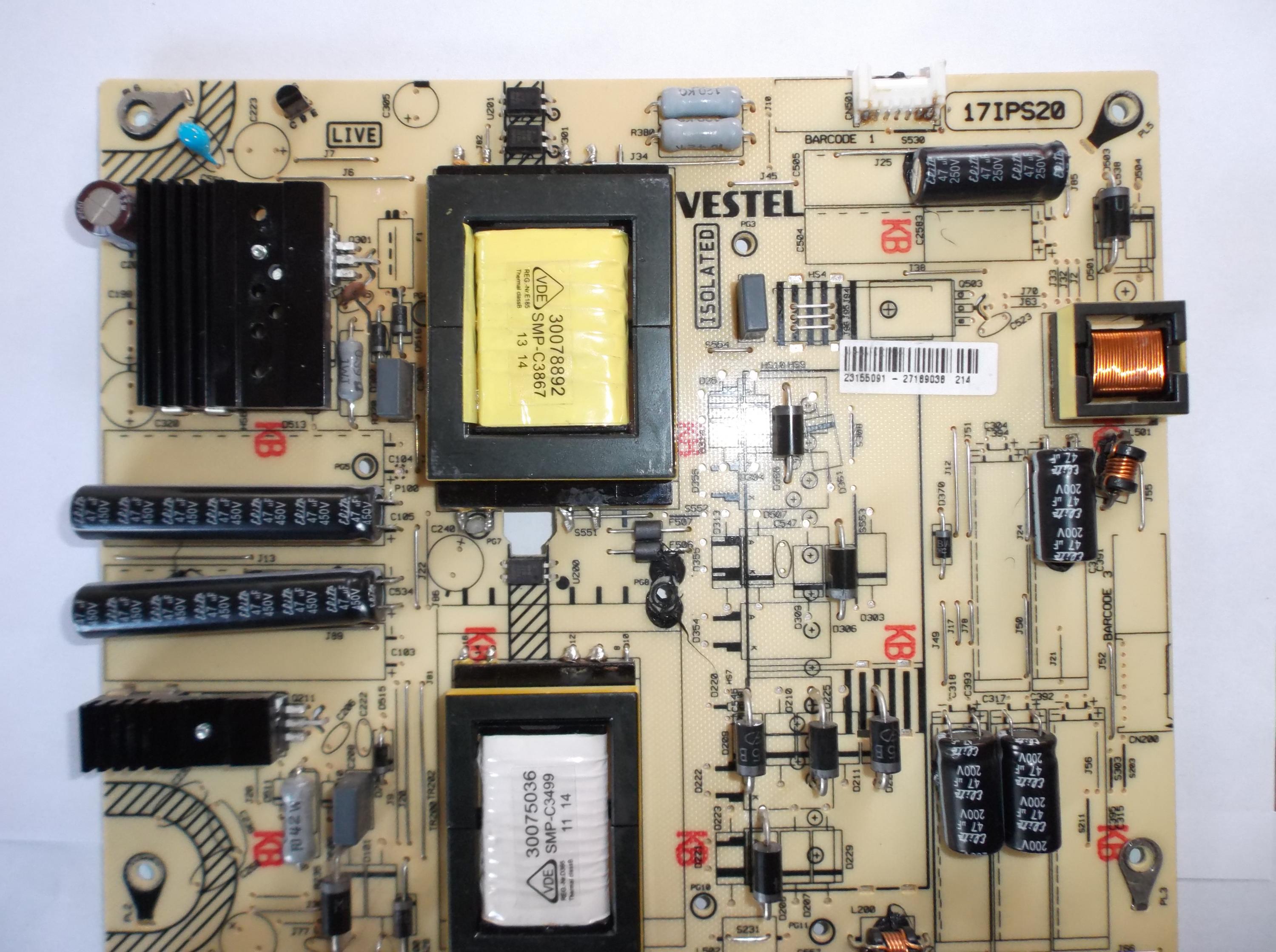

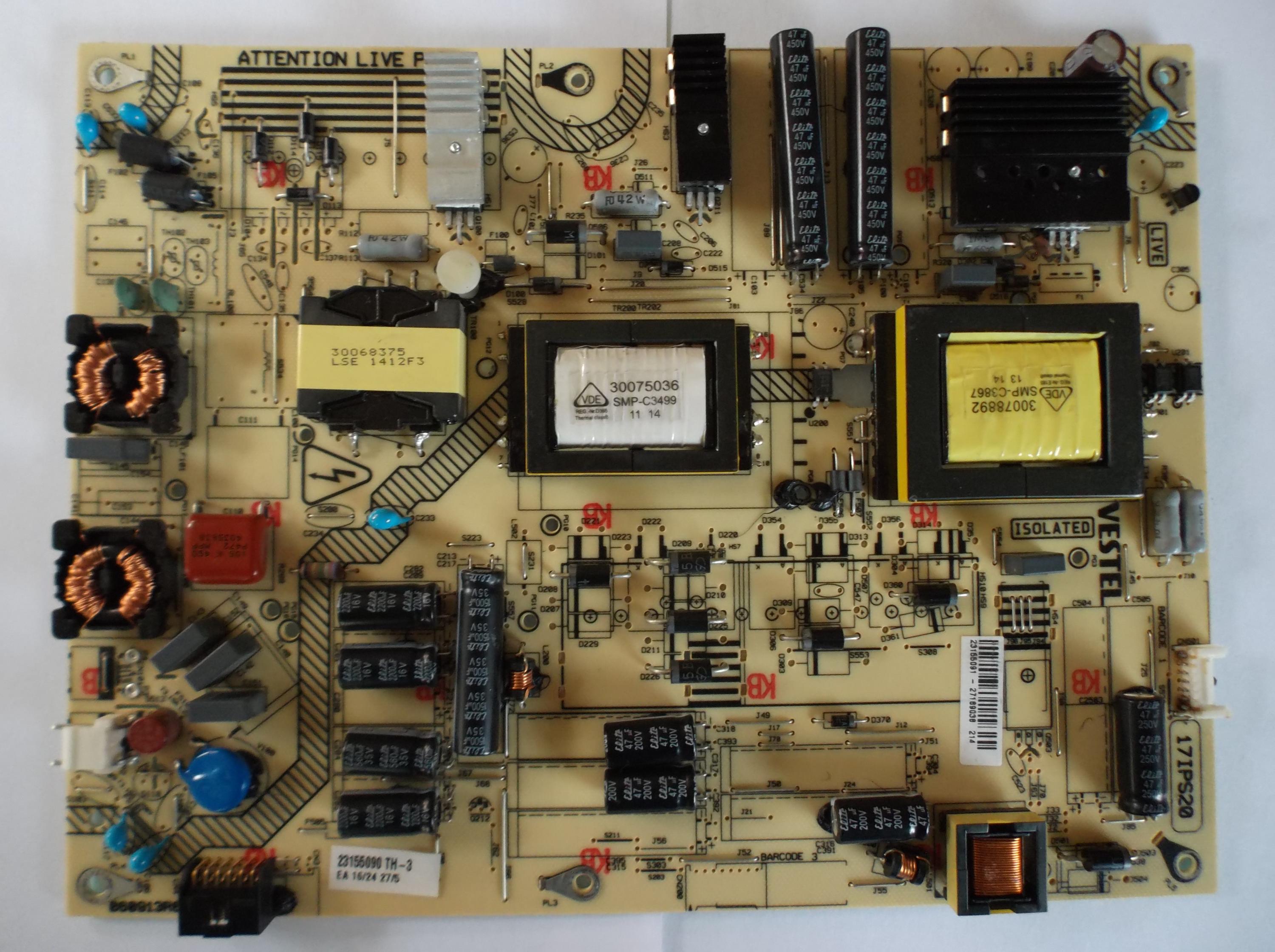

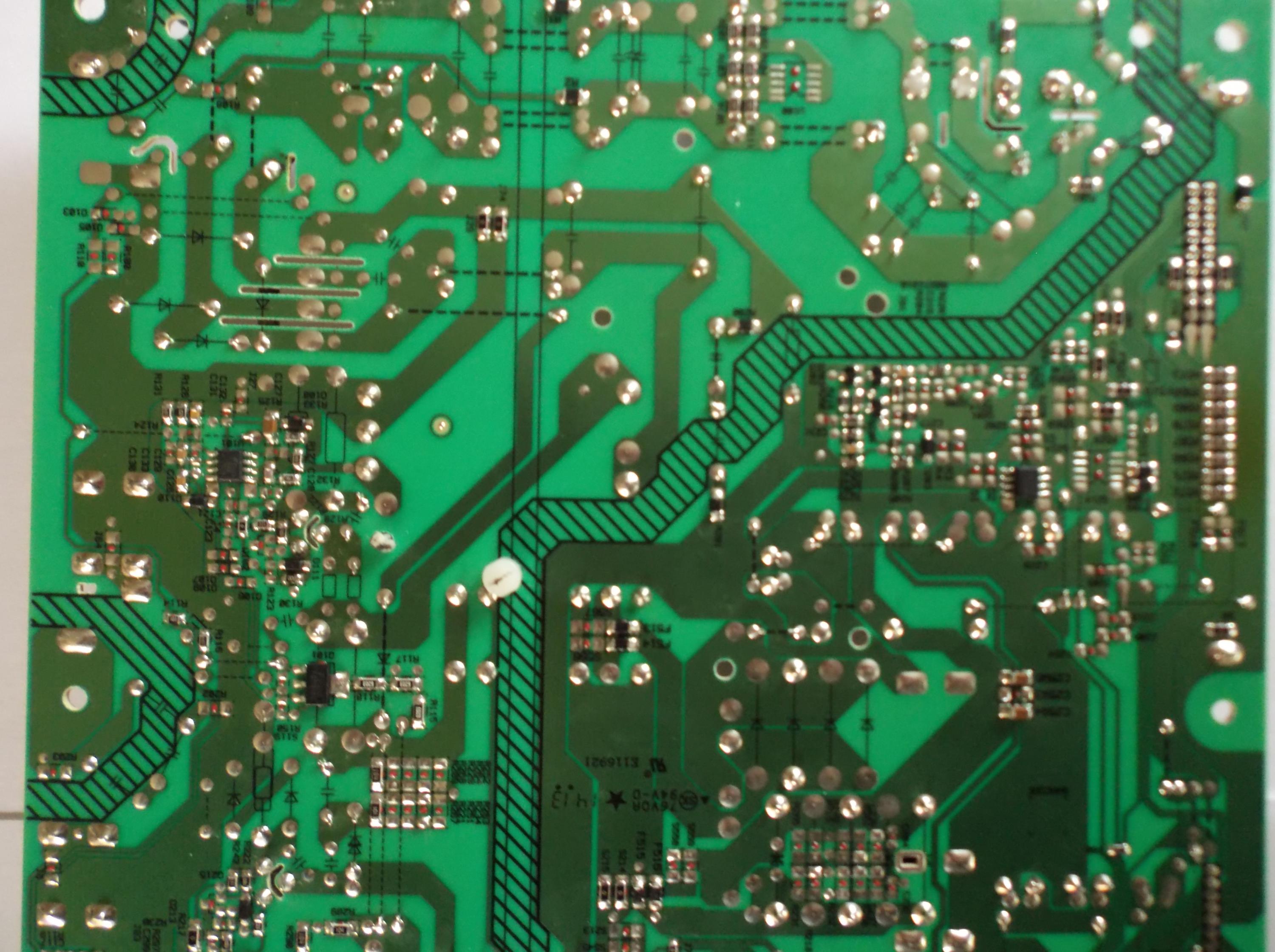

    Here are the requested photos. May come in two sends as some are not fully clear so have sent a few more to help
    • johnboy183
      • May 2008
      • 119
      #42

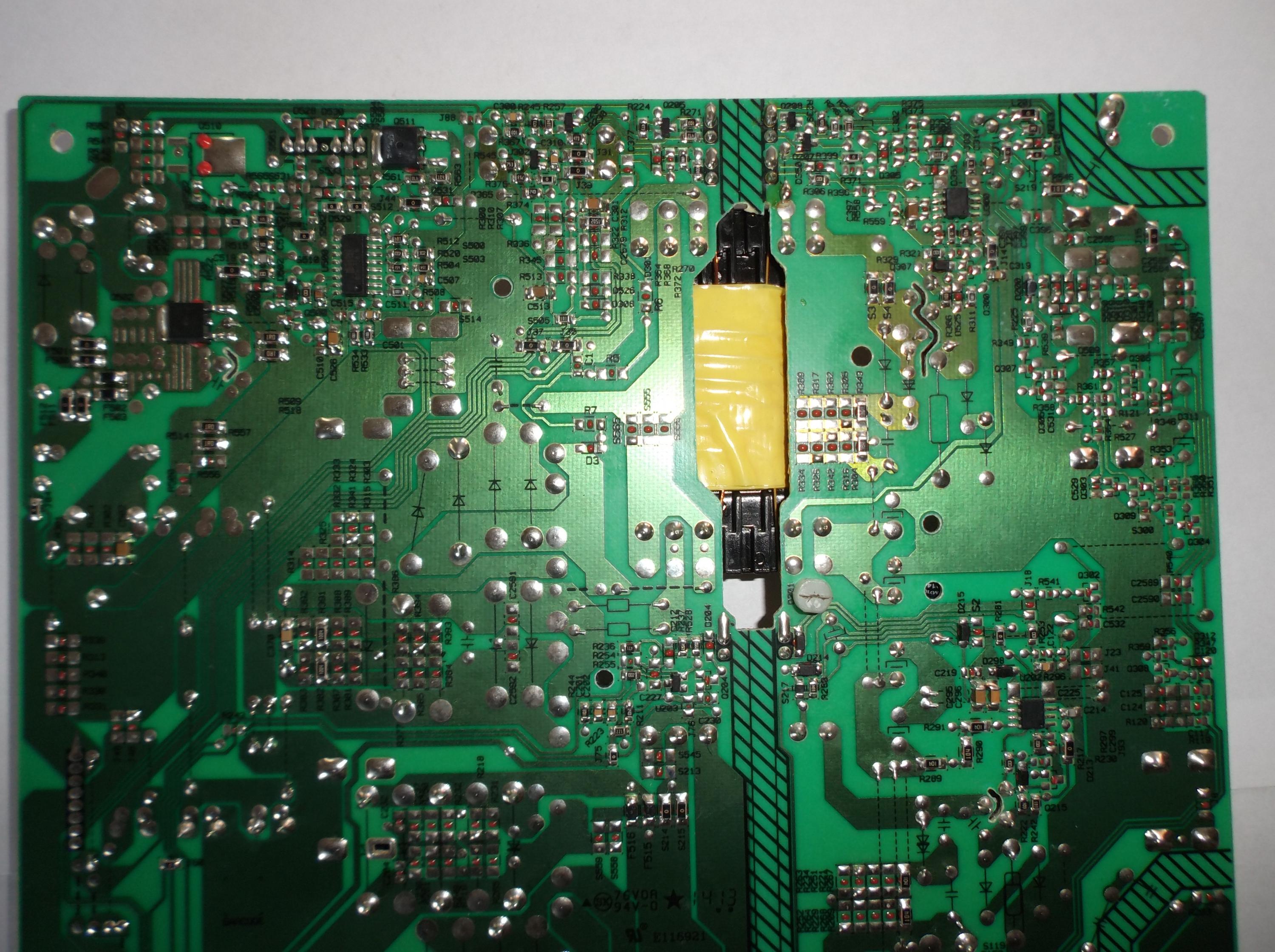

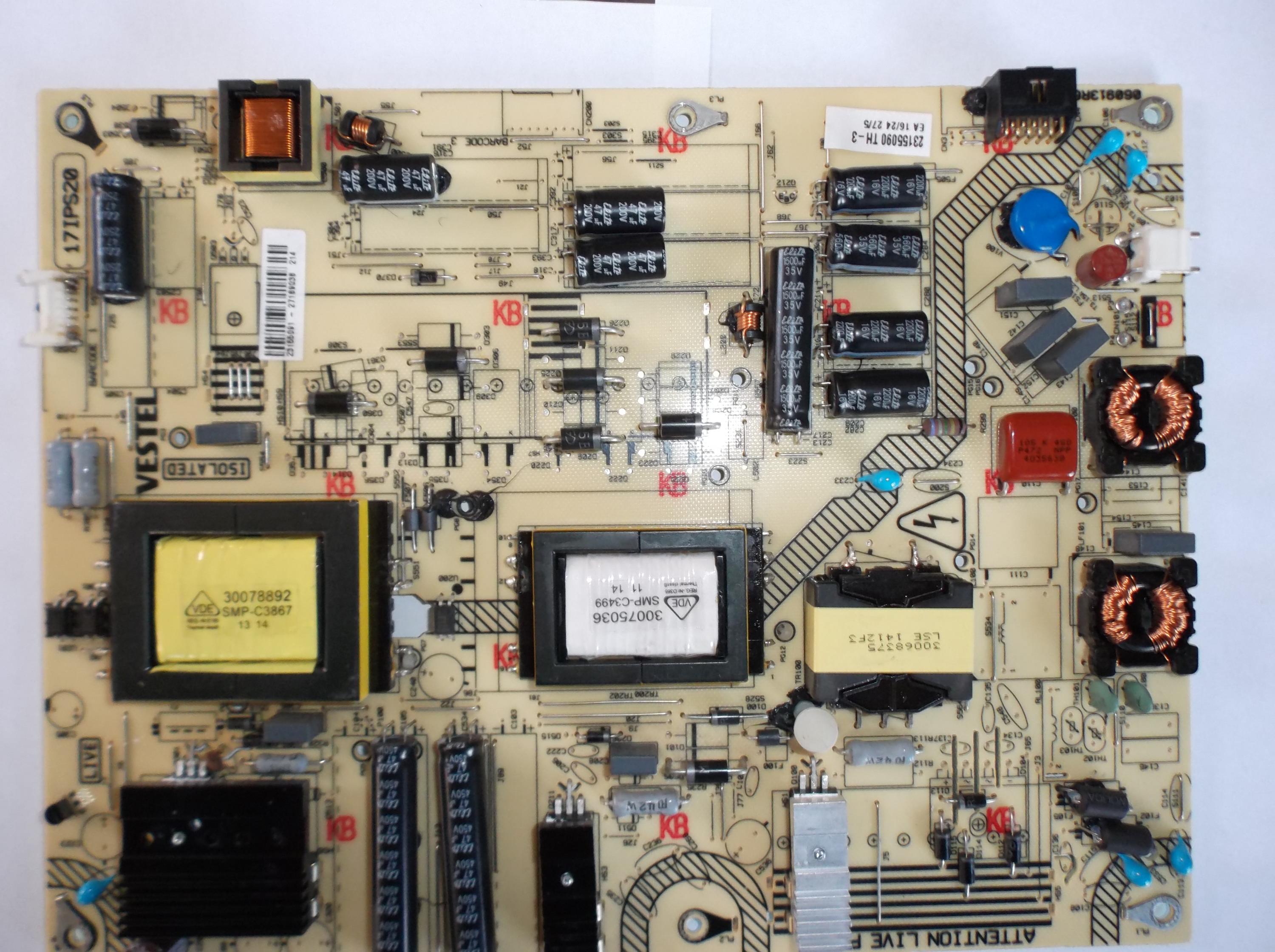

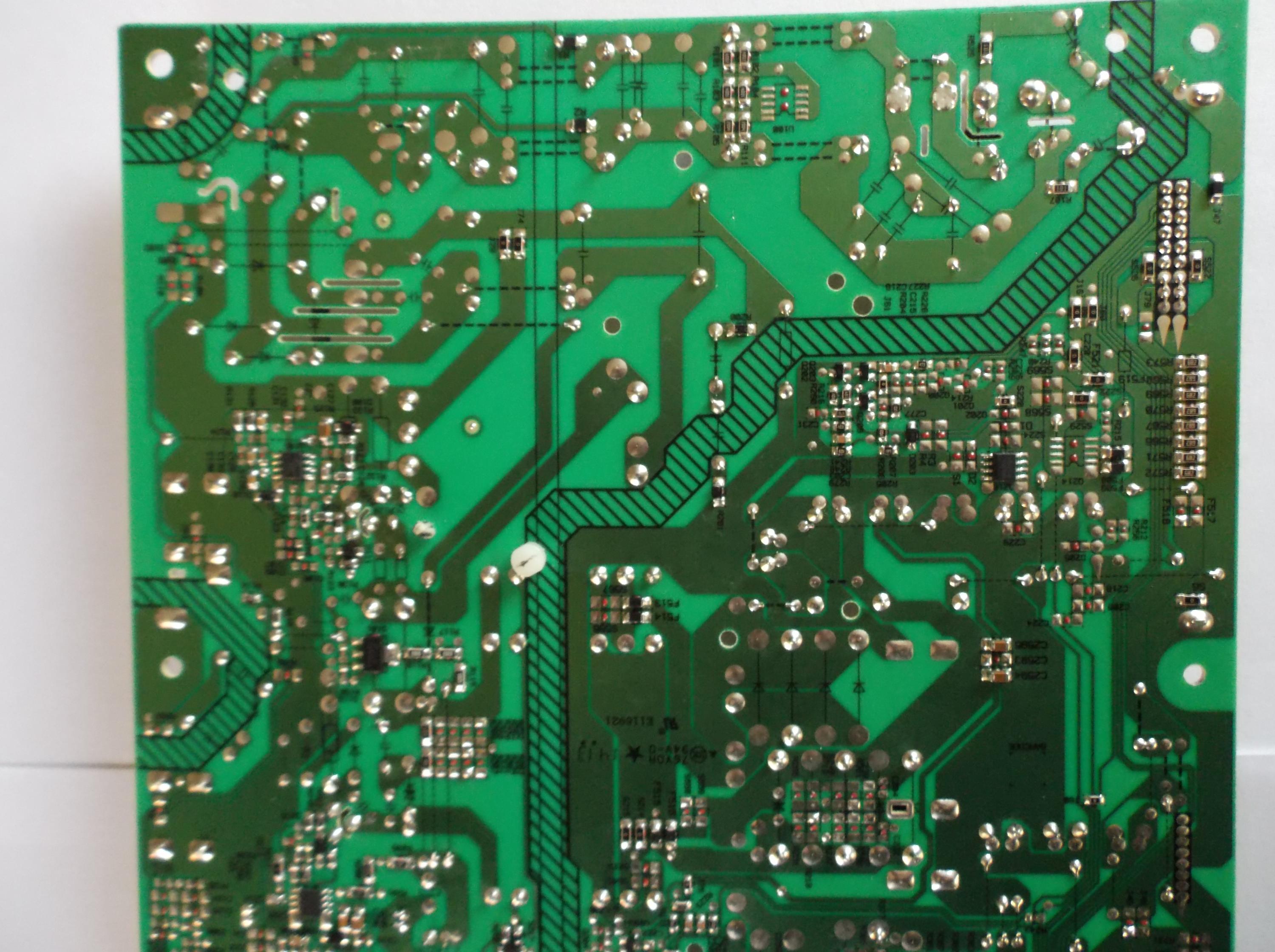

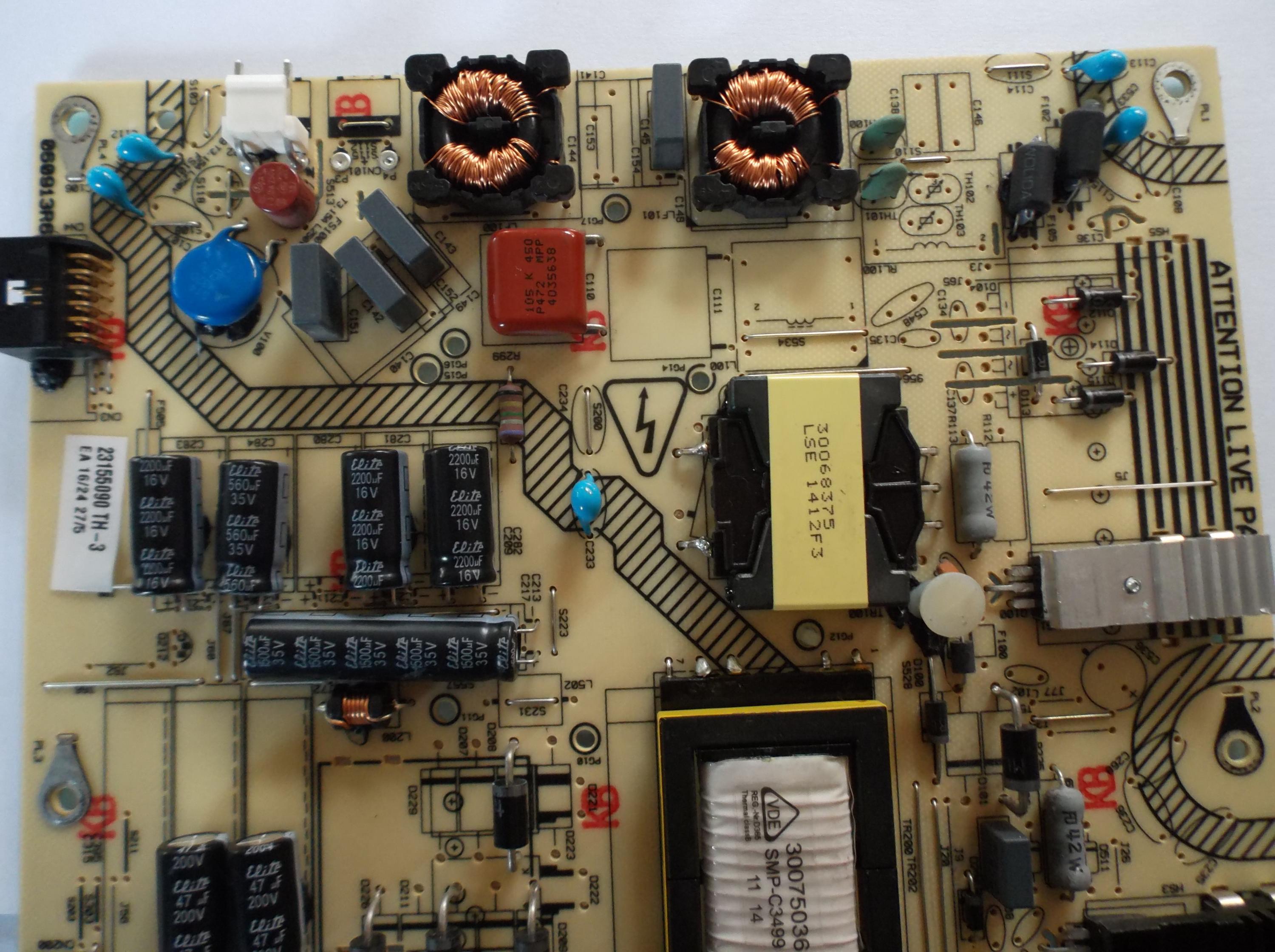

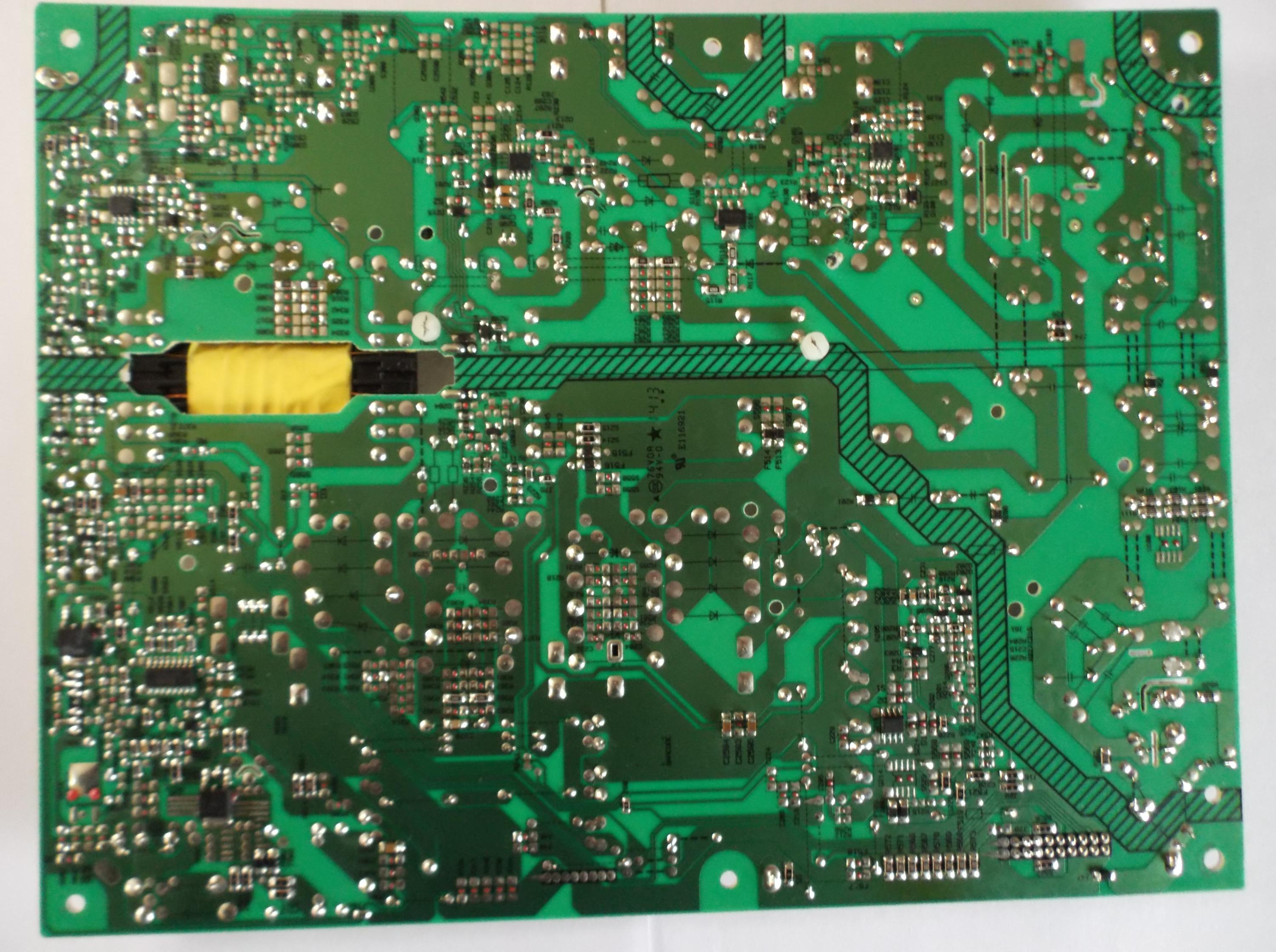

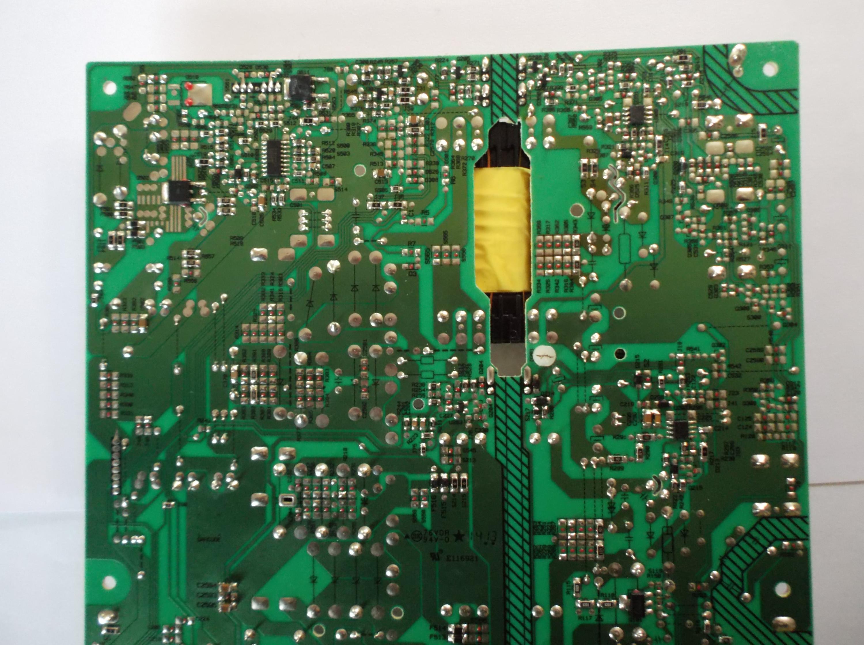

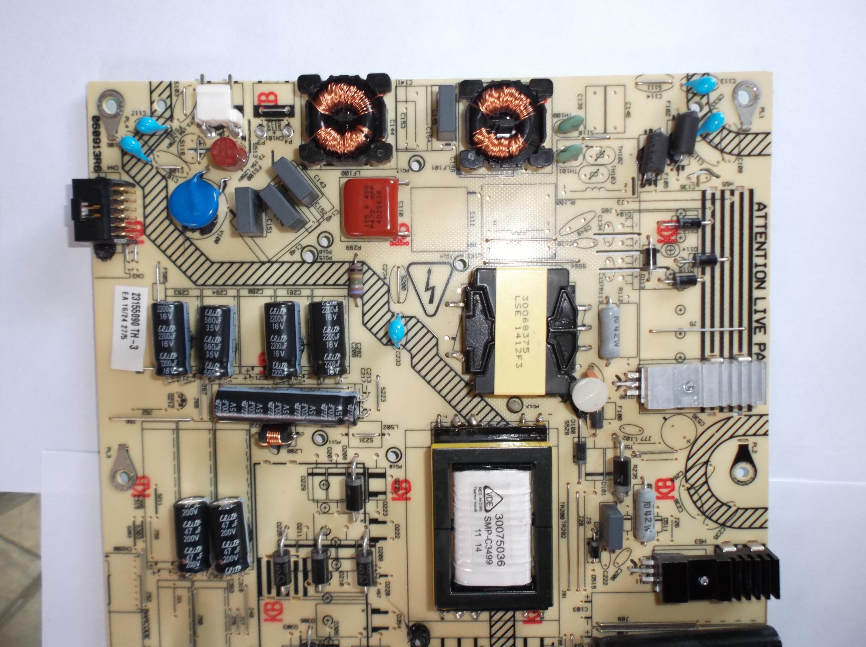

      Re: 17IPS20 No Led Voltage Solved With Video
      The rest

          #44
          BTW, after looking at pictures of your board and the pictures of OP's board in post #2, your board is not the same version as OP so the OP provides does not match your board.
          Never mind about the LED, I see that you report as 9 LED's per strip (post #35), 7 strips total = 63 LEDs..
          I am looking at many schematic versions for the PCB 17IPS20 to see which one matched your PCBA version, it looks to be PCBA 23155091.

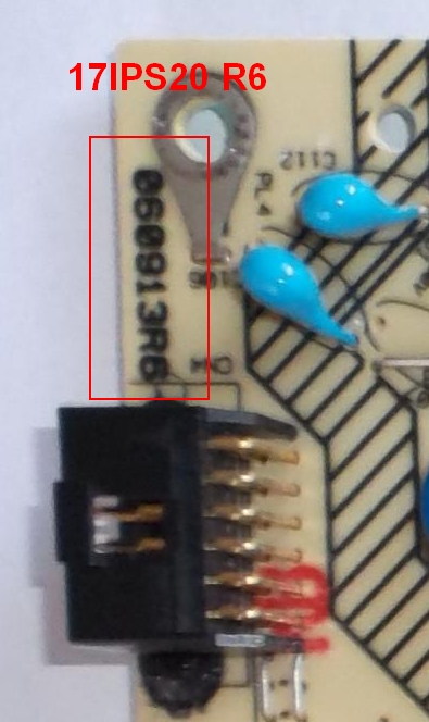

            #45

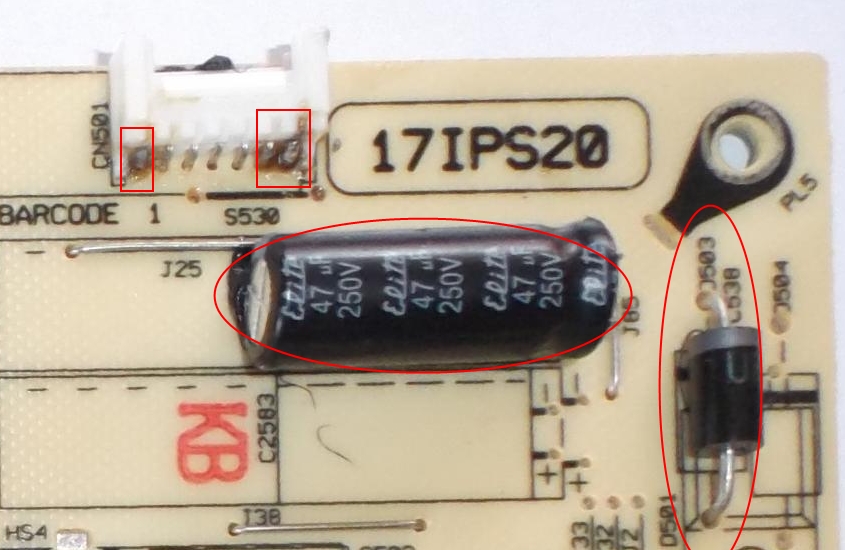

            Remove (or lift one leg off the board) D503 (LED power supply booster diode) located closed to the LED connector, then check the RESISTANCE in both directions, also check that Lytic cap next to it to make sure it is OK.
            BTW, Did someone solder the LED connector pins?
            Also after looking through your pictures your board is 17IPS20 R6, see schematic of 17IPS20 R6 attached. Notes: not all component values of your board will match your PCBA because the schematic is the Master schematic for making PCB.
