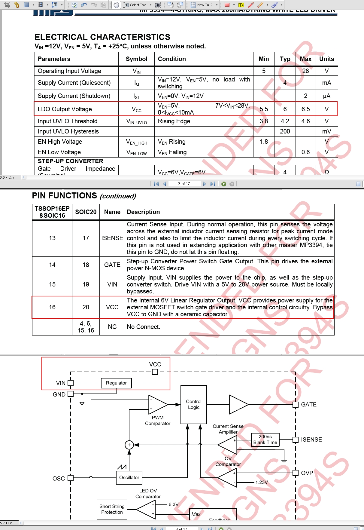

    BTW, this the info on the VCC pin 6V LDO output.

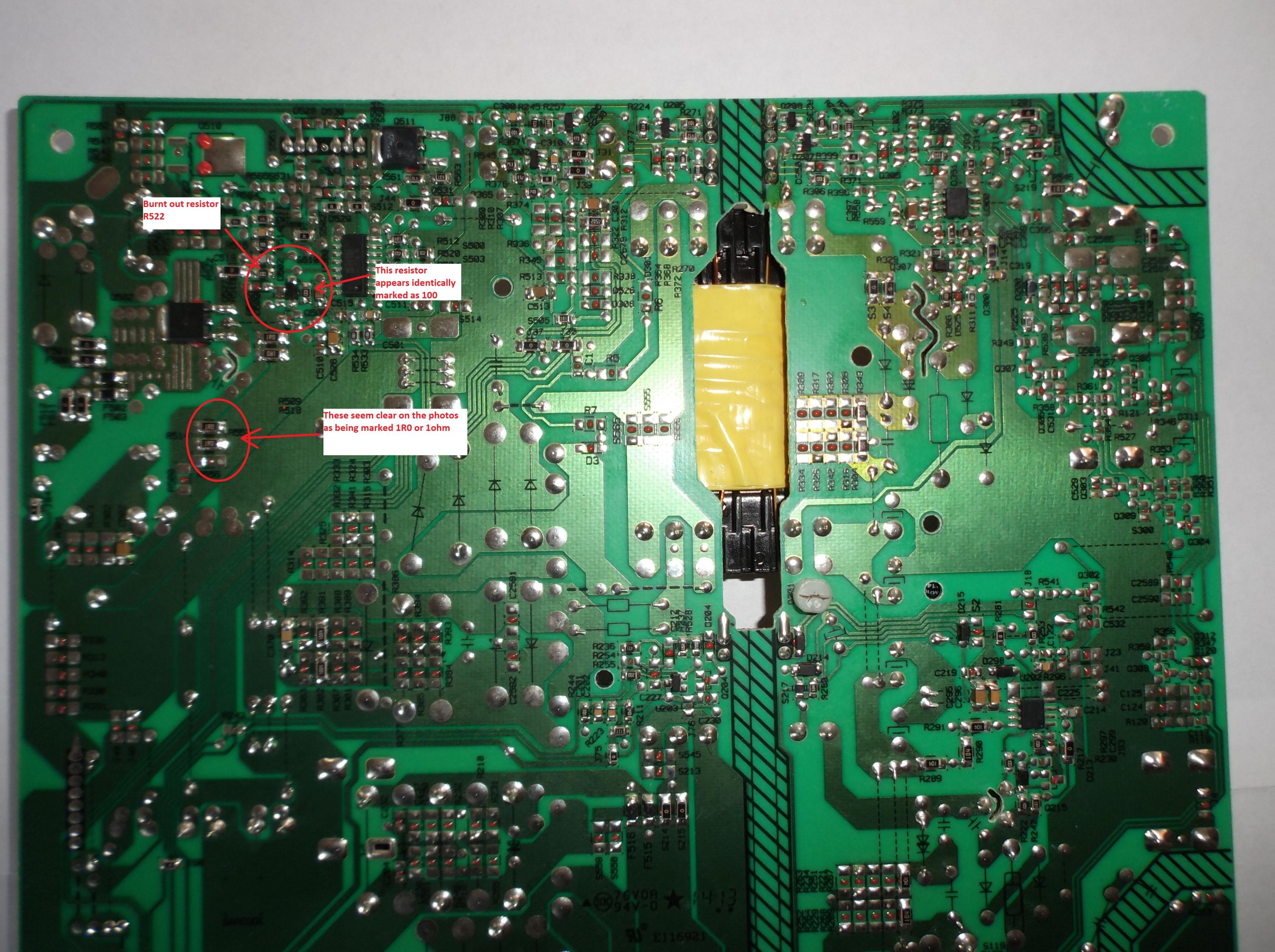

                Thanks for the points and comments.
                Fortunately I did order two MP 3394s ICs but am reluctant to just change it given the very poor pads and traces it connects to without trying the set first with the resistors replaced. If I do replace it I will probably snip off each pin at the IC then remove IC an dthen unsolder each pin from pad.
                I have attached the best of the photos I earlier sent you of the area concerned showing the resistor markings as they were.
                I think it is clear the parallel mounted resistors are marked 1R0 so 1ohm.
                R522 and an adjacent resistor (R502) look to be identically marked as 100 on the photo (highly magnified view of the board shows the burnt R522 to have only three digits and the first one is clearly a 1 and the other two digits as probably the remains of the top and bottom of two zeros).
                According to my reading smd resistors marked 100 are 10R or 10 ohms not the 330k as shown on the schematic for R522. That seems a hell of a difference between what I suspect and the generic schematic marking!

                    You have Vin so you should have the 6V on VCC as explained earlier, that should be present as long as Vin is present.
                    OK, I mess up my post #66, I was referring to R552, not R522 that burnt out as per your report.
                    R522 is connected between the Source pin of boost converter and pin 13 I_SENSE pin of U500, so for R522 to burn up, too much current has to flow through R552 and pin 13 of the IC to ground so it my mean that pin 13 of U500 is damaged, or C519 break down and shorted out, please check the resistance between pin 13 and ground to see what you get.
