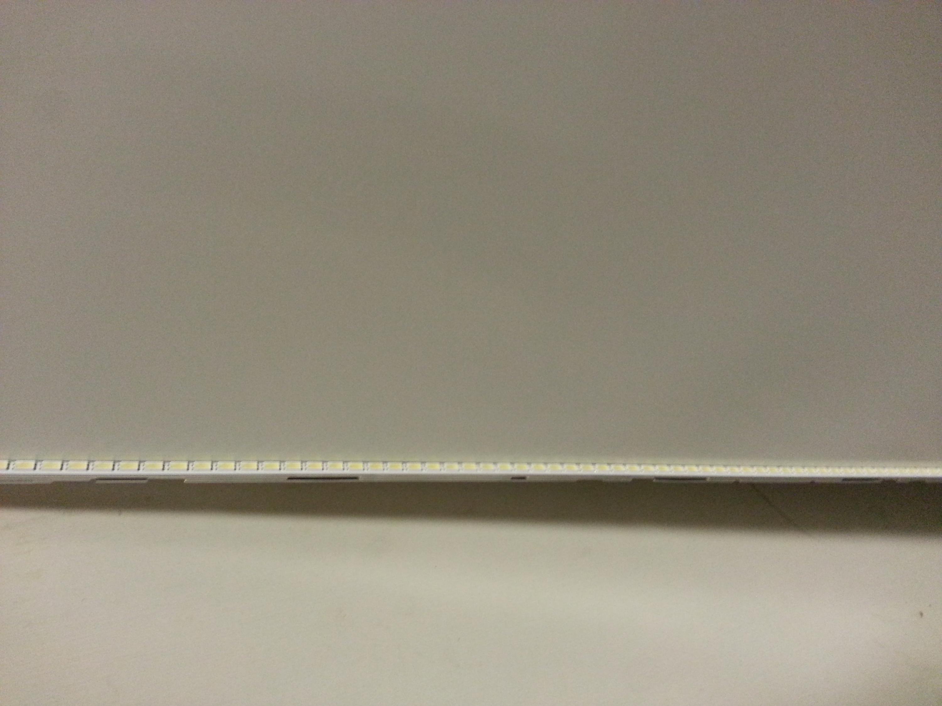

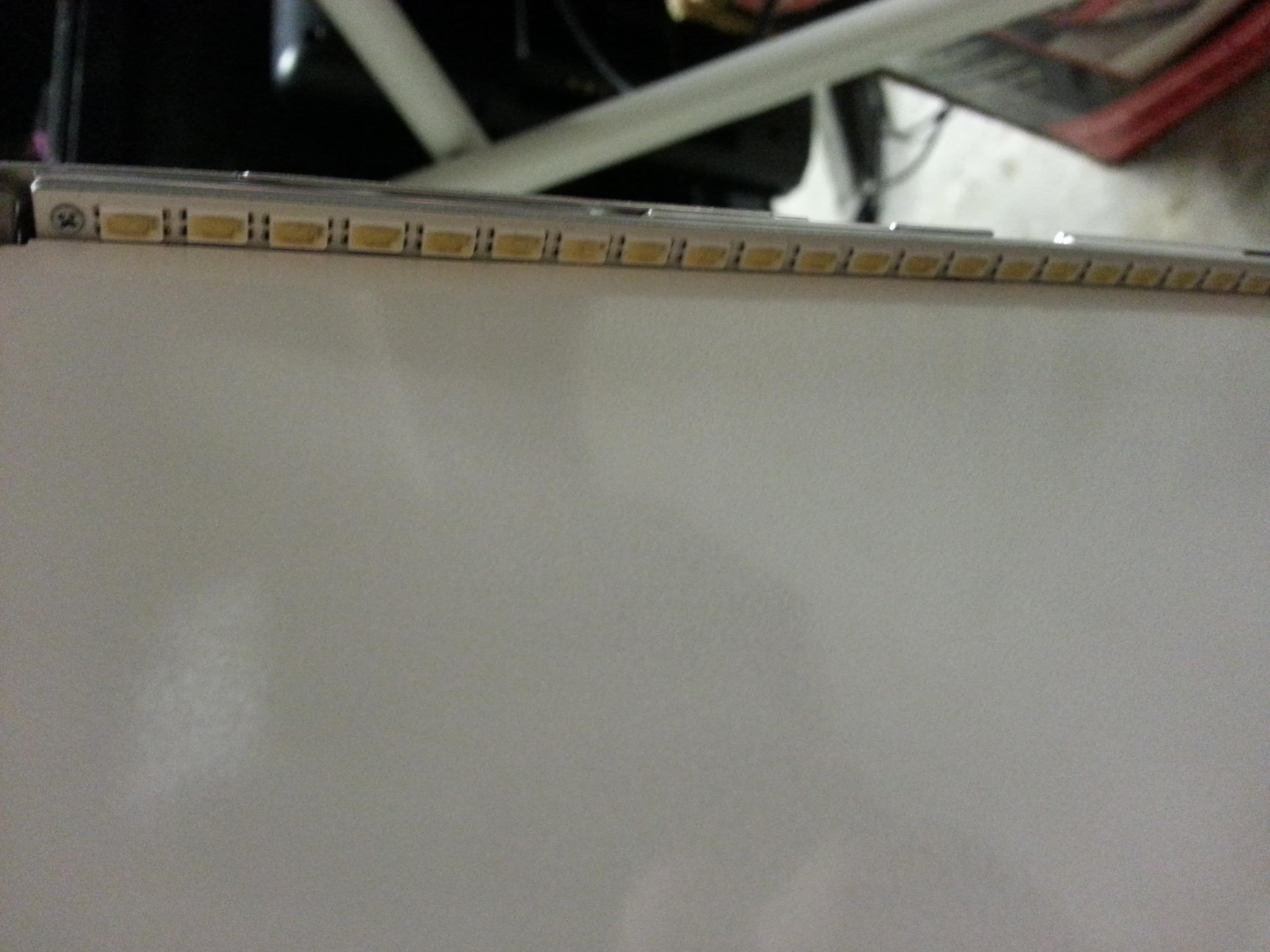

                            Finally opened her up. Pictures :-) I have about 5 bad lights maybe 6 on the right strip :-/

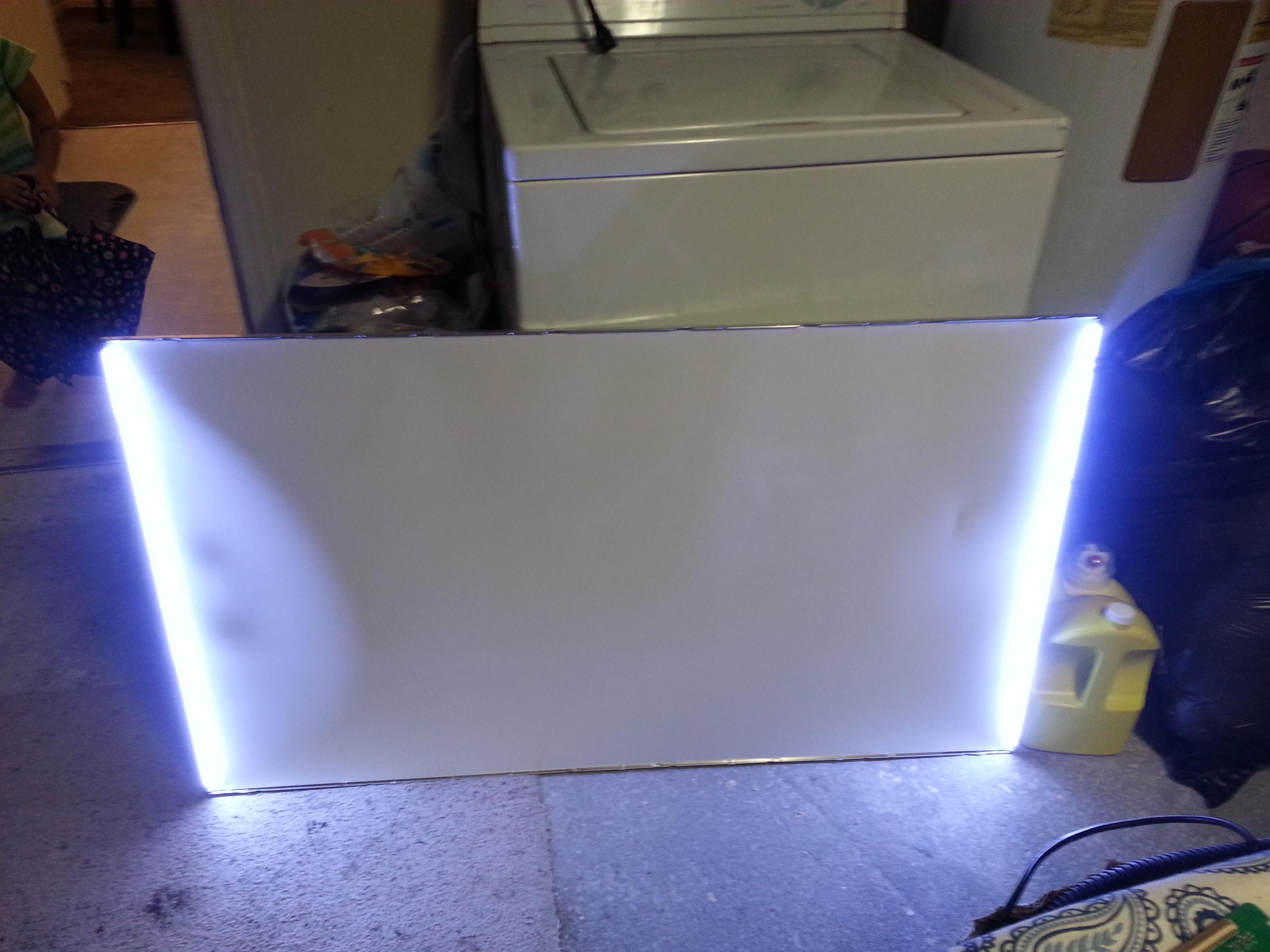

                              So I shaved down the LEDs and tined the tops with solder and we have bright lights lol.

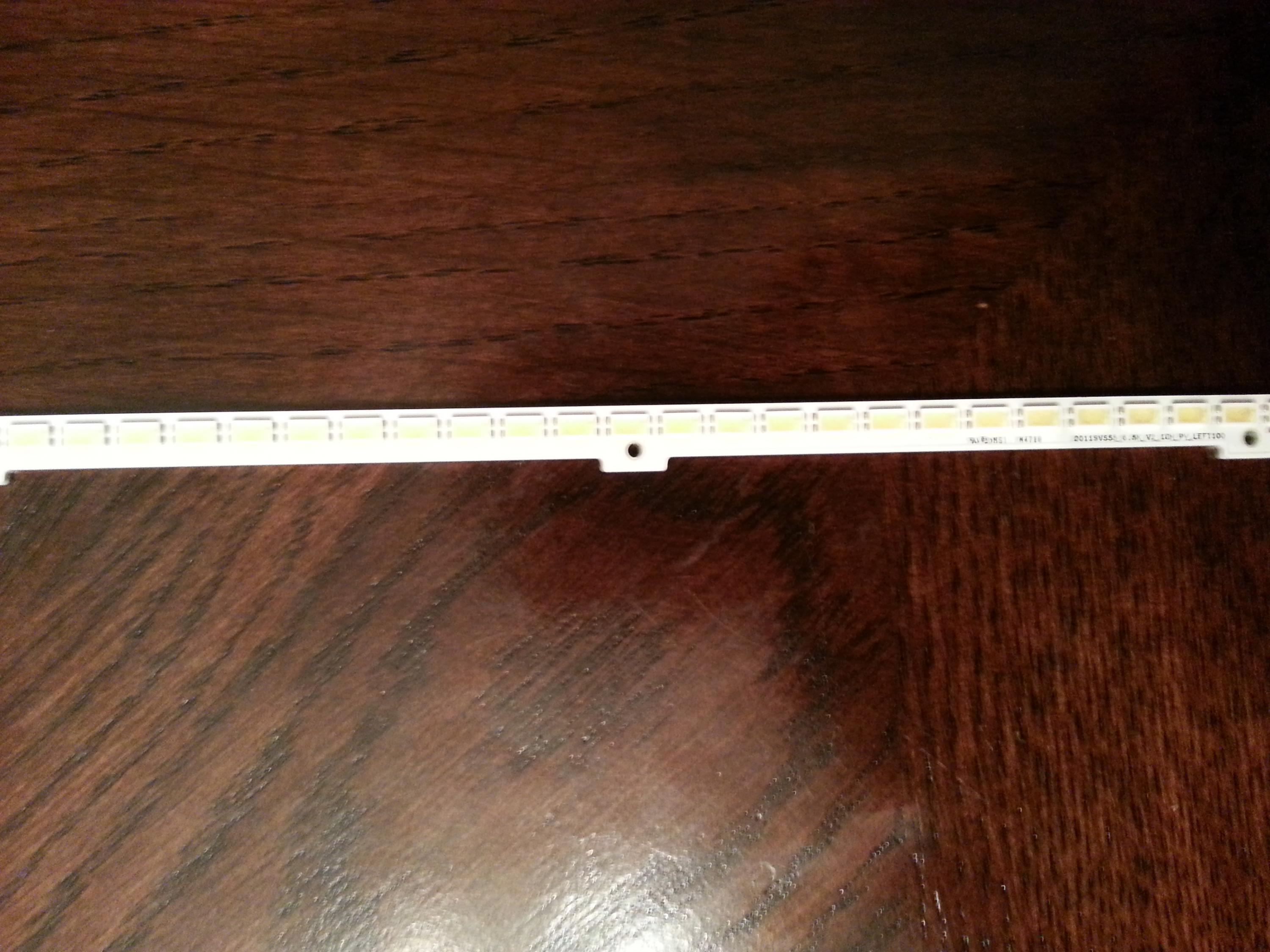

                                More Pics

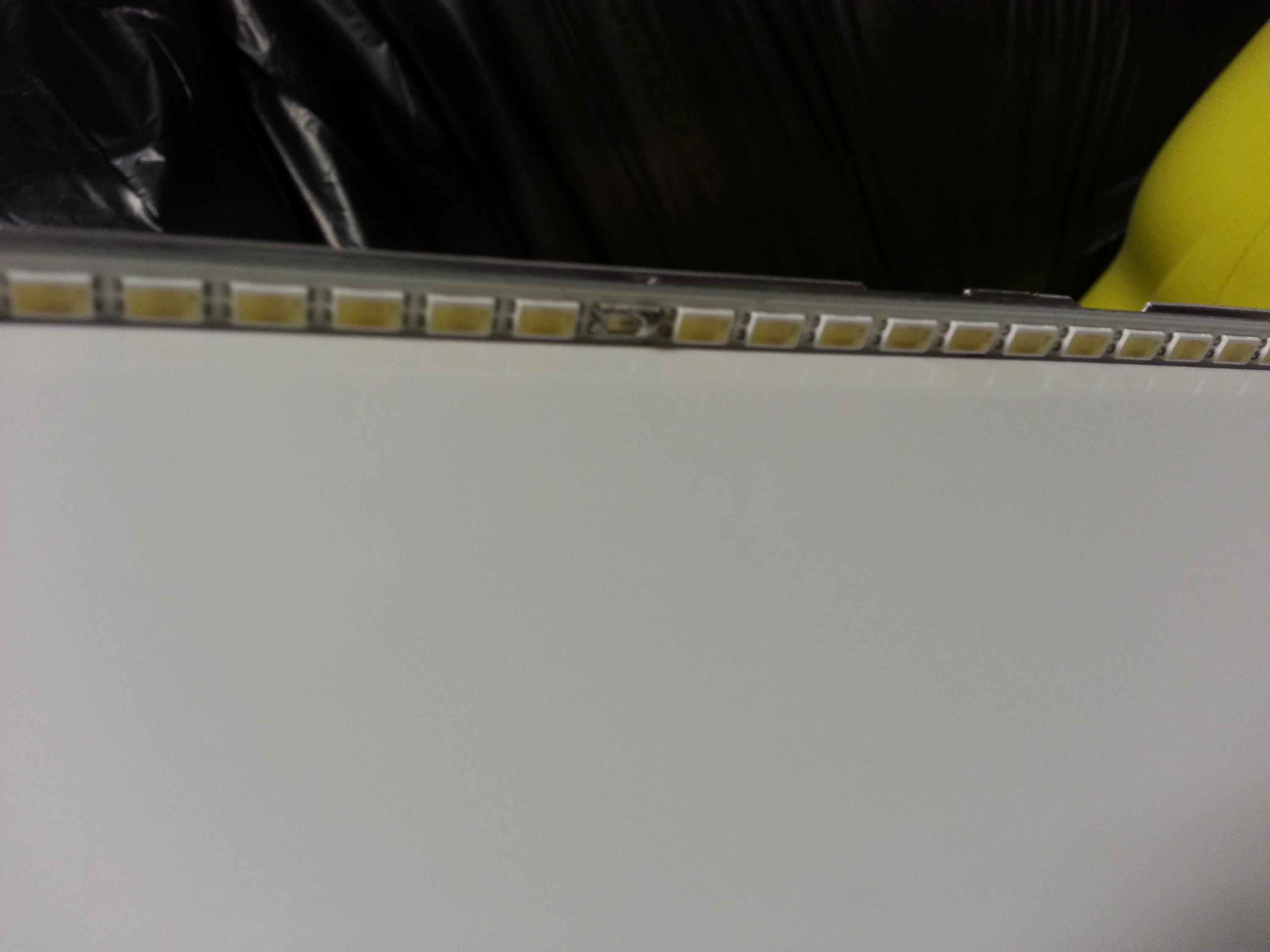

                                  #56

                                    Did you jumper out the shorted leds or replace them? The pic shows one burnt but I did not see the repair? I had a strip with 9 shorted leds and I damaged the traces trying to remove the old leds. Could we get a little more detail on the repair of the strip? I tried heat to remove them but they are glued to metal strip. I tried small sharp cutters to break the led in half and loose from strip. Not Pretty

                                      I didn't remove them. I shaved down the LEDs with a razor knife. The one's that didn't work. You can see In the picture I just took solder to complete the led by bypassing the actual broken led. I only had a couple bad lights. I mainly did this for testing untill I find replacement leds. I did find a few post on ebay with full led strips for r and l for around 100. I never removed the led. If I was to get replacements I would solder the new one's on top of the old and call it a day.
