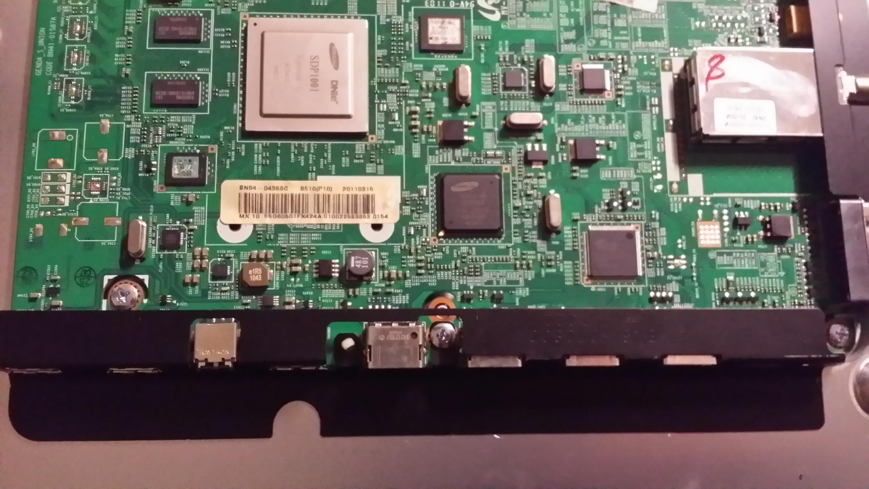

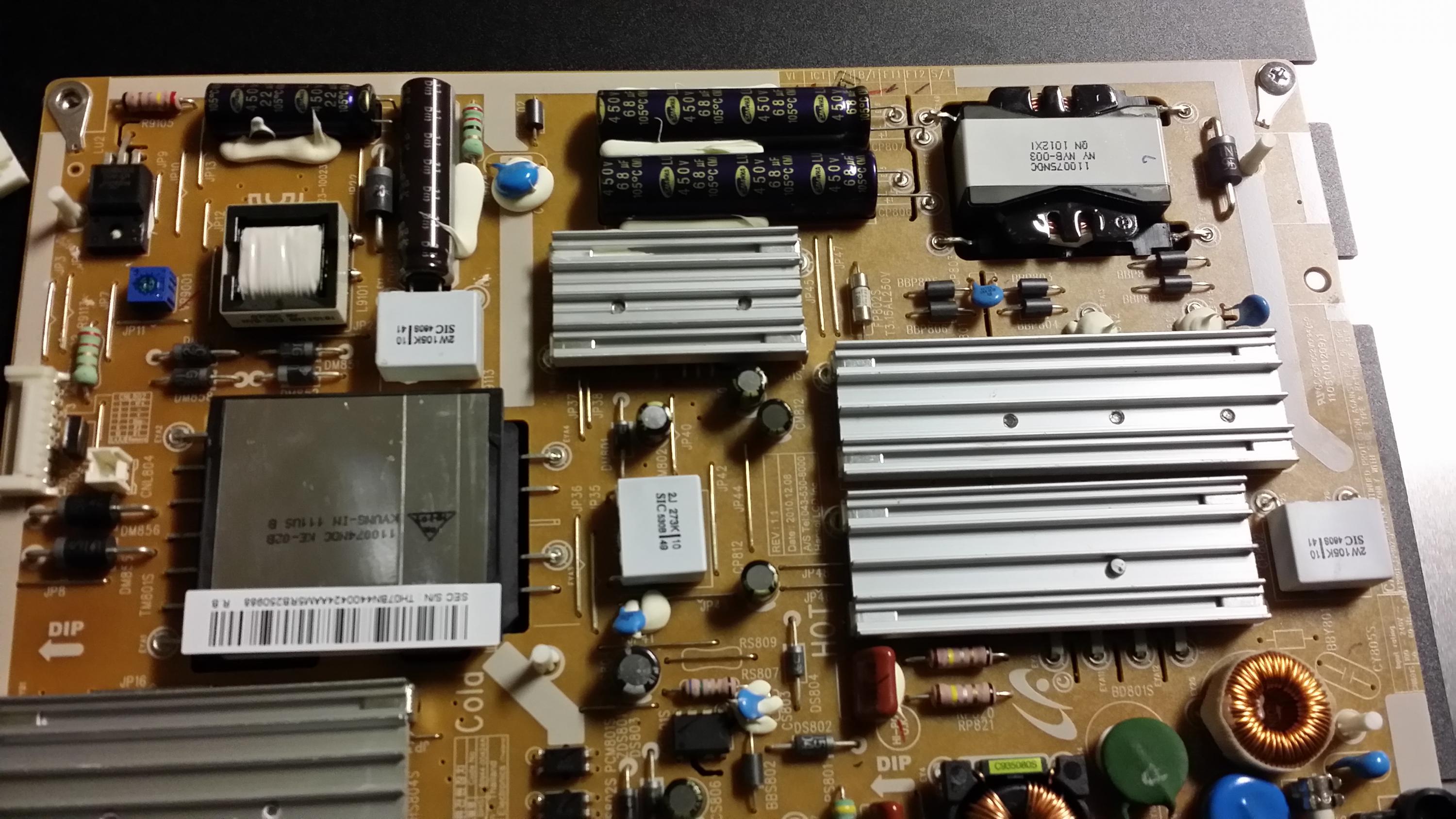

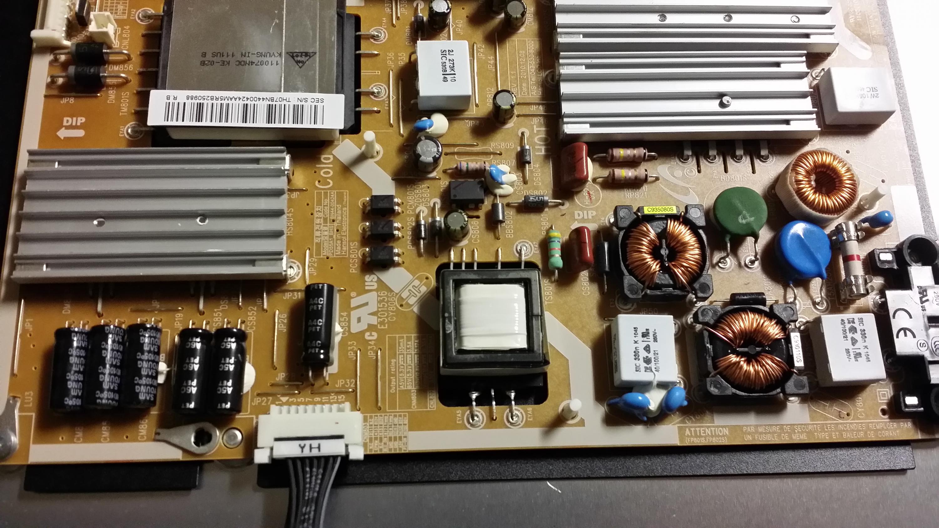

    Samsung UN55D6050TF Power Light Blinking
    I have a 55" Samsung with the power light steady blinking. I can here a weird tickin noise on the power supply. I have tested the pins on the power supply and the numbers are bounching up and down. With or without all boards plugged in. I have tried without tcon same results, with out main and tcon, with out backlight, all same results. Even the psu by itself numbers up and down. Here are the pictures....

    Re: Samsung UN55D6050TF Power Light Blinking
    Sounds like open cct / failed edge lighting LEDs. I've got a D7000 and basically it's a 4 channel backlight and any led that fails creates an open cct and the TV endlessly cycles on/off relays clicking and brief flash of the screen with the SMART logo.
    There's some guys who have done more and posted on other similar models. Some have managed to replace/repair the SMD LEDs, for mine no good, unique and they have them standingon there edge, 2 -3 yr old TV down the tube.
            Is it coming from the PSu the clicking? Does it sound like a relay click?
            maybe yours has a single bank of LEDs in series? With mine if the backlight is disconnected it also just clicks.
            What pSu part number? looks very similar to mine.
            i'm sure you'll get some other opinions shortly. I guess a bad main could do it but I think these have a common issue wit the LEDs burning out or in mine cracked solder.

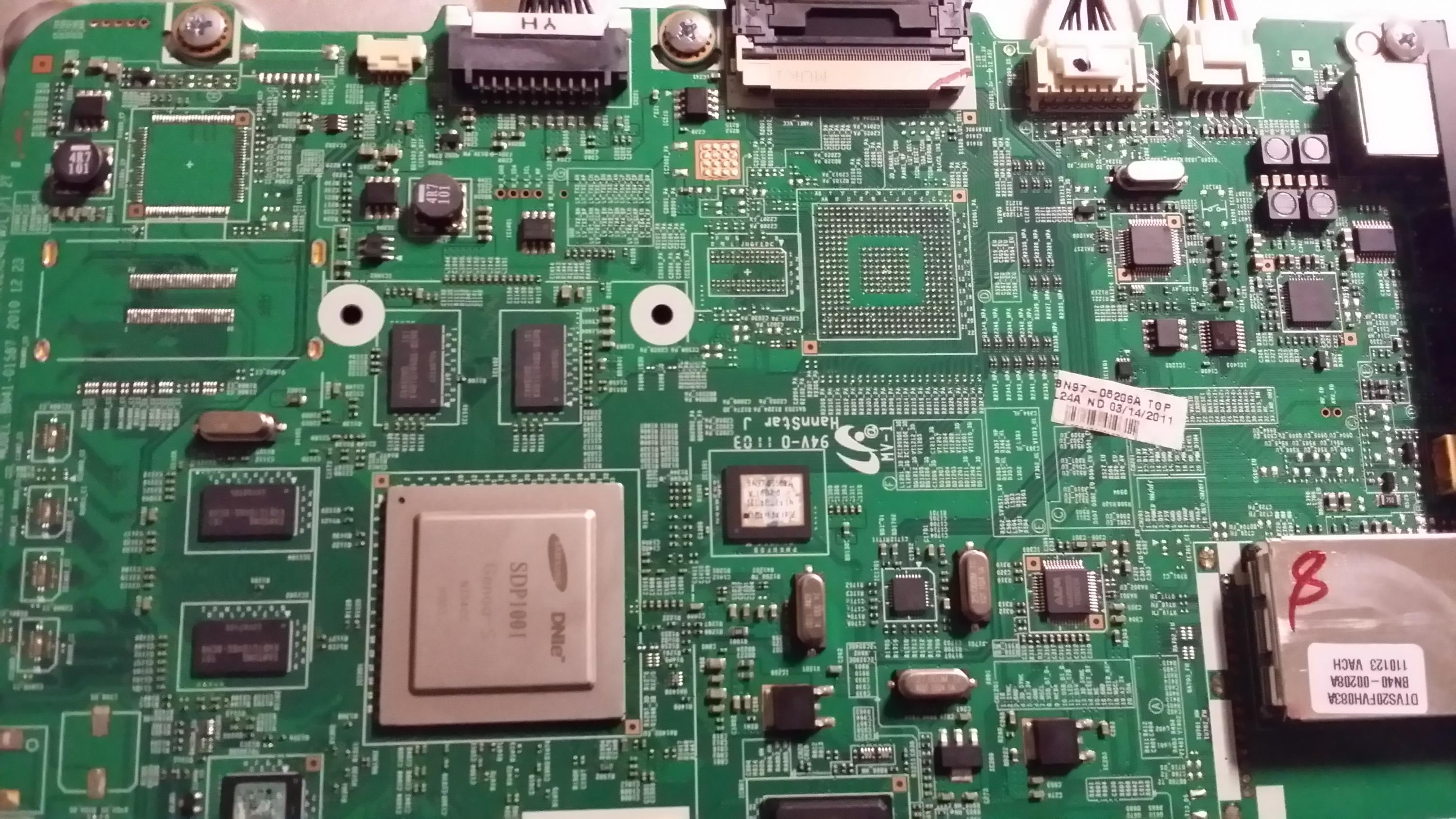

              Doesn't sound like relay clicking, I can almost not even hear it. I also read that mainboards commonly go on this set also. And if I have to get my hands dirty ill get into the leds....I have nothing to lose
                My PSU is slightly different, i can't see a relay in your shots. Mine is BN44-00428
                Try a search for un55d6000 in this forum, has the same PSU, backlight, tcon and panel

                      If your backlight harness has four wires then the easiest thing to do atm is disconnect the cable from power supply to main and plug it in. If your power supply AND baclights are working they will come on and you can probably say your main needs replacing. Report back.

                        I tried that and no. I thought the main had to talk back to turn the backlight on
