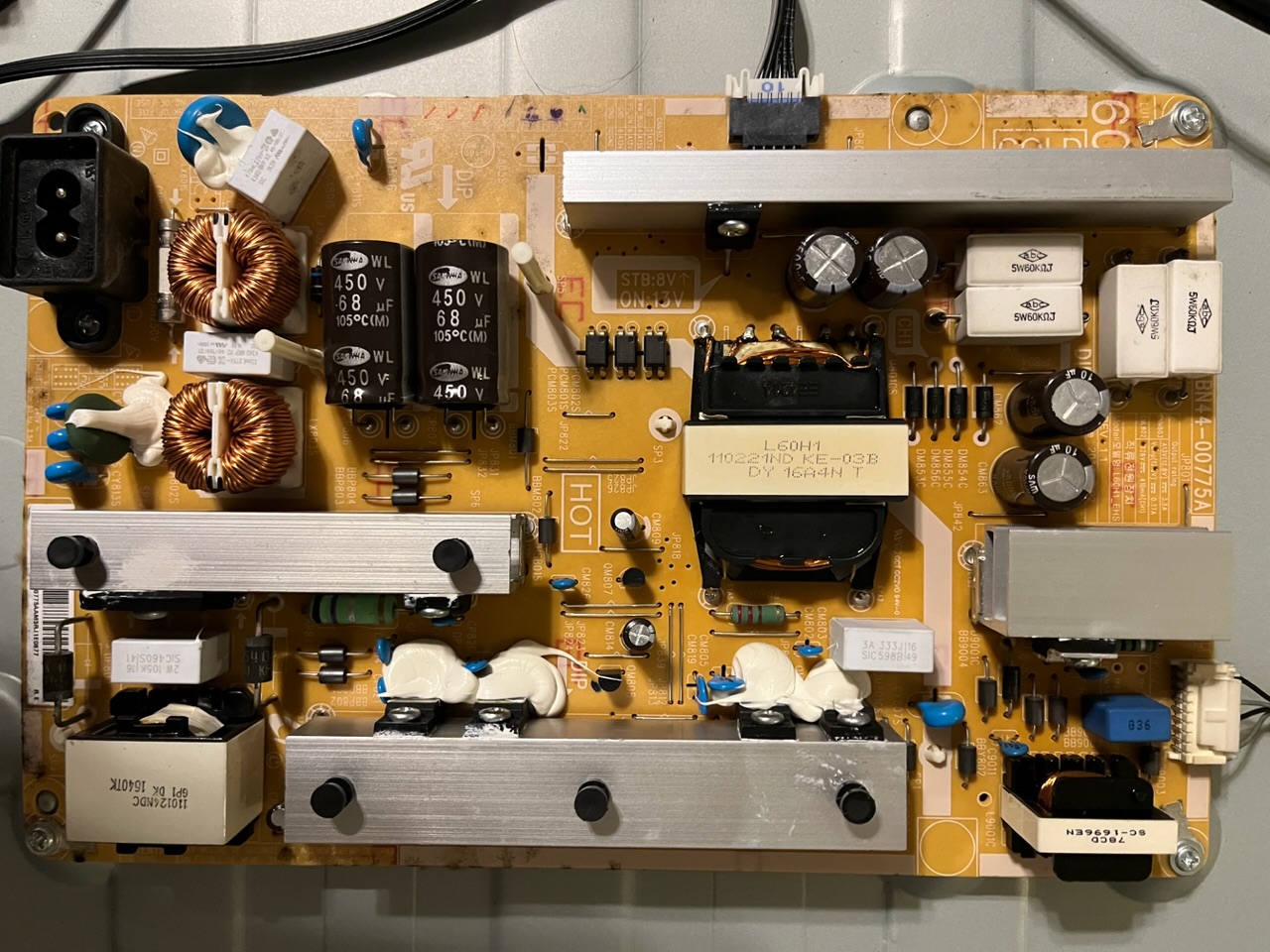

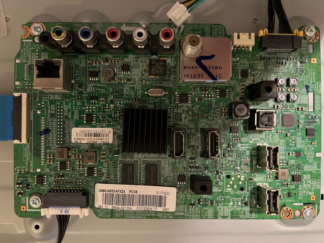

    Saved this TV from the trash but it will not power on the red power indicator light blinks 6 times with no display. I've attached pics of the power board(1st pic) and mainboard(2nd pic). I don't see any blown caps on pb like I expected so what do y'all think is the issue?

    Since the standby light is blinking, that tells me that the power supply has standby voltage. Next thing to do unplug the cable that goes from the main board and the power supply. Power up tv and the backlights should come on. If they do not, then I suspect 1 or more bad leds. If thats the issue, I would replace them all.

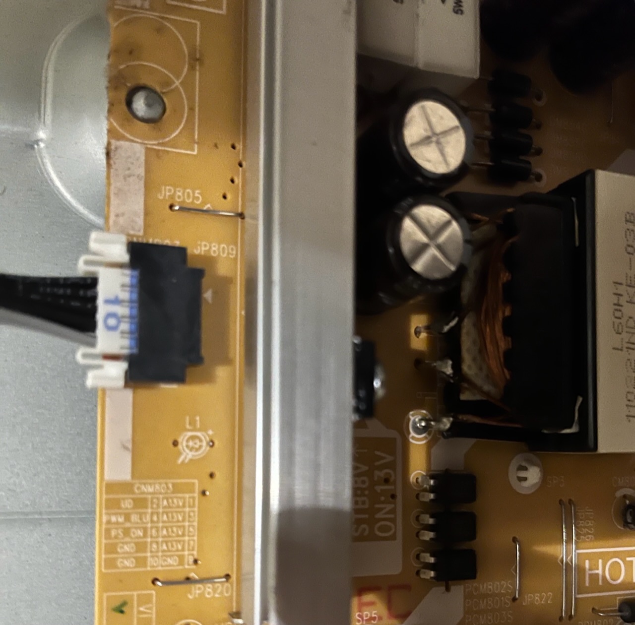

              post a picture of the table printed near the psb board connector to the main b., then check their voltages

                  Re: Samsung TV UN60J620DAF blinking power light
                  I think this is what you are asking for.

                    I've had a few blown blue capacitors on these PS boards of Samsung. So you know
                      check pin 1 & 2
                        check pin 1 & 2
                        Ok here is pin 1&2
                        2.2 v
                        12.4 v

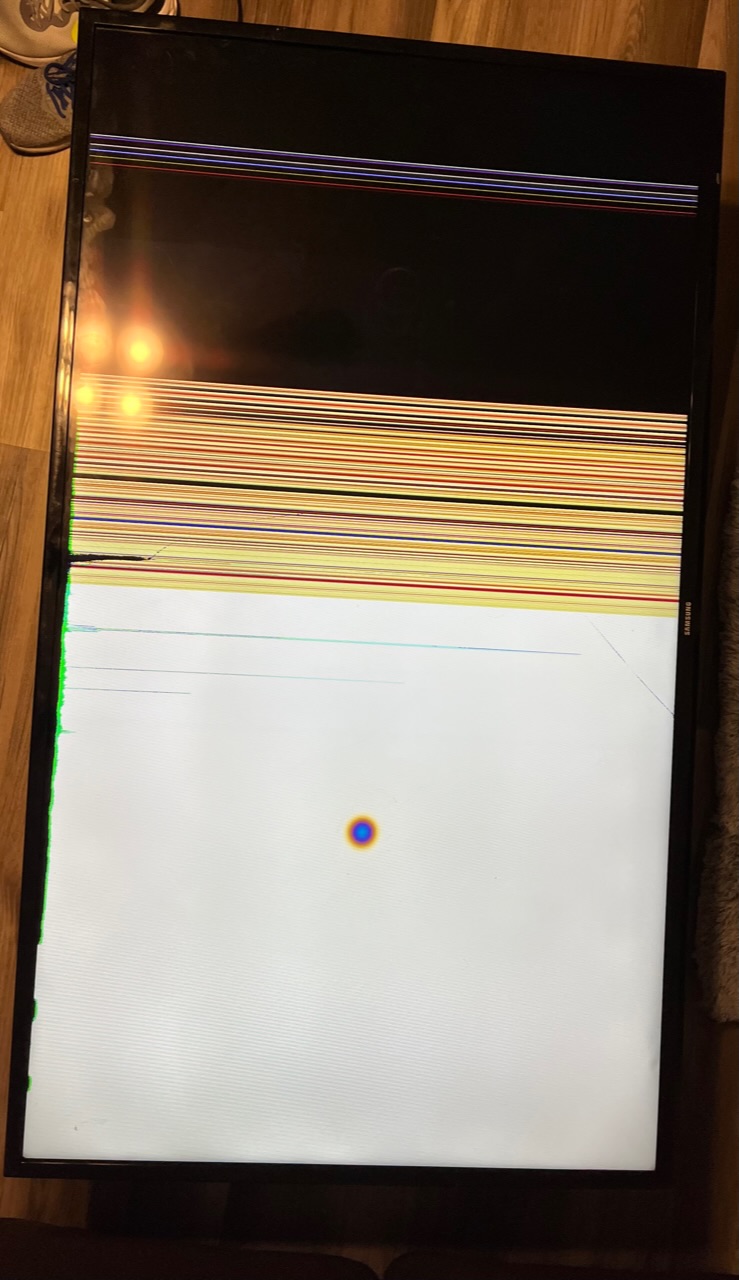

                              So I replaced the led strips and see why its best to replace all, 1 strip had all working. Unfortunately it looks like the people who put it to the road dropped the screen. oh well
                              My 50" LG tv backlight just went out so that'll be my next project. Is there a way to see if the screen is busted before replacing parts?
                                Very easy, watch it very carefully at bright light when OFF.
