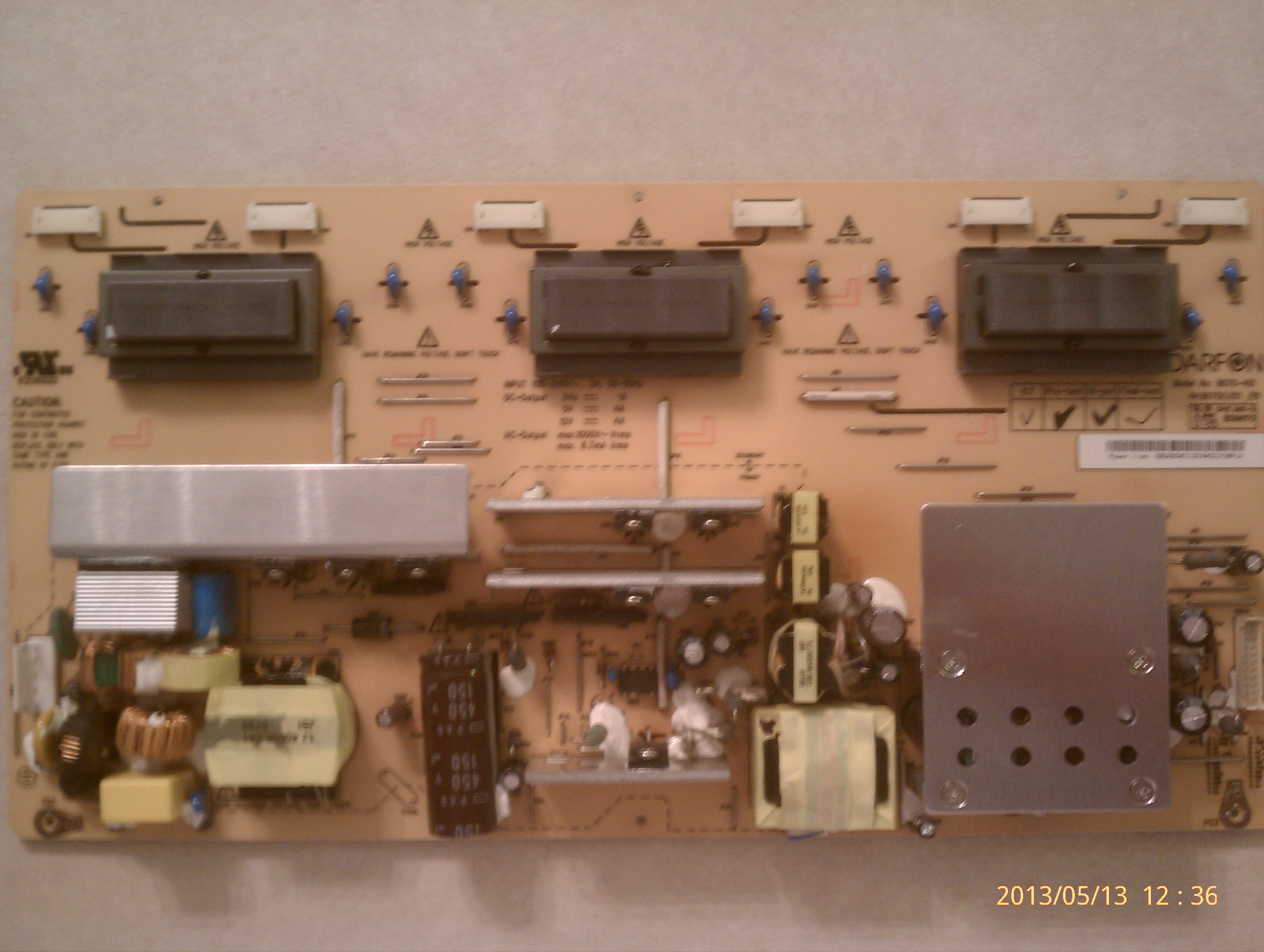

            #45
            Re: Westinghouse SK-32H240S Continued problems
            hello everyone, same symptome here. I have replaced a fried transformer to only get two seconds to black symptom. I have a fair amount of experience with lcd tv's, fixed many with many differnt problems.
            This unit has darfon B070-401. I replaced a burnt transformer. Unit still went back into shutdown mode. Cause appears to be inverter chip LX1692. All ccfl are good. The ccfl chip has a pin that connects to cap and works as a timer to transistion between ignite and run mode. The chip has an internal current source to charge the 2uf cap. when voltage rises avove .5 v the overcurrent protection is enabled, when the voltage rises above 3.5 v the overvoltage fault is enabled. By bypassing the cap with a 1 meg ohm resistor I am able to prevent the voltage on the pin from rising over 2v, this prevents the overvoltage fault from being enabled. I do not know if the controller exits ignite mode or not. However, with this bypass resistor installed, the lamps will all stay lit. The odd thing is that the overvoltage input voltage does not appear to exceed the threshold at which the fault should be triggered.
            Anyone have any suggestions, I cant tell why this thing keeps shutting down or why bypassing the timer cap to prevent over voltage fault will cause it to stay on. I think something besides overvoltage is also changed or disabled, but dont know what. Unfortunately it is not safe to leave the 1 meg resitor installed, as it wont shut down on open lamp or high voltage arc. this could cause a fire.
            Does anyone have a schematic to show what is going on for the protection on this board. I looked at the datasheet for the lx1692, but it only has an example of the single transformer application. this unit uses three transformers, so there must be an op amp or other circuitry inbetween that converts the fault signals from all three transformers to the info that is used by the chip. The voltages that come from the high voltage feedback caps range between 24v to 30v peak to peak on a sinusoidal waveform. no caps are shorted and voltages appear to be fairly consistant.
            I have a feeling that replacing the other two transformers may solve the issue as the old ones are not matched perfectly tot he new one. I really want to understand how the protection works and why this small difference triggers the fault protection. Really I cant be shure which fault mode is being triggered, or if the chip never enters run mode. From the datasheet of the driver, I cant seem to determine why the the thing shuts down.
            Does anyone have a detailed schematic, this thing is driving me crazy!

                    One thing Ill mention is this TV shuts the backlight off in about 10 seconds when there is no input connected and that could throw you off if you don't know that
                    TV1 was fixed with replacement of T3 (open secondary winding), and replace C611 (470uF 25V), C710 (1000uF 10V) both bloated.
                    TV2: T3 and C710
                    • kevinm34232
                      • May 2012
                      • 1884
                      #50
                      TV3: T3
                      TV4: T3
                      TV5: T2
                      I see a pattern here, Im out of transformers for the time being..

                                    I have received 10 more transformers from China which I got much cheaper.. Replaced the first one and TV shut down backlight. Tried another transformer same thing. Tried another one of the TVs same thing.
                                    Checked ohms readings on secondary windings they are all over the place. 3 were close on both sides, even those wouldn't keep TV on although they seem to test fine. I finally took a known good transformer and put it in the same place and it was fine.
                                    I know there have been others who had same shutdown issue after transformer replacement so maybe same batch, beware... I guess you get what you pay for in this case..
                                          I am so frustrated! I purchased an entire set of 16 replacement caps to put on this board, and I am still getting the two seconds to black problem. I have also replaced a blown fuse, and a fried transformer. I do not see any other components on the board that have any signs of damage. Is there something I am overlooking? Could the new Transformer still be part of the problem, or could I still have another transformer that is bad but just hasn't totally fried yet? I am at a loss, and would appreciate any other thoughts or suggestions. Thanks!
