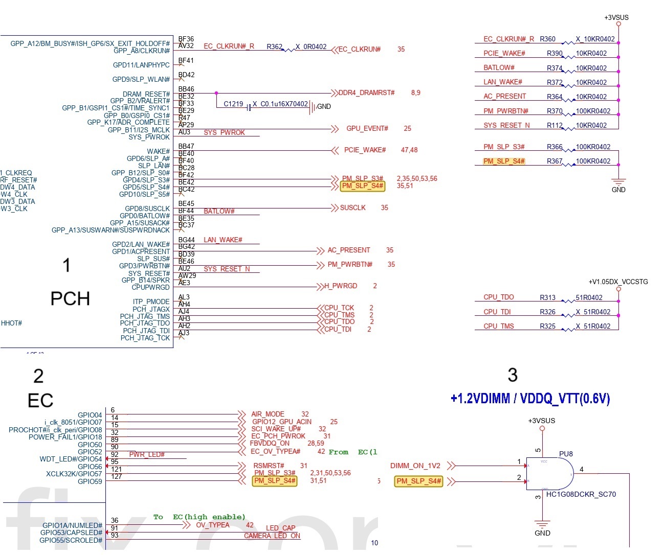

    Hi, I'm working on a MSI laptop, Motherboard number MS-16W11, GF-65 Thin 10SDR-459US. Went to another shop because the screen was flickering, but it was working well on an external monitor. The LCD was ordered and the laptop was returned to the customer and it no longer worked. It was then sent to another tech (by the shop who ordered the LCD) and the EC (ENE KB9028Q) was replaced with a donor from another MSI board with different board number and no programming was done. It looks like work was done on PU6 (TPS51225) as well as one of the GPU mosfets was burnt (I removed all three GPU mosfets).
    I ordered programmed EC chips from China and I also purchased a RT809F in the event that I needed to program the chips.
    When I install the EC chip the laptop did not power on. It draws 30mA then 50mA when I press the power button and after 10secs it drops to 20mA. If I connect the battery, it draws 490mA and the battery charging light comes on.
    I'm using known good RAM and a new RTC battery.
    There is no voltage on any of the coils but I do get 3.3V at the power button.
    I tried reading and writing a downloaded EC image but I keep getting verification errors, I read and compared the hex files and they were different so I believe the programming failed. I suspect that the tracks from the keyboard connector to the EC is too long. Since I ordered more than one chip, I replaced it and I'm hoping it's the correct firmware.
    My first question is does battery charging indicate that the EC is working AND has the correct firmware and of course, any assistance with this case is much appreciated.

          I did start going through the power sequence and PM_SLP_S4# is not coming up. All other stages before are present for about 10 seconds after the power button is pressed.
          1. PW_SW# = 3.3V (SW1)
          2. SUS_ON = 3.3V (PU6)
          3. +3V/+5VSUS = 3.3V/ 5V both present for about 10sec (PU6)
          4. +1_8VSUS = 1.8V (PU20) NO STUFF, near PCH on side with USB but 1.8V present on pin 5
          5. +1.05VSUS = 1.05V (PU14)
          6. SUSPWROK = 3.03V (PU14) and U25 pin54
          7. RSMRST# = 3.3V (U25 pin95)
          8. ACPRESENT = 3.3V (U25 pin108)
          9. PM_PWRBTN# = 3.3V (U25 Pin 117)
          10. PM_SLP_S4# = MISSING (U25 pin 127)

            1. PM_SLP_S4# = MISSING (U25 pin 127)
            This will be an open-drain pin so the pull-up resistor with a pull-up voltage is mandatory. Locate the pull-up resistor and confirm the resistance of the resistor; the resistance to this pcb trace / pin and the pull-up voltage.​

              I think this is the origin of PM_SLP_S4# and the 2 other places it shows up in the schematic, is R367 is a pull-down resistor? It measures 100K in circuit.
              The schematic is here msi ms-16w11 ver:1.1 need schematic - Badcaps

                Not pull down but its pull up for R367.
                PM_SLP_S4 will be released by PCH. So check PCH requirements,communication between SIO and PCH.

                  Ok, this is all new to me but I'm more than happy to learn. Does this require an oscilloscope?
                  • mcplslg123
                    • Jun 2015
                    • 7262
                    • india
                    For basic troubeshooting multimeter is enough.

                          mcplslg123 Can you guide me as to where I should start? Am I looking for I2C lines?
                          noipi I did turn off the verification but when I read the file after programming and compare them using HxD, the files are different. The original SIO is shorted but MSI has the EC file available for download
                          DeXXter Thanks for the suggestion, I'll look into it. I did measure resistance of all the coils and nothing looked out of range and I already tried the bios from MSI website.
                          I found a video showing the use of the supplied PCB to program the ENE chips, the technician didn't use a 47K resistor for R1, instead he used a jumper so I tried that and masked all the pads I don't need and I was able to write and verify a chip so I'll be removing that uncertainty from the process. I'll post an update after installing the verified SIO and checking the suggestions given.
