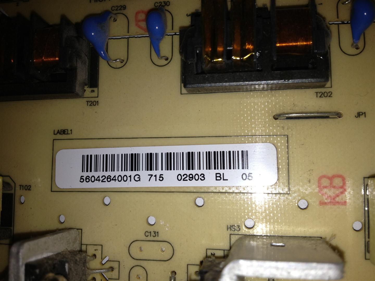

                            #73
                            Re: Westinghouse SK-32H240S Continued problems
                            You need to match the number on the barcode sticker, that is the part number of the PCBA (Printed Circuit Board Assembly), the other numbers as printed directly on the board is the P/N of the blank board before it is stuffed with components, they can use the same blank board for making many PCBA. So what are the numbers as printed on the barcode?
                            • martino
                              Not so "senior"
                              • Aug 2013
                              • 997
                              • canada
                              #74
                              Hello gentleman,
                              we are trying to figure out if the PSU board that I have will work in his TV.
                              Plugin's etc seem to be the same,but board component etc different,eventhough it's the same make model TV !!
                              I took pics of the board and barcode and legend for the 22pin plug...
                              Proud owner of dozens of broken TV's and many,many,many boards.
                              Our website and passion:http://hollenhundshepherds.com/
                              • tvdoc757
                                • Sep 2013
                                • 3
                                • usa
                                #75
                                the number on the barcode is 5604264011g74900274bp1b thank you for your help.
                                  #76
                                  http://www.shopjimmy.com/catalogsear...use+sk-32h240s, he has a sub for the your board.
                                  http://www.shopjimmy.com/westinghous...t-inverter.htm
                                  You should contact SJ for verification.
