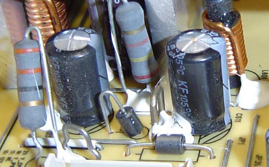

    I have been working on a 32" Westinghouse TV and so far I have replaced the inverter transformer and some of the badcaps that I found.
    What is unusual is that after replacing the bad components the TV still won't work. When I turn it on it shows the logo then goes black, then, if I leave it on the picture will show up for a second, then goes black again.
    The capacitors I replaced may not be the right ESR or ripple current rating.
    The old caps were CapXons and the two I replaced were a 2200uF 10v GF 105 C P733 VENT, and a KY 16 v 1000uF (M)105 C 7(7) 8e. Any Links fro finding the specs for these caps would be greatly appreciated. Replaced with 2200 uF, PL(M) nichicon and a 1000 uF FM Matsushita Panasonic cap.
    I also replaced a 5D 3KV, blue ceramic capacitor that was reading 9 pF instead of 5 pF
    In the pictures i have circled the parts I replaced and would like to know where to go next in trouble shooting this board?

      This appears to be and should be troubleshot as 'two seconds to black'. The pictures aren't very good, and without a picture of the bottom of the power supply / inverter it's going to require a little extra work. Since you will be doing the work, I don't mind.
      The following tests should be done in as dark a room as possible - you are going to be looking for a brief flash from the backlights.
      Set everything up so you can see the back of the LCD panel. There are usually enough light leaks that you can see if the backlights are on even from the back.
      Disconnect all of the cables to the backlights except one. Turn on the TV. You should see a brief flash before the protection circuits kick in. Turn the TV off, unplug the first CCFL and plug in the next. Turn on the TV and watch for the flash. Repeat for each of the remaining 4 CCFLs.
      With luck, all of the CCFLs except one will light. If none light, repeat, but hooking up a pair at a time, rather than only one.
      Report your results.

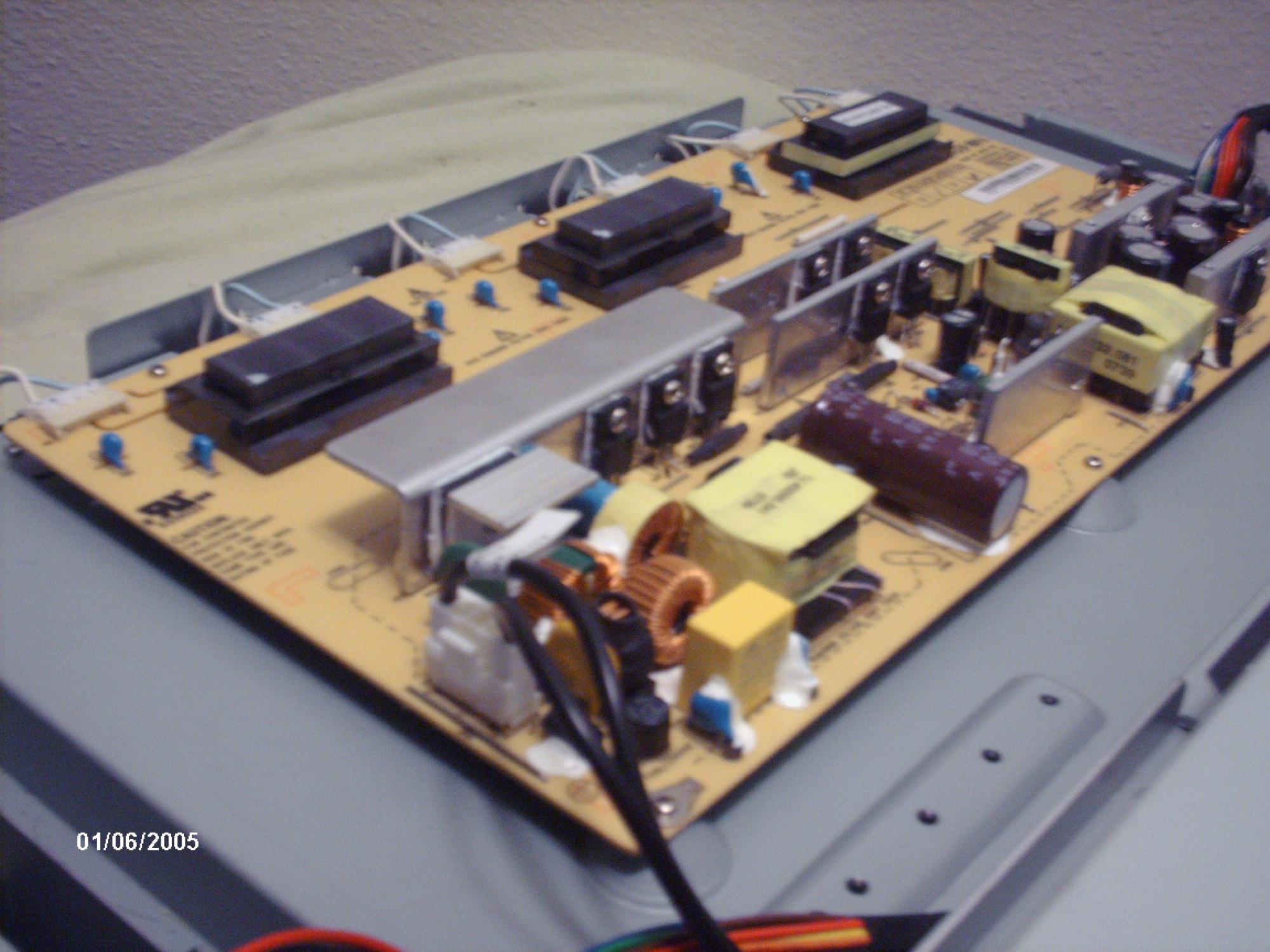

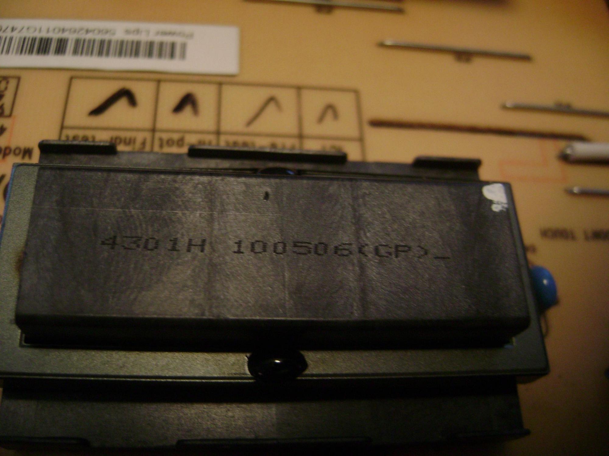

        I have the same TV and the same problem. I bought this today from someone who had this problem before. They replaced one of the three transformer on the inverter board as it burned the board open. This time (about three months later) it was the transformer on the oposite side of the board that burned open.
        Is this a bad batch of transformers? Should I replace all three to be on the safe side? Where is a good place to find them.
        Pics below.
        I should also mention that resistance checks have been done and they look ok - the ones that weren't burned.
          $10 on ebay + free shipping.
          http://www.ebay.com/sch/i.html?_nkw=4301+transformer
          lcdparts.net also has it, but it is 3x the price.
          http://lcdparts.net/TransformerDetai...ProductID=2774

            Re: Westinghouse SK-32H240S Continued problems
            Yes those Darfon transformers seem to die all the time.

              And from the variety of types that fail, it's not a bad batch, but a systemic problem (poor quality wire, poor winding technique, or both).

                      Agreed, no guarantees, but there is one indication. I've replace a 4006A type transformer, the secondaries read about 950 ohms. On the replacement the secondaries read somewhat lower - around 800 ohms as I remember. Yet the new transformer worked perfectly. The only conclusion is the 'after market' transformer has the correct turns ratio, but heavier gauge wire - which should be less likely to break.

                          Do the math. The typical CCFL draws about 4 - 6 ma at 800 - 1200 volts. Taking the worst cases (6 ma, 800 volts, 150 ohm difference), the variation is only .9 volts, about .1%

                            So, why does transformer resistance matter so much when identifying faulty inverter transformers? (Noob here!)

                              beause you will find the bad one open or many shorted turns.stands out from the others.made in the same batch they should all be close.

                                As kc8adu said, it's the most practical way to identify a transformer with an open or shorted secondary (it is highly unlikely there would be an open primary).
                                A much better method would be a ring tester, but that is a rather specialized piece of equipment that most hobbyists won't have.
