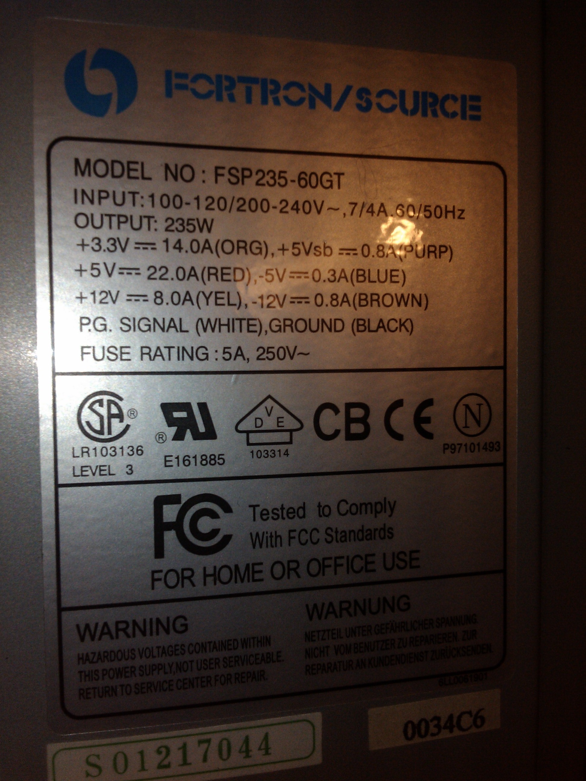

                                • Bulgaria
                                • Fixing stuff
                                #235
                                Re: the gutless, bloated, and fried power supply hall of shame
                                Originally posted by mockingbird
                                Why are those two Teapo caps always bloating in the pi filter where the purple +5VSB goes in?
                                Good question, but I don't think I can answer it. Most likely they just get overexposed to heat, as Wester547 suggested. Perhaps there's a hot spot there. Or maybe the caps were not correctly specced for that circuit.
                                I just fixed the 2-transistor 5vsb circuit of an old 235-watter. The output caps were failed, and putting any load over 100 mA would make the voltage oscillate all over the place between 4V and 5V with lots of audible noise. When that happened, the second rail produced by the 5VSB transformer (normally 12V - used for powering the driving transformer for the BJTs on the main power supply) would jump to over 30V! That was all bad news for the 16V, 47uF cap that was filtering that rail. I then changed the output caps on the 5VSB with 2x very low ESR caps (one is actually motherboard grade), and the 5VSB is now solid as a rock and stable right at 5.01V, even with 800 mA of load. I have no doubts it will do fine at higher loads.
