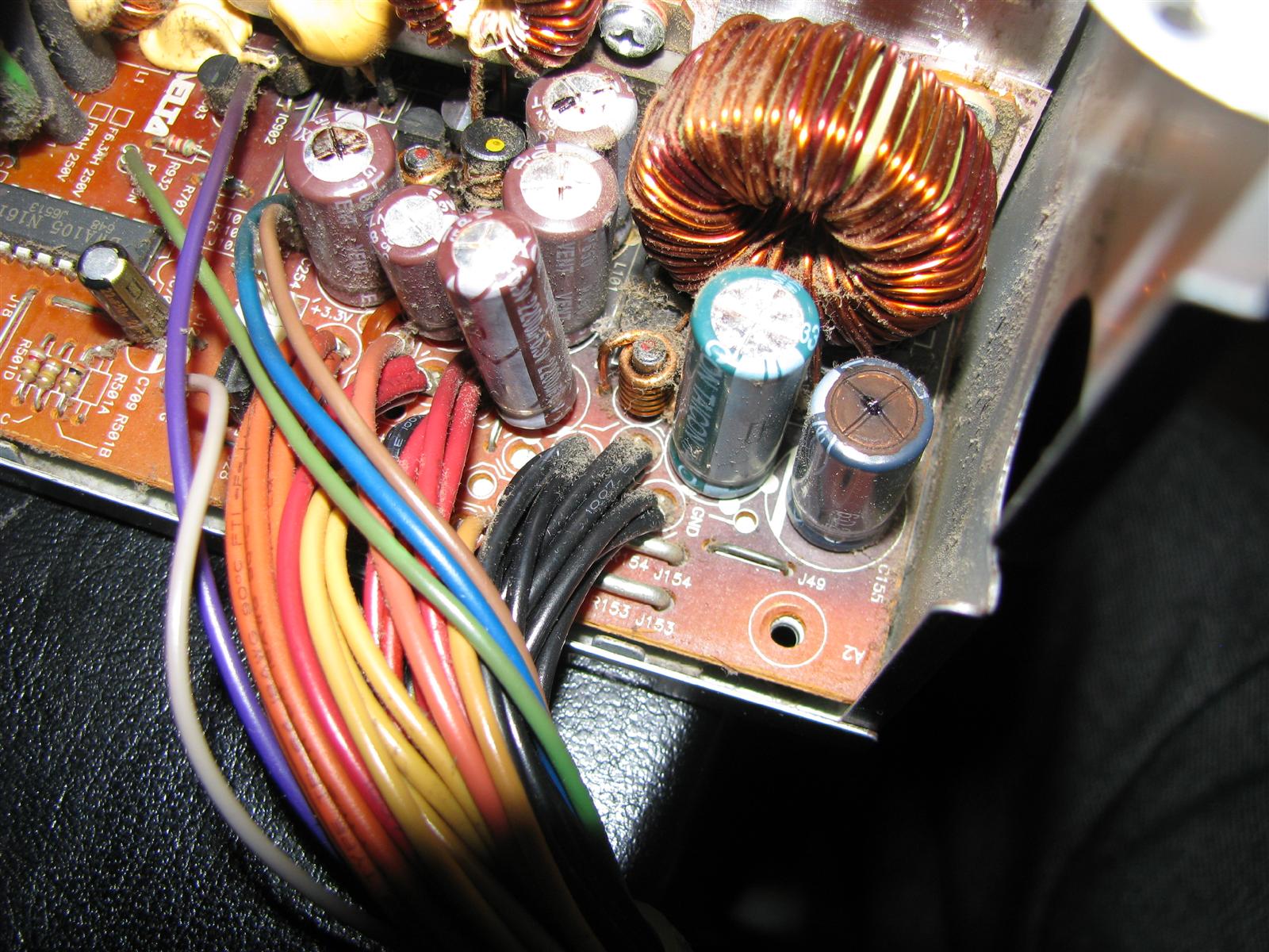

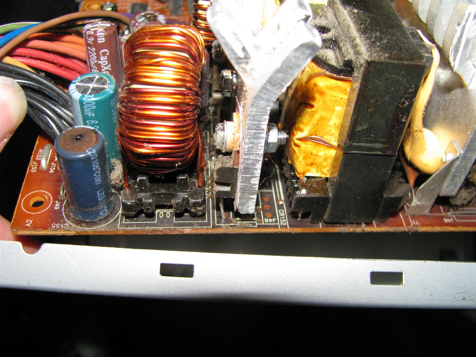

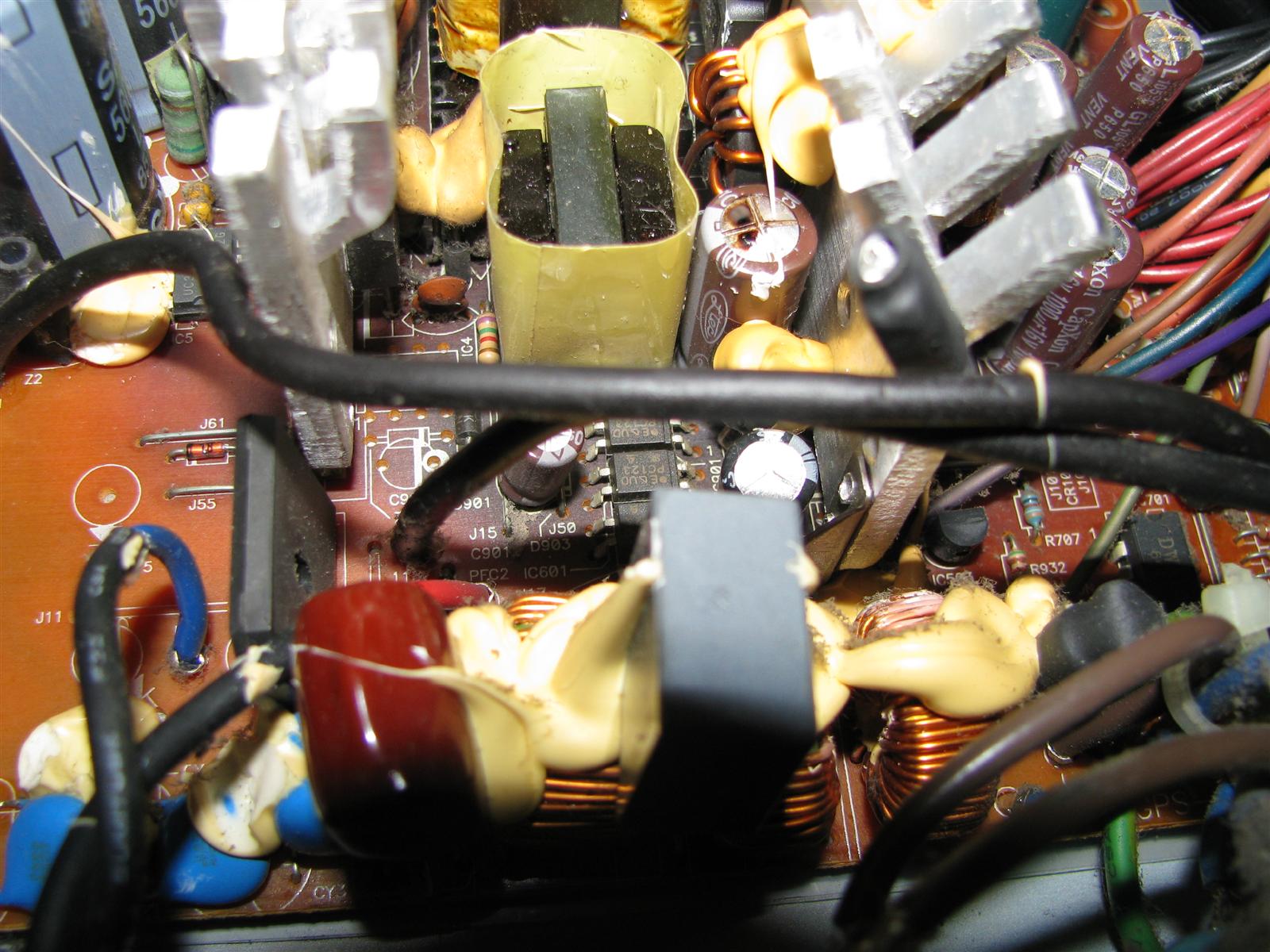

                              I bet no one thought a Delta would ever end up on here, but today I have just that - a destroyed delta. THe fan was branded T&T (Thieves & Thugs ?) and it quit. Here's the carnaige. The PCB discolouration didn't show up quite as clearly in the photos as I'd hoped, so if it looks slightly discoloured in the photo, it's really bad in real life. The cool part is, it still runs, albeit with very high ripple due to all the bad caps. I'm thinking it might be salvagable by replacing the caps, fan and secondary torroids.

                                How did it (almost) murder itself like that? Is it the tan/brown glue? Placement of diodes? Or something else?

                                  The fan quit, as I said, and it lacks OTP
                                    Oh yeah, it is pretty bad even on the foto (in comparison with Pentium's photos ). I get the feeling I should check and lubricate every fan in every PSU going through my hands from now on…?
                                      Whoops, I don't know how I missed that. ^^; No surprise that cheap sleeve bearings seize sooner than late. I'm surprised it could still start up given all the capacitors were bloated (usually the capacitors on the 5VSB rail prevent a system from posting whence they fail).

                                        WOW, that thing really fried up!
                                        I laughed at how the one taicon is not vented, and the rest (capxon and ltec) are :P

                                          It's probably just dried out. Given the amount of heat discolouration, I wouldn't blame a Panny for failing.
