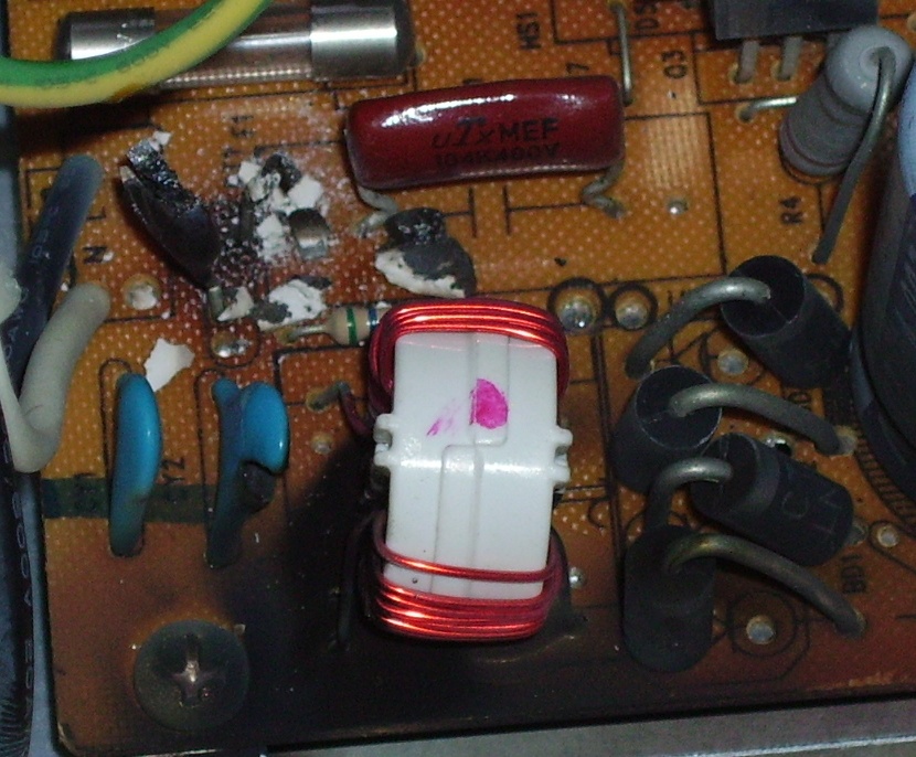

                TT ATX-400, Burned input filtering and busted caps on the secondary. All the caps are YC/Yang Chun brand.

                  #128
                  Re: the gutless, bloated, and fried power supply hall of shame
                  Looks like one of the "safety" Y caps shorted. Proper Y caps are supposed to go open when they fail. Or perhaps the coil arced over.
                  Yet another low end Solytech.

                    #129
                    Thermistor blew out, and filter choke burned up, 'cause switchers and/or primary rectifiers shorted. If you could believe its rating, the fuse is probably 8A. Mmmm... chip of the year.
                    Looks like that 'steel' was excess left over from the cheep 'n nasty scrapheaps disguised as cases. Gotta love the caps... Look! They used a TO-220 case rectifer for the 12v supply instead of two 3A FR diodes soldered to one of those stupid brackets...

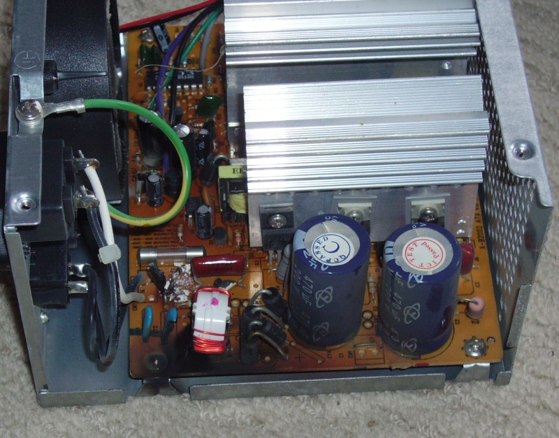

                                #135
                                you mean YC for the saturn logo? thats them.
                                sigpic
                                (Insert witty quote here)
                                • Agent24
                                  I see dead caps
