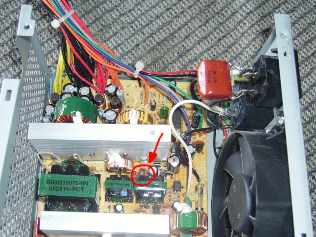

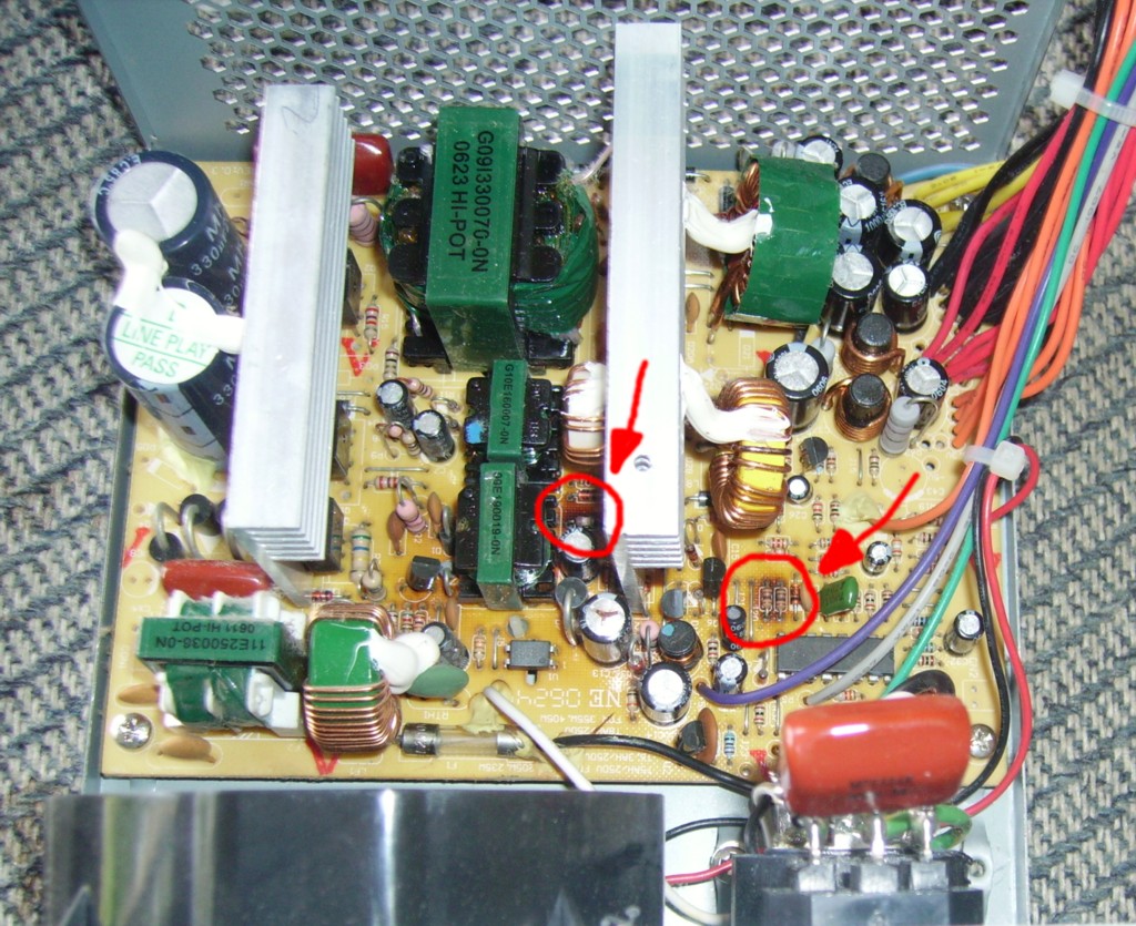

    I know I already posted it, but I think it's bad enough to warrant posting again. Power board for a Philips CD-i 910.

      That's nasty. The only time I've seen anything that even comes close to that was the PSU from a computer that lived near the coast. One day it went BANG. I opened it and noticed that the PCB was wet (salt water?). Unfortunatly, when this PSU died it took the motherboard out. It was a shame as it was a good PSU (FSP).

        The machine it came out of seems to have been around moisture for quite some time, an almost cough-syrup like substance, as there's a whole bunch of dust stuck to one part of the unit. I REALLY need to repair it, as these machines are quite rare, and a new one costs upwards for $200 if you want something that won't break (I paid $40).

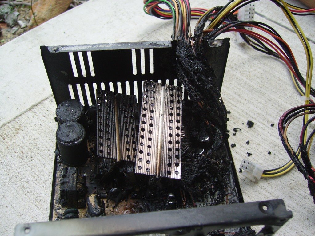

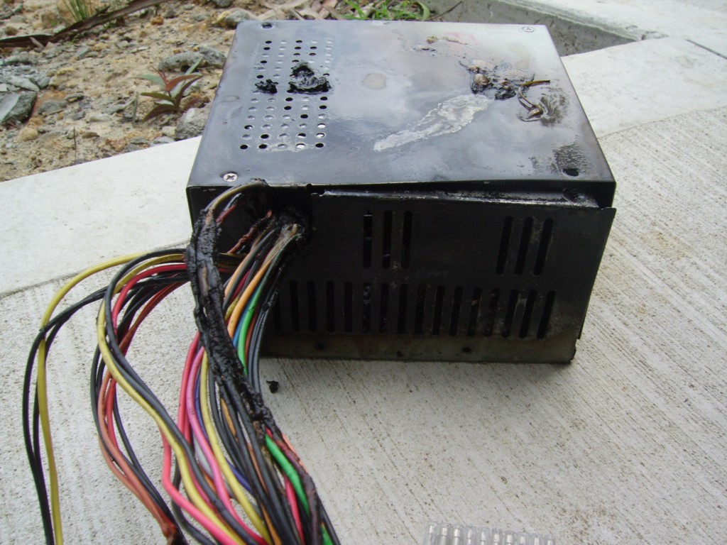

            This is an old 400W Generic PSU. It would make some strange hissing and zapping noises when plugged in, me and my best friend sprayed lots and lots of WD-40 in it and dropped a match in. Here's the carnaige.
            PS. I removed the fan first so I can use it as a case fan.

              you should have rescued the cables first - i find lots of short cable very usefull.

                Now you can post an ad on Ebay................one slightly burned computer power supply, $75. As is, no return!

                  I have lots of wires from other faulty PSUs.

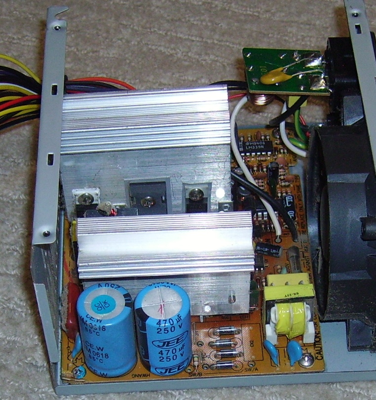

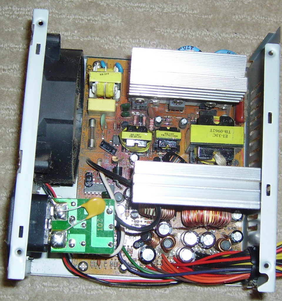

                                  Took this one home from work today, along with 2 Fuhjyyu'd Antecs. It's a Sun Pro, supposedly 550W, although I doubt it would be anywhere near that. The caps are either branded "CS", "GL", or "JEE". Two caps are bloated (although it may not be obvious in the pics) one is a 2200uF 10v JEE and the other is a 1000uF 10v CS. Note the discolouration around the middle of the PCB.

                                    "jee"!
                                    4 diodes! so you are right, i'd say 200-250w max
                                    look at the heat damage.
                                    edit- OMG! look at that fake y cap on the secondary board attached to the ac plug! one of the leads is shorting the AC!
                                    gut it!

                                      Actually, it probably can really manage 550 Watts.....For half a second!

                                        Also note the second primary switcher that is split in half

                                          That size of recifier bridge diodes on input side. That won't let PSU go all the way. These is rated 1A max.
