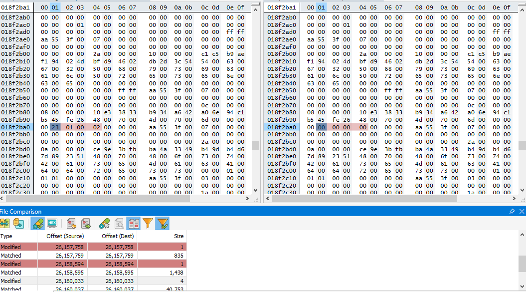

      try it dude i'm not sure if my 32mb modification would work i just copy paste binary from files i compared. but the 16mb would work fine in bios password.
      flash both files and in first boot press f10 then disable absolute in bios security. then reformat, then use MPM tool just search here in forum.

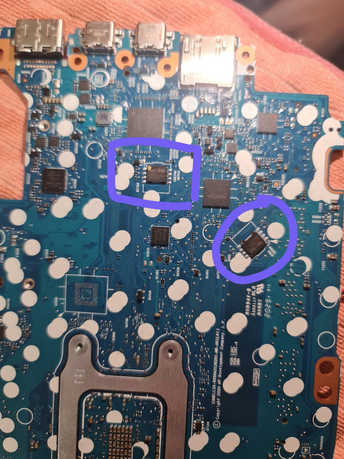

        Hello, can somebody tell me which one of these 2 chips should I read for BIOS password by RCunlocker?
        I have read the 32MB chip without desoldering, but these 2 can not read without desoldering so I don't want to desolder both and then trying which one is exact
        Thanks in advance

          Re: HP 840 G7 password
          Found it by reading the chip description, totally forgot about it, nevermind
          and Thanks

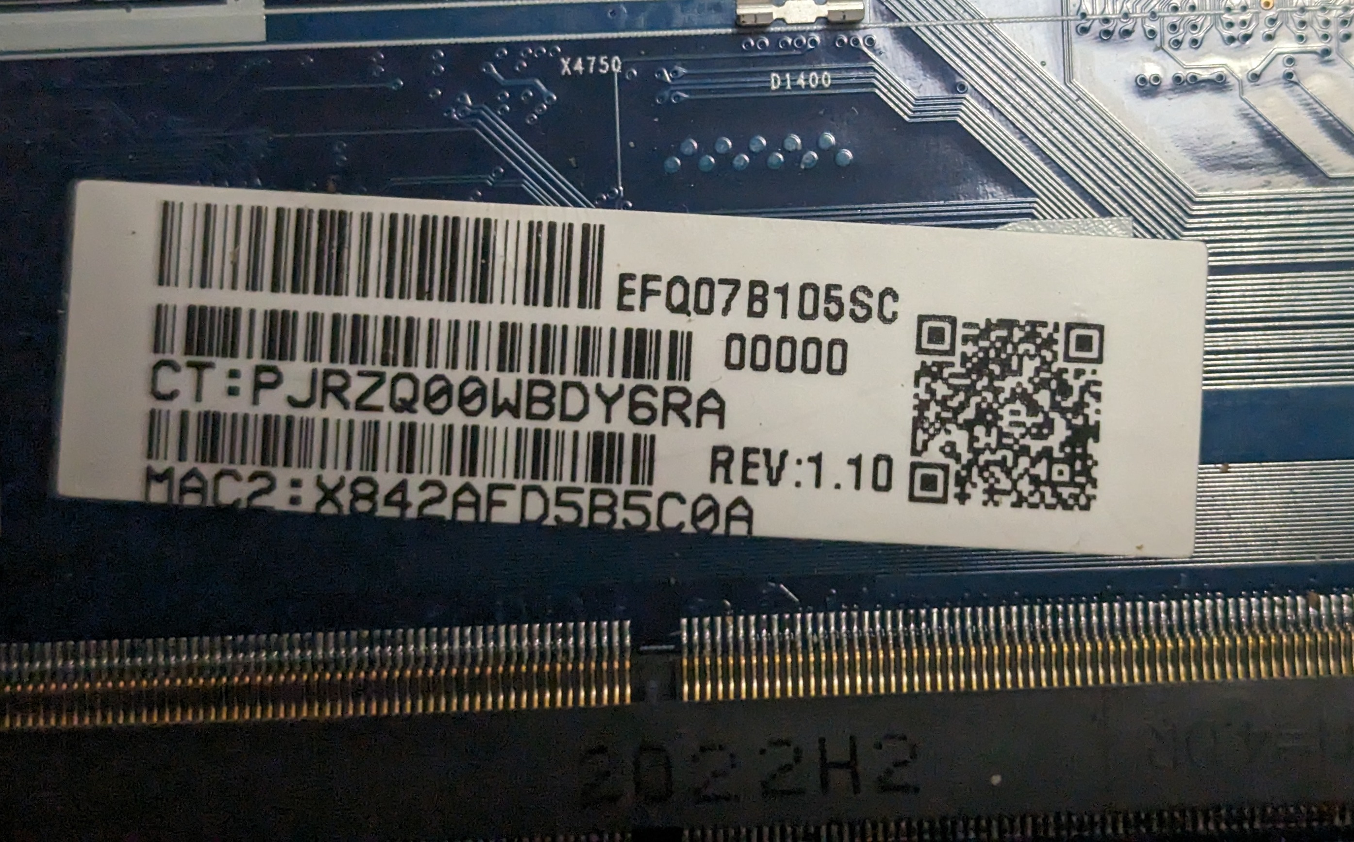

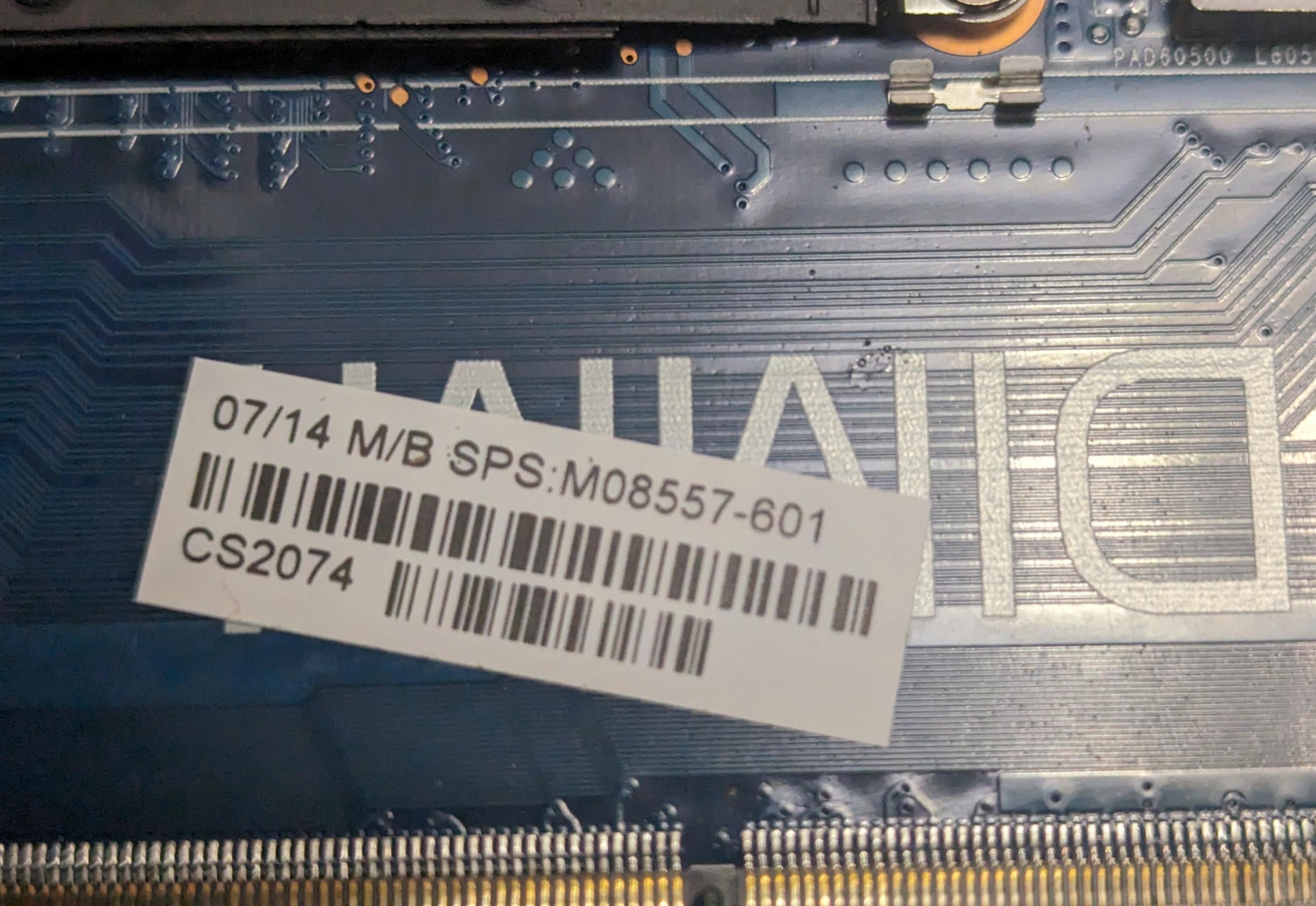

                I looked through the beginner's guide on here but didn't see how to extract the bios from the laptop to upload it. Can you point me in the right direction? Sorry man, I'm a total noob at this.
                I also forgot to include the motherboard model number. Pictures are attached.

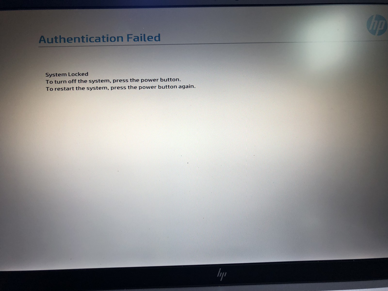

                                      Anyone remove password, i try some files in forum but "endpoint security controller problem"
                                      My original file with password

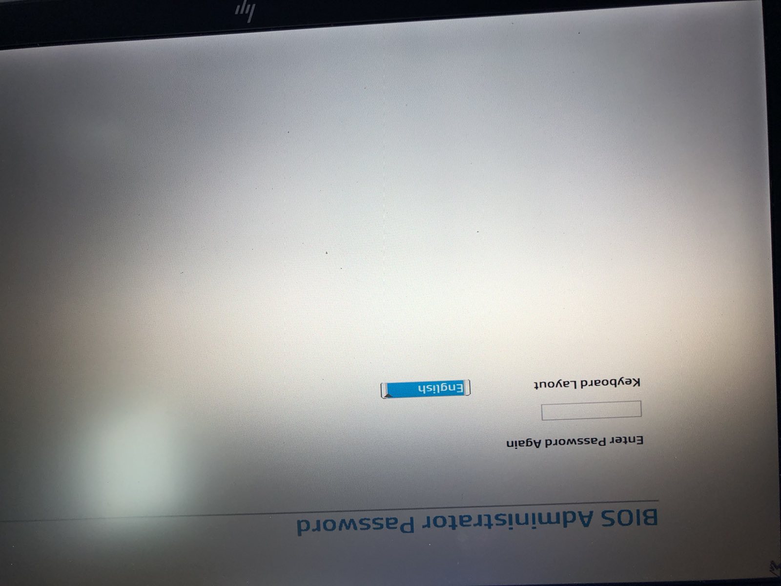

                                        There's no admin password set in the attached main bios dump, it is your original backup or not?
                                        What's the laptop serial number, is it 5CG0466LL9?
                                        Upload a screenshot of the password prompt screen.
