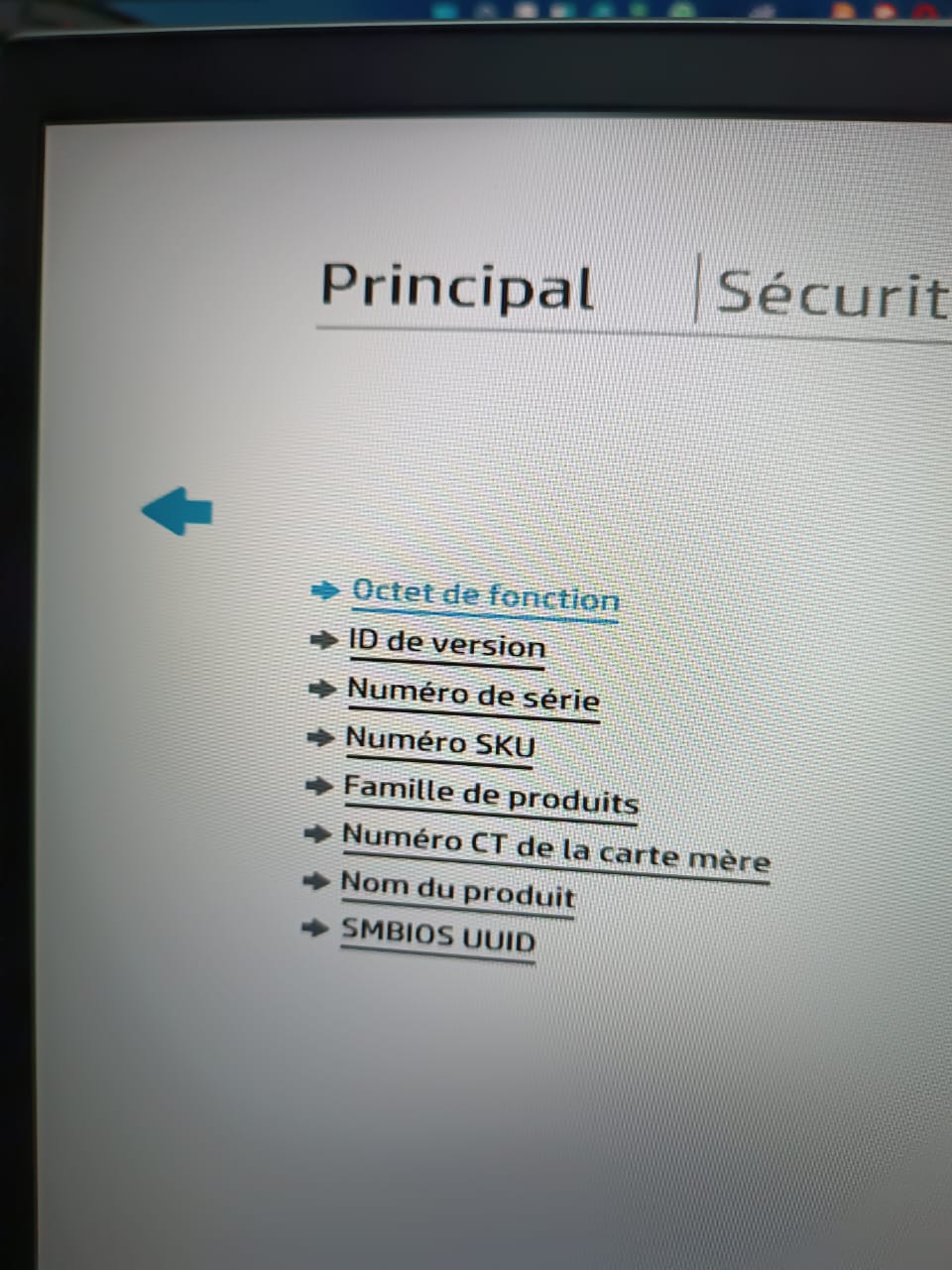

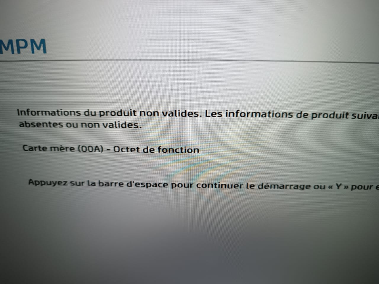

                  #108
                  Re: HP 840 G7 password
                  Originally posted by Mazorca
                  RCUnlocker did unlock the 16MB here locally, but if it didn't work, test the 32MB. First time I do this. Maybe start with flashing 32MB only.
                  after a long time 10 to 20 minute it finshed , then asked for information on the pic i tried to just enter some bit dont know octet de fonction ....but when iam on the bios tried to disable secure boot to install pc to update bios he demande the pass so the pass still existe?
                  • Mazorca
                    • Jan 2017
                    • 463
                    #109
                    Translates as function byte, so probably password is still there. Sorry the method didn't work, applied one that is for 840 G8.

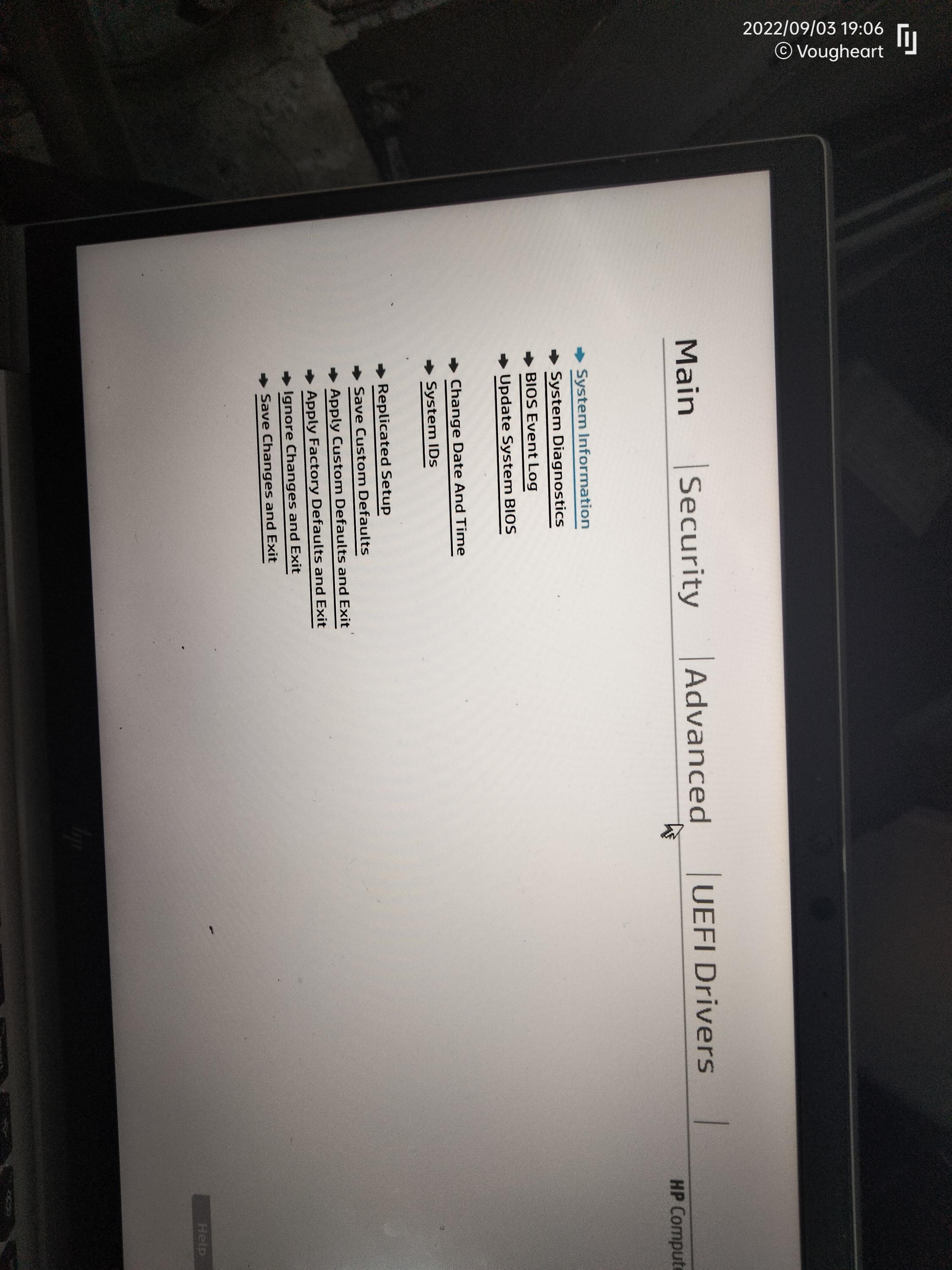

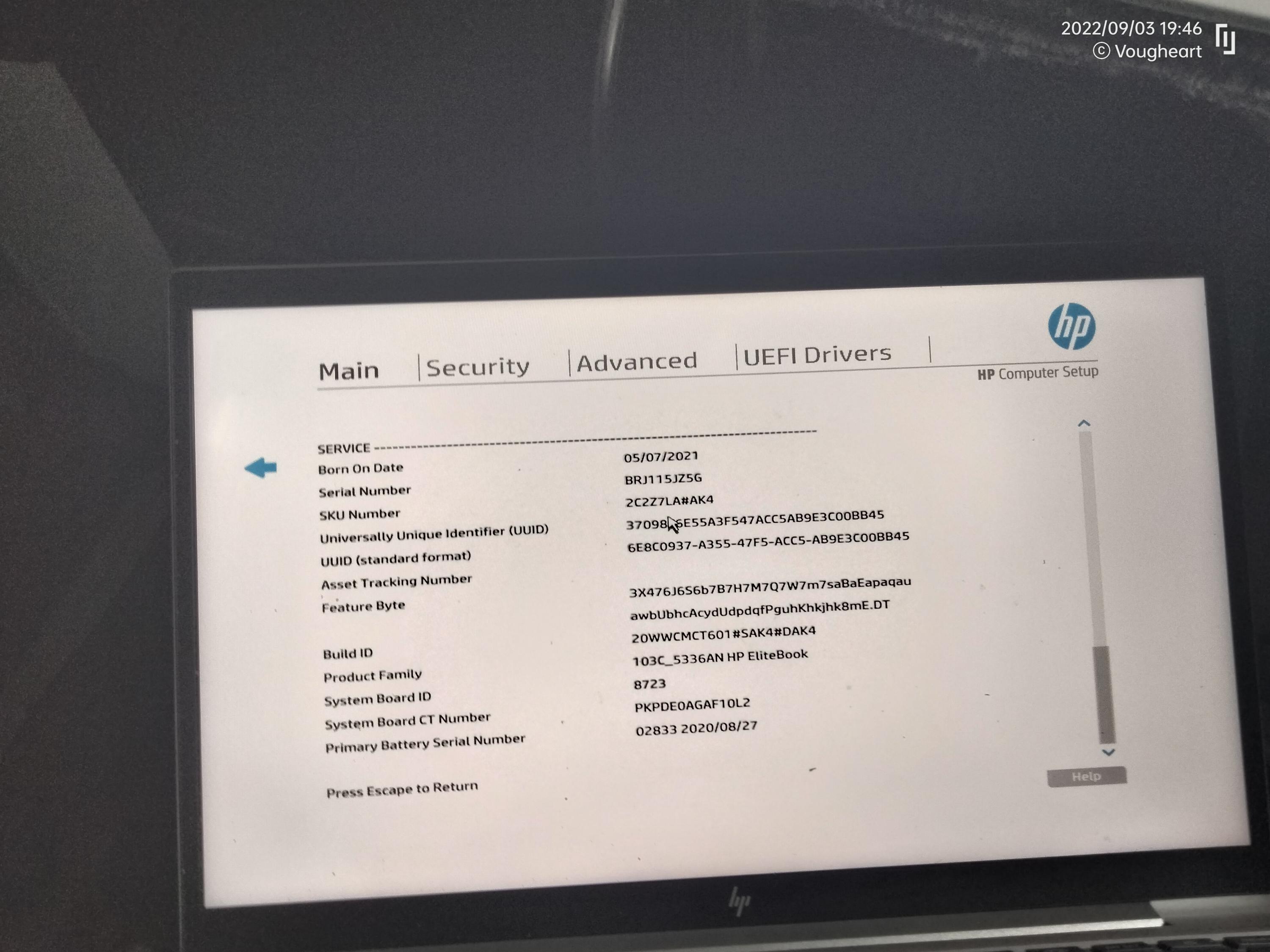

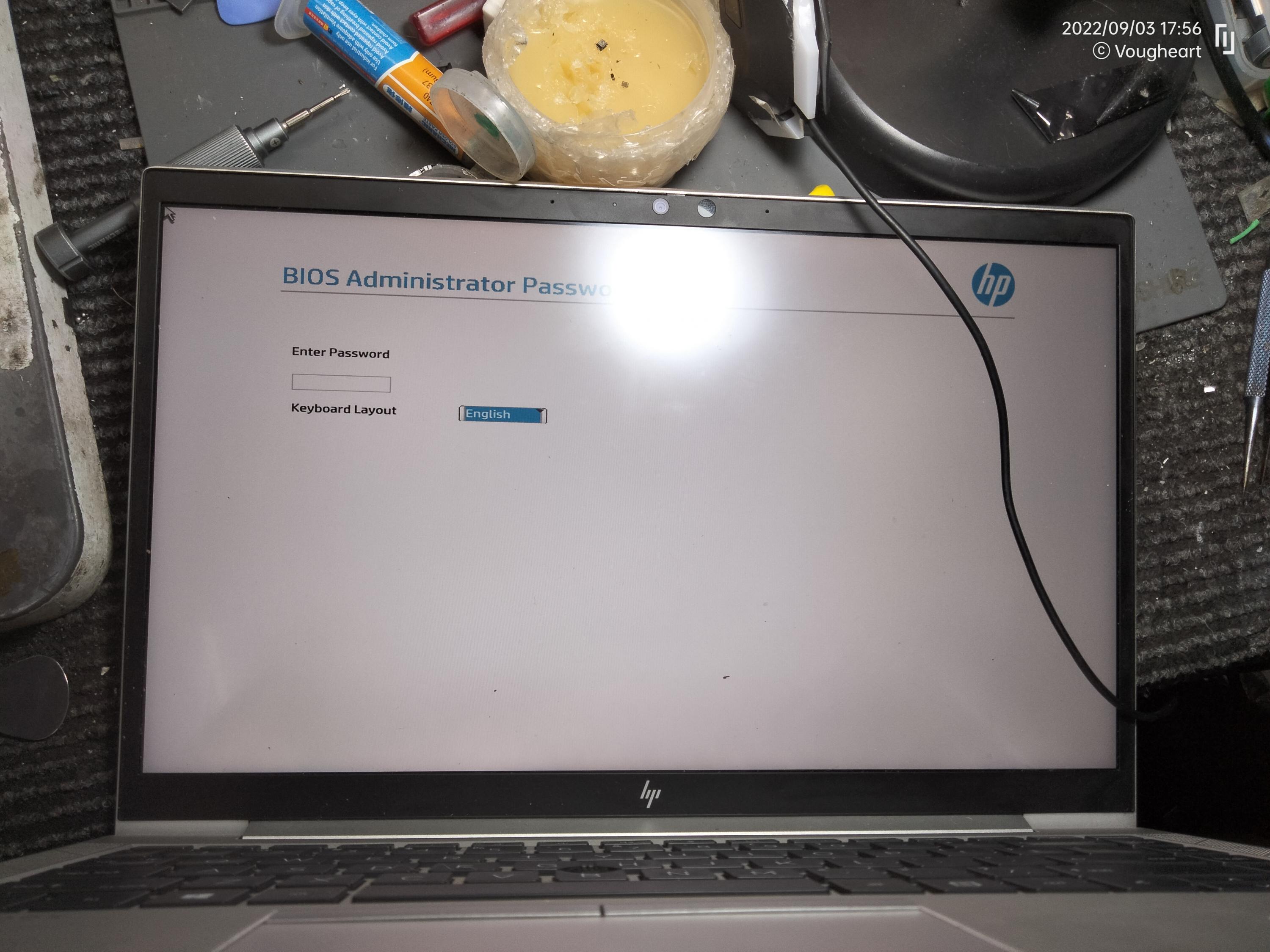

                              #114
                              HELP MY G7 840 G7 Password SWAT problem
                              • Mazorca
                                • Jan 2017
                                • 463
                                #115
                                If you are willing to try, unlock the 16MB file with RCUnlocker, and if it doesn't, continue with the BIG CHIP_unlocked. Please report back. Make sure you have good backups before any flashing is done.
                                This is how hoaca388 solved it:
                                "You used the bios of another machine, so in the 32MB bios file, there is MPM information of that device and it has enabled the "security endpoint". I rebuilt the new 32MB bios file, cleaned the ME region.
                                With the 16MB file, I deleted the first NvramActiveRegn region.
                                But now you may have trouble with MPM again."
                                No trouble with MPM was reported, but further work may be needed, perhaps also cleaning ME Region on the 32MB chip. I only cleaned the USER CRED Region.

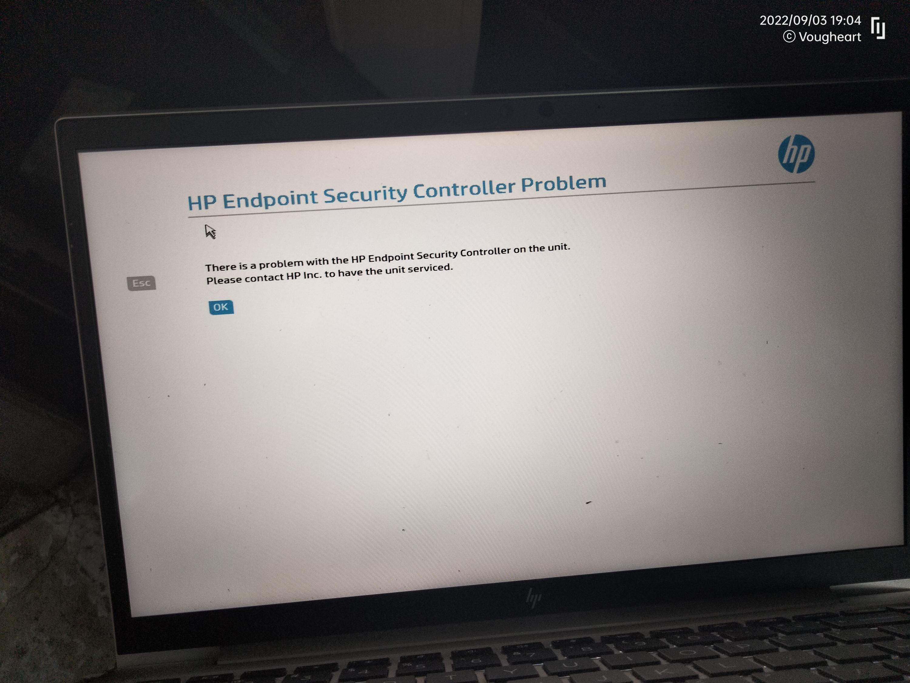

                                • vougheart
                                  • Jul 2020
                                  • 65
                                  • philippines
                                  #116
                                  i tried this files sir but the response is 7blinks on capslock
                                  and i tried the backup again but it has the same response now 7 blinks on capslock
                                  can you help me with this problem sir😭
