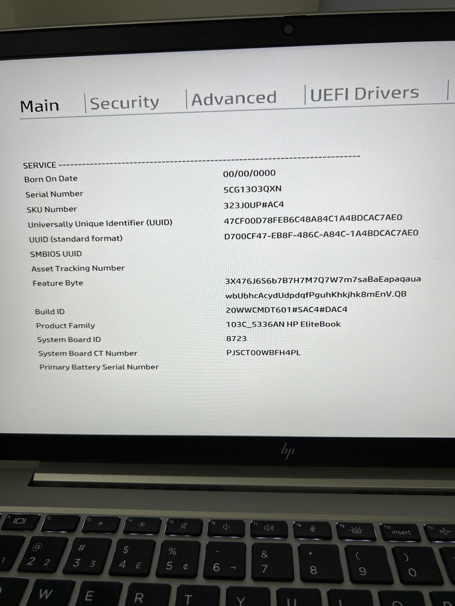

                          MPM Product information:
                          1. Feature Byte: 3X476J6S6b7B7H7M7Q7W7m7saBaEapaqauawbUbhcAcydUdpdqfPguhKhkjhk8mEnV.QB
                          2. Build Id: 20WWCMDT601#SAC4#DAC4
                          3. Serial Number: 5CG1303QXN
                          4. SKU Number: 323J0UP#AC4
                          5. Product Family: 103C_5336AN HP EliteBook
                          6. SB CT Number: PJSCT00WBFH4PL
                          7. Product Name: HP EliteBook 840 G7 Notebook PC
                          Note: The following product information must be re-programmed into the system board.
                          The (Feature Byte) is case sensitive and do not leave any blanks while filling the Build Id.
                            #53

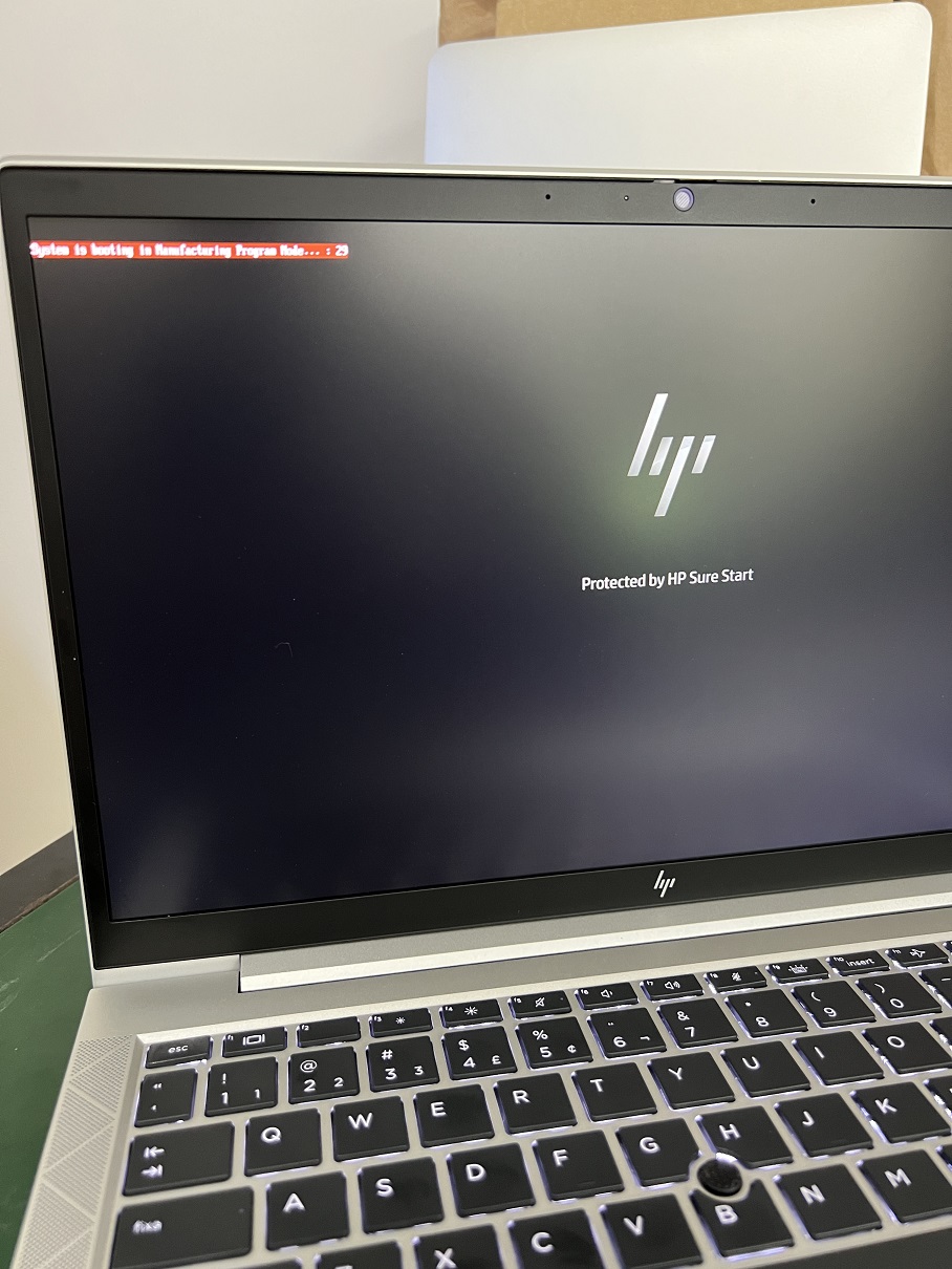

                            How do I just remove this message in red?

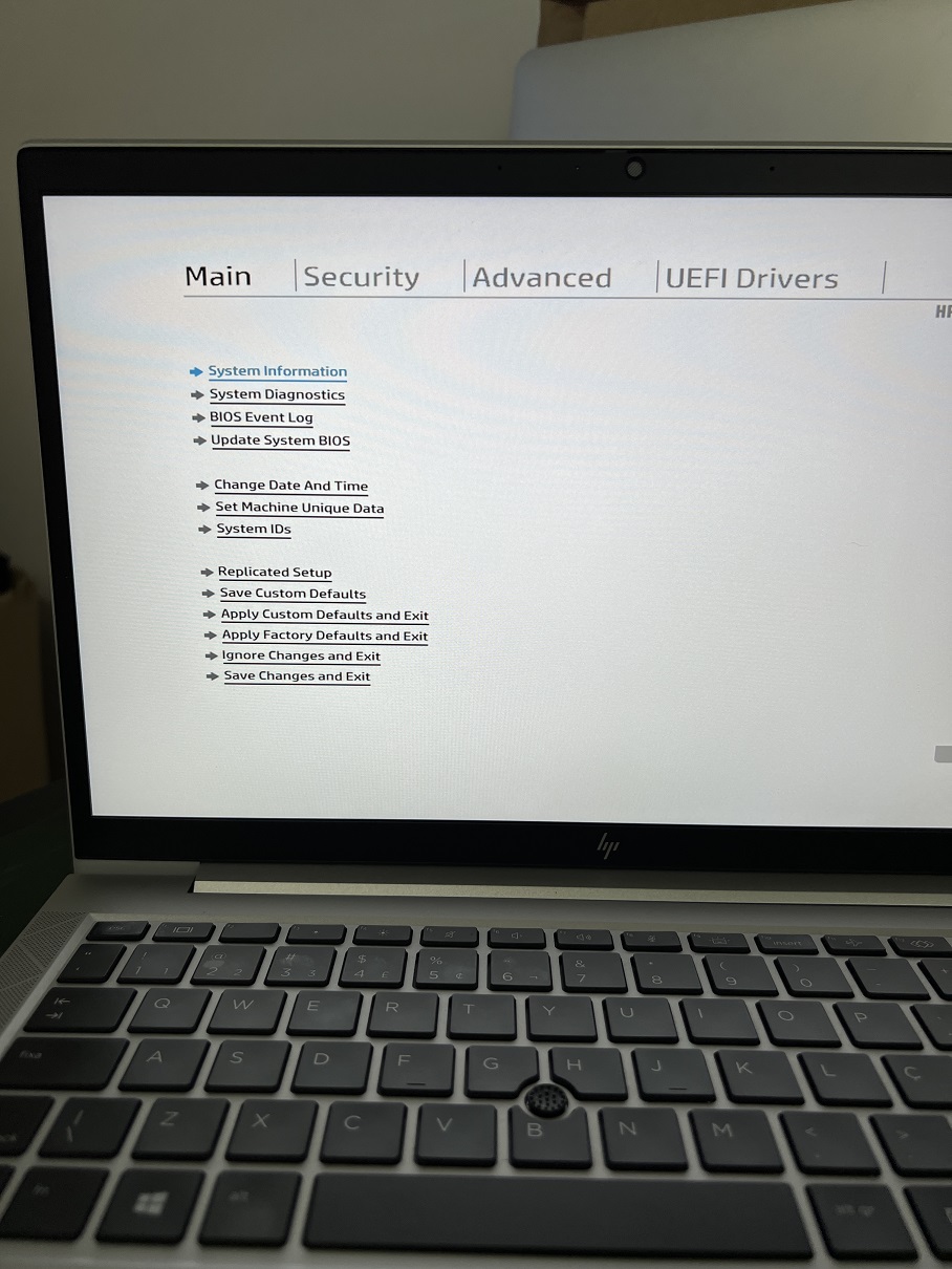

                                    Thanks for the friend's help @onizzbox, I managed to remove the red message from the screen and now the machine works perfectly.
                                      #58
                                      Re: HP 840 G7 password
                                      @69d0b913
                                      Sorry for the late reply!
                                      To exit the "System is booting in Manufacturing Program Mode" just reconfigure the information above in the "Set Machine Unique Data" option.
