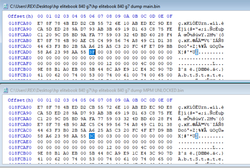

                                    help me unlock please it has bios password and computrace swatlock. in attached the bios main and the 2 ec.
                                    i need the one that is MPM unlocked i can put DMI via mpm.

                                      can you post here the block address you edit in hex? i tried RCU it doesn't boot no display. specific block starting and end. i tried copmparing files unlocked and my dump it has so many differences i dont know which block need to be modified.

                                          THANK YOU i managed to unlock by myself. i used rcu it works and i compared the unlocked computrace bin in winhex and modified mine it also works.
