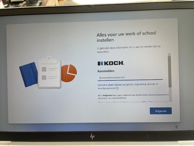

HP 840 G7 password
Hello
Can someone please remove the
work account from the dump files
serial
5CG05220LV
840 G7
Best regards chris

Hello Alfredposadas09
if i do that then it works but when i do a clean install again it still ask for this
is there no way to get rit of it
Attached FilesComment
Hello alfredposadas09
yes i always wipe the ssd and install windows from usb
I wil try the option from qayyum786
and get back
best regards chrisComment
Hello qayyum786
It is still the same.
there is a 25q80 also can it be in this spi or not
I am working for weeks nou trided alot but still same problem
Let me know
Best regards chrisComment
flash this both main+EC. and fill these new DMI info. do not install your current DMI. reformat the SSD first clean all partition then use bcu after boot to windows.
first boot press f10 reset bios to factory defaults (restart) 2nd boot reset security settings to defaults.
Use BCU to fill these DMI info:
Serial Number: 5CG051029S
Product #/SKU: 24X44UC#UUF
CT Number: PJSCQ00WDEK120
Description: HP EliteBook 840 G7 Notebook
BuildID: 20WWCMBT601#SUUF#DUUF
Feature Byte: 3X476J6S6b7B7H7M7Q7W7m7saBaEapaqauawbUbhcAdUdpdqfPguhKhkjhk8mE.ye
MAC Address : 3C:18:A0:7F:69:2Attached FilesComment
- Do Default Settings in BIOS Menu and press Save and Exit
- Power off the motherboard and write orginal file oldmain.bin
-doneAttached FilesComment
hello piszpunta
still the same i am about to give it up
i tryde everyting posible but still not sorted out
I replaced the main and ec for total new ones whit no dmi info and then stil stuck on company lock
i think it is lockt on the hash of this motherbord like auto pilot
many thanks for al the People that tride to help
Best regards chris
