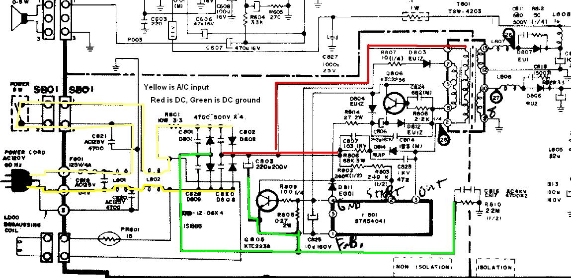

                            • 31303
                            #113
                            Re: Help with dead Commodore 1802
                            after the mains input diodes - it's all DC
                            • R_J
                              • Jun 2012
                              • 9633
                              #114
                              I don't know how many times I have said it but you can NOT use the BEEP function for testing components. Most meters will beep between 0Ω and 150Ω
                              As for the a/c or DC. You can check for A/C only to the two input (~) of the bridge rectifier, after that it is DC with reference to HOT ground (- of input capacitor C803) for any measurements in the primary side of T801, All DC measurements on the secondary side use the chassis for ground.
                              If you are measuring 165v AC on C803 you are using the wrong ground!

                                      • R_J
                                        • Jun 2012
                                        • 9633
                                        #119
                                        This is the a/c path and where the 4 diodes (in a bridge configuration) convert to DC. After that it gets more complicated as the STR54041 IC takes that DC and switches it, at HIGH FREQUENCY (around 20KHz) into A/C to drive the transformer.
                                        • roadrash
                                          • Oct 2015
                                          • 494
                                          • U.K.
                                          #120
                                          Hey RJ thats really helpful of you. Sorry been a delay in getting back to you as ive been unwell all week with my MS. Anyway what yiou did there makes it a lot more plain where the AC and DC changen and where I take the measurements from. Going by your Shematic I now find I am getting no readings where I had some before.
                                          At filter cap C803 there is no AC voltage. (before I was using one off the AC inputs as a pole but now if I measure across the capacitors 2 contacts -+ there is no voltage reading and I checked fuse again and its ok. Should be a voltage across the 2 poles of C803?
                                          I will have to look in to this further because there is something amiss here. Now I use your schematic RJ, I am getting no readings where I was getting something before.
                                          I will sleep on it and start again tomorrow with a fresh start when I am not so fatigued.
