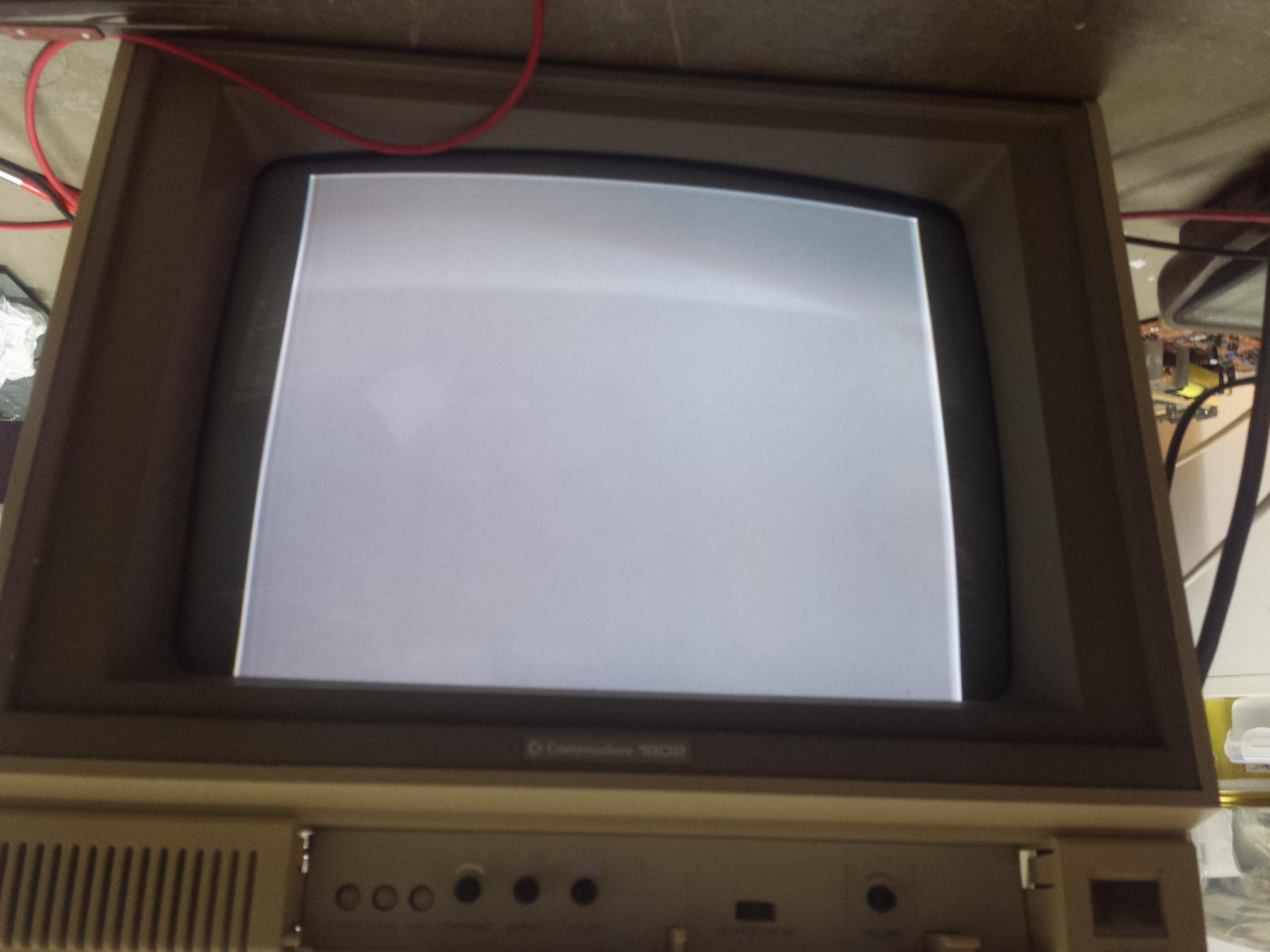

                                  I have got it back to where we were now and i have the psu working and audio section now working again.
                                  I replaced the IC801 and now its back working and i have a display now look.
                                  What now?
                                    Re: Help with dead Commodore 1802
                                    Good to see it's working. Feed it some signal and see what it looks like, One capacitor I have changed a lot is tv's and monitors it the drive transformer filter cap. C430 (1µf/160v) If you have one I would replace it.
