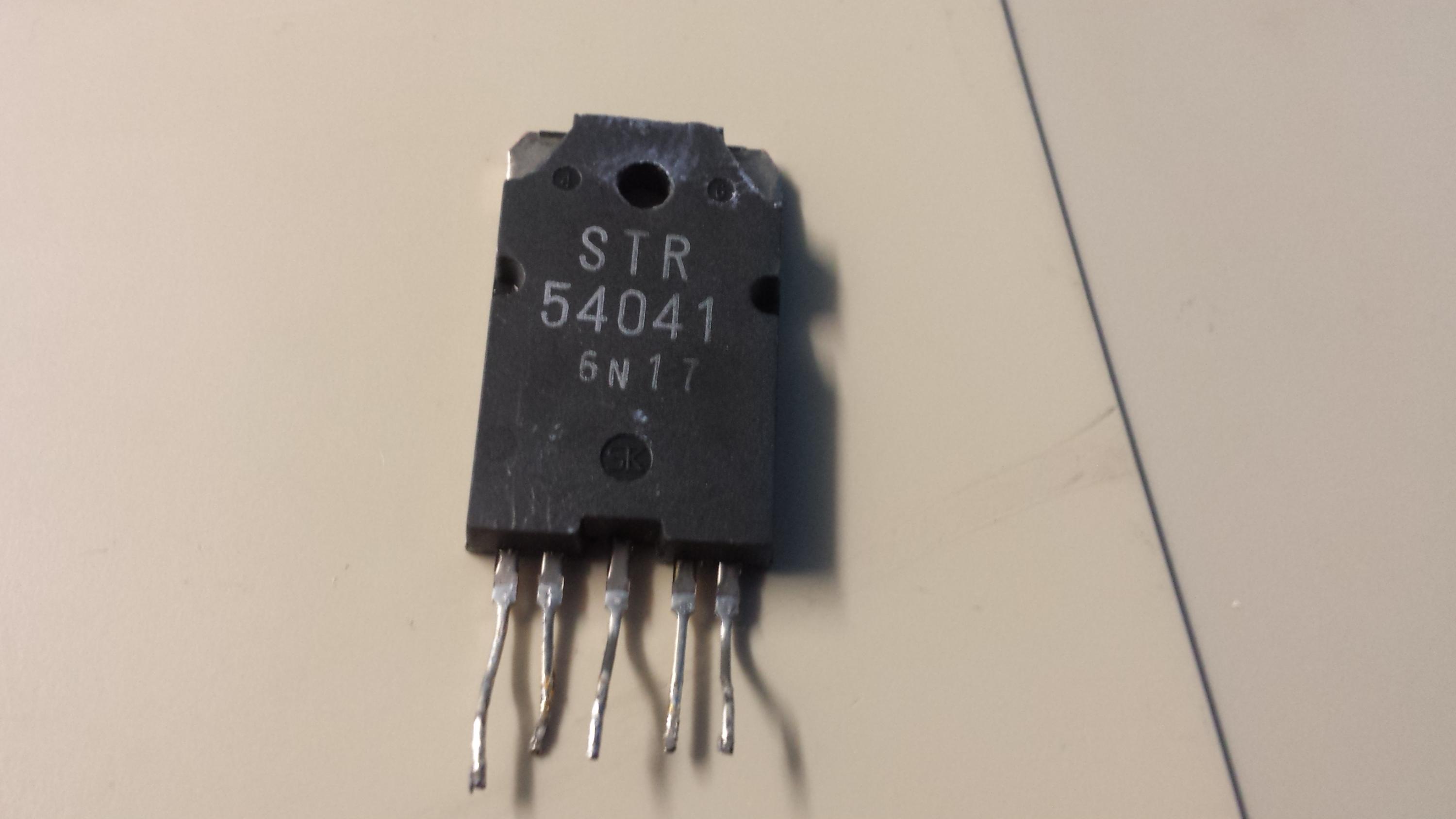

                      No short across main cap. Took out str54041 so how do i test this thing. My component tester only has 3 test leads. Can it be done with a multimeter? Here isna picture of what i removed there is not any room to get into it much.
                        #51
                        Re: Help with dead Commodore 1802
                        You can test the output transistor with a meter, see post #44

                          Thanks. It tests ok. Ive been testing everything including the STR54041 for a short and nothing tests as a short in the power supply area of the pcb except a odd iduction coils and that new metal oxcide resistor. Should i refit the STR transistor and try power it up using the light bulb as was mentioned earlier. Ive removed L805 and connected the bulb across C812. Is there anything to check before i try this and most likely blow another resistor probably.
