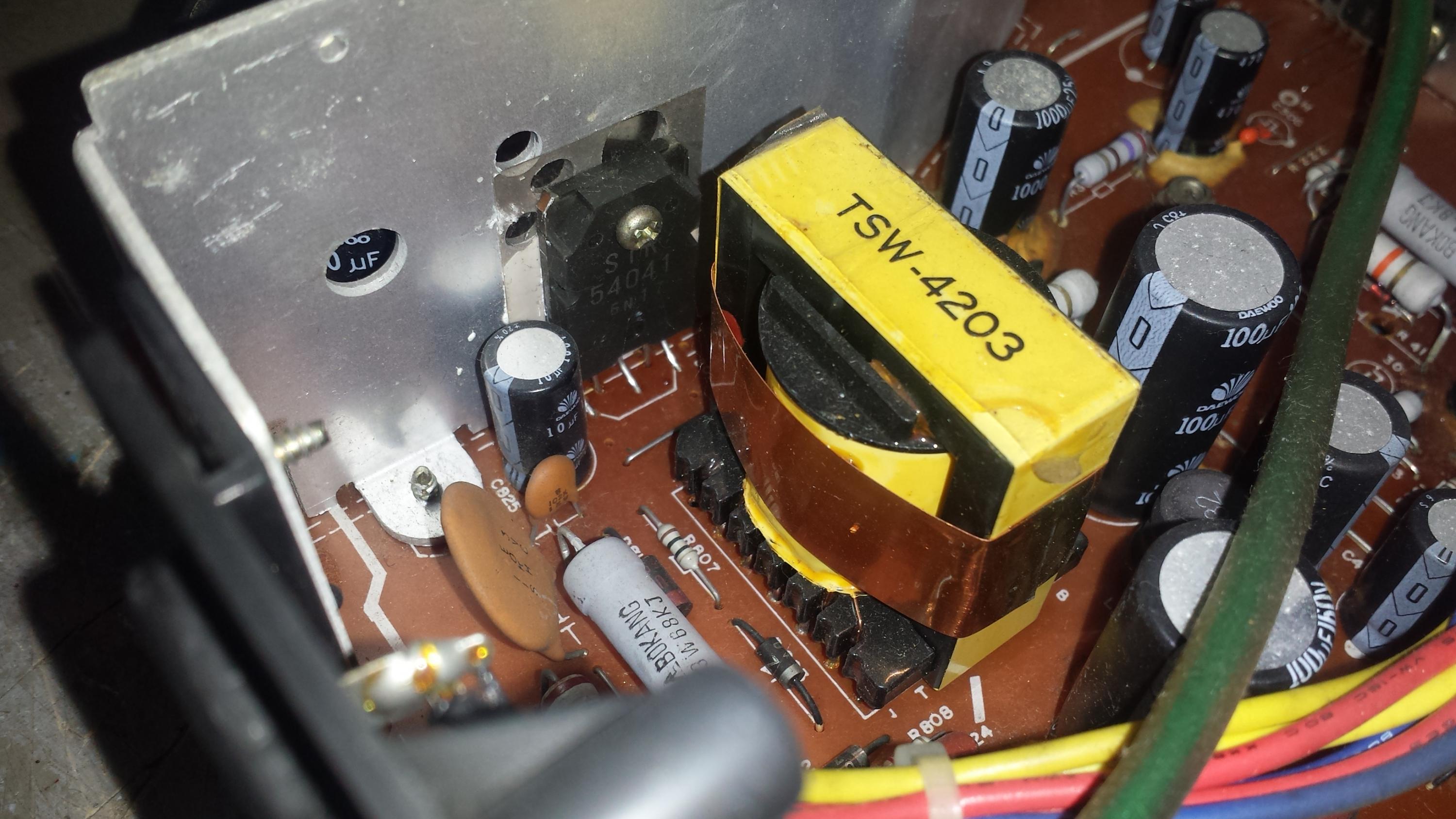

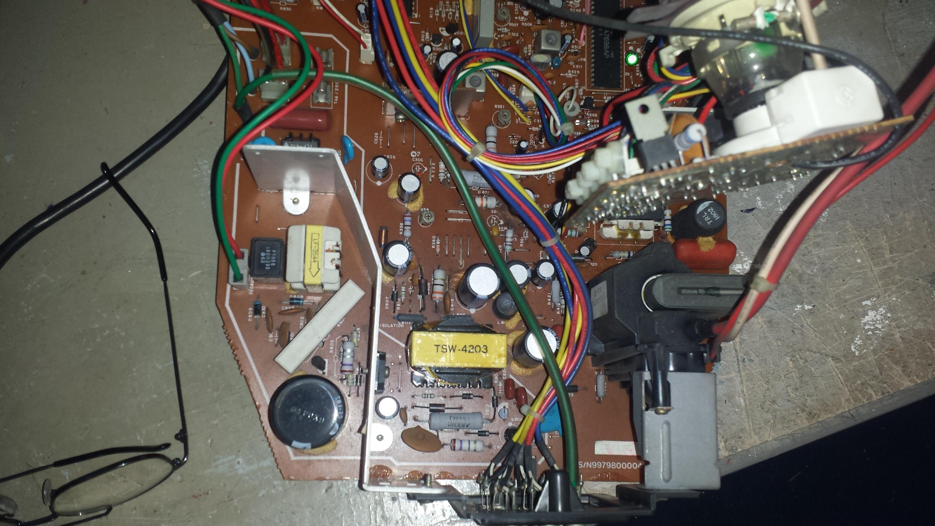

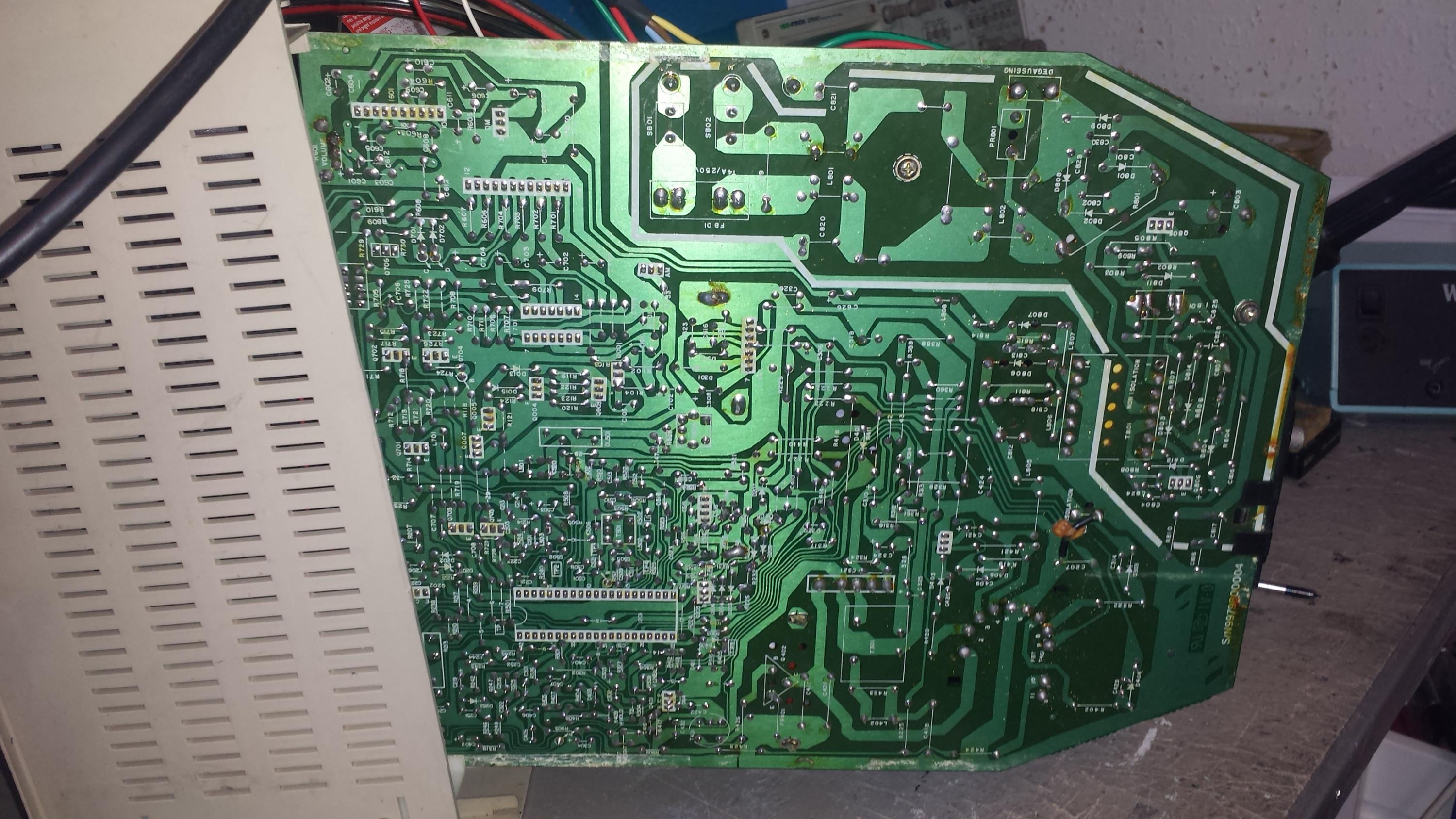

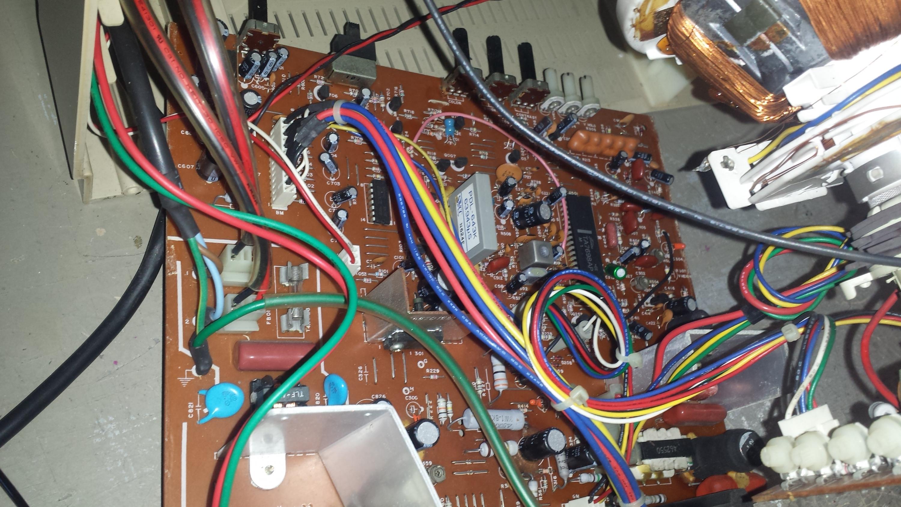

    I wonder could someone help me get my old Commodore 1802 monitor working again. This was working perfectlyfor years andthe other day I left it running for a few hours and when I came back it was dead. Ive checked fuses but they are ok so must me a PSU fault.
    There is 240v AC getting into the PCB and I can follow it quite a distance. Visualy looks like nothing is wrong but there is a STR54041 regulator which ive ordered just in case its that.

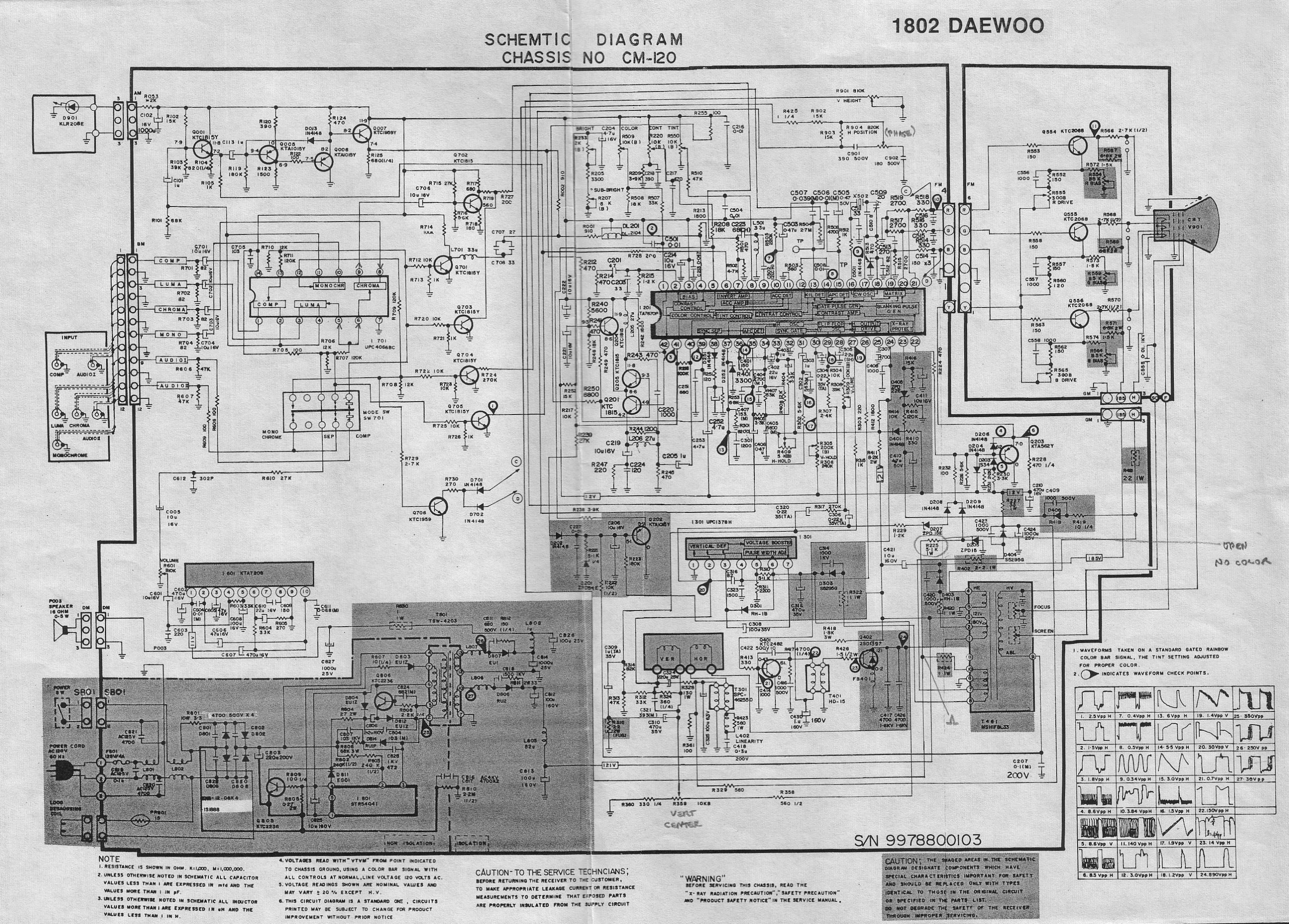

    I have found and attached a Schematic and i have a service manual but its for the 110v NTSC version.
    thank you

    It might be a simple as one of the two small caps in the primary, 2.2µf or the 10µf
    Are you getting any voltage on the secondary of the power supply?
    Check Q402 horizontal output transistor and see if it is ok and not shorted. If it's ok its likley just the power supply at fault

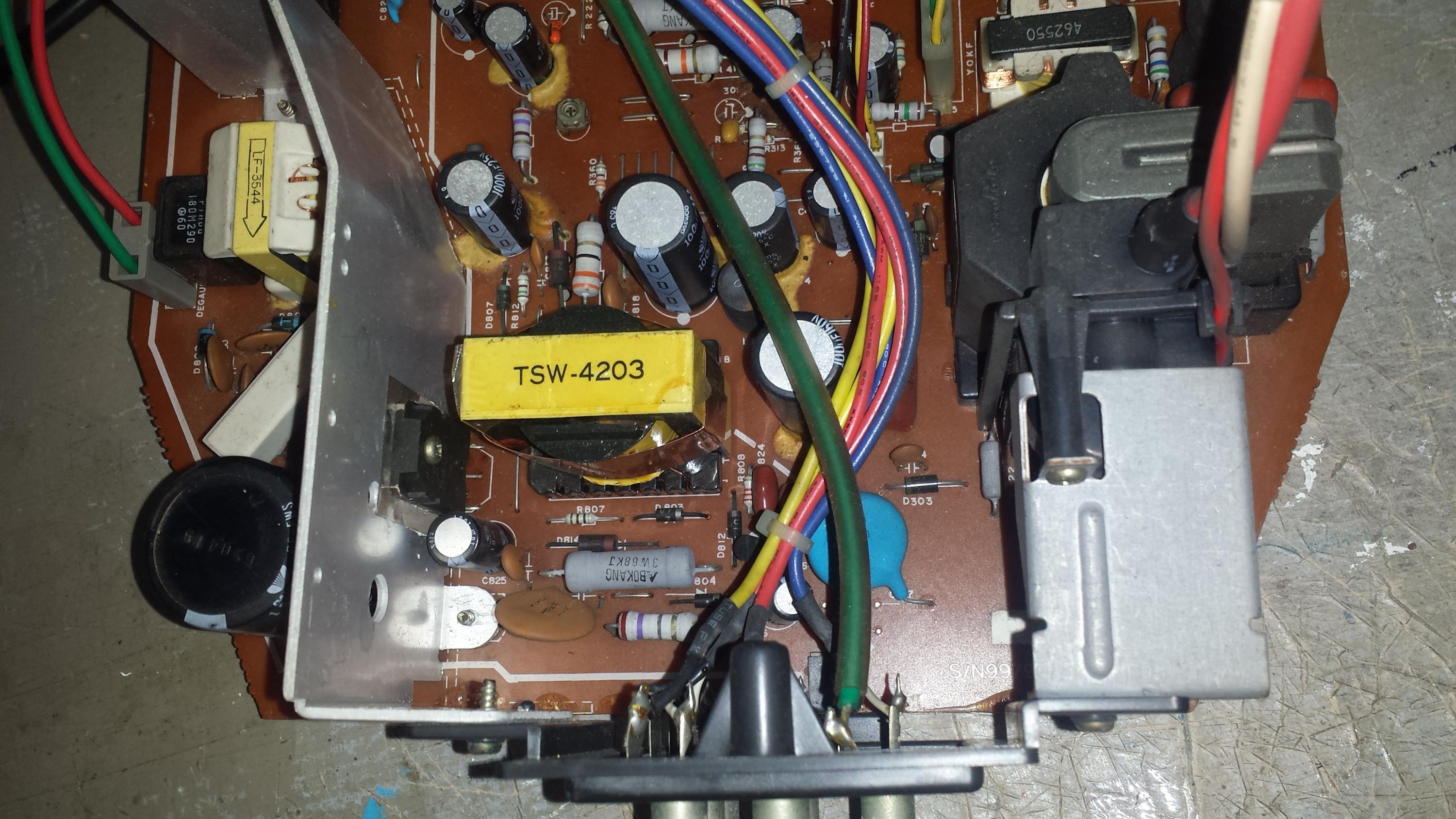

      Thank you RJ,l. I have had a few sucesses recently and it would be nice to sort this one seeing as its posibly something minor causing it. Ive taken some pictures for you so can you point out these 2 caps in the primary to me..Can you point out the Secondary section.
      I really do need to be able to identify these areas now that I am doing so many PSU's now.

        May be you should also upload the service manual.

          The transistor Q402 shows a short between the base and emitter when its in circuit. Should I remove it to check it or is this enough? Plea Here is the service manual but remeber this is for a NTSC model and mine is a PAL model. se point out where the primary area is..

            Q402 short between base & emitter is normal, you are measuring the horz. drive transformer, no short between e - c is good, The transistor is likely ok.
            Start by check in for voltage on the main filter cap. C803, then do you have voltage on pins 4 & 5 of the power supply transformer
            The cap I thould could give no start of the power supply would be C806 and maybe C825. Have you checked the board for poor solder connections? Parts like large resistors get hot and over time the solder goes to hell, transformer pin connections also get weak overtime.
            Are you getting any voltages from the power supply?

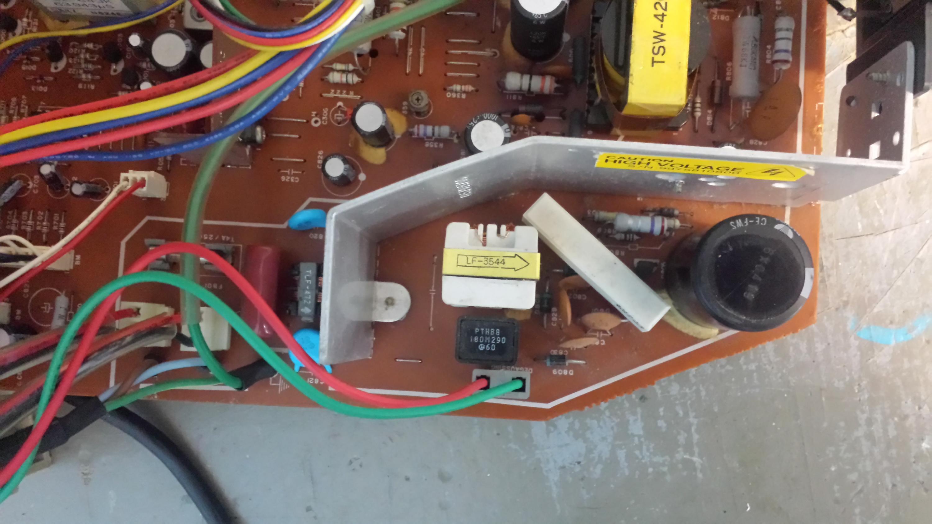

            The primary side is anything within the white line where the power cord connects to the board

                  Checked all you said RJ and everything is OK and those 2 caps are within tolerence. Ice also resoldered many contacts especially around things like the LOPT etc. I cant see any bad looking joints and those that look a bit dull I have resoldered. There is quite a bit of flux on this board but the joints look good.

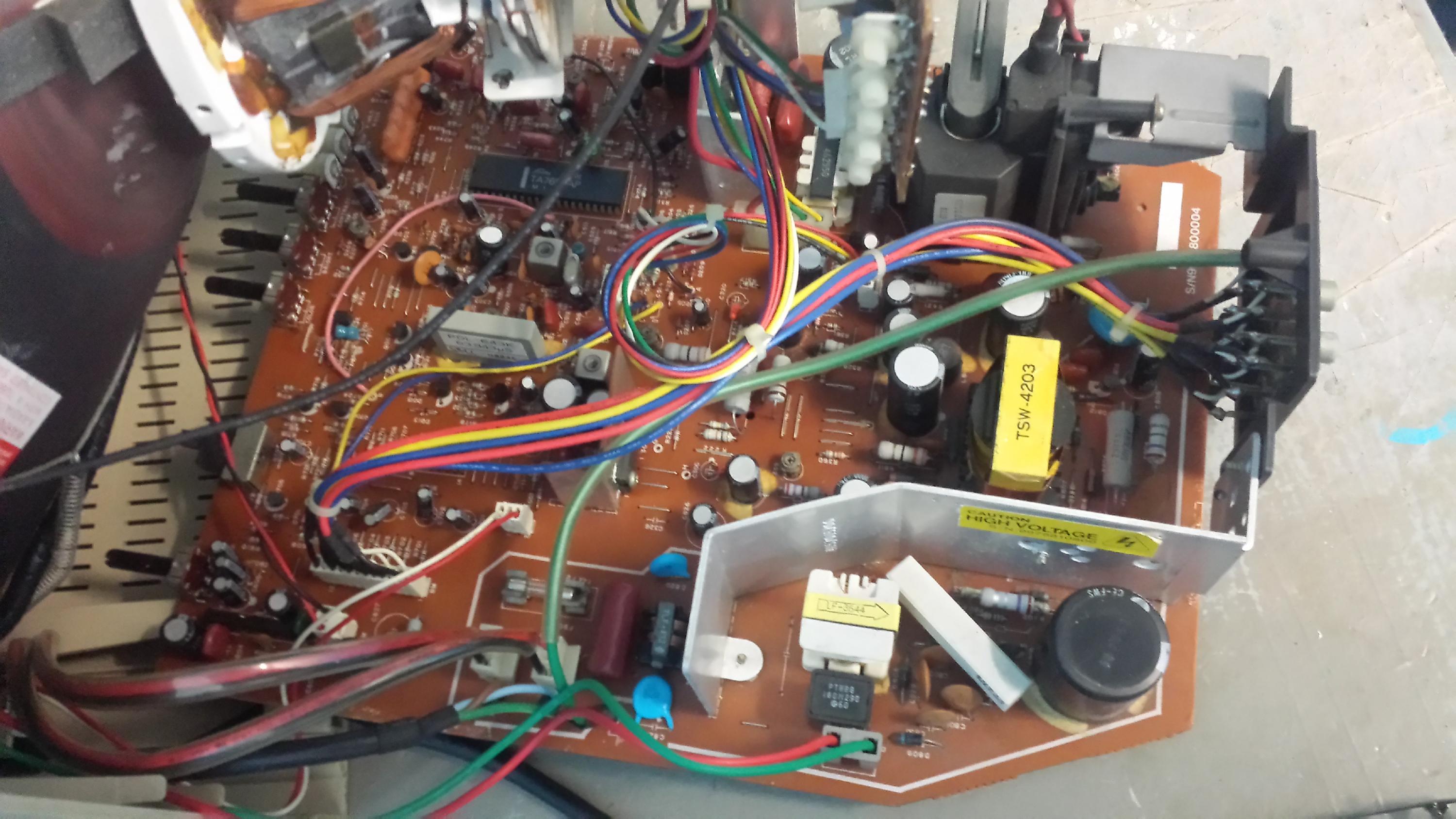

                              RJ there is voltage at the filter cap and on pins 4 & 5 of the LOPT. No voltage anywhere else like 12v or 5v. I can only get 240v AC.

                                I think I read the pins wrong on the transformer, It should have been pins 4 & 2 (the primary winding) Do you get any other voltages on the str54041 Pins 1, 2 and 4 ?
                                You could also check those resistors in that primary circuit, maybe one of them is open.

                                      I just asked to check Q402 to see if it was shorted, you checked it and measured a short between b-e which is normal, you were measuring the horizontal drive transformer secondary. I assumed there was no short e-c since you did'nt say.
                                      There are two (2) secondary voltages produced by the power supply.
                                      One is 12 volts from D807, the other is the B+ 121 volts from D806
                                      Check if they are there or not.
                                      Pin 3 of T461 (horizontal output transformer) will have B+ 121VDC, Caution measuring pin 1, it will have ~120 VDC, BUT if the horizontal circuit is working it will also have 1~1.5KV of 15khz AC

                                        I cant get any voltage from D807 or D806. Thats using both AC & DC and connecting black proble to a heatsink which should be a good ground. Or should I have reversed the probes as well with it being on a diode.Something interesting when I powered it up this time It made a slight bong noise and and you could hear it power up. Dont remember if it was doing that before.
