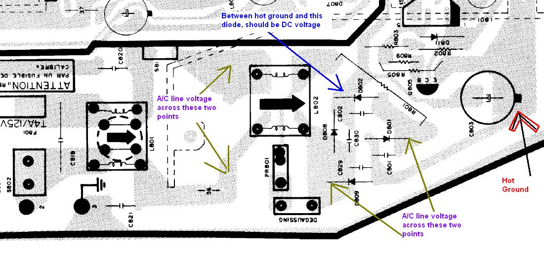

    The sound (bong noise) is the degausing coil, mesure the DC voltage across the filter caps, C814 (12v) and C813 (121V) the heatsinks may not be grounded. If there are no voltages, then its time to start checking on the primary side.
    What voltage do you measure ACROSS C803? If you have voltage across C803, leave your negative meter lead on C803 negative and with the red probe check the voltage on T801 pin 4 and pin 2
      Couldnt find C814 anywhere until i noticed it was a cap labeled as R814. Anyway no voltage across C813 & C814 and no voltage between C803 and pins 4 & 2 of T801

        Re: Help with dead Commodore 1802
        So you have 0 voltage the main filter capacitor, that does'nt leave much, Check the large 3.3Ω 10 watt resistor R801, it must be open or has cold solder connections

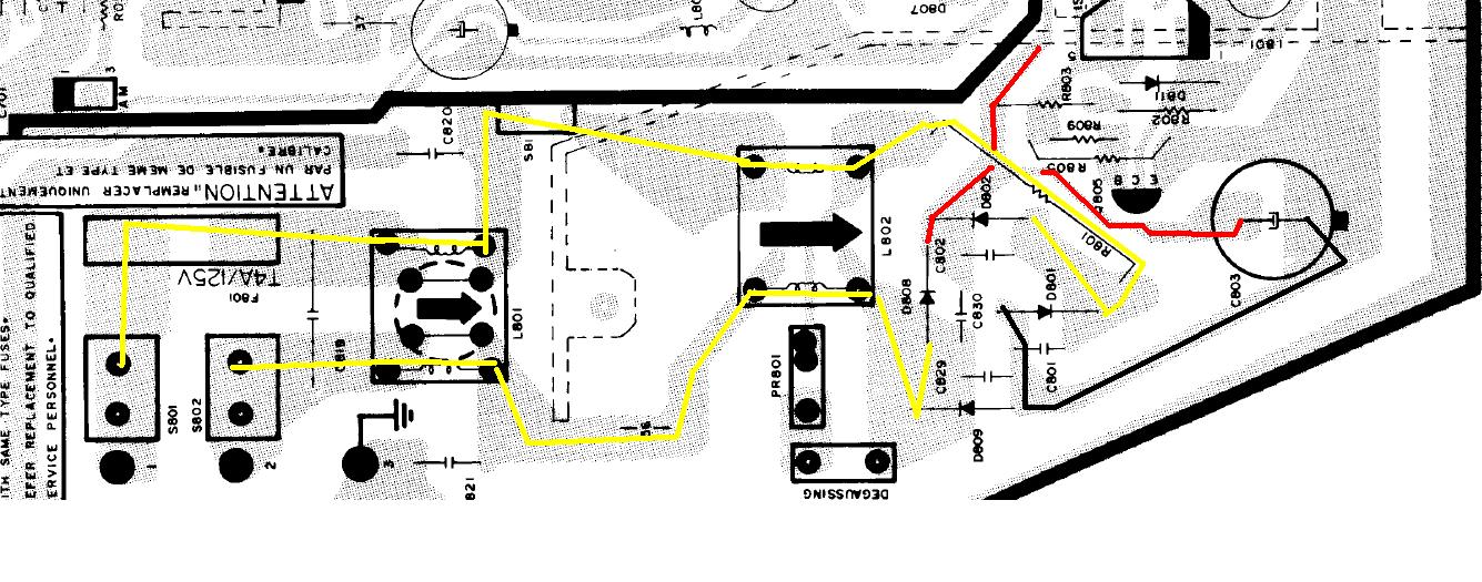

          R801 is open circuit and registers nothing on any scale.
            I only had a 4.7ohm wire wound resistor here and ordered some I thought were 10A 3 Ohms that were actualy 3.3ohms. Ive got another 10A 3ohm one comming and be here in a few days or so.

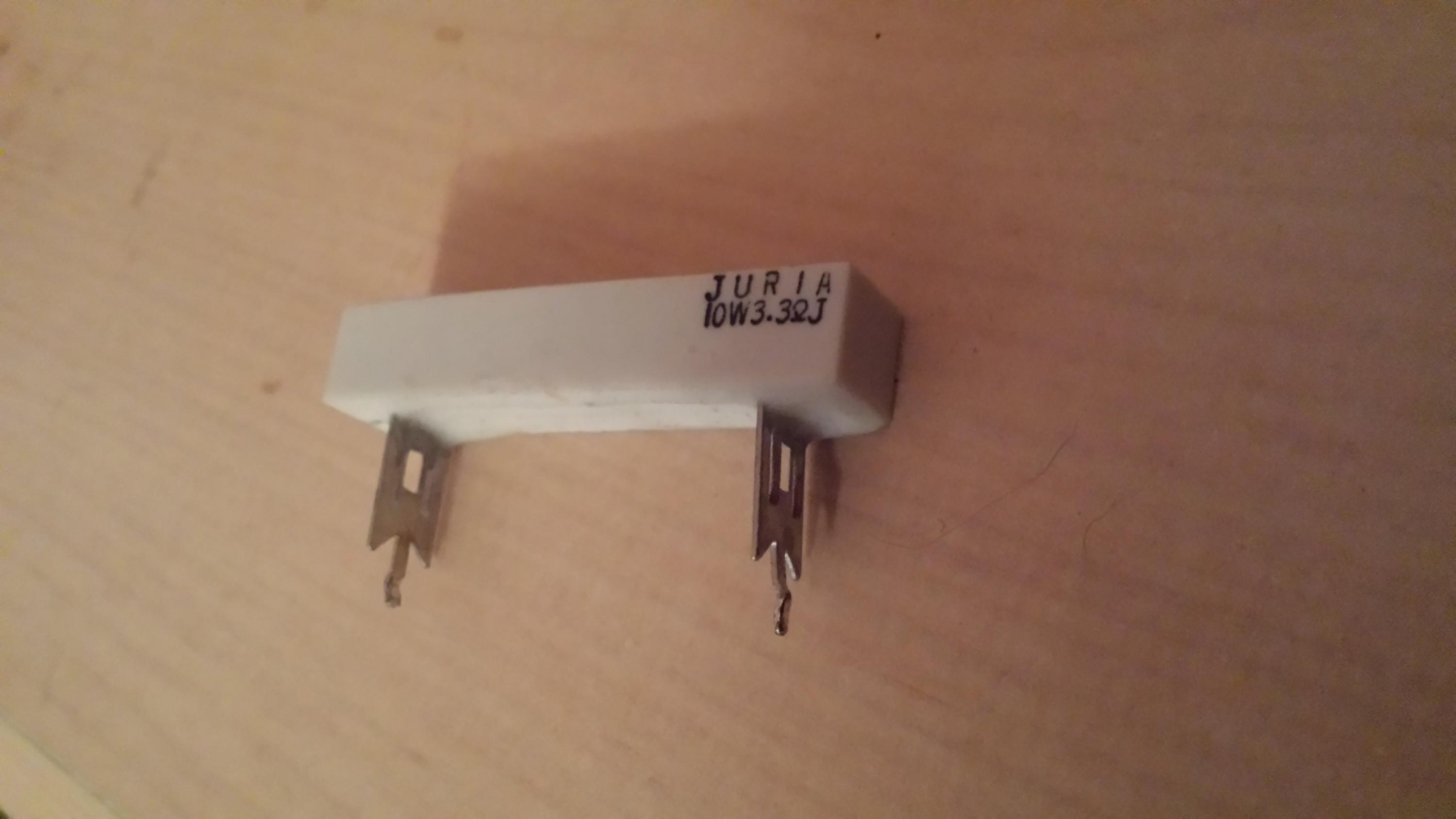

                  Its a large white oblong ceramic type.
                  Could it be just age and maybe being left turned on for hours because I accidently did that when I left it on overnight one night by accident. It was after that I found it dead.

                  • roadrash
                    • Oct 2015
                    • 494
                    • U.K.
                    #29
                    This is it. Is it. What type is it?

                      you cant tell without breaking it, but you rarely get wirewounds used on ac because the coil radiates interference.
                      btw, the replacement needs airflow under it, what we used to do is solder the new one on top of the dead one so it still stands high off the board.
                      that or use ceramic spacers.

                        It will be a wirewound, this from digikey should work A137101-ND Mfg # SQZW103R3J which seems to be like the original. TYPE SQZ horizontal, pluggable.
                        They go open after time, the wire gets a weak spot and thats it, If there was any other problem it would have blown the fuse and not the resistor.
                        If you just want to try the monitor, replace it with a piece of wire, if there is a short anywhere the fuse will blow. or if you want to get fancy replace it with a incandescent lamp to test

                                    I fitted a 3.3 ohm wire wound resistor and as soon as I powered it up it blew it again.
                                      It blew the 3.3Ω 10 watt resistor! but not the fuse? Ok check the 4 power supply diodes, then check the resistance across the main capacitor. You must have a dead short somewhere in the primary circuit
                                      Post a picture of that new resistor that blew open
