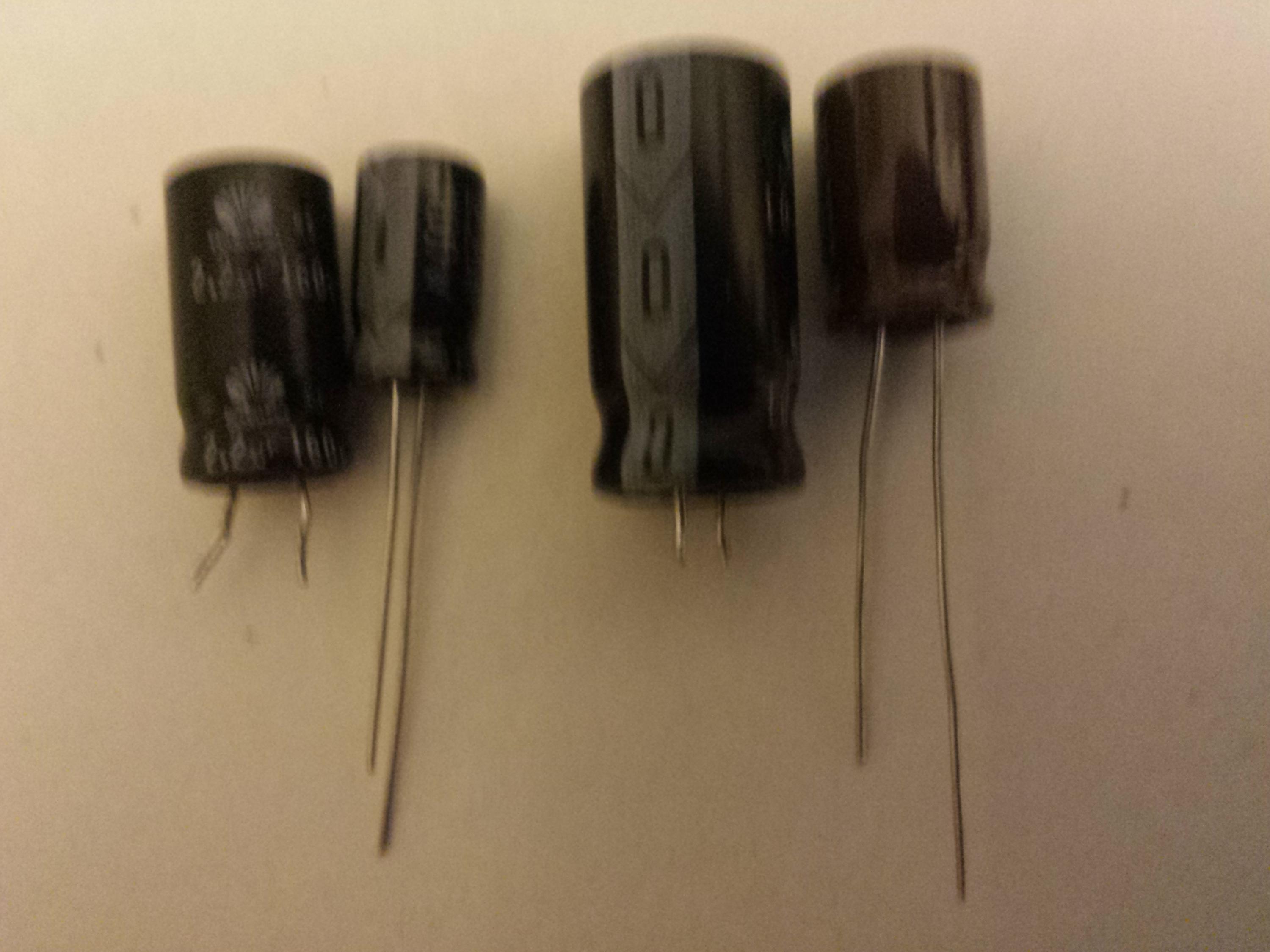

      I ordered the two caps as suggested and they arrived today. However I was shocked at how much smaller they are than the originals. WIll this be OK or should I find some others a similar or nearer size.

        Hold them up to the monitor so I can see them I'm sure they will be fine, With newer technology they can make them smaller as long as the capacity and voltage is correct they will work.
        Check the new 2.2/160v capacitor [C806] on your meter just to see what it displays.

                  Ok here is comparison picture. They are about half the original size.
                  • R_J
                    • Jun 2012
                    • 9532
                    #149
                    Re: Help with dead Commodore 1802
                    They will be fine

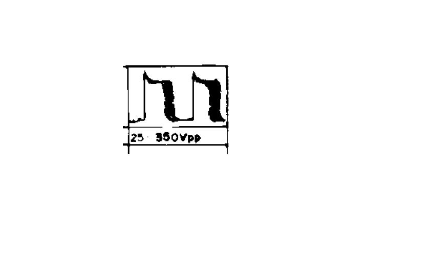

                                      #158
                                      Did you have any voltage on either of the secondary capacitors, C812 or C814?
                                      You could try disconnecting L806 and see if you get any voltage on C814. This would lighten the load the power supply has to supply and if it is going to work. Or leave L806 connected, and disconnect L805 and place one of your lamps across C812 and see if it lights.
                                      This power supply needs to generate a square wave to drive the regulator ic 801. If there is not enough voltage on C803, the cpapacitors, C807 and C825 do not charge enough to make the circuit start to switch (like a flip flop circuit)
                                      Q805 and Q806 generate the square wave that is applied to ic801 pin2. Then ic801 pin3 switches on and off at about 20khz and produces the 350 volt peek to peek waveform (number 25). at pin 2 of the transformer.

                                          Check if ic801 is shorted, pins 3 to 4
