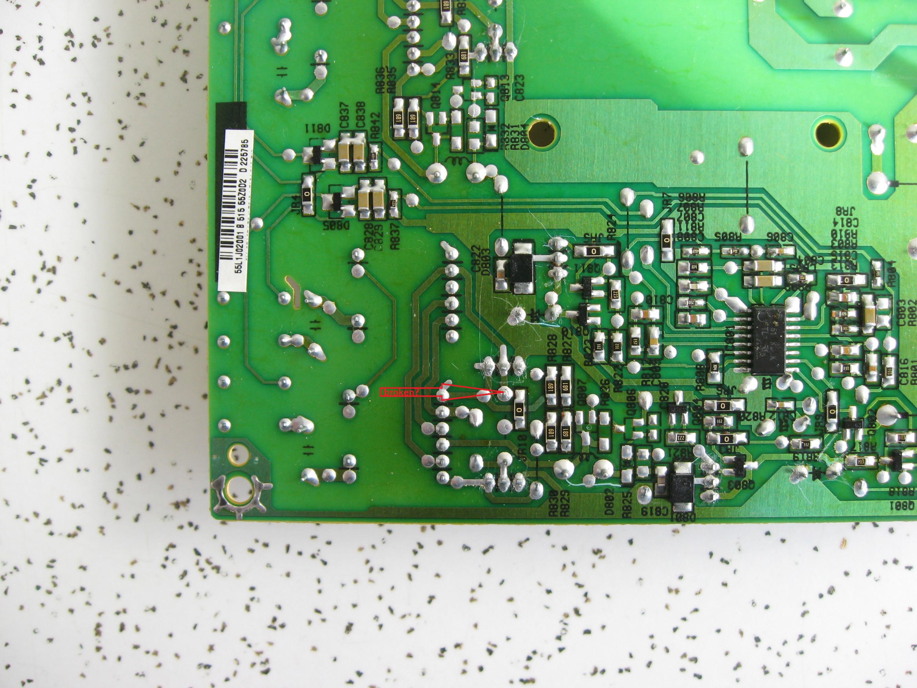

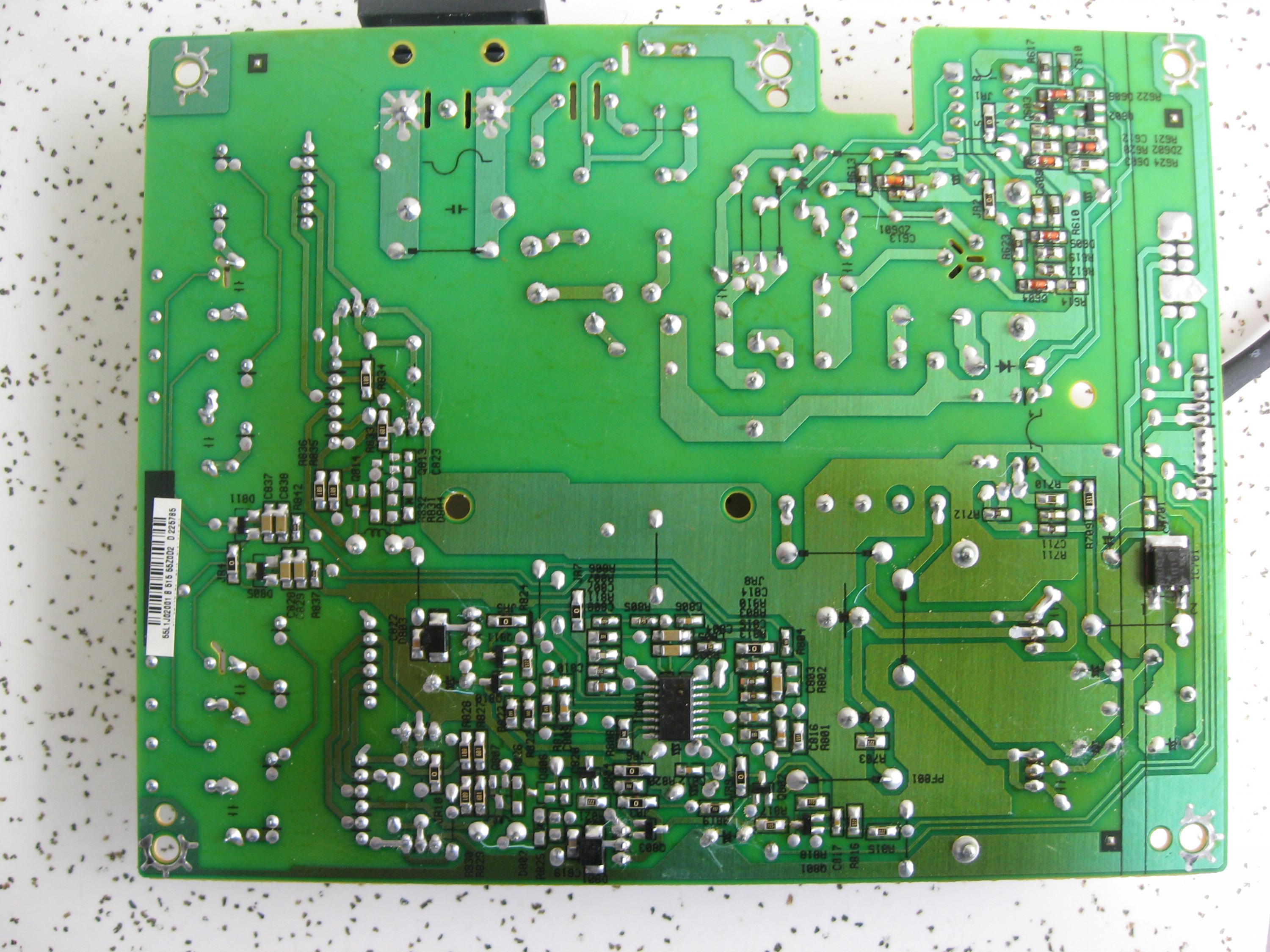

            In all this thread I cant actually see a decent picture of the main board.
            Can you post one - both sides of the board. Is the power switch cable connected to the main board?

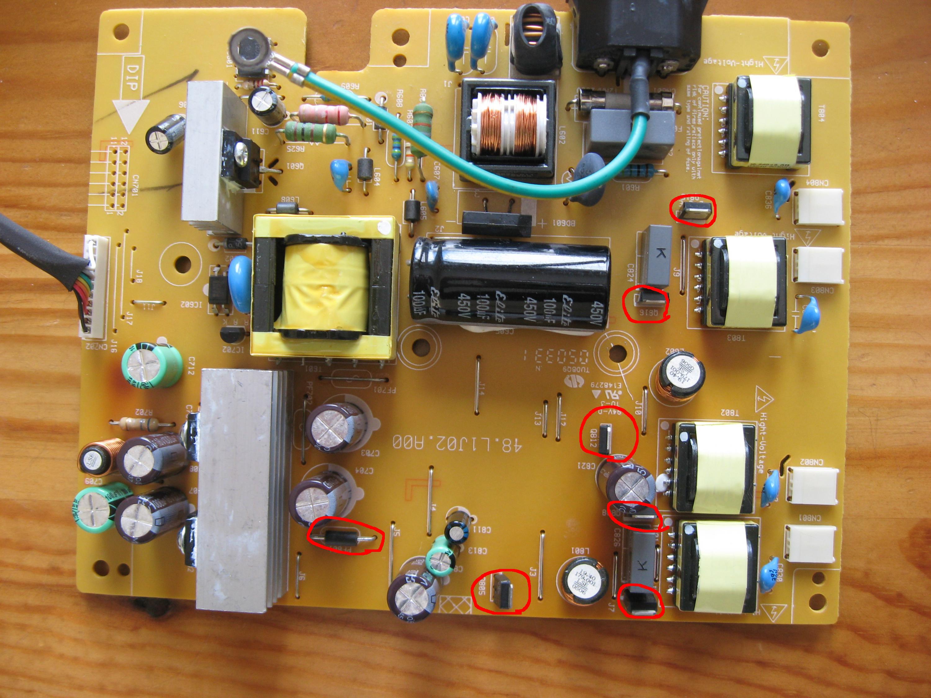

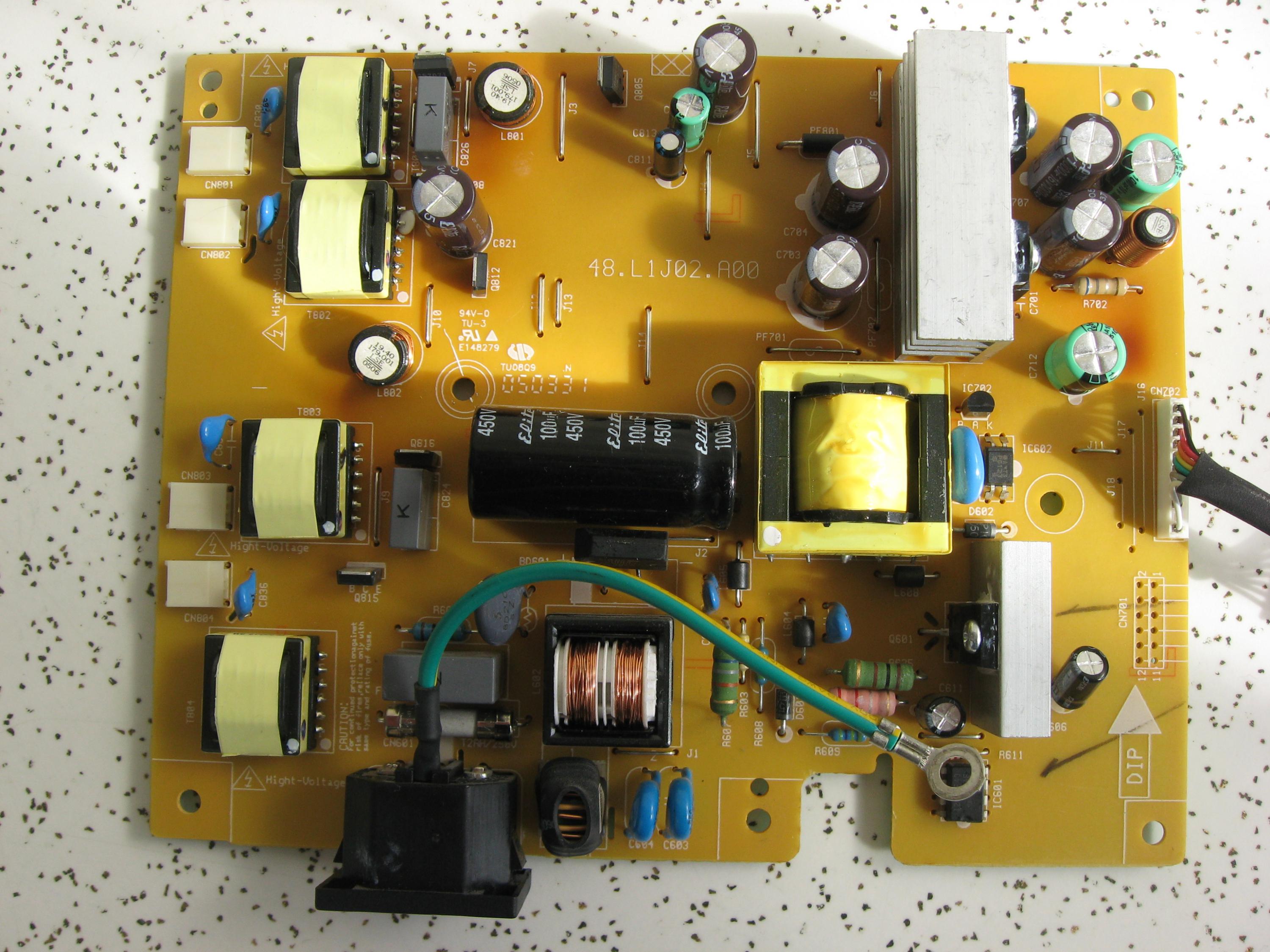

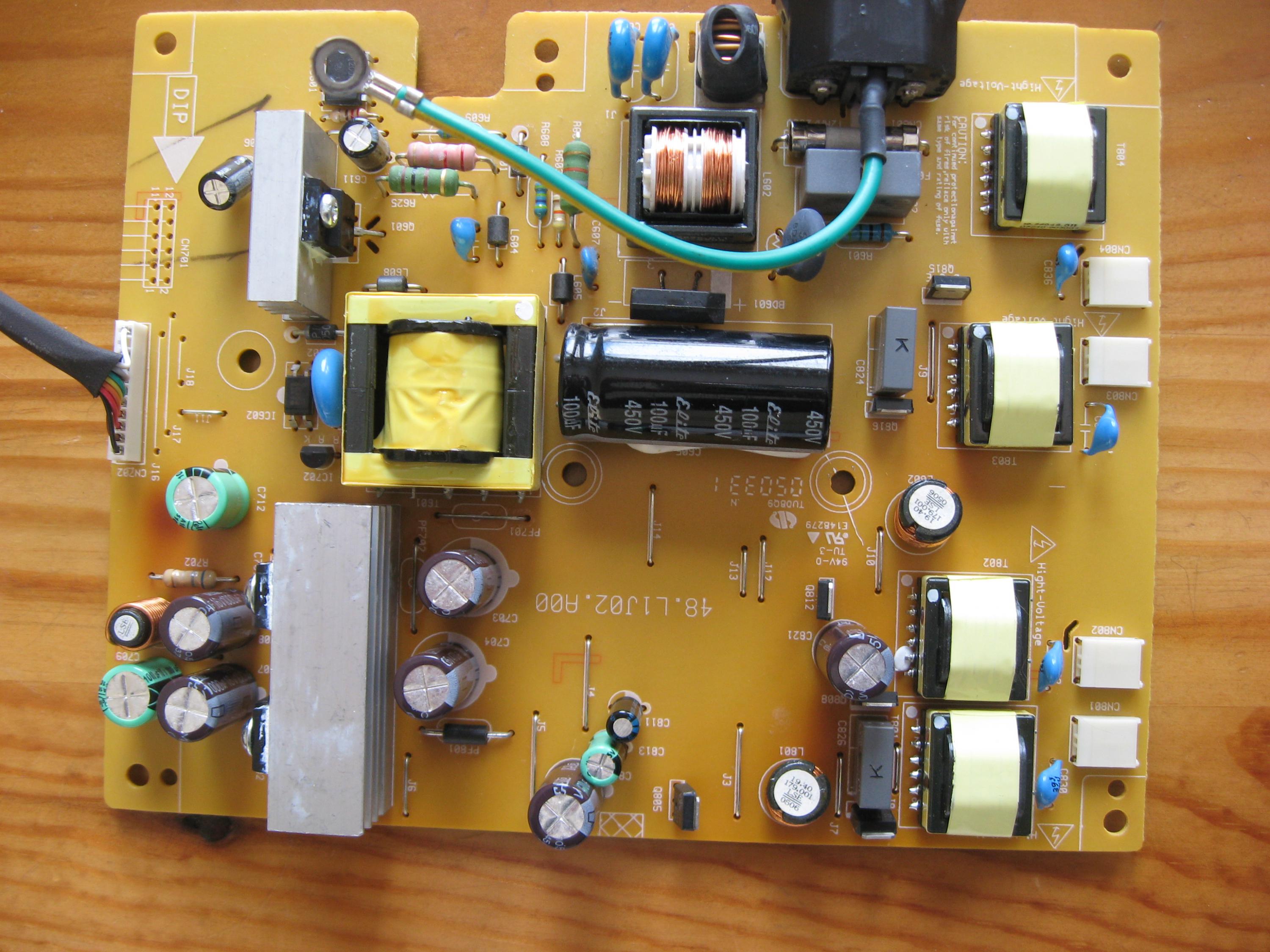

                        here they are

                          First test the fuse PF801
                            #153
                            Re: LCD 19" BENQ T905 problems
                            Check the black fuse PF801 which supplied the B+ to the backlights inverter circuit, it should be <1 Ohm.
                            This board is also know for bad solder joints, especially around the Inverter transformers, C5707 transistors and MOSFET q805/812, etc. Those transistors should also be checked for shorts or low resistance leakage.

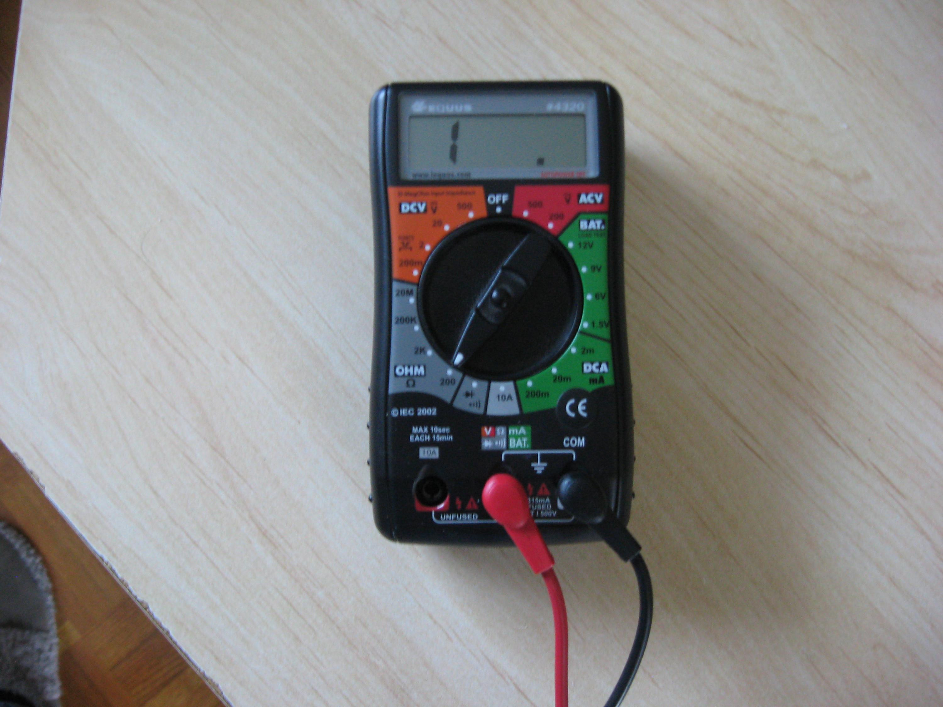

                                  ok i set my multimeter on 200 ohm, and when i check pf801, it stays at 1
                                    #157
                                    1 Ohm? or over range? Touch the two probes together and tell us what you read, the fuse should gives about the same reading, it sounds like the fuse is open.

                                      so
                                      q808 and q809 give me reading of
                                      leg1 to leg 2 03.4
                                      leg1 to leg 3 03.0
                                      leg2 to leg 3 00.8
                                      q815 and q816
                                      leg1 to leg 2 1
                                      leg1 to leg 3 1
                                      leg2 to leg 3 1
                                      q805 and q812
                                      leg1 to leg 2 1
                                      leg1 to leg 3 1
                                      leg2 to leg 3 1
                                      so if i understand this correctly, my pico fuse pf801 is dead so are q808 q809
                                      and c826 has a broken soldering ,
                                      am i right, what else?
                                        if i touch the prob together i get 00.3, but on the fuse it says 1 so i think it means over range, check picture

                                          That fuse is open, then you need to check those transistors/MOSFETs for shorts/low Ohm, it looks like you do have some with low Ohms readings. Remove them and test them off the board.
