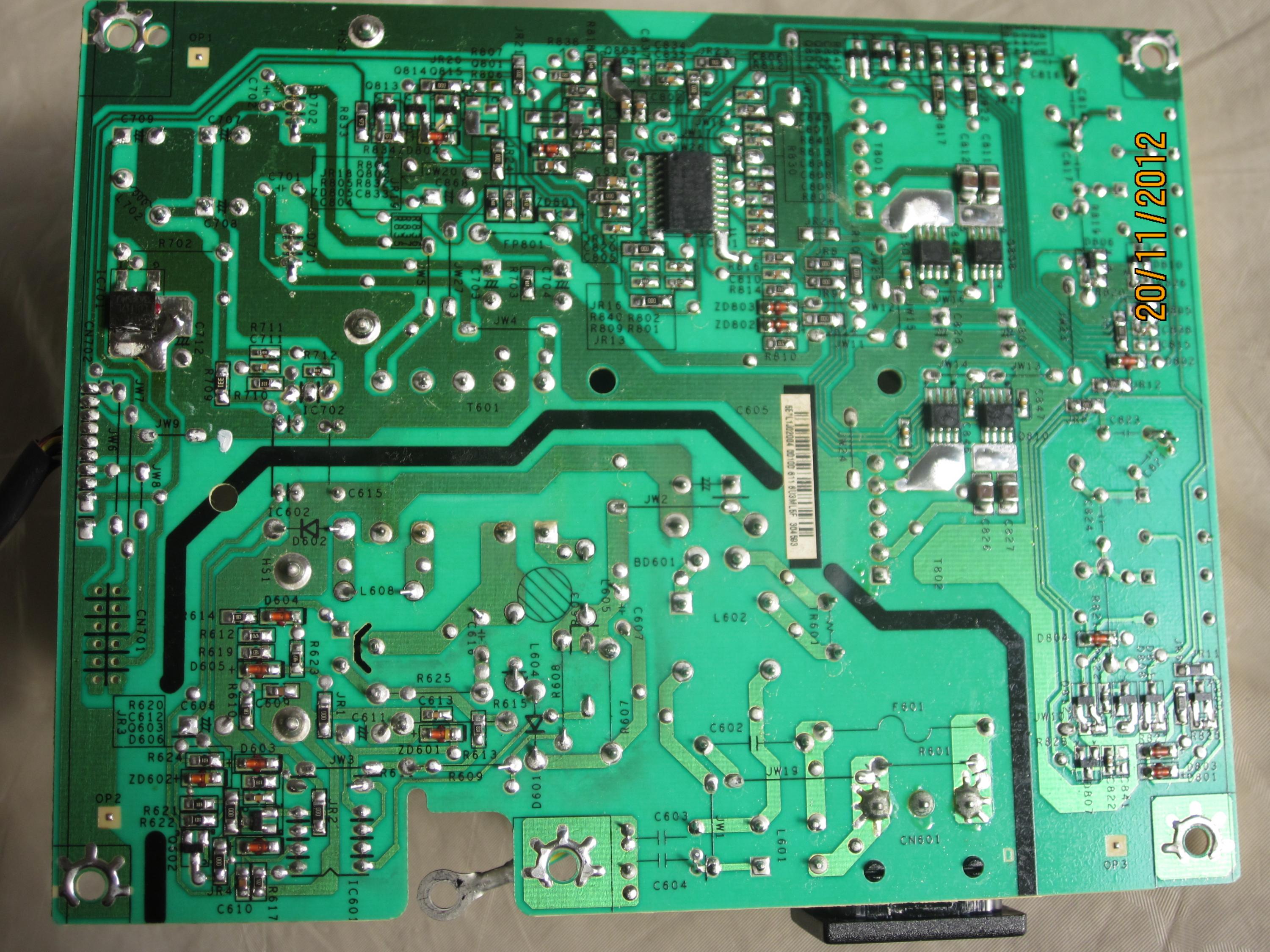

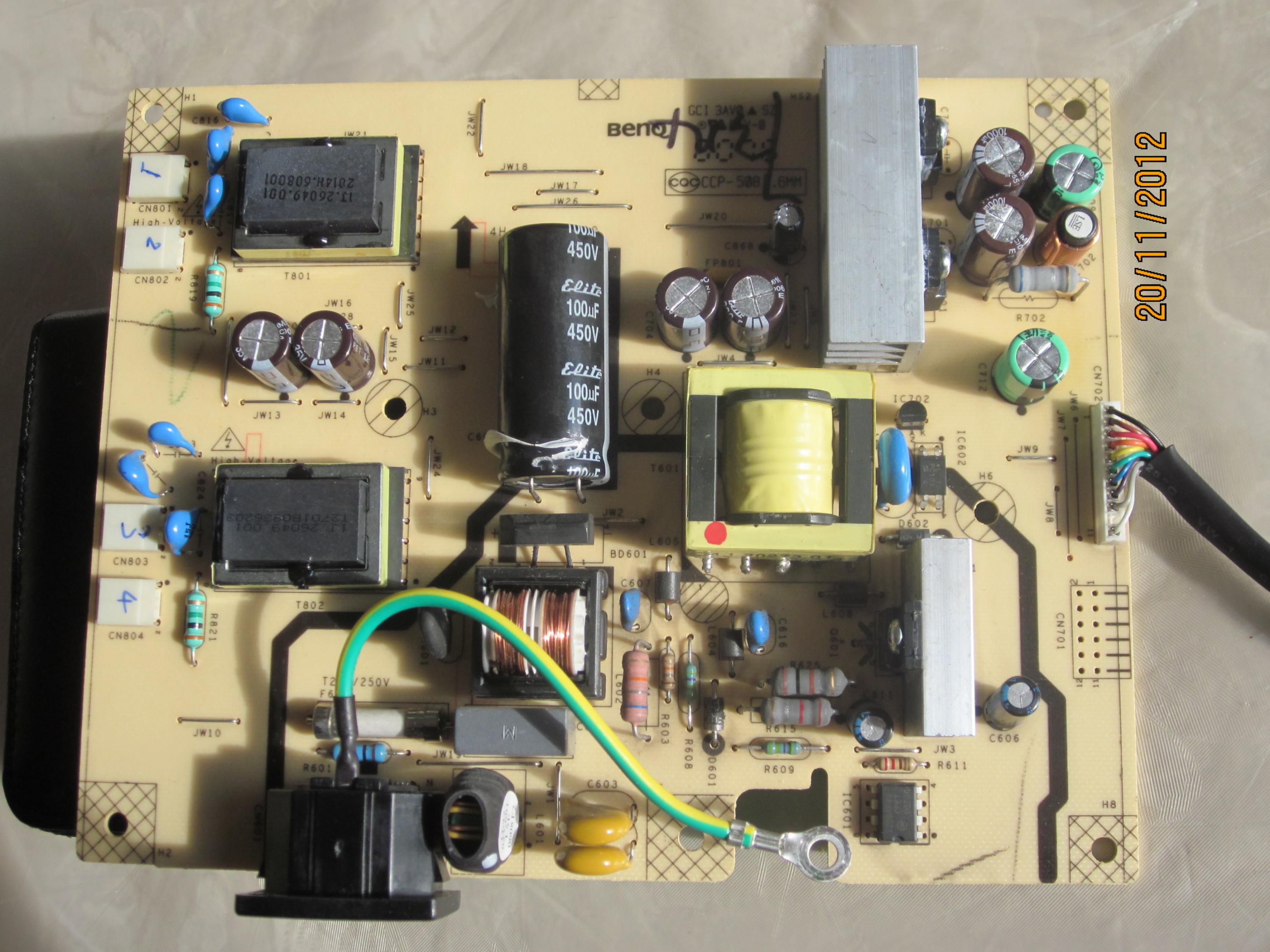

                                    My LCD 19" BENQ T905 has the same problem: no power and no light of the power led. I checked that all the caps are ok (not blown), fuse is not broken, all the IRFU9024 have no any fried evidence. There is voltage on the 400 V cap when connect the power plug. Any one can help me to restart the monitor?

                                      What voltage on the 400v cap?
                                      Which fuse?
                                      We need pictures
                                      Welcome to the forum-
                                      We can help a lot more if you please post good clear pictures of the whole chassis, and then pictures of each board, front and back and close up of connectors, (max resolution 2000x2000 and 2MB) using the manage attachments button, which is found by clicking "go advanced" under quick reply.

                                        Re: LCD 19" BENQ T905 problems
                                        Dear Selldoor,
                                        Thanks for your quick reply. The voltage on the 400v cap c605 = 316V.
                                        the 2 fuses measured on board are 0 ohm for f 601, and 0 ohm for the picofuse fp 601 respectively. I attached here the pictures of board both sides. Please help me to find the problem and give me instruction for resolving it.
                                          Dear Selldoor,
                                          the 2 fuses measured on board are 0 ohm for f 601, and 0 ohm for the picofuse fp 801 respectively. I attached here the pictures of board both sides. Please help me to find the problem and give me instruction for resolving it.
