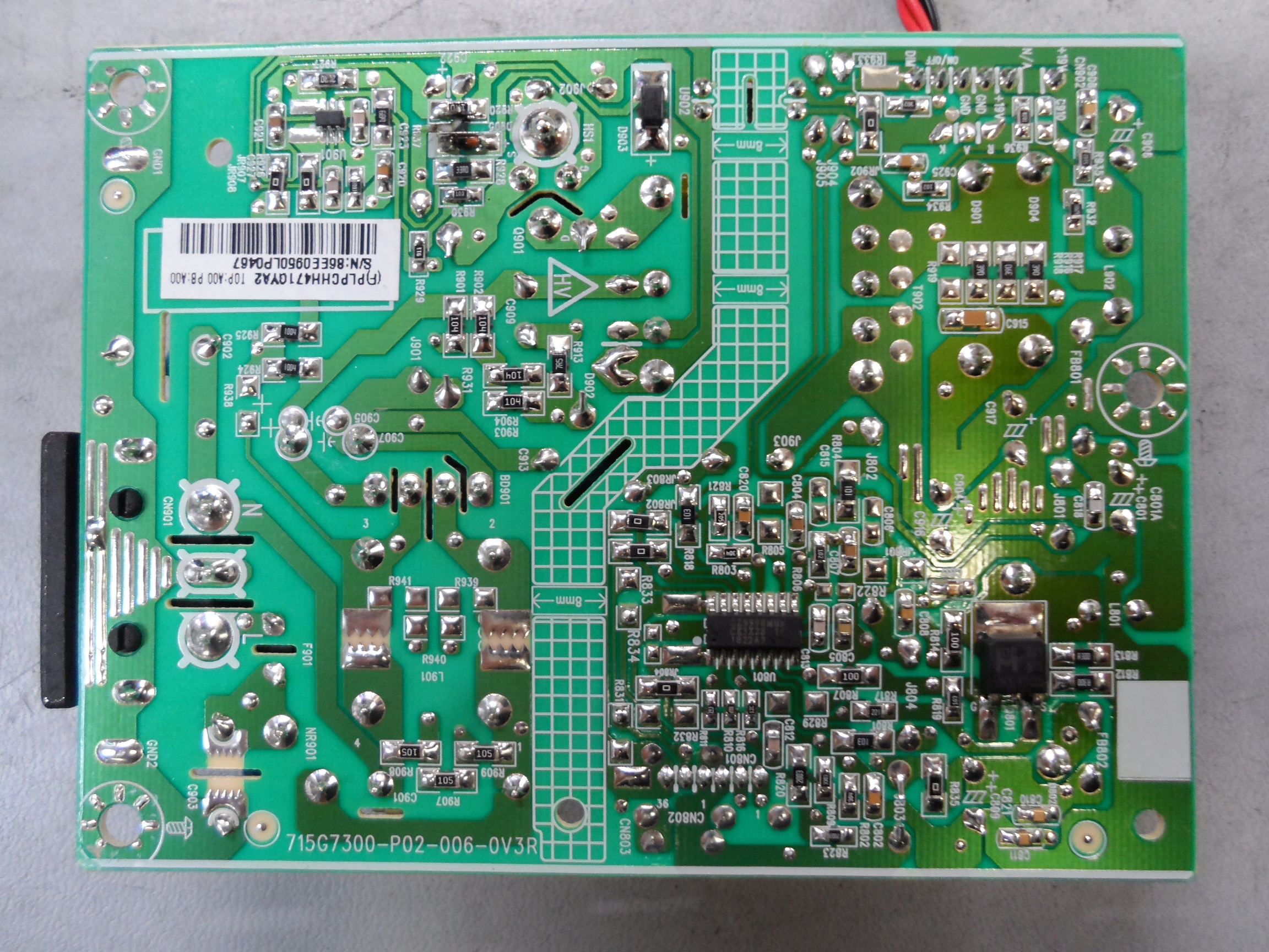

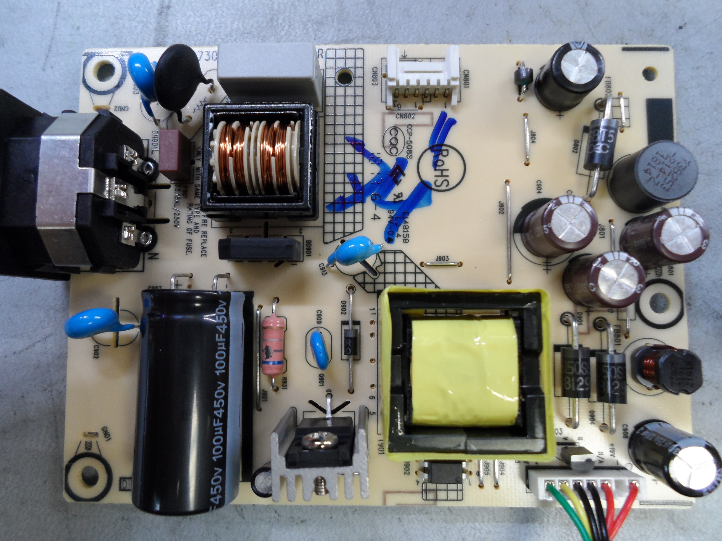

    Hi all, I am looking for some help in ID'ing some parts in an attempt to fix a power supply from a GW2780-T monitor. The power supply PN is 715G7300-P02-006-0V3R. I have been looking around for the PN and it appear the board was used by other OEMs as well (ASUS, Viewsonic). If anyone has a schematic, it would be helpful.

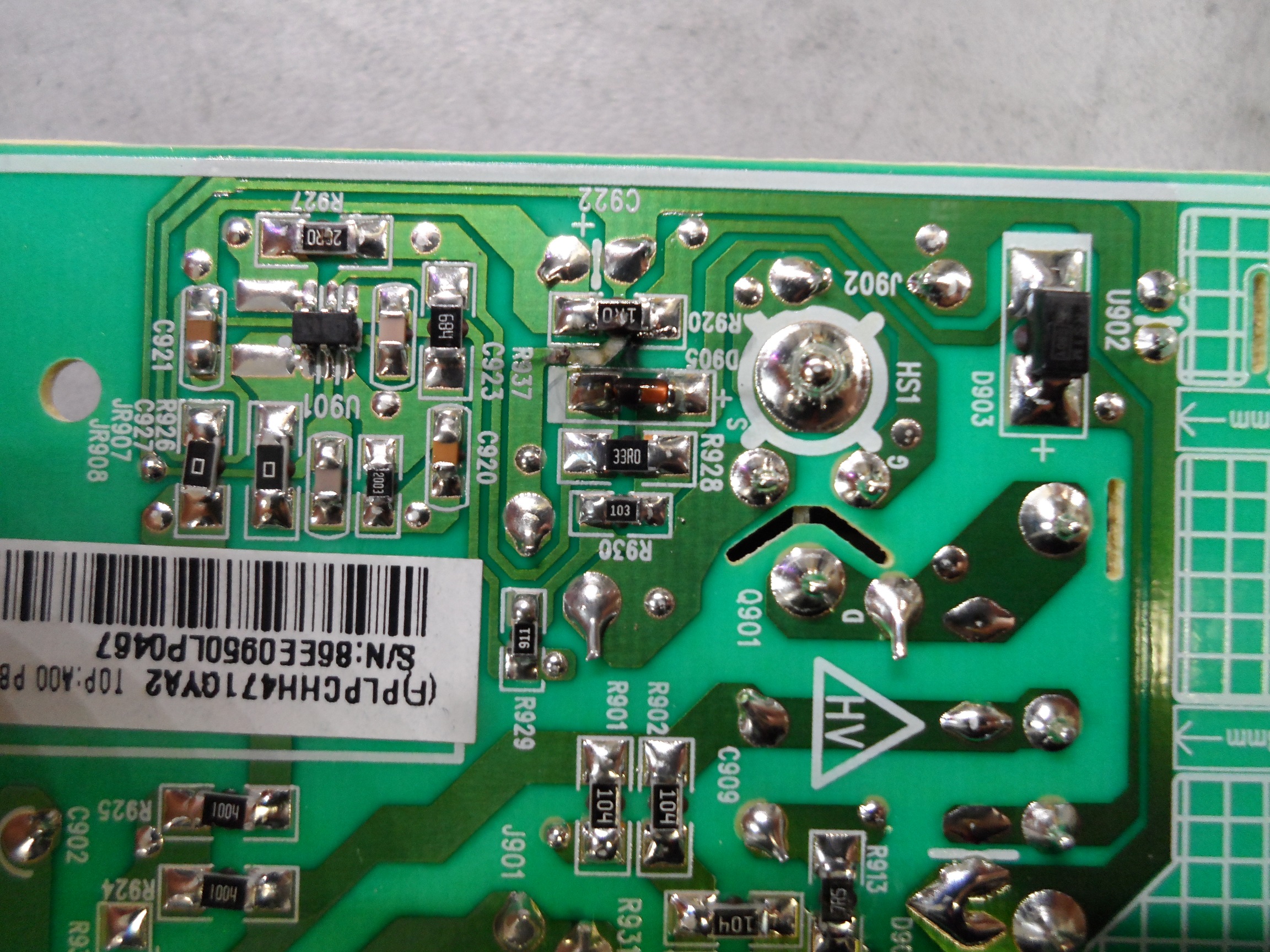

    Quick look on the underside of the board, I can see:
    -D905 is blown - ? value
    -R920 is open - 1Ω ?W
    -R927 is open - 20Ω ?W
    On top side, I see:
    -R931 open - 0.68Ω ?W
    Metered short:
    -P9NK65ZFP
    Thank you

    D905 will be similar to a 1n4148, the wattage for R920 & R927 will be low, (1/8w?) they are in the gate drive circuit so there is low current. R931 is likely a 2 watt, but U901 will also be bad. And C922 is likely weak as well. Check that none of the diodes in the secondary are shorted as well.

      Thank you so much for your advice! I placed order for the parts. Hopefully I can get them soon and swap them in for additional testing.
