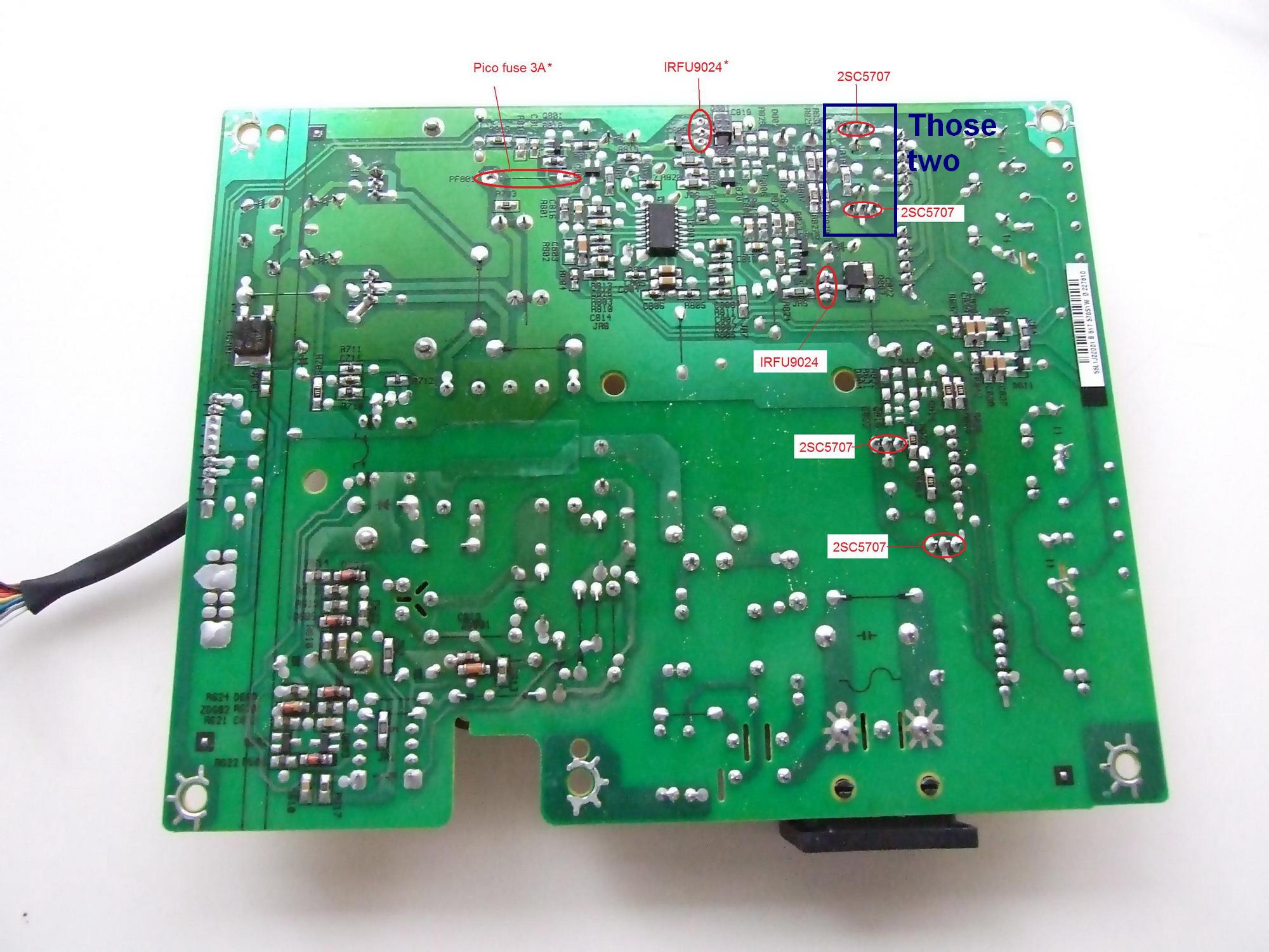

        Ok,found another blown transistor.
        I have marked them on the pic attached.
        Between them there is a gray box called C826
        Is like the 2nd pic attached.
        It has a "K" on top, and on one of the sides reads:
        R75 MP
        .22 160
        T2 05MLK13
        What type of capacitator is? Which mesure? Is there any way to test it with the multimeter?

            #45
            Re: LCD 19" BENQ T905 problems
            Yes, that I is what I meant by fail in pairs.
            http://en.wikipedia.org/wiki/File:Condensators.JPG
            http://en.wikipedia.org/wiki/Capacitor#Capacitor_types
            This picture is much better than the original. In the original, we could not see the entire board because of the angle.
            That is why clear focused top down view pictures are so valuable.

                  Maybe the guy misspelled it and added a 0?
                  AFAIK 220nF = 0,22 micro F

                  On top of the cap there is a "K".

                    Ok, after changing the blown transistors and fuse, and replacing all the Elite caps I tested the display.
                    It showed the BenQ logo!...but it just stayed for 2 secs, and it wasnt properly lighted, like if the brightness was low.
                    Between those 2 secs, there are some artifacts, like color inverted image,etc..
                    Also, the display started to stink a bit, so I disconnected it.
                    What can it be now?

                      Did you resolder all the transformer pins and other components as suggested in post #21?

                          What retiredcaps is talking about are the 4 inverter tranformers. If you look at the first photo in post #26, they are the 4 small square yellow boxes on the left side of the photo. You should use desoldering braid to soak up the old solder from the transformer pins and then apply new solder. Do this for all 4 transformers.

                              Ok, so I was going to resolder the transistors today,but tried the display first.
                              Its broken again
                              Guess Ill have to change the fuse and the transistors again
                                #55
                                Read post #21. Look at the very last sentence.

                                  Ok, my mobile is working again.
                                  Took photos of 'problematic' bits:
                                  Code:
                                  Photo number. Description
                                  1. Those are the transistors that were originally blown.Theyre blow again (the left arrow actually indicates the trans,not the cap :p)
                                  2.The bottomside of those transistors.Those 2 yellow points,are bridged (they have continuity and the polimeter beeps with the diode/continuity beep setting).
                                  Im not sure if they should be bridged... One is a pin of the 'K' cap of the 1st pic and the other one is a SMD named "JR10"
                                  3.Those are another bridged point.The cap pin is bridged with a drop of tin that it was already on the board.I think its ok
                                  4.I tried to compare those bridged with the image posted here, but im not sure, so I marked them
                                  5.Two new blown transistors.I dont know if they were blow before, but theyre now.They have a heatsink and theyre glued to it.
                                  Also, theyre special and are larger with a hole for a screw. Its one piece, I mean its not a transistor glued to another one. Wonder if I will be able to buy that type of transistor...Also, I dont know they ID, but I guess the guy in the shop will know.
                                  6.Those are the things I have to resolder right? Are they marked correctly? What are those two things marked as '?' ? Should I resolder them also?
                                  7.Finally, this is the bit I said it was burnt.but the transistor under it its fine.

                                    Yes, because you chose to ignore 3 people telling you 4 times to resolder the transformers. This problem with the Benqs has been known for about 2 years now. When people say you *must* resolder the transformer it is because they have experienced what you have.
                                    We can lead a horse to water ...
                                    Here is the technical explanation why the transistors short out.
                                    https://www.badcaps.net/forum/showpo...&postcount=269
                                    A poor analog might be the following (I can see PlainBill shuddering right now). Imagine a car engine as the transformer. When the bolts holding down the engine are loose, it shakes all the components of car.
                                    You take the car to the mechanic (Eric the car guy). Eric says I can fix the loose radio, loose hoses, loose steering wheel, etc from all the damaged caused by the engine for $500.
                                    Eric also HIGHLY recommends that he rebolts and remounts the engine. It will cost $1000. You balk. 2 days later, the engine causes the same damage. This time Eric charges you $1000 because the engine caused more damage than the first time.
                                    Eric again recommends remounting and rebolting the engine, but this time it is $1500 because of more damage. You balk again.
                                    And so on ...
                                    2.
                                    If you follow the circuit green pcb trace you should be able to tell if they are on the same circuit path or not. If they are, then it is not a problem if they are bridged.
                                    I started here on these forums back in April 2010, but I can't remember a single case where a bridged connection has been documented as a problem.
                                    I asked a similar question. See
                                    https://www.badcaps.net/forum/showth...+solder+joints
                                    That is a good idea, but be aware that there are possibly many revisions of this board. Manufacturers can change the boards as they see fit.
                                    The picture's angle makes it hard to see, but those are probably dual diodes? They should have 2 diode symbols pointed towards the center.
                                    What measurements did you get for these dual diodes?
                                    Yes, resolder those. L indicate an inductor. T is a transformer.
                                    Some browning is normal. As long as the transistor underneath tests okay, it is fine.

                                      One other suggestion.
                                      Once the new parts come in, check them all out of circuit to ensure they are good.
                                      When you get all the repairs done, put away the monitor for 2 days. Come back 48 hours later with post #21 printed and go through each sentence top to bottom and bottom to top (i.e doublecheck all your work).
                                      That will give your brain some time to process the repair.
                                      Additionally, BEFORE you power up. Doublecheck all the components again to make sure they are soldered in properly, oriented correctly (not backwards) and retest them with your mulitmeter "in circuit".
                                      Then and only then, apply power.

                                        If I didnt resolder the transformers, its because I wasnt sure which ones were them, until jetadm123 pointed them out.
                                        That being said, I also didnt research more, because after checking that the fuse and the transistors were blown, I thought that those were all the problems the PCB had.
                                        One thing im still not sure:
                                        Code:
                                        Desolder all 4 transistors and the polyester caps (between the transistors
                                        Is the polyester cap the 'K' cap from my first pic? Theyre 2 so it makes sense, but just to be sure.
                                        About the dual diodes, yes they are.Theyre named "DXXX" and they have this printed on one side:
                                        YG902C2
                                        -->|--|<-- CI
                                        40 121
                                        I managed to unstick them from the heatsink.
                                        But how do I test them? I tried this but I dont know if its correct:
                                        - Black (COM) on 2nd pin RED on 3rd: 400
                                        - RED on 1st pin BLACK on 2nd: 400
                                        Those values are with the diode setting ( -->|) of the polimeter. Other combinations didnt show results.
                                        The things I need to resolder, I just need to unsolder them and sold again with new tin or is there any other action involved? I ask because the soldering on those things seems ok , at least on looks.
                                        One more thing, should I resolder those things marked as '?' on the 6th pic?
