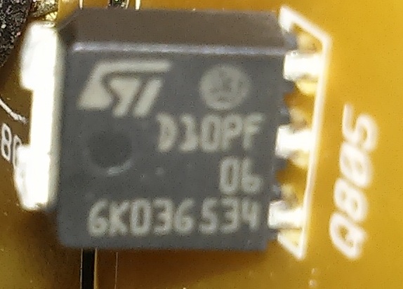

                        Hello everyone
                        First say that I am from Spain and sorry for my English , I am using google translator.
                        My monitor is a Benq T905 . Has the problem of two seconds and off . If I connect it to pc , I see the desktop and two seconds and off, after shotdown continuous green LED and shortly after passing yellow
                        With a multimeter checked
                        Picofuse (PF801*) = 0.04 ohms, ¿Is good?
                        Two C5707 = Bad
                        Two D10PF-06-6K036534 (Q812* - Q805*) = Bad
                        *See Photo
                        I have doubts:
                        ¿Where to buy or compatible D10PF-06-6K036534?, I do not find
                        What Picofuse buy considering that I live in Spain ( 220V ) ? This is good for me?--->Fuse3A 125V. Reading the post 99...Yes, I think so
                        First photo.....
                        Green star = Changed
                        Yellow star = Good
                        Red star = Bad
                        I will change the yellow and red stars , but any suggestions? (Also I will review welds as stated in the manual....A guide on how to troubleshoot 2 seconds to black)
                        Second photo....
                        Is the pic not find it anywhere , any equivalent ?
                        Wrote the best I could , thanks for your time and work. A greeting
                        • jetadm123
                          • 2169
                          #172
                          Re: LCD 19" BENQ T905 problems
                          D10PF-06-6K036534 is probably:
                          std10pf06
