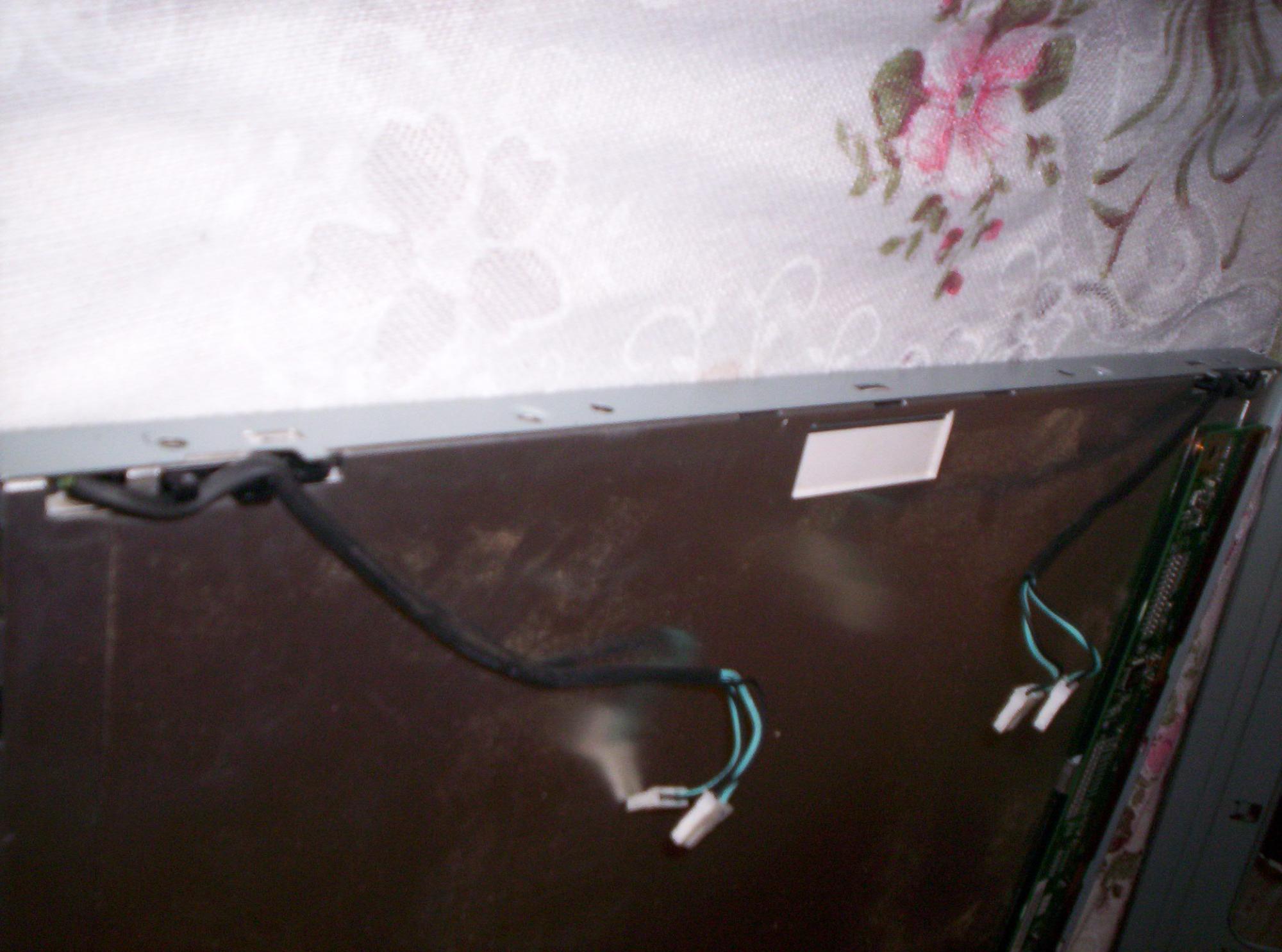

          I connected the display, the pc recognizes it, the led powers on and work normally, etc.Except for the no image,it works correctly.
          I tried to put a strong light in front of the display, and couldnt see anything.

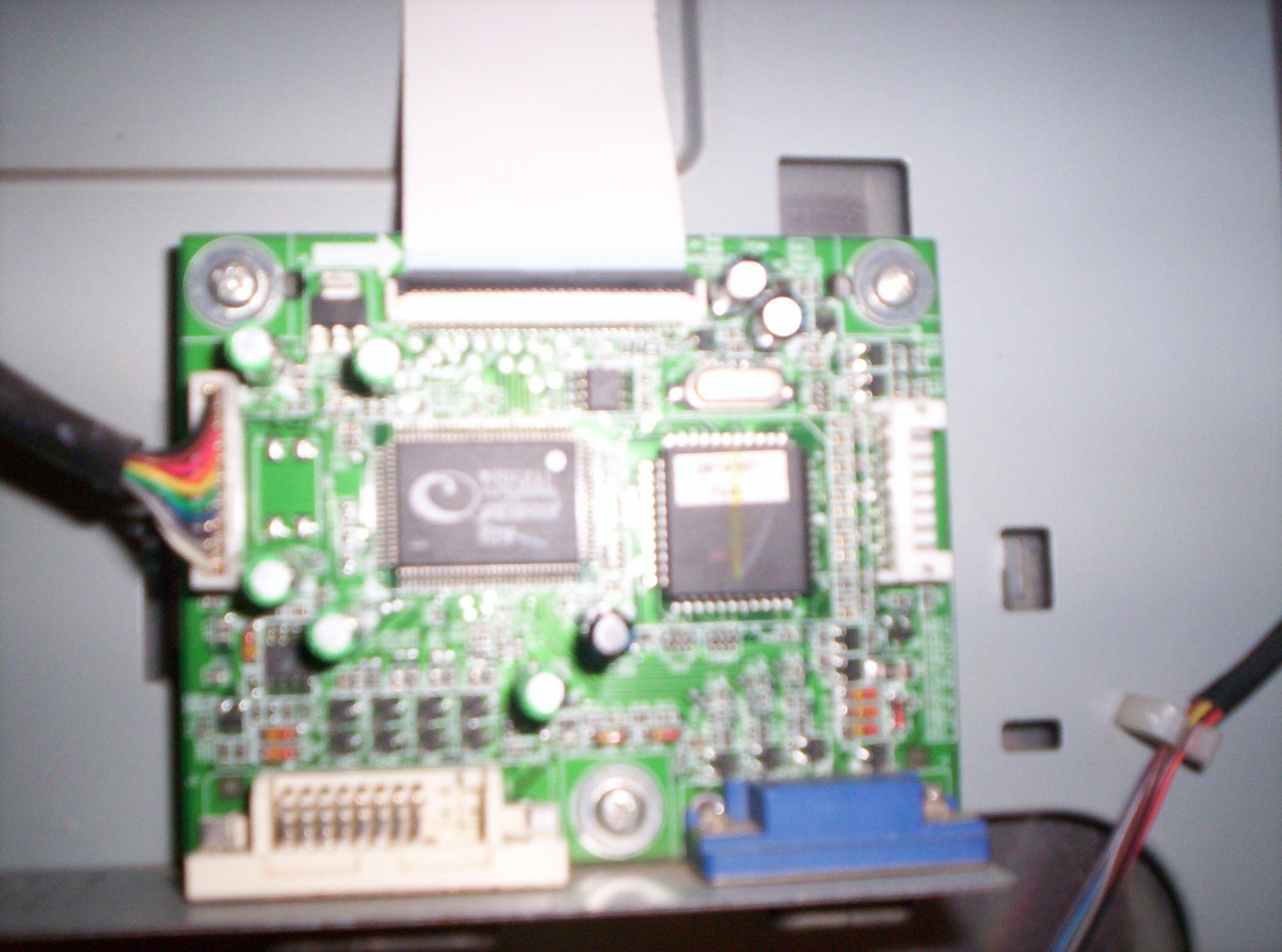

          Here are some pics,sry for the quality.
          What should I do now?

            Re-read post #18 on how to post pictures. The URLs you supplied show nothing but a postage stamp.
            Did you try testing anything in post #20 and #21?

              Re: LCD 19" BENQ T905 problems
              Sry, now I uploaded the images into the forum.

                I suggest you start by studying this book
                It will walk you through the basics and id all the components on the boards.
                In addition, your pictures are horribly out of focus. Take your boards to a window on a sunny day, use macro mode, and turn flash off. Here is an example of clear focused pictures ...

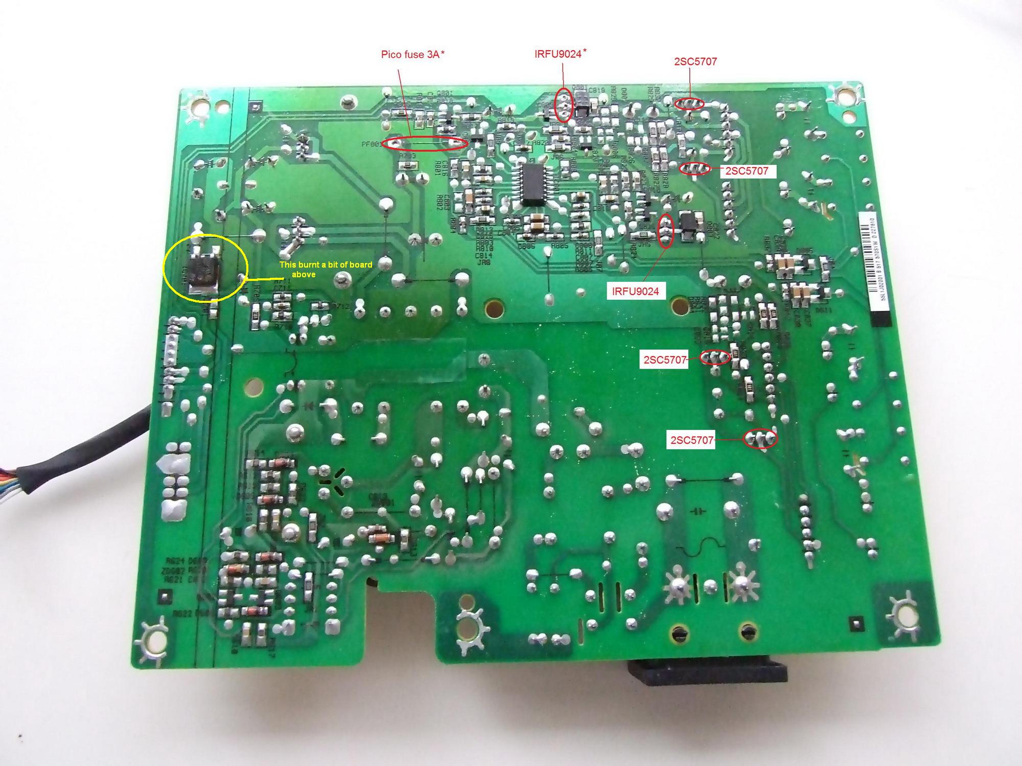

                  Ok Im gonna change 2 capacitators that seem a bit out of shape (just a bit, I bet theyre ok, but just in case) and the fuse, that seems is a common problem.
                  But I saw 2 transistors that seemed to have burnt a bit the board.
                  One just a bit, and the other, you can see the burnt a lot. Also this transistor seems to have a very short middle pin, or its broken, I dont know.
                  I have marked it on the pic attached.
                  I have checked them with a multimeter, configured it in Ohms, and tested the middle ping with the others.
                  Before saying anymore, I have to say that its what I read on Internet on how to check transistors ,so I dunno if I did properly.
                  Well, I had values from both transistors, so Im not sure there broken after all...
                  As a last note, I must say that I checked them on board, ie. I didnt desolder them.
                    Some browning is normal.
                    Here is how I test transistors in circuit.
                    a) put black probe (com) on pin 1 and red probe on pin 2 - read ohm
                    b) put black probe (com) on pin 1 and red probe on pin 3 - read ohm
                    c) put black probe (com) on pin 2 and red probe on pin 3 - read ohm
                    If any ohm reading is less than 50 ohm you have a shorted transistor and it will need to be replaced.

                      #30
                      Thanks retiredcaps, I gonna check them.
                      But one question, which ohm switch should I use? I got : 200,2k,20k.... up to 200M.
                      You said 50 ohm, so I guess I should use "200"? Or did you mean 50k ohm?

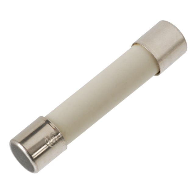

                      In the board, aside the picofuses there is a 'nromal' fuse, like the one attached on the pic.
                      How many ohms should it give?
                      Edit 2:
                      Ok, the picofuse is blown, with multimeter at 200k ohms, it went from ~160 up to 200.
                        All fuses should read 0.3 ohms.

                          #32
                          Ok,the pico shows "1.", the normal one shows "0,2" so seems this one is ok.
                          The transistor that burnt the board also seems ok, almost everytime showed a range out of range (showing "1.") and a few times showed a high value ,like 197 for a second then went out of range.
                            Your picofuse, as we suspected, is open or BAD. You will need to replace it.
                            The showing of 197 is your multimeter not reacting fast enough. For your own fun and learning, try testing the same transistor on the 2k, 20k, and 200k scale and see what you get.
