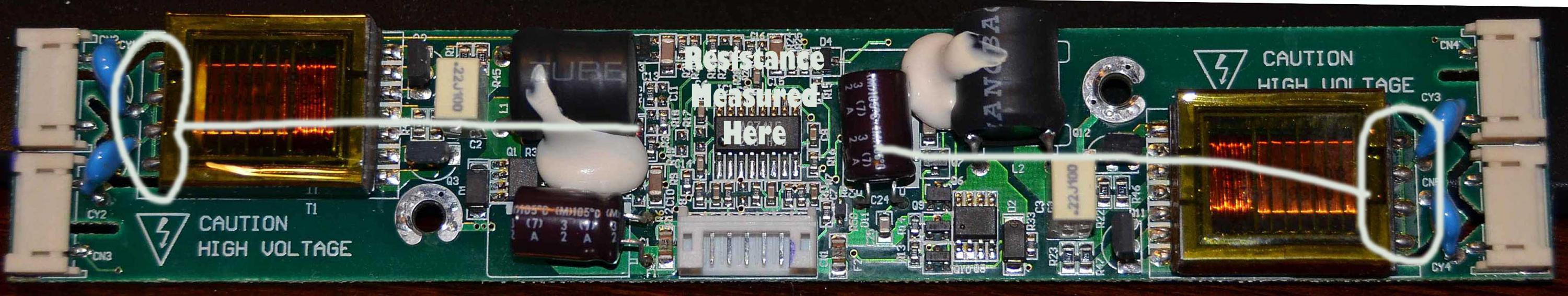

          Re: Viewsonic VX900 Bad Inverter
          Budm
          Yes if i Turn the monitor off and back on with a PC connected I get a display for about half a second.
          Rtech
          Secondaries measure .2 ohms between all 4 pins both transformers.
          Davi.P
          I have a ccfl tester. It has the small ccfl connectors. I will get out the alligator clip leads and connect and test the ccfl's
              Originally posted by ZappedAgain
              Budm
              That doesnt sound correct did you have your meter on 2000 ohms.
              If not try again - can you see a part number on a transformer
              • ZappedAgain
                • Mar 2011
                • 49
                Ok First Readings on the Transformer Secondaries where made with an autoranging fluke 116.
                Remeasured with a Wavetek
                on 2000 range readings between all four connectors is 0.0
                on 200 range readings are 1.2 ohms on all connectors both transformers.
                Ken
                  Cant believe they are all shorted. Must be using the wrong tabs
                  Can you make out the part number.
                    Selldoor if you watch the picture you see that pins on output are united by a track (don't ask me why) , i think this is not new in my memory, maybe lamp connectors are connected 1 pin to the transf. & 1 pin to chassis ground.

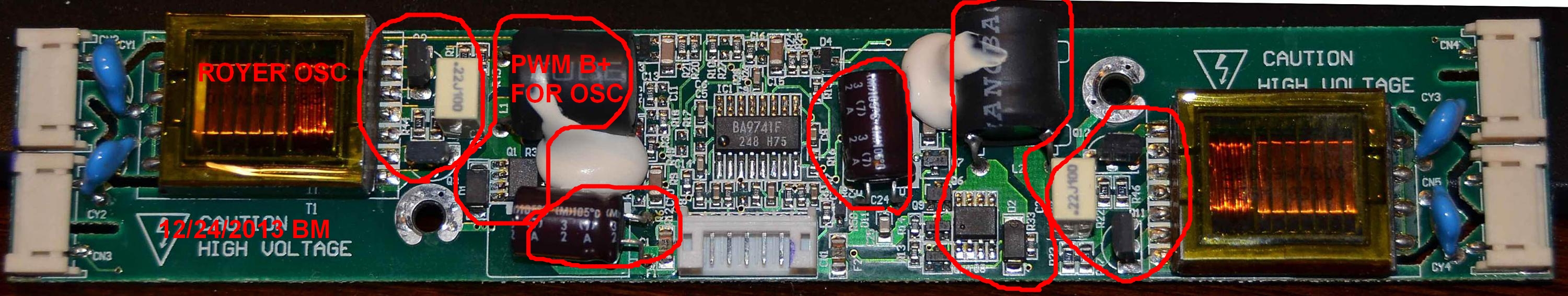

                        The inverter transformer drive is ROYER Self Oscillating circuit, the amount of lamp brightness is adjusted by using variable DC feeding the OSC, it is done by the MOSFET Q8, 2, D2 (Q1, L1, D1 for the other channel) the Pulse width signal from the PWM IC is used to drive the Gate of the MOSFETs. If the MOSFET Q1/Q8 has shorted S to D, the lamp will be fully on all the time. The PWM will be not be sending the signal to turn on the MOSFET if it detects open lamp (lamp not connected or will not stay on after firing voltage is applied), or circuit draws too much current. So anything goes wrong in the first 3 seconds, the circuit will go into shutdown (this 3 second time out can be bypass for troubleshooting purpose by grounding one of the pin on the IC).
                        One end of the lamp is connected to the ballast cap then the transformer winding, the other end of the lamp is connected to the resistor/diode network for the lamp sensing circuit.
                        So, did you check or replace the two electrolytic caps C1, C24 yet? Try heating them up with hair dryer.
                        C2, C3 of the Royer Osc also need to be checked.
                        You can also have bad lamp assembly that needs to be verify.

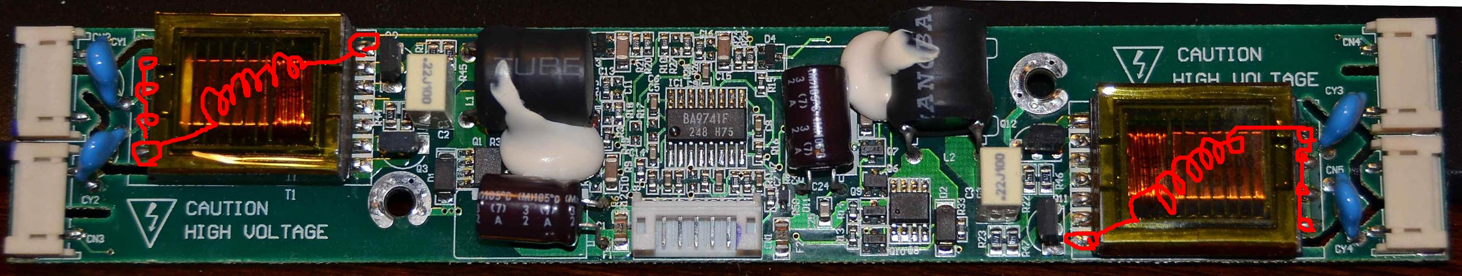

                            • tron
                              • Apr 2009
                              • 47
                              secondary windings for backlight
                              have high resistance, 200mohm
                              is a low resistance reading
                              tabs are where
                              the transformer
                              pins come out
                              of the secondary
                              (high voltage/resistance side)
                              and go to light up the tubes
                              01 and V1...06 and V6
                              is the row where
                              the secondary side is in this
                              picture:
                              https://www.badcaps.net/forum/attach...chmentid=13909
                              • ZappedAgain
                                • Mar 2011
                                • 49
                                Here is a picture to show where i measured the inverter transformers. Hope this clarifies things. I will work on making sense of the other post to give it a try.
                                I am not a professional at this.

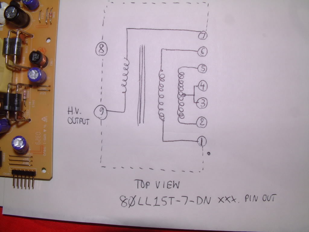

                                    Yes, we need the P/N as printed on the transformer to look up the pin out.
                                      Try this reading, it is similar to one of the transformer I worked on before:
