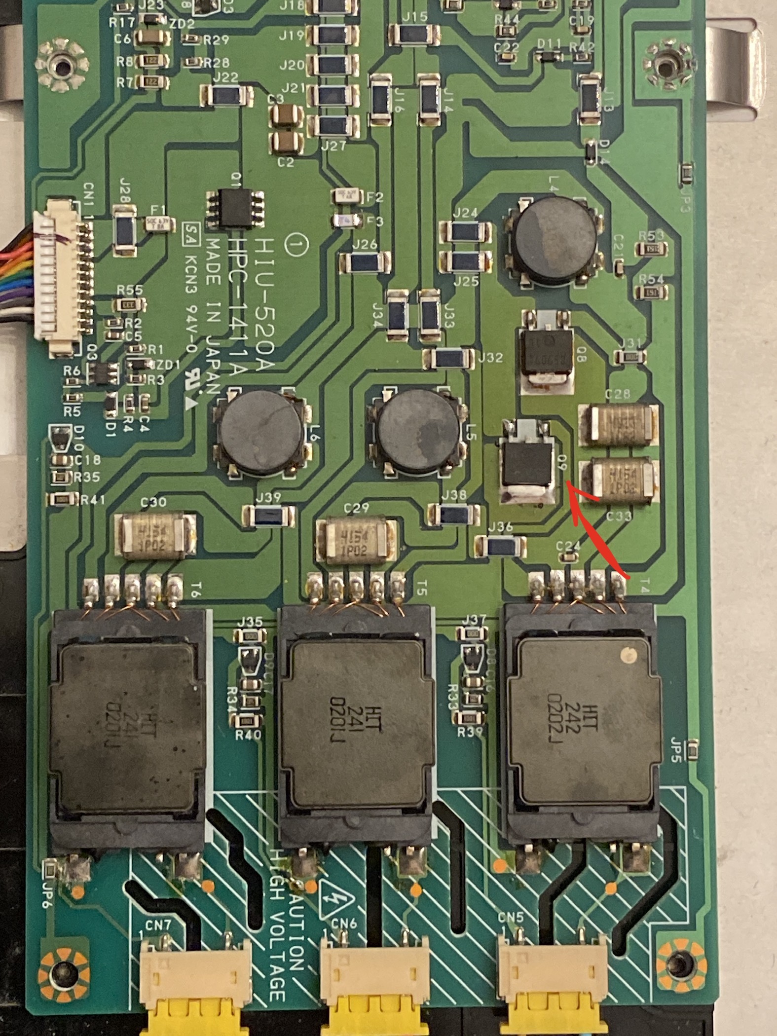

    I've got lots of pictures and am happy to share but without known what would be of interest, I'll just start with pictures of some of the boards.
    The four images:
    5438 is the video board
    5452 and 5453 are two shots of the inverter board topside
    5453 - shows J7 which is the connection from video board to inverter showing the signal note BRICON source is Pin2 of U3 which is located just south of the electrolytic caps along that left edge in that picture

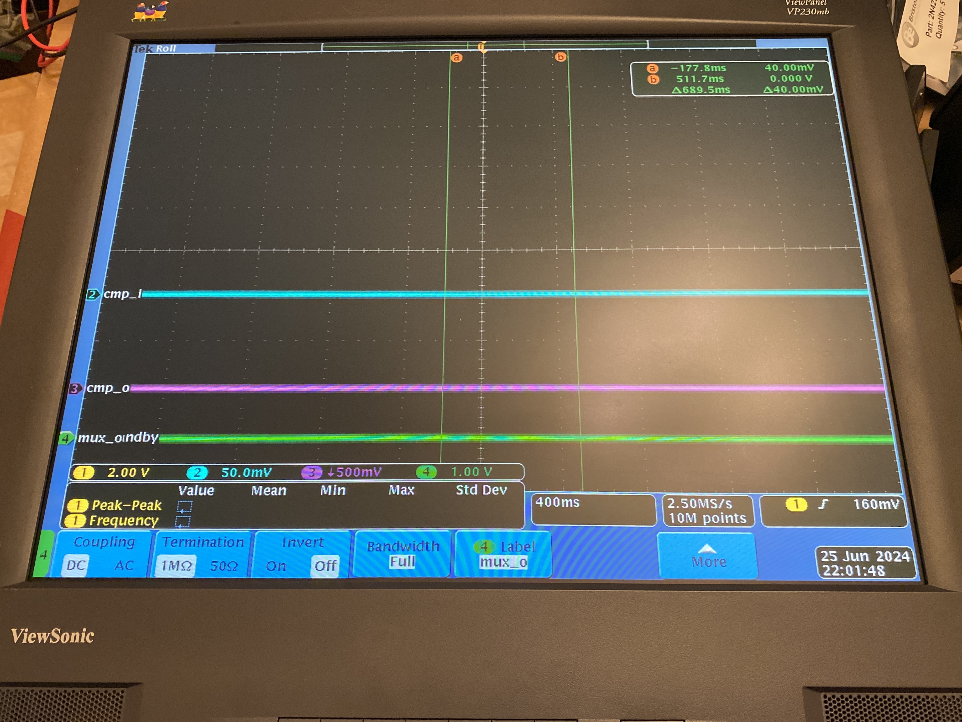

    Little update because I'm looking to move this to the side for a while, I was able to confirm the screen does have an image!
    I'm also sharing a video of the display being switched on to demo the dim backlight behavior. I hope I can share .mov file!

        I read all what you did and din’t do to the LCD. I have to admit you did pretty good, but there are a couple of crucial things that were either missed or not written down. Symptoms on LCD like this aka “2 seconds to black” the most common reasons for it to do so are capacitors bad on the inverter board, the small little transformers on the inverter board, cold solder joints / connections or the blue 1kv high voltage caps at the ccfl connectors.
        If the ccfls are displaying a pinkish hue, they are at the end of their life.
        Check the little transformers on the inverter board and measure the resistance on the primary and secondary windings of each transformer and note them down. The transformers got to be within 3%. My bet is that at least one is out of spec. There is no real fix for this, unless you either find a replacement board / transformer or you disable the protection circuit on the inverter.

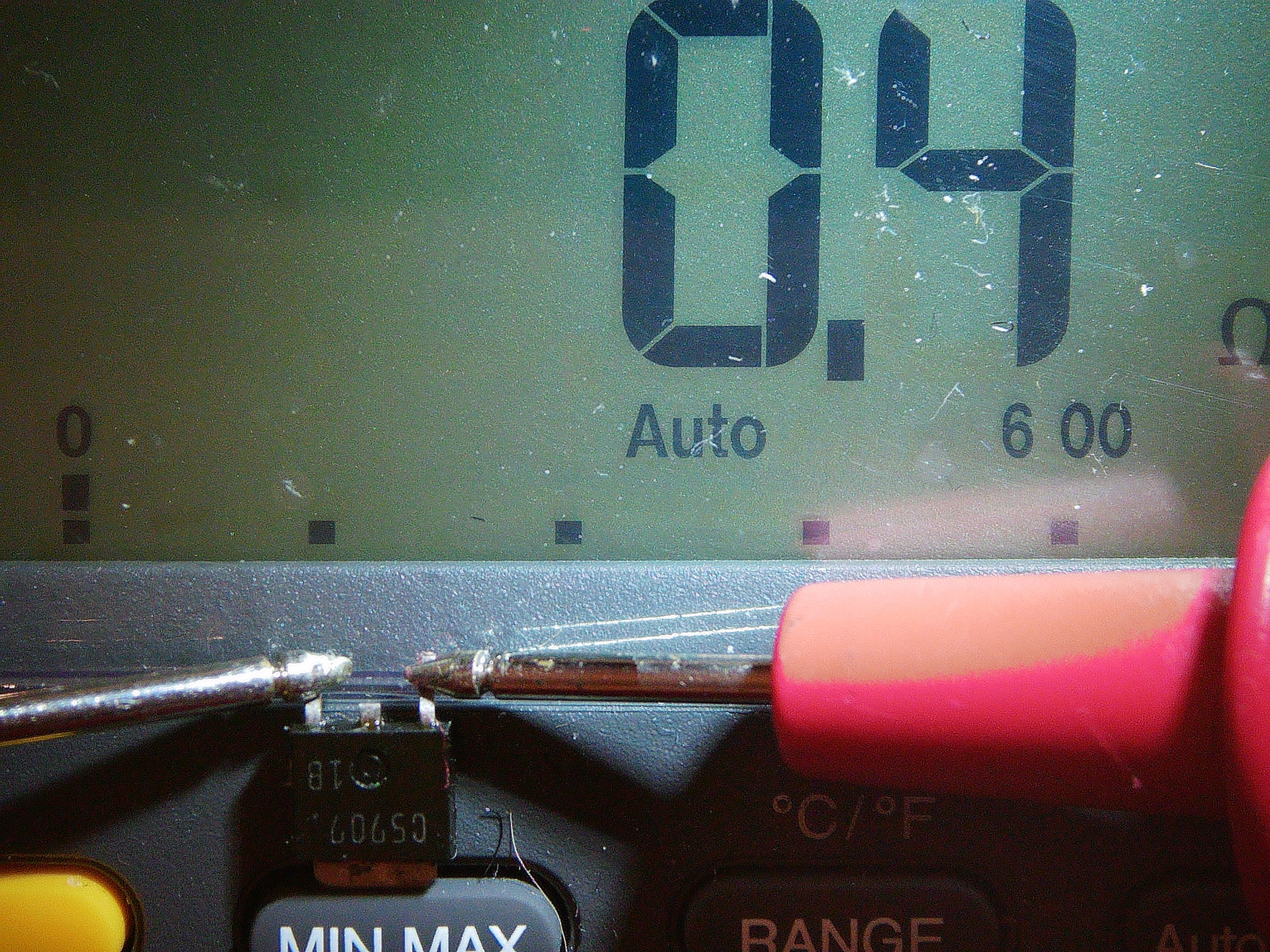

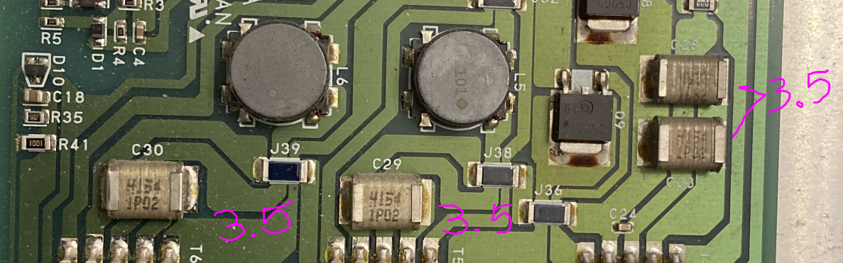

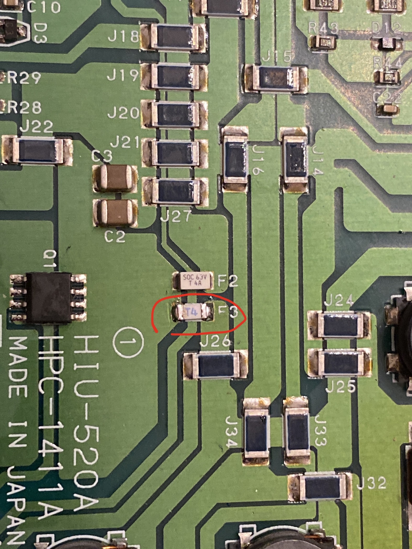

                  Well this is promising... it's great to have a lot of components to probe on the board. I started with the HV transformers measuring the resistance between the input and output pins, what I noticed is the top side (CN2-CN4) had fairly high resistances (450kOhm) pin 1 and the others. Moving to the other side Cn5-CN7 were all almost 0. Odd so I checked the ESR on the big caps neraby and found, pictures are easier than words, so these are measured ESR values, no surprise the two on the right are equal because they are in parallel...
Name:	Top Row ESR.png
Name:	bottom row caps esr.png
                  So I'm feeling confident things aren't quite right since both sides are show some very different readings.

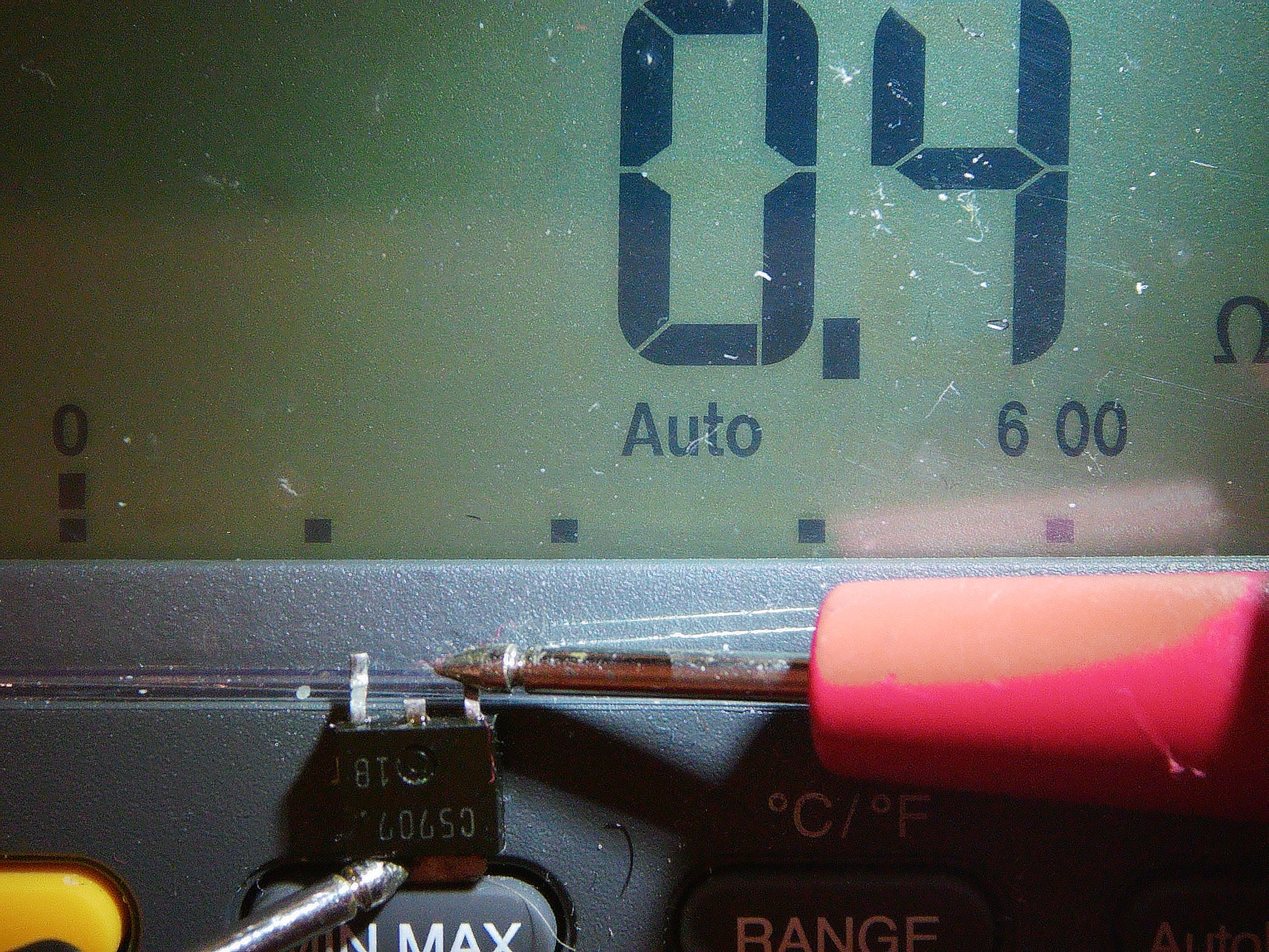

                  Next moved on the the BJT transistors (Q6, Q7, Q8, and Q9) and found Q9 (pictured in the second ESR picture seemed to show shorts between B/E and B/C while the others tested fine.
                  Removing the C5707 and testing confirmed:
ID:	3284761 Click image for larger version
                  Looking at the back of the board I do see a slight brown discoloration on the green soldermask right where this part is mounted on the other side. If that's the result of my removal or some other overheating I'm not sure but I'm going with it wasn't my work. =)
                  I'll get a few of these with my next parts order and see what magic follows!

                    I got a new C5707 (a few actually in case I missed something and destroyed another one). What's interesting now, is I can see the discoloration on the board around Q9. After replacing I powered it up and same thing!! WTH?!?!
                    I started tracing the circuit back to the input and soon found two 63V 4A fuses, I had originally found a single 63V 8A fuse and found that was fine. But the 4A fuse in line with Q9 was blown. After waiting for mouser to week to fill a tiny order I got the new fuse installed and the backlight stayed lit!!
                    YEAAAAAAHHH!!!
                    Lots of learning along they way, and I never wanna do that again!
