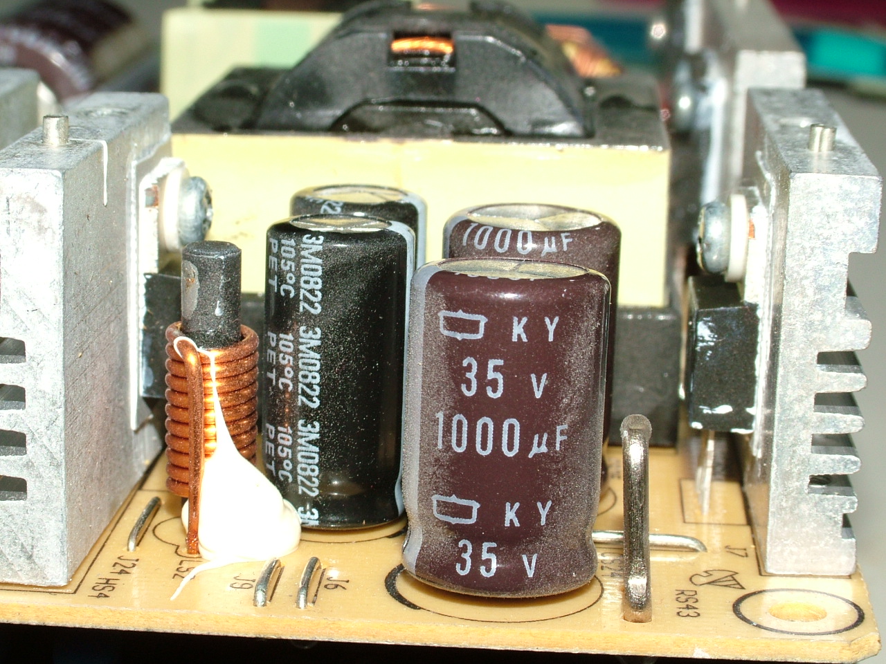

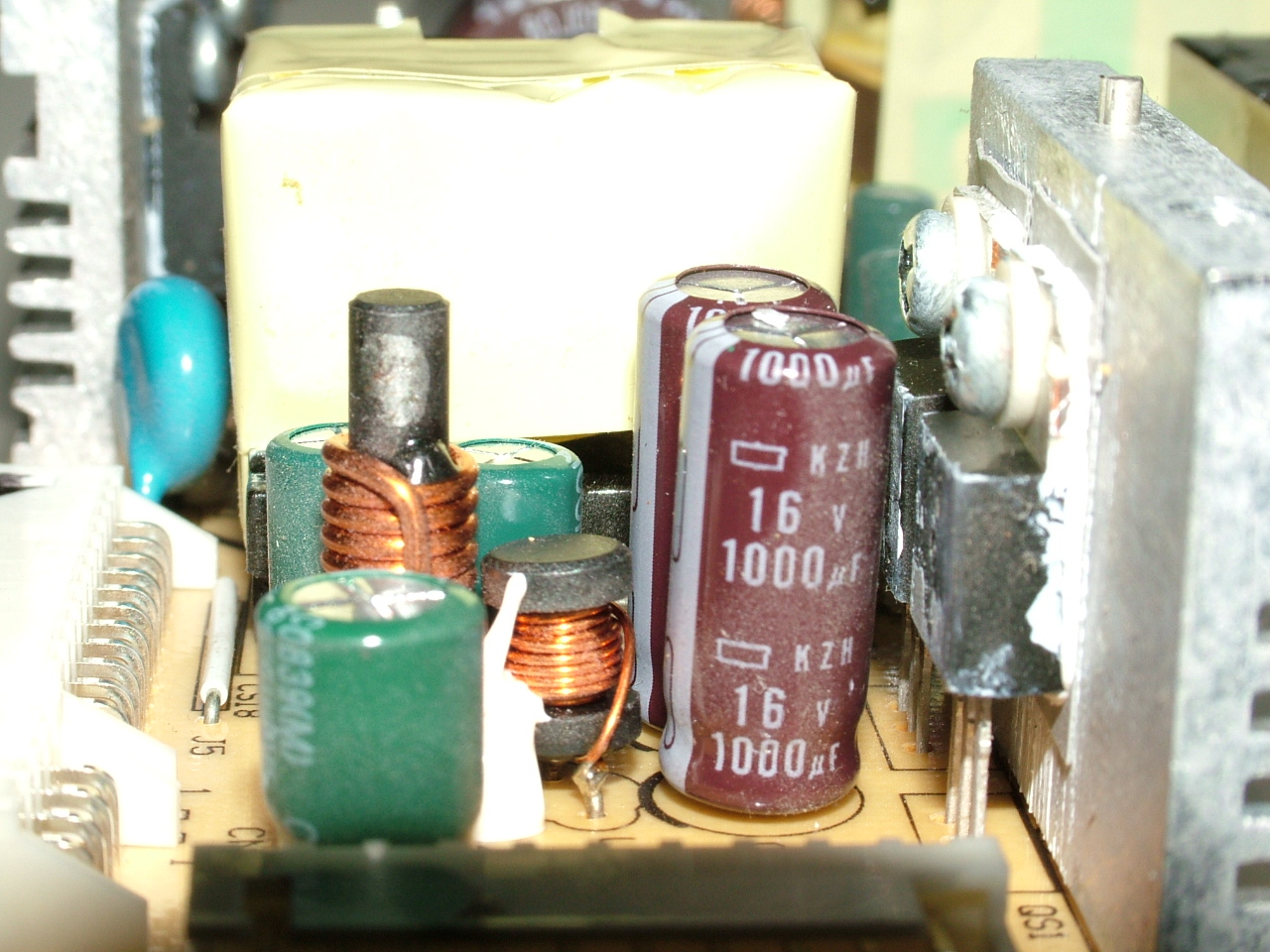

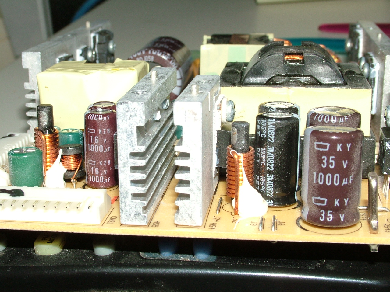

        Videoman5, I just happen to have the list I made for mine right in front of me. As selldoor pointed out this may or may not apply to your board but you can probably compare yours to mine on the previous page to see if they appear the same.
        Mainboard:
        3x 16v 470uF
        5x 16v 100uF
        12x 16v 10uF
        PSU: Mine is apparently one of at least two different models.
        2x 35v 1000uF
        2x 16v 1000uF
        2x 25v 680uF
        1x 25v 220uF
        1x 10v 220uF
        1x 16v 100uF
        1x 35v 33uF
        4x 50v 10uF

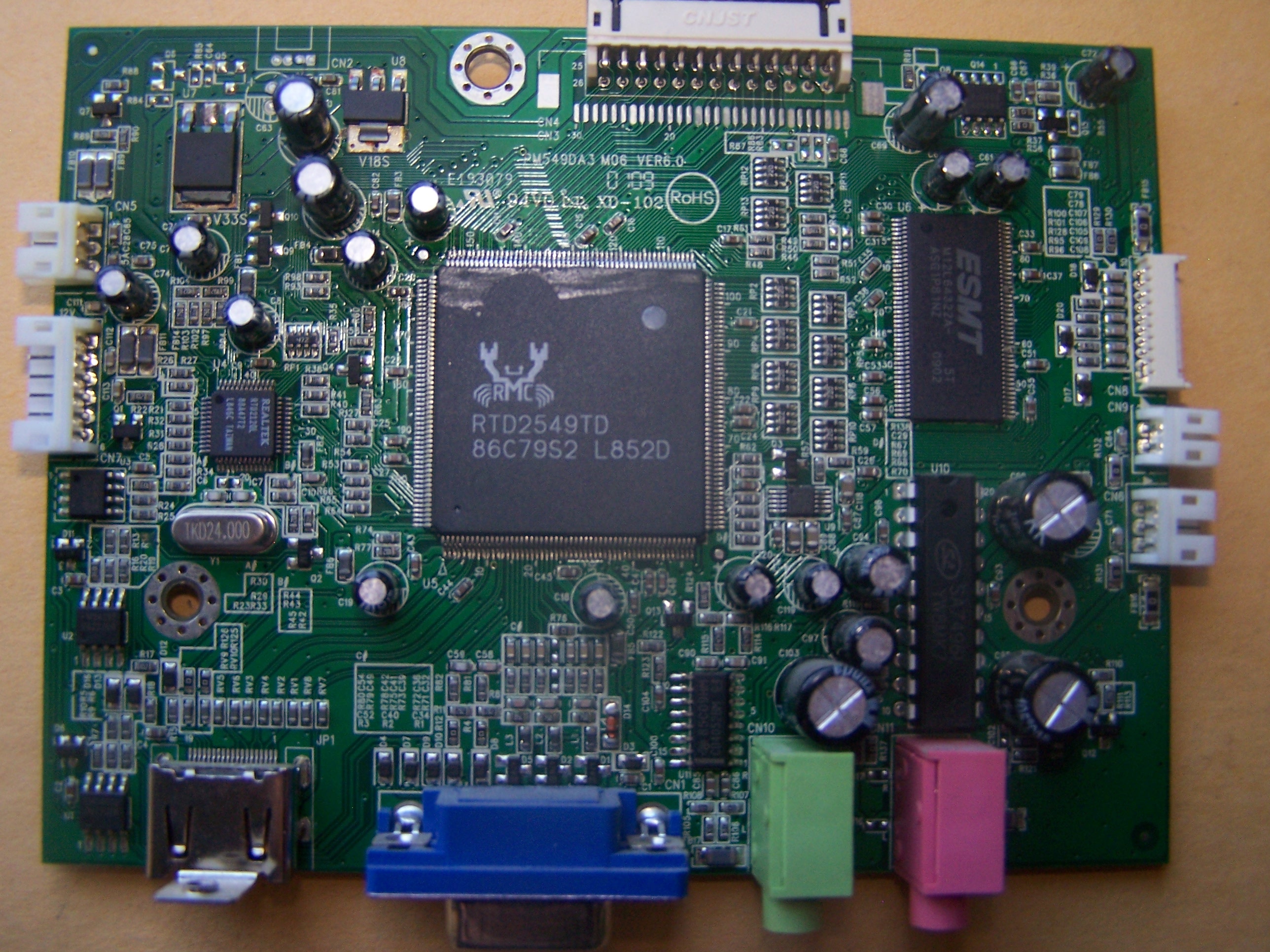

                Start by changing the caps C80 and C83 (pic 1/2) then if that fixes it consider changing the caps on the power supply.
                A cap that looks bad is bad
                A cap that doesnt look bad is probably bad given the symptoms you describe.

                            Originally posted by selldoor View Post
                            Yes C80 and C83 are usually the ones to change on the main board
                            They are 100uf16v and the ones in the digikey link will be fine.
