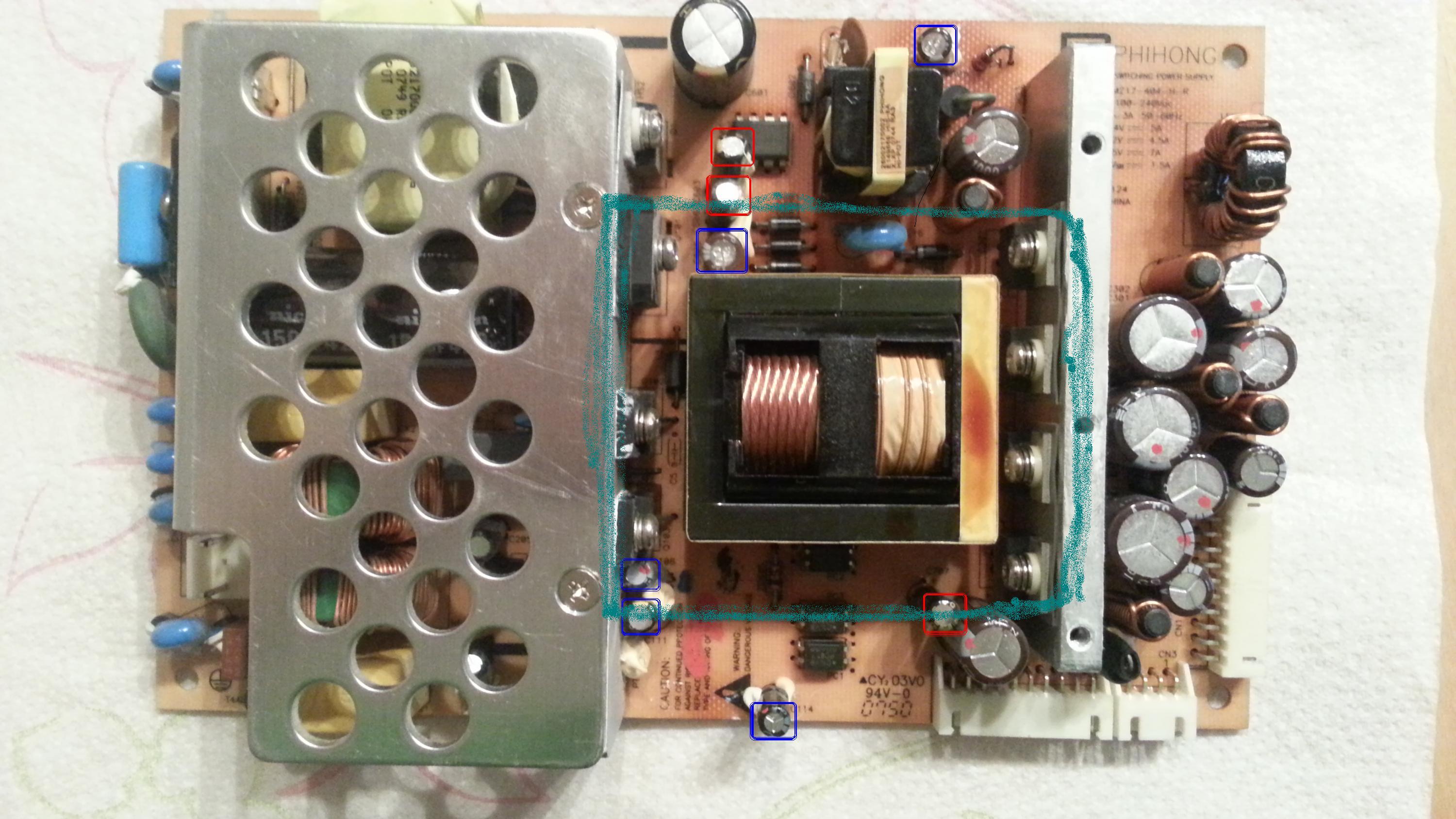

                          I used to run fan mods when I was overclocking. It can't hurt. Ok, the 3 caps you definitely need to replace are circled in red. (not exactly circles, but you get the idea). Those tend to dry out due to the poor quality of manufacturing, and the heat next to the switchmode transformer. The ones in blue are optional. The caps on the right side of the board really don't need to be replaced. On the 2 models I repaired, all of those caps still had very low ESR even after years of use. The area I marked in green is where I would direct a fan. Good luck. ~L-J-7~

                              Yes, I tested the others with an ESR meter. If you have the time, the skill, and the patience; you could definitely replace them all. The reason I don't always recommend total replacement is that unless the person is fairly skilled, it can make it worse. (solder bridges, splash, smd components damaged)
                              If I were repairing for a customer I'd replace all of the ones in red and blue circles. And the 2 on the main board budm mentions.
                              Photo and link are courtesy of budm - http://s807.beta.photobucket.com/use...00085.jpg.html
                              My thinking is...... If a capacitor hasn't gone high ESR after 5 to 8 years, it'll probably last another 5 to 8 years. I figure these monitors will be obsolete by then

                                  As per lumberjacks suggestion I'm going to replace the following 8 caps on the power supply board in an effort to fix the slow power on issue (Blue LED blinks intermittently w/delay until caps are heated then poof solid blue and on) I'm having and need someone to confirm I'm getting the right caps.
                                  Board Locations-CAP-Link to product from digikey
                                  C406=10u/50V http://www.digikey.com/product-detai...1250-ND/356152
                                  C603=22U/35V http://www.digikey.com/product-detai...1230-ND/356133
                                  C606=1U/100V http://www.digikey.com/product-detai...0765-ND/285717
                                  C605=47U/50V http://www.digikey.com/product-detai...0321-ND/266330
                                  C707=22U/35V http://www.digikey.com/product-detai...1230-ND/356133
                                  C108=10U/35V http://www.digikey.com/product-detai...5161-ND/245020
                                  C111=22U/35V http://www.digikey.com/product-detai...1230-ND/356133
                                  C114=2.2U/50V http://www.digikey.com/product-detai...0313-ND/266322
                                  *Note* I could not find a FM or FC series for C108 so chose M series
                                  If these choices are correct then ok. If I've chosen "unwisely" then please suggest a replacement from digikey. Thanks Gents!

                                    Re: Hanns-G HG281D, LCD Monitor no power
                                    If it fits (diameter and height), you can go up in voltage and use this FC 10uF 50V cap
                                    http://www.digikey.com/product-detai...0316-ND/266325
                                      On the power supply (SMPS) board, you should try to find Panasonic FR or FM versus FC. FR and FM are better suited for SMPS versus FC. While all 3 series are low ESR, FR and FM are "better" low ESR caps versus FC.
                                      In short, FR > FM > FC.

                                          Will the FC series work though? I understand that FR/FM series are better but I'm willing to use the FC series as long as they work.
                                          Seams that every FM or FR series I try to find on digikey requires adding voltage as they don't offer the correct rated cap at the standard voltage.
                                          Example: 47U/50V requires 47U/63V for the FR series so I would need to add voltage to most of the caps to obtain FR/FM series.
