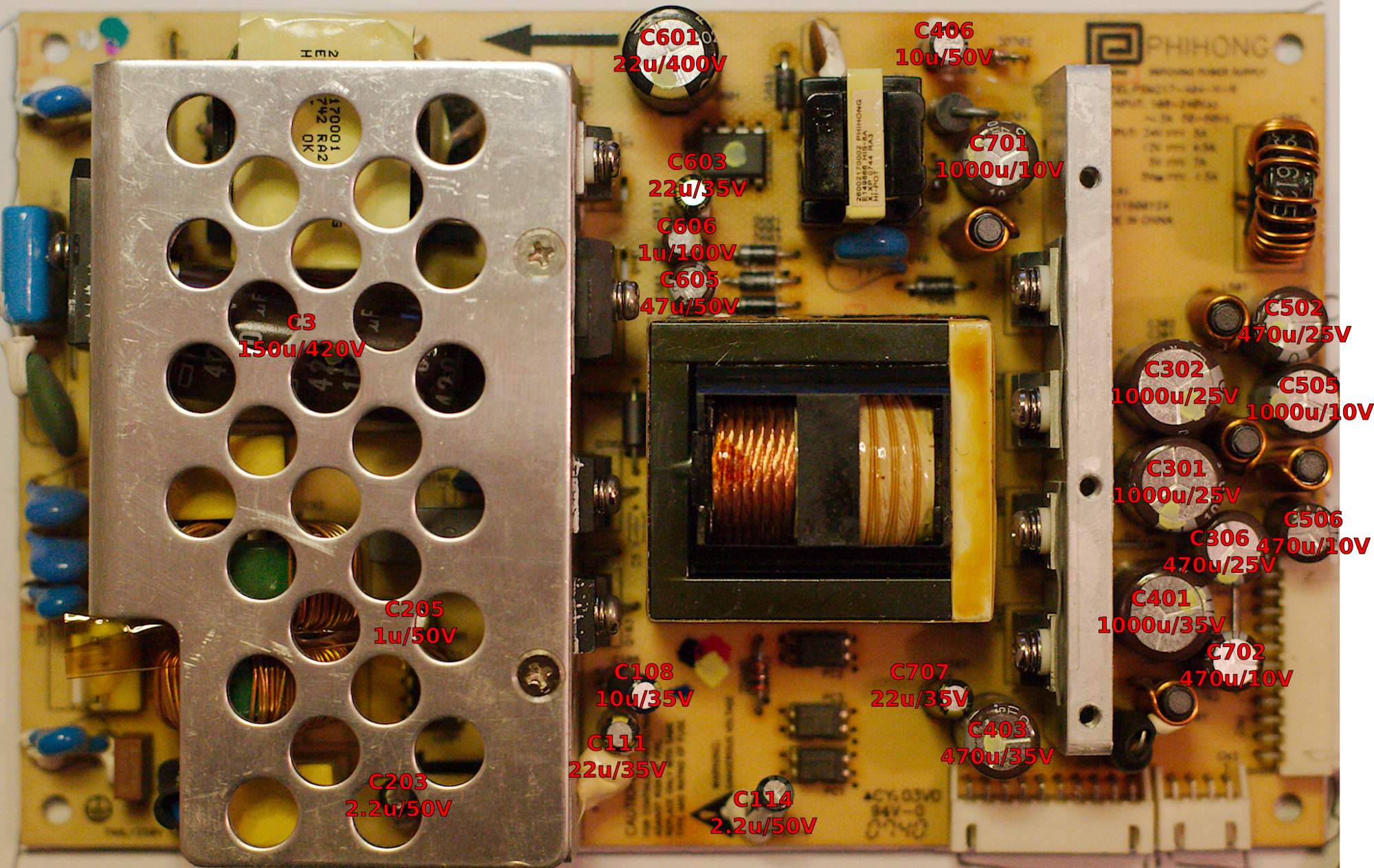

                    Hello all
                    First I'd like to thank everyone who has contributed to this thread and shared their experiences repairing this particular monitor.
                    Second, sorry for the long post. This is a success story so you might not even want to read this.
                    I bought my Hanns.g 4 years ago and it started showing first signs of failure about one year ago. The monitor would go black for a second or two, and then the image would come back.
                    For a couple of months now, when booting my pc the image would be fine, but a few seconds after logging in the screen would go black a take anywhere up to a minute or two before the image came back. Afterwards it would mostly run fine (even for an entire day) without going to black. Sometimes I'd see image distortion but never for very long, a couple of minutes maximum.
                    It seemed to me the problem was dependent on the signal the monitor was fed. I'm using Ubuntu Linux and for those of you not familiar with Linux, besides the graphical user interface there are text-only interfaces called consoles. When I'd switch to one of the 6 consoles, I'd never have the problem. In fact, I often successfully used this trick to get the picture back quickly, by switching to one of the consoles after the screen goes black, waiting a few seconds and switch to the Desktop again I would get the image back.
                    So, the symptoms: black screen, power LED always on (blue) even when screen was black, symptoms probably linked to input signal. When the screen was black, I could not see an image when shining on the screen with a bright flashlight.
                    Having read through this entire thread I took some measurements.
                    With only the PSU connected to AC power, I got 4.99V on the 5VSB rail, looks good.
                    Next I hooked up the main/logic board and the switches to the PSU. With AC power connected, I still got 4.99V on the 5VSB, still good.
                    When I hit the power button, the blue LED comes on, after 1-2 seconds all voltages appear, 5.11V on the 5VDC, 12.2V on the 12VDC and 23.98V on the 24VDC rails respectively. Where I'm not sure is the PSON signal, I was reading 3.12V there. Is that what it is supposed to be, I was expecting that to be 5V too? Maybe someone can comment on this?
                    After another second or two, the monitor goes into standby (amber LED) and all the rail voltages go back to 0V except for 5VSB.
                    I also measured the voltage across the large input cap C3 which was 380VDC which seemed fine too.
                    I didn't take any more measurements at this point.
                    It seemed to me the PSU was fine, at least the rails are where they are supposed to be.
                    I remembered reading this post earlier in this thread.
                    This sounded pretty much like what I was experiencing. And since I also noticed signs of heat on my logic board in that spot, I decided to give this a try first. I replaced C80 and C83 (all the electrolytics on my logic board are CapXCon by the way) both are 100uF/16V.
                    Success! The symptoms have completely disappeared.
                    Anxious to see if I had resolved the problem, I forgot take any measurements before I hooked up to monitor again. I really wanted to check the PSON signal again to see if the voltage had changed, I guess I will still do that soon.
                    The only thing I made sure of was that I had not created a solder bridge when replacing the caps by checking for a short between the two terminals of each cap.
                    On the topic of removing these caps, they were a b*tch to remove. The negative terminals are likely connected to the ground plane of the pcb and I had to turn up the heat on my iron quite a bit. Having had a couple of bad experiences with cheap pcbs in the recent past I didn't feel too sure about this but I managed to pull it off without damaging the board or traces.
                    The next time I have to order parts I will order a complete set of low ESR replacements for all both boards as I think it's just a question of WHEN the next caps will fail as opposed to WHETHER they fail at all.
                    I am including some pictures. What I forgot was to write down the revision numbers of the boards. The pictures aren't too good as I only have DSLR and no lens with a macro function and I had to shoot from quite a distance to get them into focus - and then there's not much depth of field.
                    I did label all the electrolytics with designations and values on the top view images though. Maybe this will be helpful to someone.
                    The PSU is the Phihong PSM217 404-h-r. As I wrote above, I'll include the revision nr. as soon as I can.
                    Again, thanks to everyone for posting here. This has been very educating!
                    Cheers
                    Lenny

                      Re: Hanns-G HG281D, LCD Monitor no power
                      The "regulars" thank you for reading through everything. Almost everything that can go wrong with this monitor has been discussed in this megathread or its variants at least once.
                      PSON is generated by the main/logic board. It is usually > 3V.

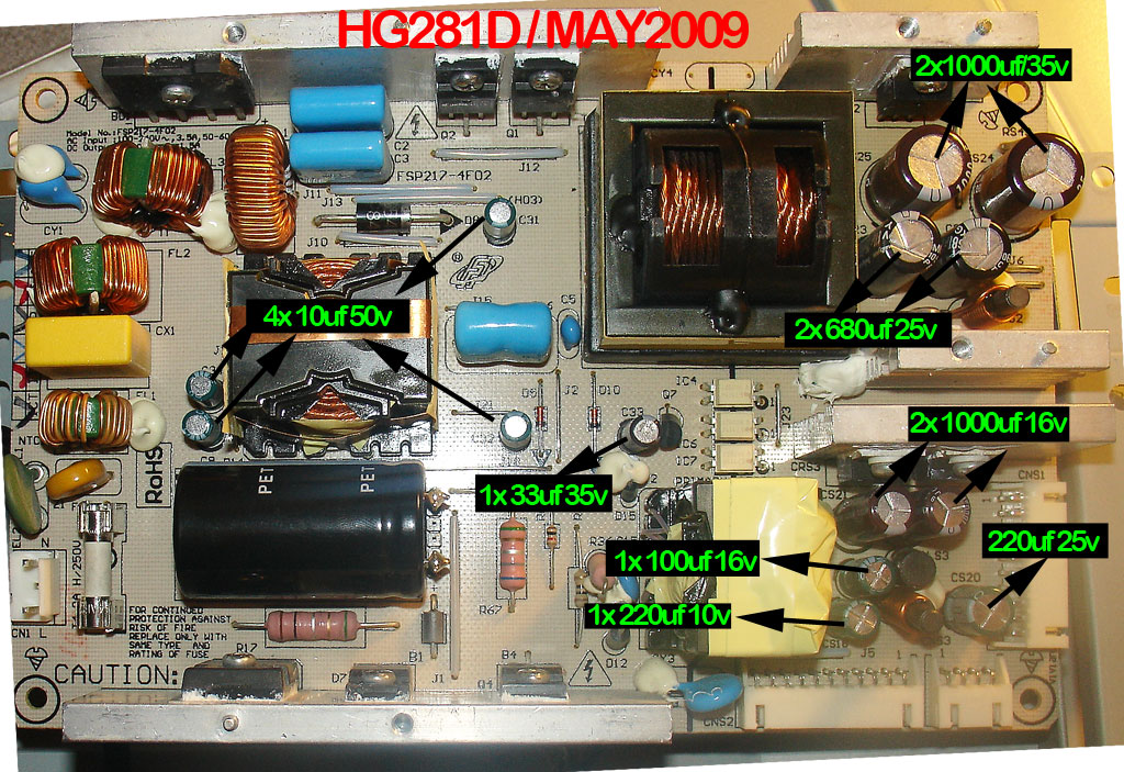

                        Originally posted by cody_hb85 View Post
                        In search of a solution to the screen flickering, no power issue I've been having with my hanns g hg281d I came across this site. So I have been reading this thread and after everything is all said and done, I have gone ahead and completely replaced EVERY cap on my power supply with caps from Digi-Key. The blue light comes on now and stays on, goes into standby when no input is plugged in, comes back from standby and recognizes the input device when plugged in. Disply works, back light come on, everything is fine...... until...... the screen starts to get fuzzy, especially around desktop icons and dialog boxes. I've also read in this thread that it could possibly be the caps on the logic board? Please advise me on where to start! I will post whatever pictures you may need as soon as I get home from work this evening. Thanks in advance!
                        I have done exactly the same thing replacing all the caps on my power board. The monitor boots fine in safe but when I try and run it normally the same flickering fuzzy screen returns (there is much reduced flicker in safe). Not sure what to do next.
                          Hi hopefully you will have used good quality low esr caps for the power supply.
                          Read this https://www.badcaps.net/forum/showthread.php?t=23592
                          and https://www.badcaps.net/forum/showthread.php?t=24000
                          Try replacing the two caps first but also check the voltage regulators

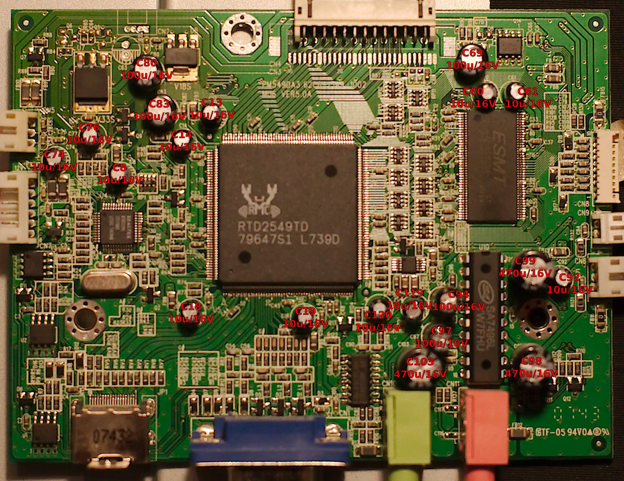

                            Does anyone know which caps the logic board requires (HannsG 281D) as I'd rather buy em in the UK rather than order them from USA.
                              Please see here, I used Panasonic FM series: 100uF 16VDC
                                  I chose to look at the capacitors closely to see what they were, I was just being lazy asking, for the record my HannsG 281D logic board has:
                                  3 x 16V 470mf
                                  12 x 25V 10mf
                                  5 x 16v 100mf
                                  Is it OK to use caps with slightly higher voltage rating, I make sure I disconnect monitor when I am not using it as I doint want to burn down my flat?
                                    3 x 16V 470mf
                                    12 x 25V 10mf
                                    5 x 16v 100mf
                                    Yes, you can go higher in voltage. Just be aware that going higher in voltage may result in a physically larger cap. This can cause a potential problem if you have many caps clustered together.
