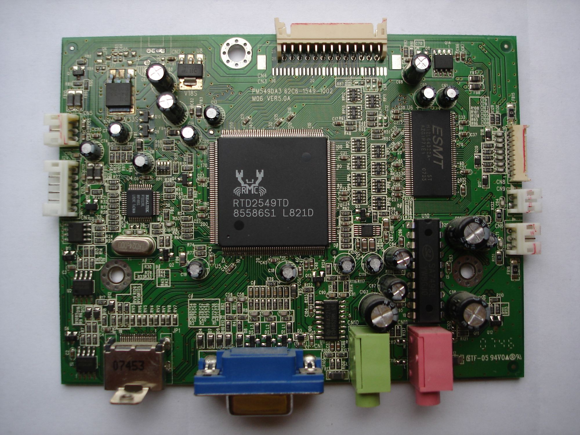

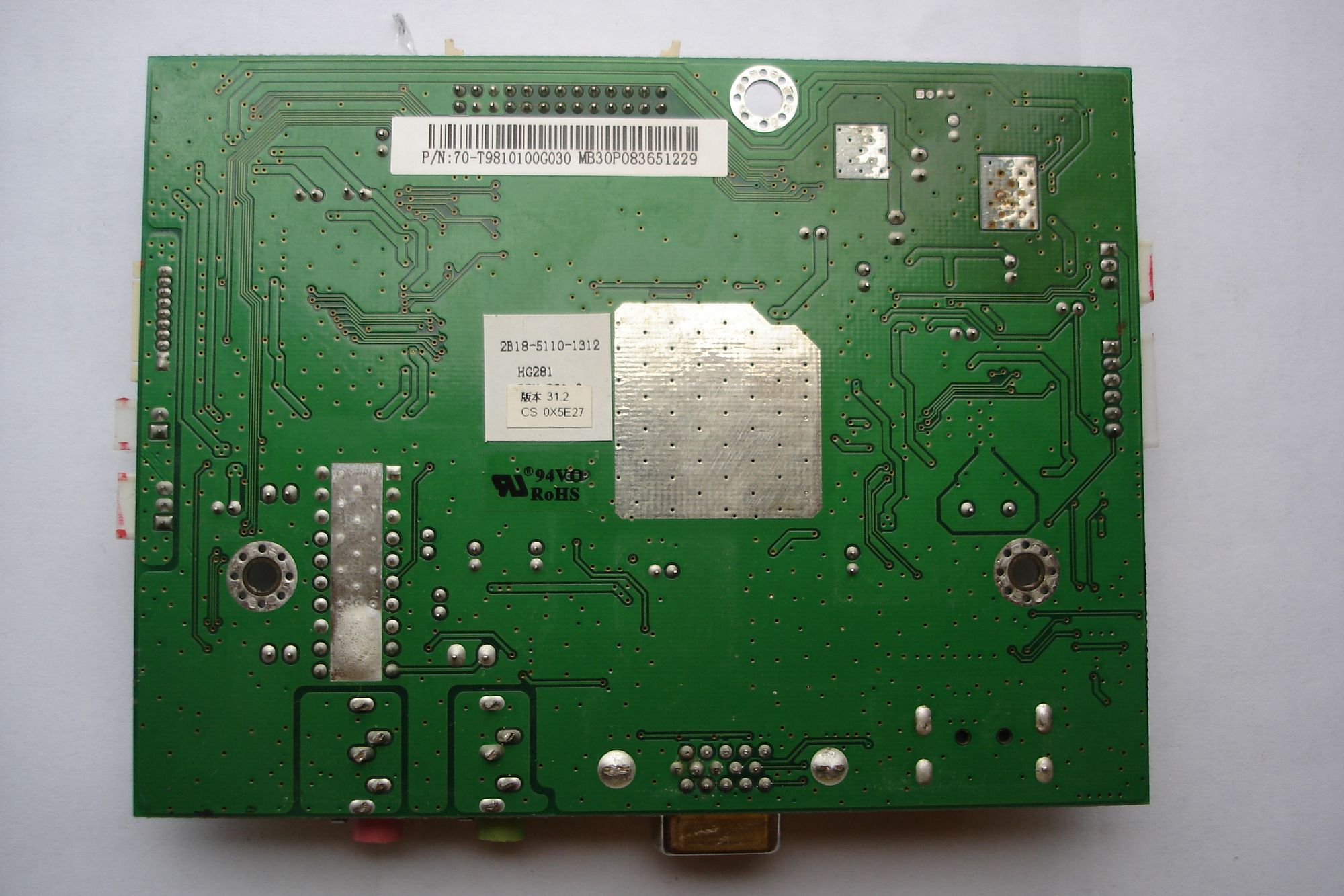

    Hi all, I have Hanns-G HG281D LCD monitor with no power problem.
    I inspected visually all caps on PS board (PSM217-404-H-R), they are look absolutely normal. Also I tested all big semiconductors, fuses, coils, transformers and resistors. Nothing found bad so far. If some body had similar problem with this issue please help. Thanks.

    • Mishannya
      Badcaps Junior
      • Sep 2010
      • 31
      Re: Hanns-G HG281D, LCD Monitor no power
      Q: 1) Does the power LED come on at all or stay off?
      A: No, it doesn't.
      Q: 2) If you have a multimeter, check the secondary voltages on the connector between the power board and logic card. You should get 5V DC at least one of the pins.
      A: The 5V DC presents on the power board and logic card (actually 4.4V ~ 4.9V DC)
      Thanks.
      • retiredcaps
        • Apr 2010
        • 9271
        Good photos.
        Regarding the 4.4 ~ 4.9V DC, is that fluctuating or do you mean one pin is 4.4V and another is 4.9V DC. 4.4V DC is low and is suspect.
        On CN7, do you see 12V DC? The picture of the logic board shows 12V DC printed on the PCB.

                            U7 on the video board looks very discolored. Check the DC voltage on it with your multimeter by placing the negative probe on ground and the positive probe on the tab of U7. It's probably a 3.3v regulator. Also check the DC voltage on U8, same way as for U7. Post what voltages you get.
                            • Mishannya
                              Badcaps Junior
                              • Sep 2010
                              • 31
                              U7 reads (2.9V~3.3V), U8 (1.6~1.8)
