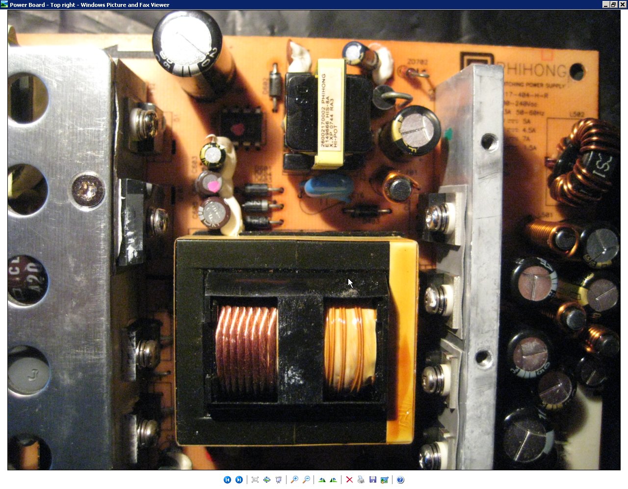

                Here's my latest attempt at the photos, which were taken this evening (when the natural light was at its low) using MACRO mode. If they still require further improvement I could do this tomorrow morning in early morning sunlight (assuming it's sunny) in MACRO mode.
                The first batch are for the Power Board.
                JPG4 == Top Left of PCB
                JPG5 == Bottom Left of PCB
                JPG6 == Bottom Right of PCB
                JPG7 == Top Right of PCB
                I see now what you mean by T vent - the Caps have the letter "T" embossed on them.

                    Re: Hanns-G HG281D, LCD Monitor no power
                    Originally posted by retiredcaps View Post
                    It is possible that the 7 electrolytic caps clustered around V33S and V18S are dried up and causing the fluctuating voltage.
                    From your picture, I think I see CapXon branded caps. They are one of the worst, if not the worst, makers of caps.
                    If you have never soldered before, I suggest either practising if you have the equipment or getting a co-worker (properly motivated with a free case of beer) to change out the caps on the main board.
                    Replacing caps on the main board is more difficult than the power board as it is typically multilayer versus a single layer for the latter. Multilayer means more copper planes to soak up the heat from your iron tip making it more difficult to desolder caps.

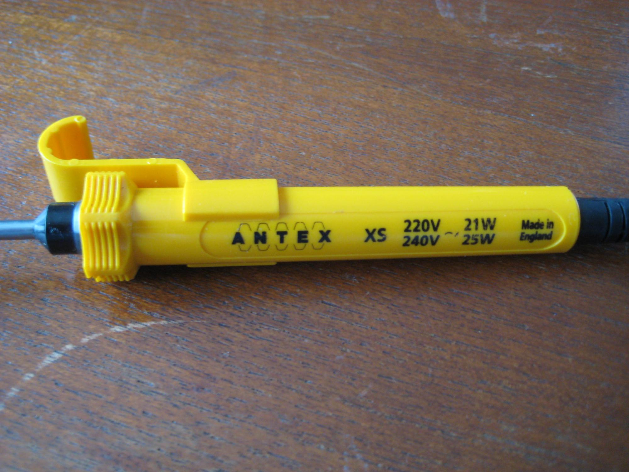

                                          My son pointed out to me that we had a soldering iron. It is an Antex 25 Watts which I picked up for £5 from a local General DIY store not so long ago.
                                          Attached are the JPGs.
                                          Some questions:
                                          (1) Is the wattage sufficient for it ot do the work that is required on the PCB i.e. de-solder and re-solder the CAPS; and
                                          (2) Is the tip of sufficient shape and dimensions for it to be used for de-soldering and re-soldering work on a PCB?
                                          Thanks.
