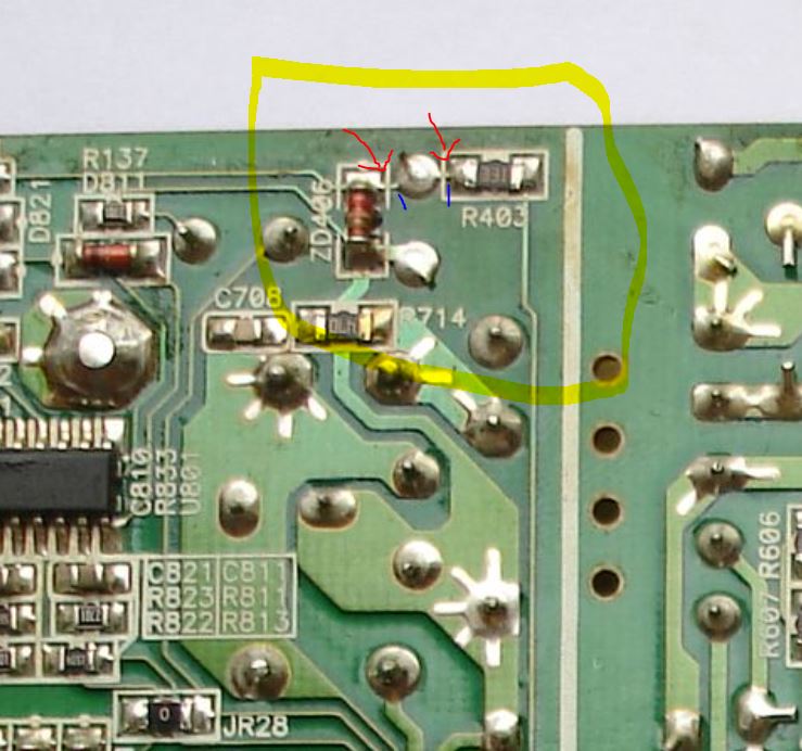

    Emergency question!
    On the PSU, Between R403 and ZD406 there is a capacitor. It is capacitor 11 on the chart.
    If I pulled a pad off removing that capacitor can I just solder that one leg of capacitor 11 directly to the leg of R403 and ZD406 or use one of those circuit pens to reestablish a connection or is my PSU finished?
    This really sucks. I believe I pulled the pad right through the hole with the capacitor wire.
    Does the leg closest to the outer edge of the PCB connect both R403 and ZD406 or does it only connect to R403?
    I used Red and Blue pen in the picture to point at what I believe is traces connecting these three parts together.
    Am I correct in thinking I can repair this or is this a done deal?
    I was close to half done removing capacitors when this happened.

      Re: Hanns-G HG281D, LCD Monitor no power
      It's fixable. Nothing too bad actually.
      Just put in the cap and solder some thin copper wires to connect it to the two points beside it.

        #623
        Another HannsG 28" Monitor saved from the trash heap!
        I have got to say this forum is a great need for me.
        I come across broken monitors all the time.
        I popped two pads after removing 6 caps on the PSU board and was able to repair them using cap wires with a little help from this forum. Manipulating them in place without a magnifying lens in bad light with bad eyes was a bit tough but I managed.
        So far the power button issue is gone and the fact that it even came on is absolutely promising! Now all I need to do is run it all day and let my brother game on it for a few hours and I will know if the snow issue is gone too.
        But I suspect it will work fine since I replaced all the PSU caps except the ones under the aluminum cover and the two 100uF 16v caps on the mainboard.
        You guys have been invaluable. Thank you!

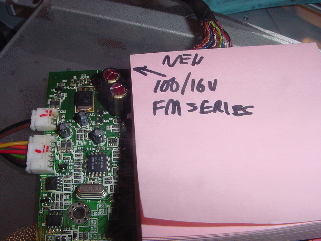

              After lurking on the forum for the past two weeks, I manage to fix my HG281D with all the information everyone contributed. The screen was flickering none stop everytime it power on so I only replaced the caps on C80 and C83 main board it now back to normal.
              • Mark369
                • Jul 2009
                • 163
                #627
                Just a update i gave replaced the caps on main board 100uf 16v and now Wooking good. Thanks to all

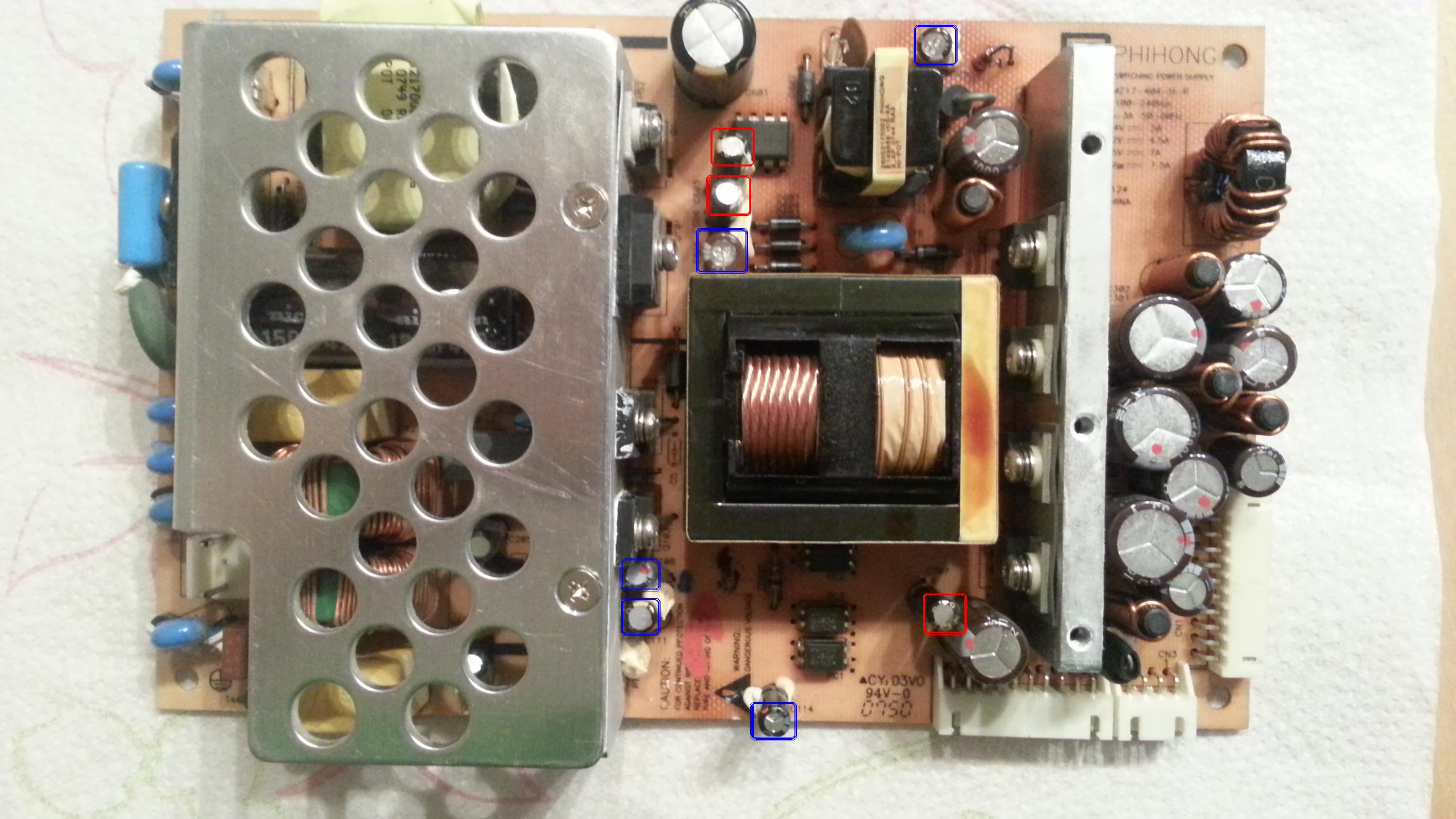

                    The intermittent symptoms you describe definitely sound like caps. If it was C80 and C83 you'd get a fuzzy picture or distortion. (I'd still replace them because eventually they will go bad).....BUT......It sounds like the caps on the power board are your main problem. They start to dry up on the inside and show no signs of bulging.
                    I've repaired many of these. If this power board is the same as yours (there are 2 types used) then I'd replace the caps circled in red in my picture. (ones circled in blue are optional) The 2nd picture is the caps to replace on the main board. Picture provided, courtesy of Budm.
                    Let us know if that worked for you.

                      Thanks for the information and the pictures.
                      I will order some replacement caps and swap out the ones marked in the pictures.
                      I will post my results once the procedure is complete.

                          Apparently my monitor has a newer version of the power board (Rev. 2 from 2009).
                          I saw 1 other person in this thread (algomez) with the same board and a similar issue, but he said the following:
                          "I replaced all caps with Panasonic FMs except for the huge one. Same symptoms..turns on fine for 15min or so then shuts off. Will turn on again then shut off after a couple of seconds."
                          I saw a post from PlainBill a few pages later stating:
                          "This type of power supply actually contains 2 supplies - the standby supply, which is always on whenever the monitor is plugged in, and the main supply which is turned on by one of the processors on the signal card."
                          This is why I originally thought that it might be a an issue on the signal/logic board, since it could be sending erroneous "power on" or "power off" signals to the power supply.
                          Unfortunately, I do not see another post from algomez mentioning whether replacing the caps on the signal/logic board had any effect on his issue, nor do I see his "final verdict" stating if he was able to get it working or not.
                          Any ideas which caps I should focus on on this power board?
                          Furthermore, does anyone know what components to check on the signal/logic board for the power on/off signal?
                          For reference, this is the power board I have:

                              Change the caps on the logic board regardless. C80 and C83, IIRC, are the biggest offenders. The mostly cause a messed up imagey, but I wouldn't be surprised if they were responsible for a no-power issue as well. Read this post after the second quote, where it says, "yes":
                              https://www.badcaps.net/forum/showpo...&postcount=604
                              If you are making an order from online and paying a good amount of shipping, you might as well buy replacement caps for the power supply too. That is, replace all caps on the power supply except for the big one. Sooner or later, this monitor always needs it.

                                  Thanks to all who posted here, my monitor would shut down if it got to hot in the room, put a fan behind the monitor on full blast that would keep it going, but its getting really hot this week and even the fan wouldnt keep it on.
                                  I replaced c80 and c83 on the logic board and all is well!! working great.
                                          See post 629 if your board is the same replace the caps as marked and also the 2 on the
                                          main board. It could be a no brainer fix but if it doesnt fix it, it rules out a lot of possibilities.
                                          The symptoms do sound main board related, but it could be other things, so if you want to pay postage twice just replace those 2 caps.
                                          You need to use good caps from a known good supplier - lots of fakes on ebay though
                                          some are known to be ok.
