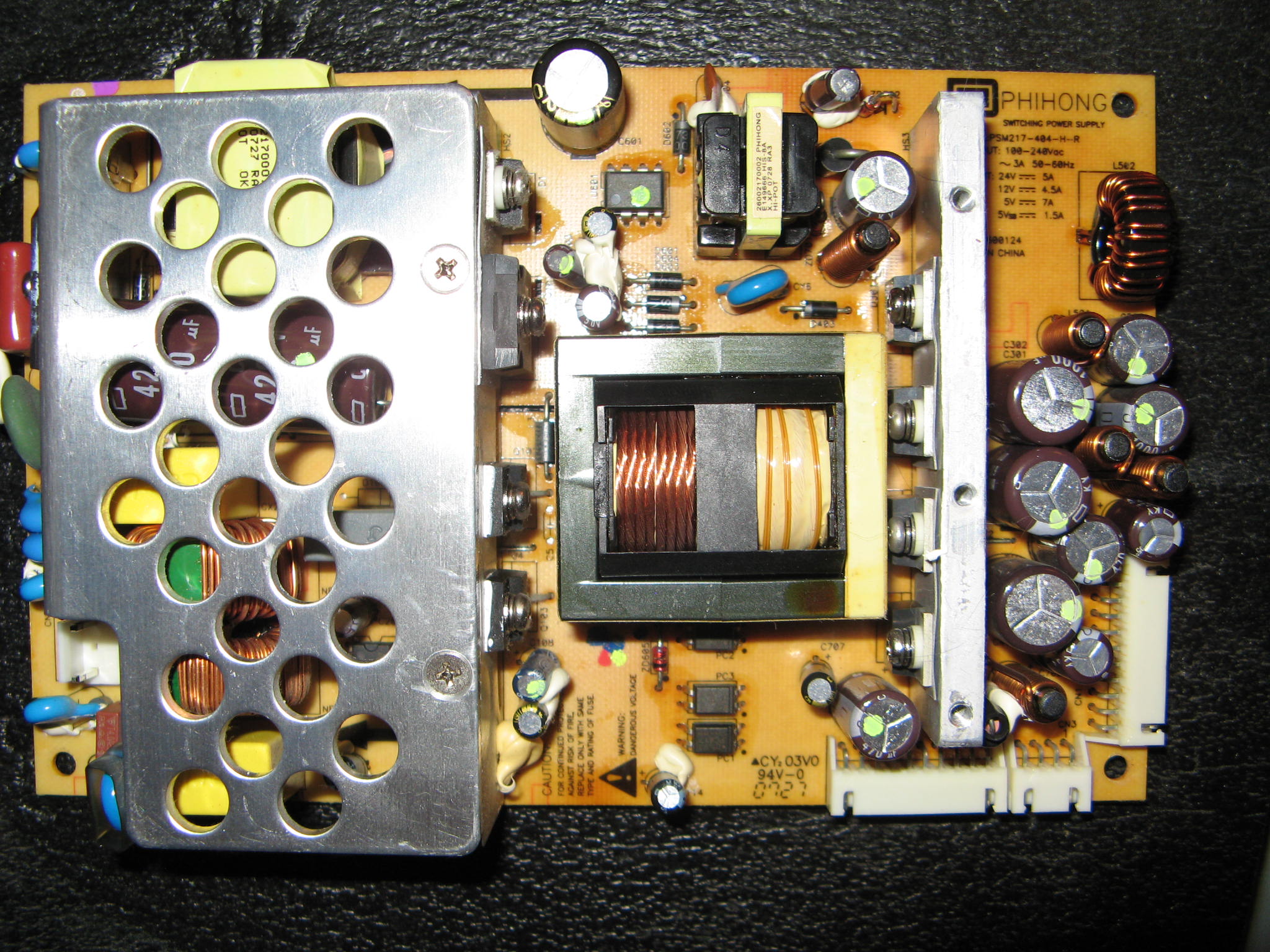

      I've uploaded a few pics (sorry for quality) before I order the parts but can someone confirm that some of these caps look like they were replaced once?
      The orginals I think said L-Tec but I can't make out the name of some of the others.
      Asking because this unit was a replacement unit as I had trouble with the orginal monitor and had to send it in for warranty repair so I'm assuming this was a replacement item.

        Those look like the originals alright. Another clue is the glue attached to the caps. Repairs don't normally add the glue back on. Only the original manufacturer uses it. I can see those very caps you need to replace in the center. They tend to dry up. And those 2 on the main board. And you should be fixed up real good.

                    Well this just keeps getting better and better. The monitor would not come up today so I tore it apart again today to see if something came unpluged as I had it apart a day or so ago getting cap ratings.
                    I'm still pretty sure my issue is related to the caps on the PSU and I have them (8 on PSU 2 for LB) on the way, but discoverd a mess today on the logic board (see pics). As I stated before this monitor was already in for warranty repair for a "Fuzzy Screen" issue so I'm asumming this is their fix.
                    On the logic board it looks like they already replaced 3 caps judgeing by the mess they left on the board.
                    C80 With a 100u 25V
                    C83 With a 100u 25V
                    C69 With a 100U 25V
                    Now besides the mess what concerns me is the voltage regulator U7 (Img_0611). Measuring voltages this is what I got (Regulator upright-legs down pin 1-3 reading left to right)

                      The brown "mess" on the logic board is just left over flux from when they changed the caps under the warranty repair. Doesn't help nor hurt the board in any way, so it can be left alone. If you want to clean it, you can use isopropyl alcohol.
                      As far as changing caps C80, C83, and C69 - that depends on what caps they used for the replacements. Judging by the color, they look like Chemicon KY or KZE to me. If not, let us know what they are. I would also suggest to replace the 3 small 10uF 16V CapXon caps (C74, C77, C8) right under the the voltage regulator - they likely got cooked.
                      Also that 22uF 35V small L-tec cap on the power board.

                          The "mess" is the flux left over from their soldering. A little alcohol and a Q-tip or paper towel will clean that right up. They actually did a decent job soldering. I'd leave the ones on the main board.
                          The reason for the intermittent startups is because that little startup cap is probably almost dried out. Once you replace the 8 on the power board you'll be fine. Not sure about your soldering skill; but if you need to, you might wanna practice up until the caps arrive. Sincerely, L-J-7

                                      OMG what a nightmare I got myself into.
                                      Where to start... Well the caps arrived in the mail today so I decided to go ahead with the recap job. As I told LJ7 I've spent the last few days practiceing on a few motherboards but also on a few ATX power supplys as those are single side boards which this PSU is so I was pretty much ready.
                                      So what happens on the first cap desolder..... BAM!! Lift the solder pad breaking the trace right off the board using the needle method to open the hole. Solder was cool and solid but it stuck to the stainless steel as I spun it so I was pretty pissed and it was the first cap.
                                      I could not believe how fast the board solder melted (less then 1 sec almost on contact) and this was using a cheap ass 20watt iron. The other boards I practiced on were not anything like that. Needless to say I screwed up two pretty bad and had to build some bridges to a few componets while checking continuity between them.
                                      I was also suprised that several of the caps had the zig/zag pattern in the hole and the ends folded over on the bottom side which made their removal a little more difficult.
                                      The three that gave me the most trouble I thought would be the easiest and they were C406, C707, C114. Anyway long story short after the repair was done I thought I would "Plug in the AC...hit the switch and hear the pop". I did check the 5V rail before power and it was rock solid so I asummed once it kicked the 12V-24V rails on it would pop.
                                      Low and behold hit the power button and the DAM THING WORKED!!
                                      So for those looking through this thread this is what fixed my issue which was "Slow startup, blue light blinks here and there and taking 5 min to 5 hours to come on and no sleep mode"
                                      Replaced caps C406, C603, C606, C605, C707, C108, C111, C114 with quality panasonic caps from digikey.com. Fast delivery and total cost was $6.02 including shipping.
