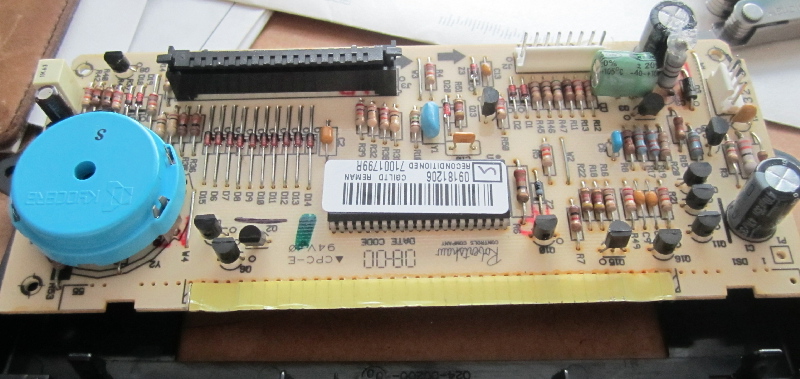

              This is the third time my Jenn-Air wall oven's display has gone dim. I read the posts and this time I purchased a Digi-Key 68uF cap and planned to replace the old one. The circuit board in the oven is reconditioned. See my two photos attached.
              The component presently in position "C3" isn't similar to the 68uF that I purchased. The board looks like that component was replaced in the past.
              Any suggestions?
              Premium supporters get full download access and other benefits.
              • ratdude747
                Black Sheep
                • Nov 2008
                • 17136
                • Linux, hardware, bicycles, pet rats (formerly), did i mention LINUX?
                #127
                Re: Dim Clock LCD on Jenn-Air wall oven
                Just replace the *cough* mess *cough* in that location with the new capacitor. It looks like some moron for whatever reason thought a crap cap could be made to last longer by limiting voltage/ current with a bodged-in resistor... Yeah, good one! (sarcasm)
                Whoever refurbed that board must not have been the hottest soldering iron on the bench... that's pretty terrible. Damn. Hall of shame material?

                  Damn. If I were going to 'refurbish' things in that manner, I sure wouldn't want to take credit for my work. Much less have it traceable with that fancy 'refurbished' sticker.
                    Thanks for the help. The repair was successful!

                      wow.and just to think a proper low esr cap in that position would have lasted the rest of the units useful life!but no we will bbq it with a resistor!
