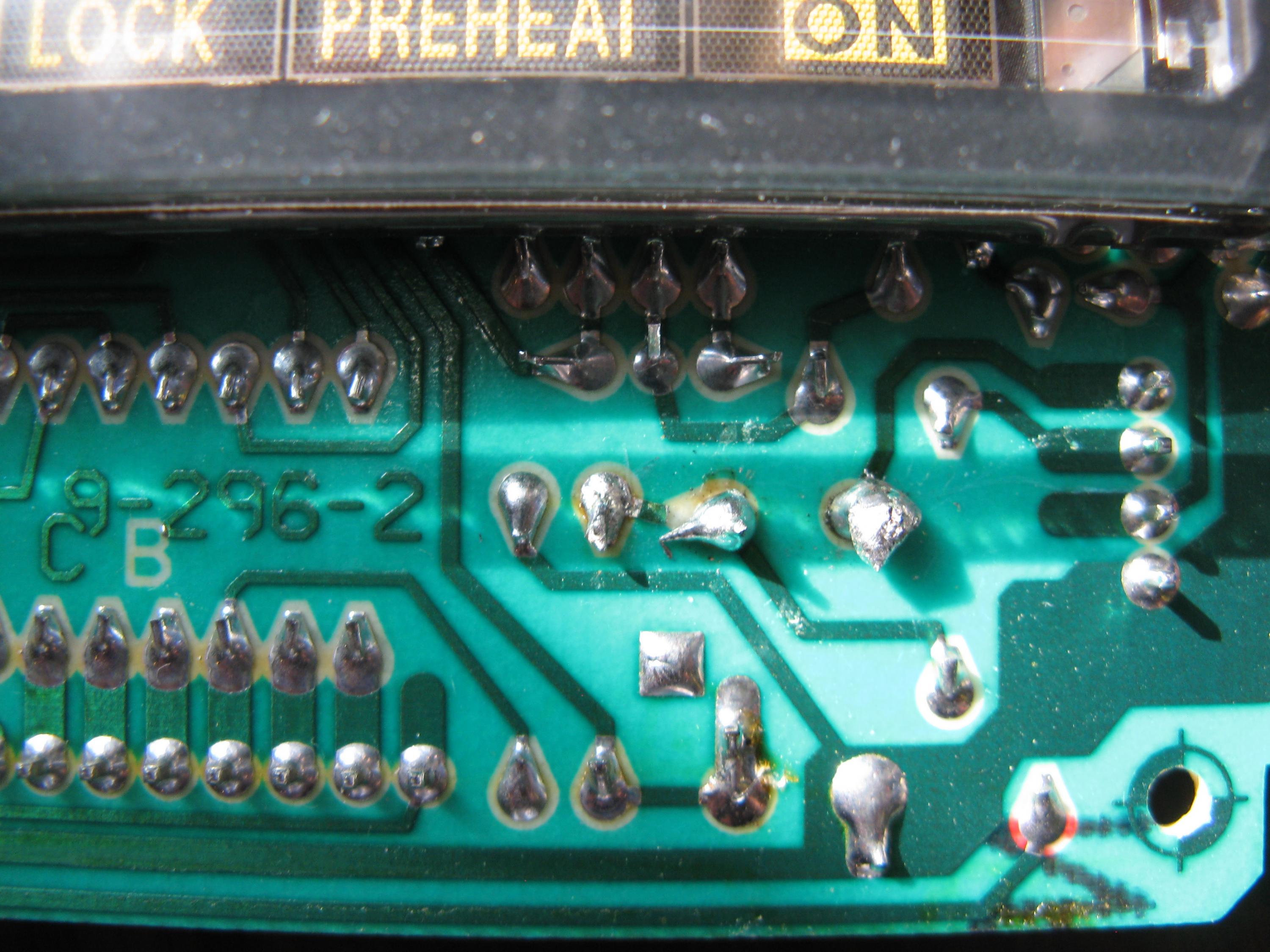

      I am new to this forum. I replaced the C3 capacitor in my Jenn Air wall oven board (modelww27430p). Before the replacement, the oven would work even though there was no display to show the temp, etc. The clock displayed dimly. After the repair I can't get oven to even start, nothing beeps when I press the buttons to start a function and no clock. I tested the extra 68uf 35v capacitor (purchased from DigiKey) and get the same ohm reading with both the unused capacitor and the one on the board so it would seem that the one on the board is connected. Any suggestions on what I can do next to fix this issue? I purchased all the capacitors listed in one of the first messages in this thread. I am confident of the polarity on the capacitor as the orientation is the same as it was originally.

              #86
              Re: Dim Clock LCD on Jenn-Air wall oven
              The capacitor seems tight as do the other connections on the board. I'm wondering if my problem is the ribbon cable because that connects the board to the touch panel. How do I know that the cable is well seated (pushed far enough in)? Also, is there a fuse that I might have popped because I'm thinking I disconnected or connected when the power was on once. I have attempted to attach a picture of the soldier joints. The joints aren't as flat
              on the board as the originals - is that my problem? Is there a way I can get them to flow to the board better?
              Thanks, Jackie

                #87
                Thanks, Jackie
                Ah! no wonder why it isn't working, you broke a copper trace.

                  #88
                  where is the broken copper trace (trying to learn, not questioning your response). Does this mean I just anty up and buy a new board? I'd really like a working oven even if I have to pay the price. And, how do I avoid breaking a copper trace - I want to fix my daughter's oven and not mess it up like I did mine
                  Thanks, Jackie

                    #89
                    Thanks, Jackie
                    Here it is. Just use a thin piece of wire (like from a component lead) to bridge the gap there, and solder it in good. That should fix your problems!

                          #92
                          Thanks for the advice. I have bridged over the bad copper trace. Now the top oven is working but no display or lower oven function. I'm wondering if the ribbon cable is not seated quite right. Great advice on practicing on an old board and watching you tube videos. I'm sure practice will help. I'm not ready to give up so will try what you've suggested.

                            The solder joint on the other side of the capacitor doesn't look too good either. You might want to touch it up too. Hopefully doing that will bring life back to your clock.

                              #94
                              Thanks to this forum my oven now has a display, etc. This was wonderful. Now I'm wondering how I could figure out if there is a bad capacitor in my other jenn air oven. I can't adjust the temp on that oven. That oven doesn't get as hot as it should. There are steps to input and bump the temp by 5 degree increments but they don't work. Jenn Air says I need a new control board so for now I'm setting the temp 20 degrees higher than I want to circumvent that problem.
