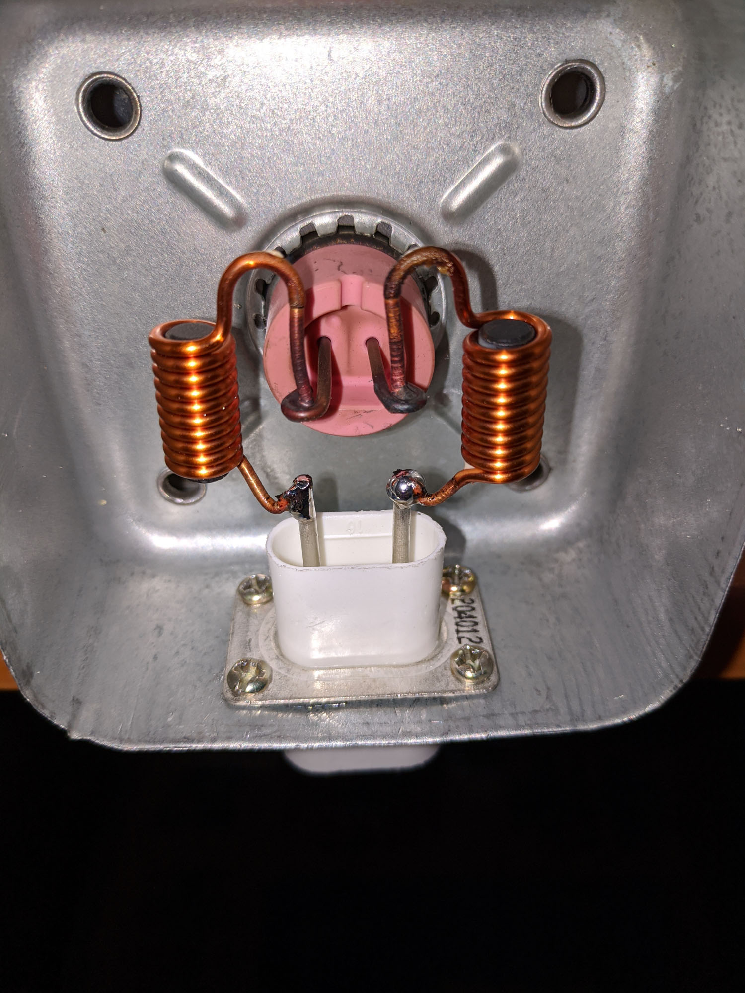

    One day my microwave oven stopped heating.
    It would turn on and rotate the plate but no heat.
    I removed the cover and checked components with digital multimeter.
    Found that the high voltage fuse was blown.
    This is not the AC fuse, if the AC fuse was blown then the oven would appear totally dead.
    Then I tried to find replacement fuse on local electronic parts stores and this specific value was not available so I got the closest I could find.
    I replaced fuse and tried to heat up a glass of water.
    Strange noise was coming from the oven when it gave power to the magnetron, but the familiar noise of the magnetron generating the heating waves was not heard and the water not heated. Instead, I could smell some burnt electronics/plastic smell coming from inside the enclosure so I turned it off quickly and checked again.
    The fuse, being of bigger current size, doesn't burn any more but something has definitely failed inside the oven.
    Then googled "microwave oven works but no heating" and stumbled upon this video:
    https://www.youtube.com/watch?v=9BUalRbhWG4

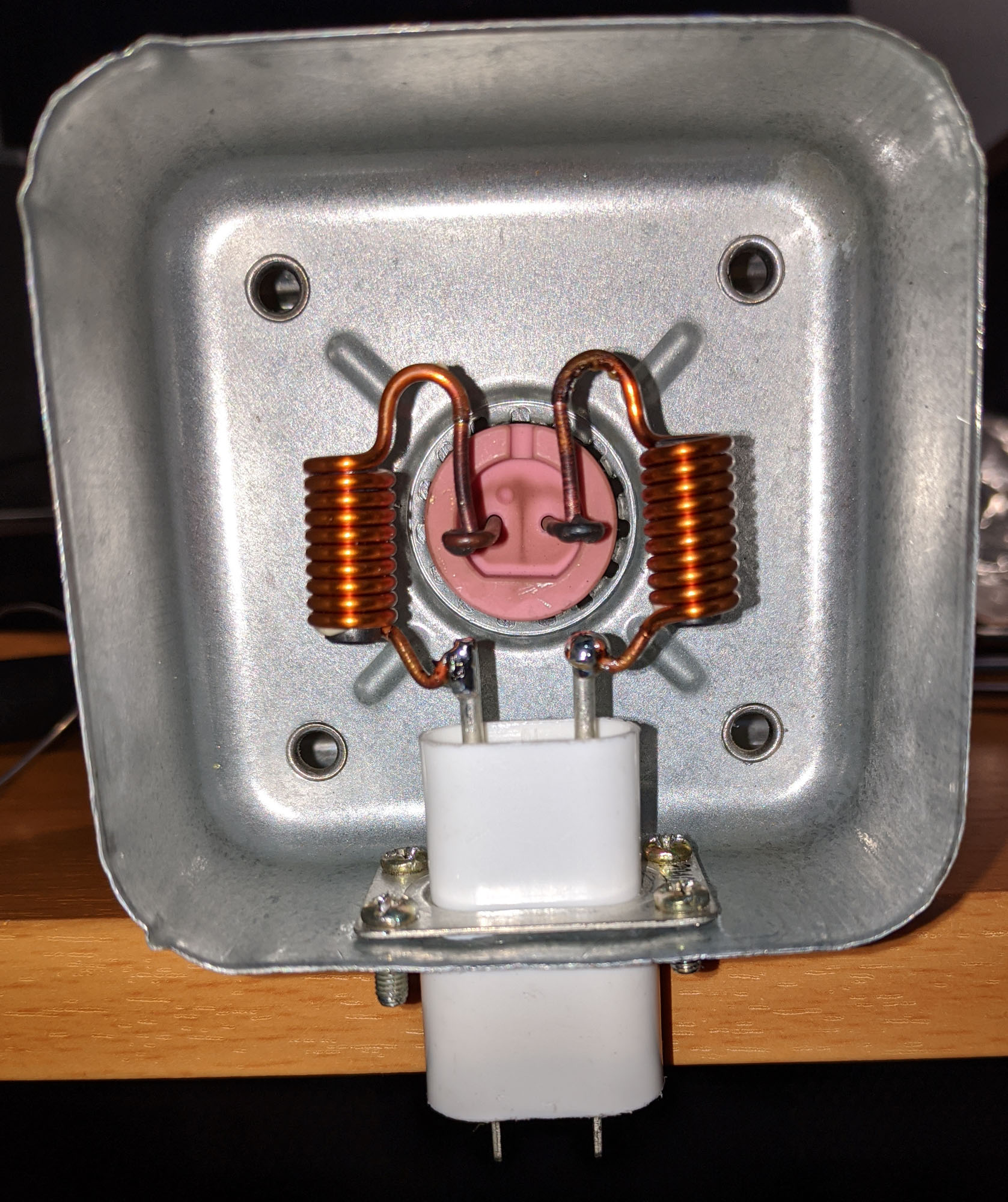

    Turns out that on the magnetron connectors (that contain some capacitors inside), one of the connector is arcing to the case of the magnetron.
    So, I ordered connector and HV diode from aliexpress/ebay. HV diode looked discolored from heat but was not able to test it with digital multi-meter (appeared open, DMs cannot test HV diode except if it's shorted). I thought it would be a good idea to replace it anyway.
    So, I replaced the connector and diode and the oven now works as new!
    One think I did different from the repair in the video linked above, I did not use screw terminal for the new connector terminals, I just soldered them to the magnetron as you can see in the pictures uploaded. The original terminals were welded. I hope it lasts.

    One comment I have for you is as follows
    I would have wrapped the wire around the terminal and then soldered it so you would have a solid mechanical joint plus a solid soldering joint as well
    Because what you might notice is a few months from now that the stress from heating and cooling of the heater element might cause it to crack [ soldering joint ] and cause connection issues ( also vibrating of the magnetron might also cause the same problem )
    I have work on some microwave ovens in the past and never seen this type of failure before
    On this note where did you find this connector that you replaced could please post the website link to it
    Thank you for posting your finding in this forum

        Well, I should have thought this earlier, now time will tell how long it lasts..
        I bought the HV diode I replaced from here:
        https://www.ebay.com/itm/5pcs-HVR-1X...72.m2749.l2649
        Here is a link to the connector:
        https://www.ebay.com/itm/5Pcs-Electr...72.m2749.l2649
        Quality seemed to be OK but they had some visual differences (it's 5 pcs lot), they were not identical.
        You can also buy the connector with screws and nuts as a kit ready to replace the shorted one from here:

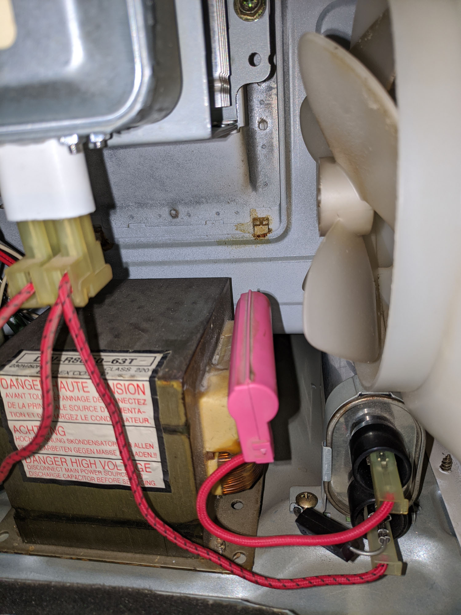

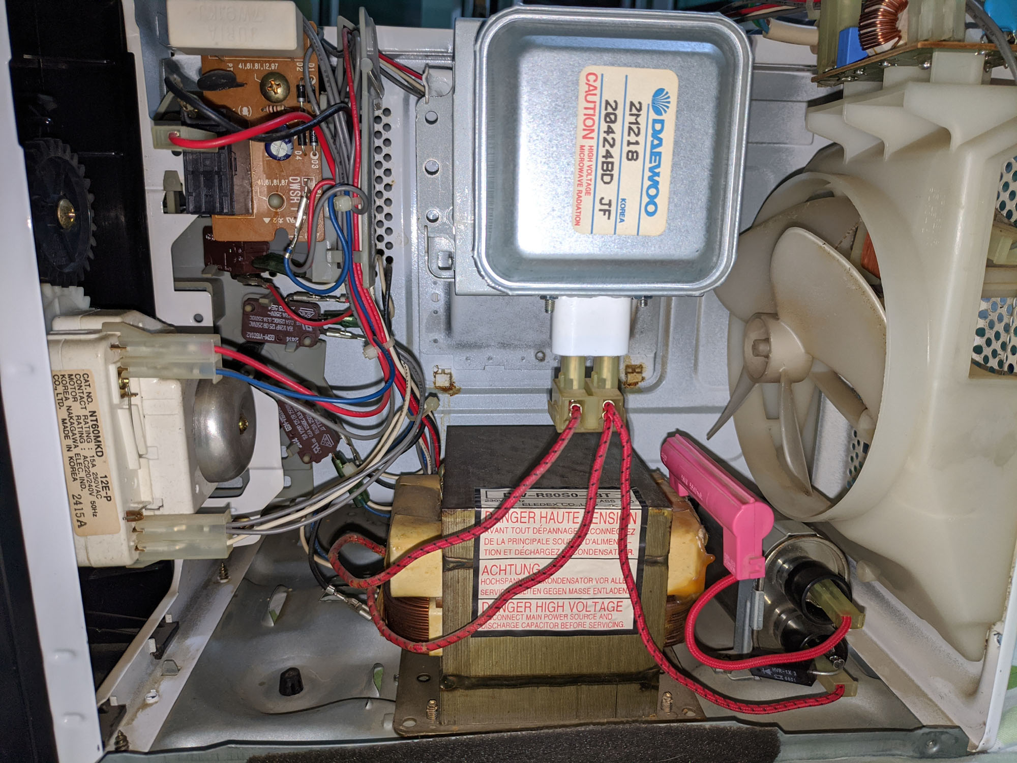

              Re: Daewoo microwave oven repair
              Where are the diodes in your repair? I cannot see anything in the picture matching the ebay link you shared

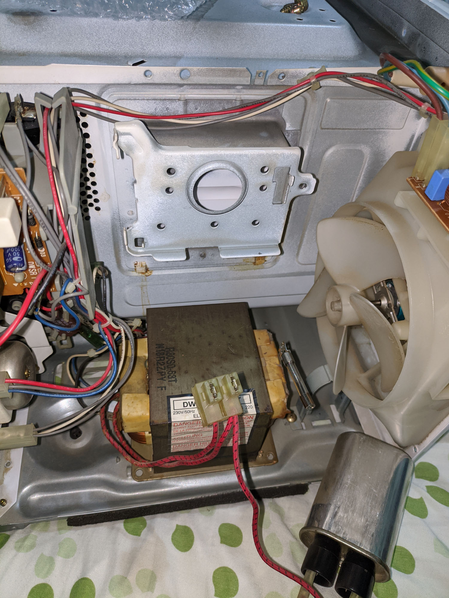

                        here:
                        https://www.badcaps.net/forum/attach...9&d=1611525320
                        https://www.badcaps.net/forum/attach...0&d=1611525320
                        on the bottom right, near the large AC capacitor
