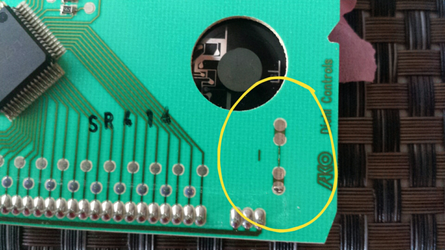

          Did your display fade out gradually or suddenly? Post some pictures of the board.

            Hi Bluto, thanks for your reply. The lcd went blank over time and has been for a few years. I did change all caps and repaired the breaks in the copper traces and one break in a transformer lead. I took for repairs at local tv repair shop and computer repair shop. Pics attached, hope clear enough. After repairs there was nothing on the display for days but suddenly dim clock numbers appeared but not to be exclaimed about as others have. A brighter display would be great tho. Any ideas. THANKS

              It seems like you are back where you started. In your 4th picture, it looks like you circled a bad solder joint. You might want to go over the whole board again looking for more of them.

                Actually the 4th pic shows a broken transformer lead. I got it fixed. I took pics of ever inch of the board and magnified them and only 3 broken copper traces and 1 broken transformer lead were found. The C3 cap that was replaced has some give from the leads going into the cap itself. Whenever I give it a rock back and forth I can feel a slight movement in the cap. The solder connection is firm. Do you think this could cause the dim display?

                  Yes it could be bad. C3 (68uf) on these boards is what drives the VFD and causes the fade out. It is usually the only one that is bad. Try replacing it again. If you have a multimeter with a capacitor mode, you can check the capacitance of both old and new.
                  If you are just coming to this thread and don't want to read all 11 pages, start by replacing C3 to fix the faded out clock. I replaced all caps on mine but it was not required. I can't edit the first post or else I would clarify.

                            I guess I should have put all of that information in my original post. So after one more peek inside the oven, here are the specs and part numbers to order from Digikey. All part numbers listed are for Panasonic FC series capacitors. FM series part number shown in parenthesis where the FC series cap is out of stock at the time of this post.
                            On the clock module:
                            C1 & C4 470uF 35v P10301-ND (or the FM series: P12400-ND)
                            C3 68uF 35v P10292-ND
                            C7 22uF 50v P10318-ND
                            On my oven I also replaced the two caps on the power supply/relay board as a precaution. They were as follows:
                            3300uf 16v P10260-ND [filter cap] (or the FM series: P12373-ND)
                            47uf 50v P10321-ND [the only other cap on the board]
                            Of course the power supply/relay board could vary if you have a different model oven (gas for example).
                            Please update this thread if this information is useful and you are able to repair your clock module.
