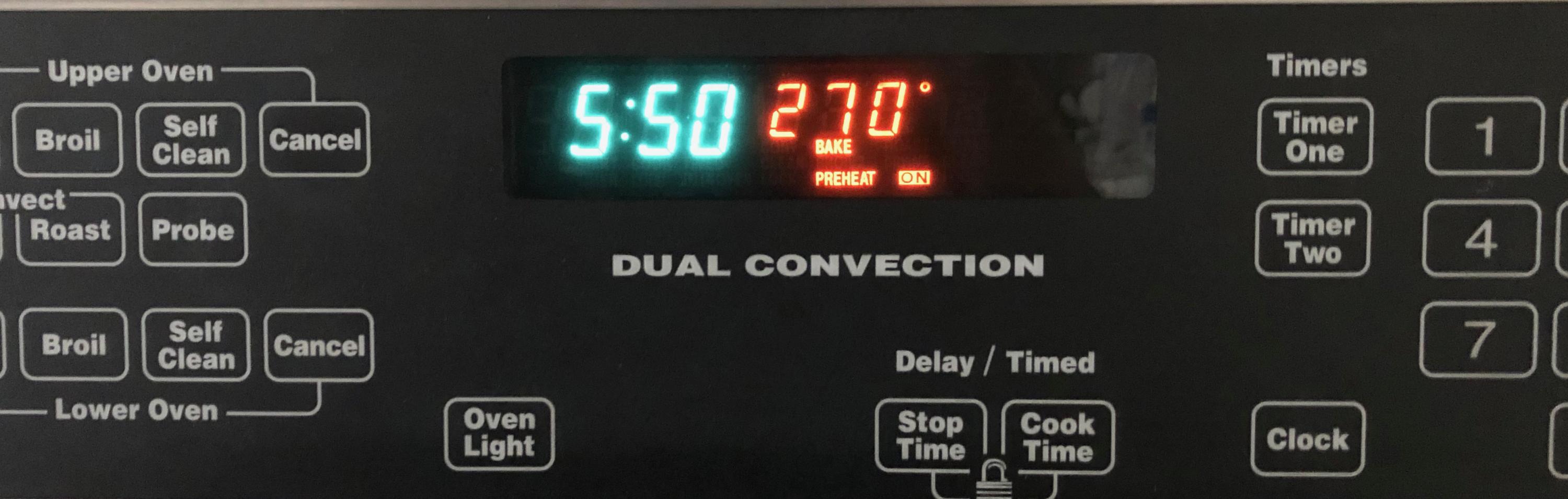

                    #229
                    Re: Dim Clock LCD on Jenn-Air wall oven
                    And... the result. Thanks again!

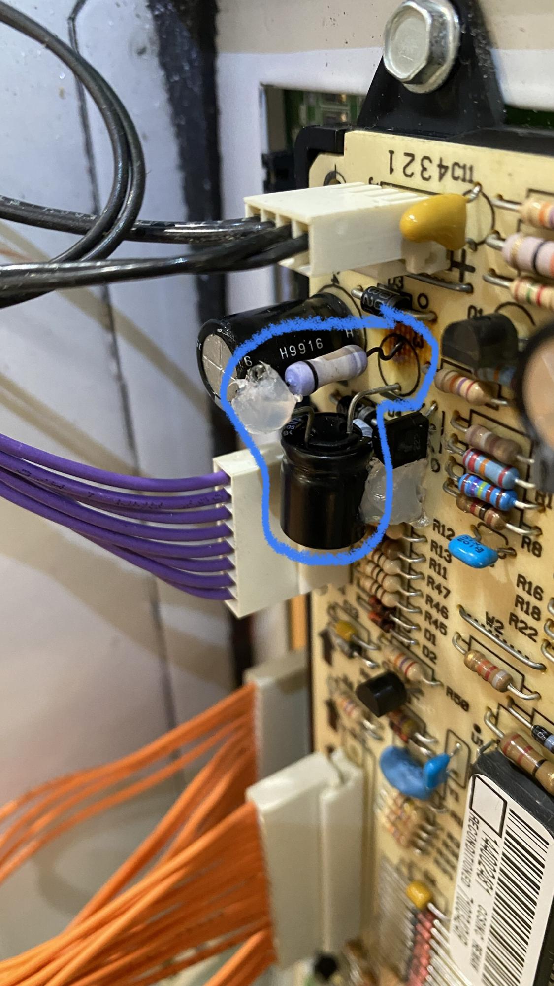

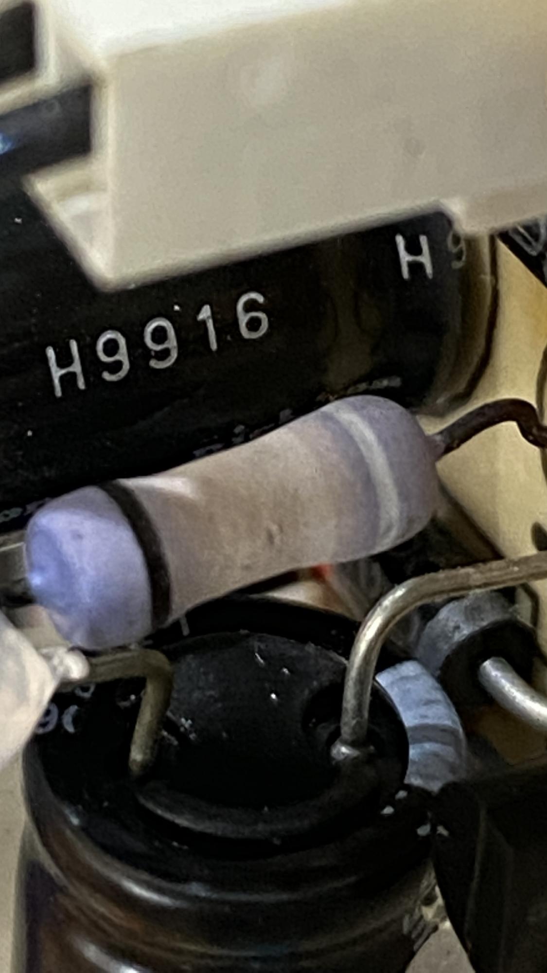

                                  Thread bump;
                                  Hello all. I need some help. I have a Jennair wall oven. The display has faded to nothing but the oven works fine. I have read on the previous posts about the c3 ECapacitor.
                                  Upon inspection I found the c3 with a resistor soldered in line that is then soldered to the board. the cap is a 220uf 35v; The obvious problem is the resistor has failed and overheated, and popped off the solder from the board (burnt mark also there).
                                  The resistor overheat has made the stripes unreadable.
                                  I am not sure why there is a 220uf in that location. Is this the reason for the resistor to pull it down to 68uf ?!?!
                                  The 220uf doesn't look damaged.
                                  All of the references in this thread say that it is supposed to be a 68uf 35v. Should I just replace it with a 68 and clean up the terminal and install?
                                  I appreciate your help -- trying to get the screen to work before we have family over for Christmas dinners! :o

                                      #238
                                      There are refurbished/reconditioned Jenn-Air oven control boards out there that have an added series resistor at capacitor C3, in an attempt to make C3 last longer by lowering its ripple current. Like pics here:
                                      https://www.badcaps.net/forum/showpo...&postcount=126
                                      It looks like 11 ohms and 2W.
                                      If that resistor overheated, then C3 has likely failed. Can you test it or look for signs of bulging, leaking etc. It is OK to upsize the part from 68uF to 100uF, I would say 220uF is a bit much but I have not measured the actual circuit.
                                      • RoadsterZ4
                                        • Dec 2021
                                        • 5

                                          #240
                                          That resistor is burnt badly, kinda puzzled because it means something else has shorted?
                                          Another post shows red as the first stripe. Newer Jenn-Air oven controller boards use: a 27ohm 3W resistor red-violet-black-gold, and 220uF 35V capacitor. Adding the resistor is supposed to give C3 longer life, as well as the upsizing it from 68uF to 220uF. What happened to your board then?
                                          For a suitable 27R 3W resistor, body is about 15mm long, I'd use flameproof safety types: TE RR03J27RTB, TE ROX3SJ27R, Yageo PNP300JR-73-27R, Panasonic ERG-3SJ270 etc.
                                          For a suitable 27R 2W resistor, body is about 11mm long, I'd use flameproof safety types: TE RR02J27RTB, TE ROX2SJ27R, Yageo RSF200JR-73-27R, Panasonic ERG-2SJ270 etc.
                                          The resistor does not dissipate even 0.5W normally.
                                          I would replace C3 and C4 and test the old parts, one of them should have failed short. That's a bit weird, unless you have high mains voltage or power surges/lightning. I wonder what their operating voltage is. Test diodes D3 and D4 too.
                                          I went down the rabbit hole a little into the circuit. Capacitor C3 feeds C4, so if C3 or C4 fail (low value) it will give a dim display. If either shorts, no display and it would burnt up the resistor.
                                          The board has already been refurb'ed so it will be extra fragile, the PCB pads.
