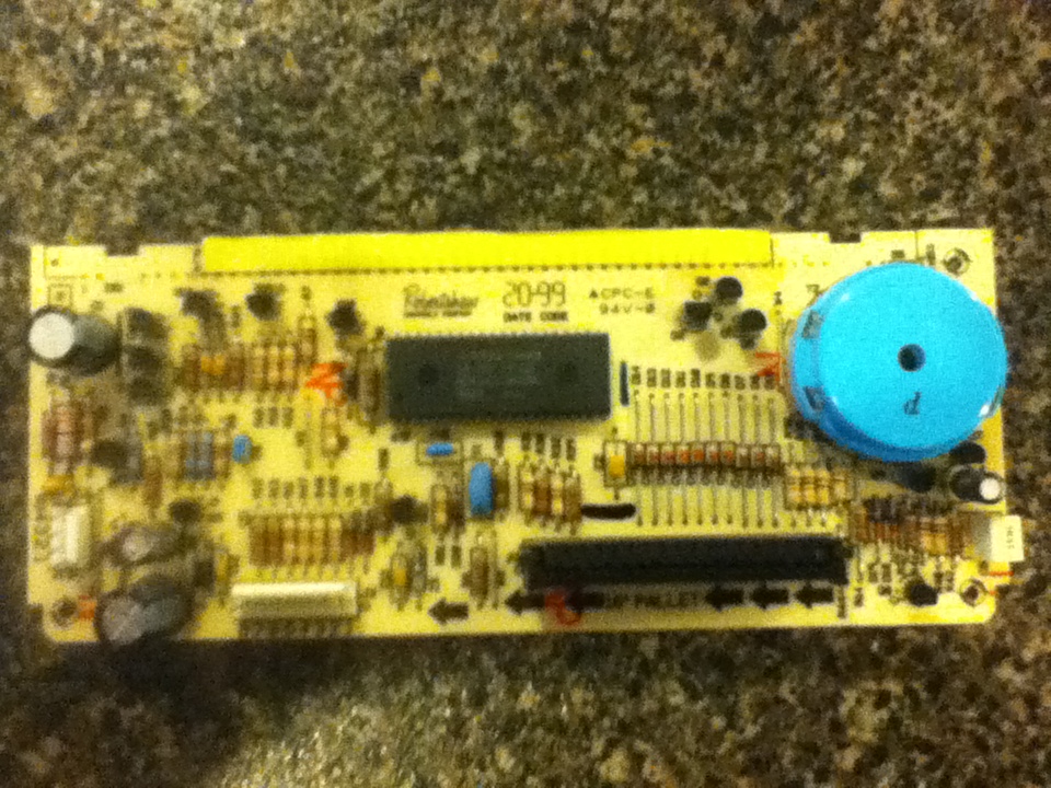

      Hi, I'm having problems with the portion my Jenn-Air oven display (Mdl WM27460W). The "clock" side of the display seems good but the side that shows the oven temp, etc. is not showing anything. Weill replacing the capacitors solve this problem? Thanks.

        A friend of mine asked me to help him with his Jenn-Air oven display. Apparently the display went out on his range but everything works as it should except for the display. This is the third time the trouble has happened and he has replaced the board twice with a cost of over 200 dollars for each repair. After searching the net a little for some info on the PC board I came across this site and signed up. We will try replacing capacitor C3 and see what happens. After reading the posts here it seems that will fix him up ok. I will send in a update with the results after a new cap is installed. Thanks for the help here fellas.

          Re: Dim Clock LCD on Jenn-Air wall oven
          I'm not sure if replacing the other caps also will fix your particular problem since you say the clock part works ok. It wouldn't cost you much to replace all of them and see what happens. If it doesn't work you should be able to replace the board for around 240 dollars.
          You might also try cleaning the ribbon cable connections to see if that helps. Pushing down on the end taps of the connector is supposed to release the cable.

            Well, replacing capacitor C3 fixed the display problem but now the front panel control buttons aren't working for some reason.
              Make sure the connector that connects the keypad to the circuitboard is fully seated.

                He did do that and even cleaned the connections; unfortunately that isn't the trouble. We got close to fixing it. He may now end up replacing the unit since it is getting fairly old.
                  Check for solder bridges, and add some fresh solder to every joint.

                      HI, I finally did what everyone else was saying so I replaced all 4 capacitors and now everything works. I can see both the clock and the right side of the display which shows the oven temp and selected functions. This saved me lots of money, cost me less than $6 for the parts and shipping. Thanks everyone for your generous help.

                              You guys absolutely rock. I had to do a 47 and 22uF in parallel but that cost all of $2 at my local Fry's electronics to replace c3.

                                Thanks for the help and the info I found on this thread, I ordered the parts online and they arrived in one day (yes I ordered replacement parts for the other caps but only installed C3).
                                I have posted photos detailing all the steps, but anyone who stumbles on to this thread can feel free to ask questions. For example, I wasn't sure how to remove the wide ribbon cable. Then I remembered, when I had recently fixed my son's Ps3, you just press on the two protrusions on the edges of the plug and the ribbon just slides out.
                                Removing the old solder took a while. I melted the old solder with the soldering iron then pried out the cap wire using a thin flat screwdriver. Not sure it this process might damage the circuit board but what did I have to lose, since if I was not successful I would have to buy a new module anyways (it's $250 plus 13%tax Cad here in Canada from a local jennair parts dealer).
                                Anyways, good luck to those who may wish to try this out, but proceed at your own risk.

                                    You should be good replacing just the 68uf cap. I was talking to my uncle over the Christmas holiday and he mentioned that he had recently fixed his oven clock also. I asked if it had faded out and he said no it had just went out suddenly. The was on a 17 year old oven. So if yours blanks out suddenly, it is probably still worth the effort of replacing the caps. Its amazing how common this problem is. Almost 20k views on this thread and no signs of slowing down!

                                        BOOM!!! replaced the 68uf cap C3 and it works again. A big THANK YOU to bluto and this forum Saved me a lot of money
